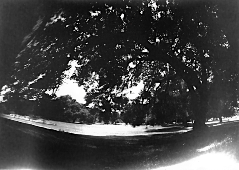

Here it is. Not a good photograph and not a good negative, but it shows the process worked. There is some mottling that I've also seen with H202 bleached paper negatives when exposed to light and redeveloped... but not so much when redeveloped in thiourea.
@NedL: congratulations!
