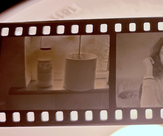

I remembered that I had a semi-successful roll from the citric acid bleach in the drawer here. Quick snap to show that it does work, but I didn't finish work on a final bleach with citric acid. You can see there is still some staining and the Dmax is too low. The frame with my daughter looks much better, but I'm not posting that one. You can see the edge of it here to see how it looks. My household ammonia is 5% and I was diluting it 1:1 with water.
