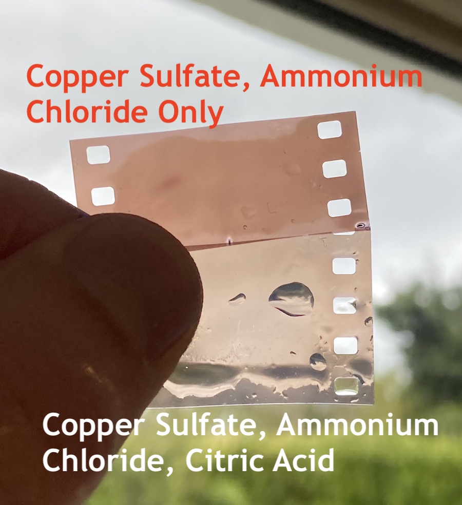

Well, I took the morning to attempt some experiments. I was thinking about this last night and wondered what would happen if we used ammonium chloride in the bleach instead of sodium chloride. I tried to sort through the chemistry and as I understand it, in theory it would give you copper chloride still, but but with some ammonium hydroxide in the bleach itself. Only I was nearly out of ammonium chloride, but I dug around and I found another 250g bag of it. So I was able to run some experiments like that.
Takeaways
  1. Using ammonium chloride instead of sodium chloride noticeably speeds up the bleach. Seems ready to go in about 1.5 mins @ 20C. I had several ideas about why but my main thought was that it probably is dissolving some of silver chloride right away on formation, and maybe that helps drive the reaction. Times will vary by density of course.
  2. You don't get clear film this way, but it's starting to be a reasonably effective bleach.
  3. Density looks like what I was getting from peroxide/citric acid without the EDTA. But EDTA is not likely to help with copper in solution here since I think it will preferentially bond with the copper vs the silver, right?
  4. It appears not to be blixing too much though I suspect it is blixing somewhat
  5. You can eliminate the staining
  6. If you use ammonium chloride in the bleach, you don't need the citric acid at all. But you get a noticeably different density and it's a little slower. This might be a better rehal bleach than using citric acid and sodium chloride.

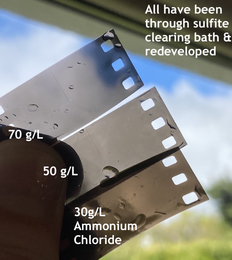

Setup
  • Fomapan 400 developed in my two bath developer 2B-4 (from a film leader). I would guess density is about 3/4 what it would be from reversal.
  • 100 ml of copper sulfate bleach, with the following formulation:
    • 5g copper sulfate pentahydrate
    • 3g citric acid 99.9%
    • varying amounts of ammonium chloride (3-7g)
  • 20g/L sodium sulfite clearing bath (same as with the peroxide bleach)
  • No separate ammonia bath
I tried several different concentrations of ammonium chloride. Up to about 70g/L it continues to make a difference to the resulting density. Above that I did not see any difference to my naked eye. The lower amount resulted in some brown/yellow staining, even with the clearing bath. By the time it's at 70g/L you don't have any staining.

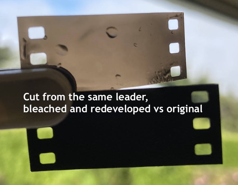

I was worried about how much of a blix it might be, so I developed half a snippet of Fomapan 400 in Ilford Multigrade developer (not to completion) and threw the whole thing into the bleach. I can't see any noticeable reduction in density from the undeveloped section. The image below has been bleached but nothing else.

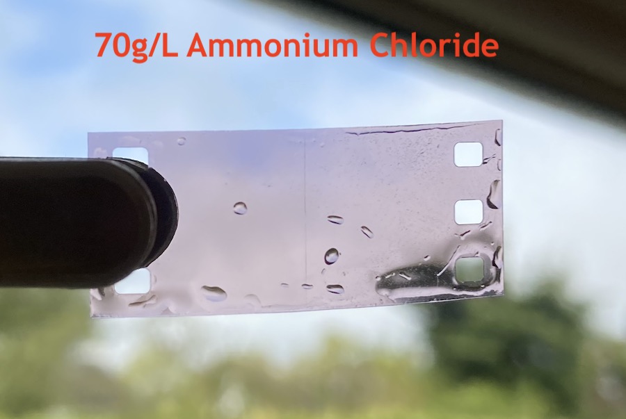

Finally, this image shows what the result is using a bleach that was made up of 70g/L ammonium chloride and 50g/L copper sulfate and nothing else, vs adding the citric acid at 30g/L. Difference in color is because this is (I think) ADOX Silvermax 100 in my 2B-1 two bath from a different leader.

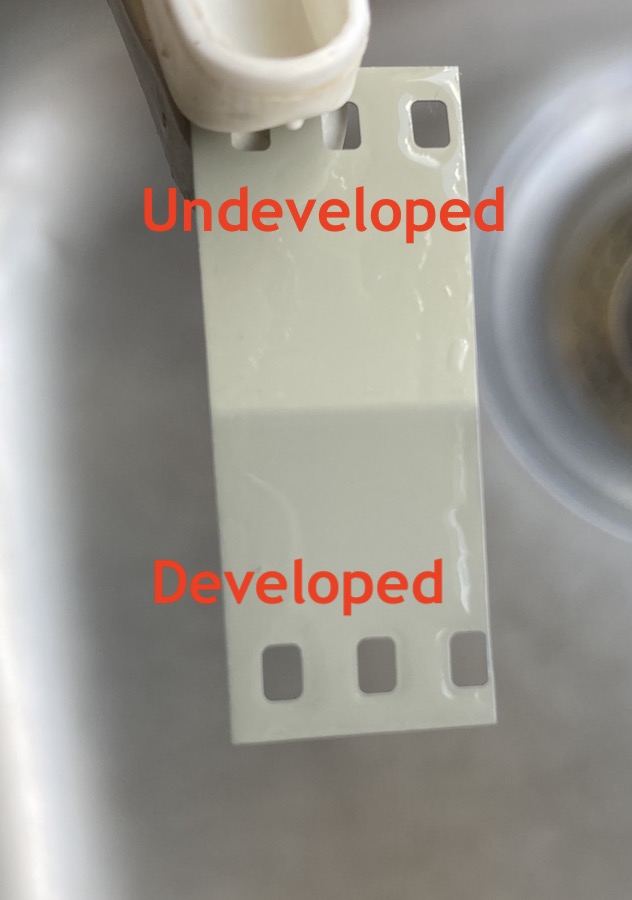

I took a small strip each of Arista Edu Ultra 100 and Orwo UN54, daylight fogged inside the room, developed for 10 minutes in my experimental reversal first developer. Then I bleached both strips for three minutes at room temperature (28C), washed and fixed. Arista strip nicely cleared but Orwo strip had some density on it. I washed the Orwo strip and bleached it for the second time, about two minutes, washed and fixed. Still the strip was not fully clear. Then I bleached it for the third time, for three minutes, washed and fixed. This time the strip was clear except for a small patch suggesting that a bleaching time of 10-12 minutes is needed for best results @28C. And at 20C, the time needed could be even higher. So, while the result with Arista Edu Ultra was encouraging, bleaching time for Orwo UN54 is on the higher side.
BTW the bleach didn't remove Silver Chloride from the film in a noticeable way. The addition of Ammonium Chloride doesn't eliminate the need for a subsequent Ammonia bath to clear Silver Chloride, at least with the amount of Ammonium Chloride used in the current formula.
