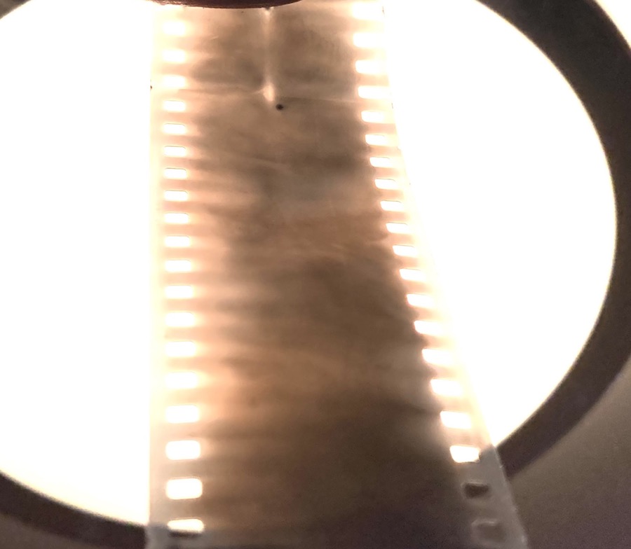

This is likely partly be inadequate bleaching, but I am pretty sure from the look and the color that a fair bit of this is silver citrate that wasn't cleared because I didn't use the sulfite bath. Not the best photo, but this should be the clear leader.
