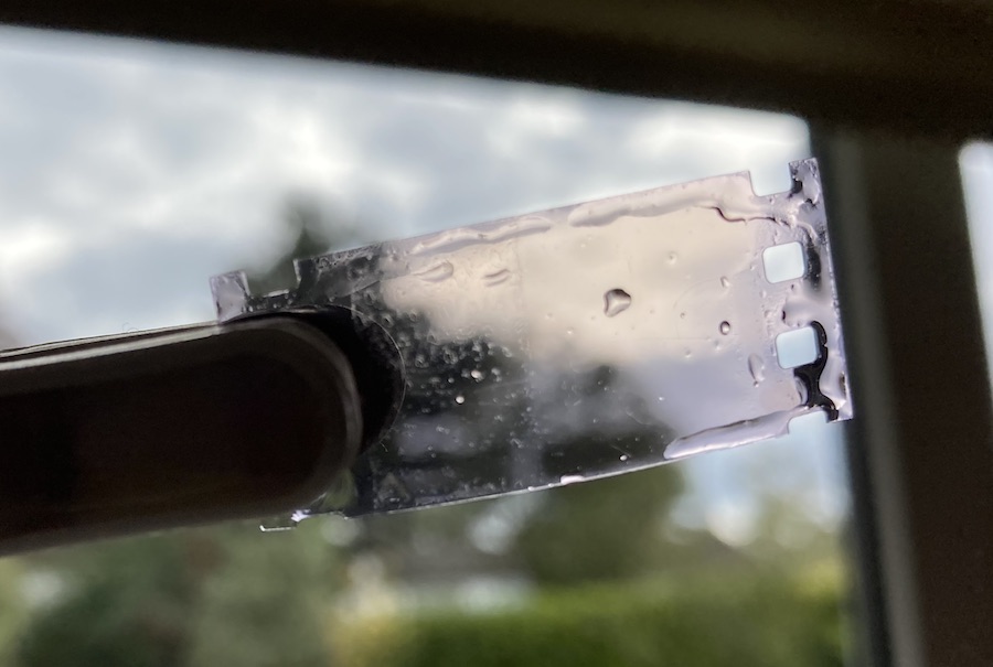

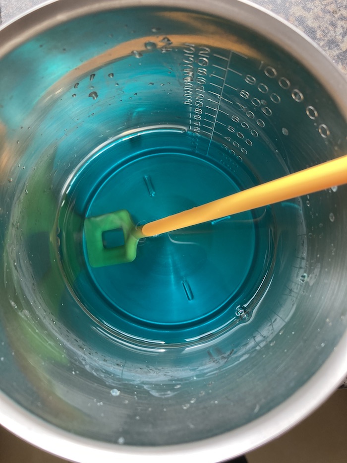

So I got stuck doing taxes today (fun, fun!) and didn't get to shoot any frames like I wanted. However, I got about 2 hours to run some further experiments with the Copper Sulfate/Salt/Citric acid bleach I posted.
I am using Copper sulfate pentahydrate from the garden shop. The salt is Tesco brand. It is not iodized. It's substantially all sodium chloride but does contain sodium ferrocyanide (not ferri) as a caking agent. I am not sure how much ferrocyanide ion is present in the bleach. Presumably a very tiny amount.
Pretty happy with the result.
Here's what I did:
  1. Developed a leader of Ilford Delta 100 for 7 mins in my old Ilford Multigrade-based first developer (MG 1+5 with 1.5g/L sodium thiosulfate)
  2. Because I am testing the bleach and not trying to test dev times for the first developer, I fixed for 3 mins
  3. I bleached for 5 mins @ 19C followed by 2 mins in 2.5% ammonia at 19C
  4. Skipped the clearing bath. It seems to have no effect in my testing so far.
  5. Redeveloped for 5 mins in Ilford Multigrade 1+9
Result:
Film base seems to have a slight pink cast.
When first mixed up with just the salt and the copper sulfate, the bleach is quite cloudy. When the citric acid is added, it looks like this:
Note that I mixed it in the 1L stainless, but moved it to plastic after. The bigger container is nicer for mixing and it doesn't get scratched by the crystals.
