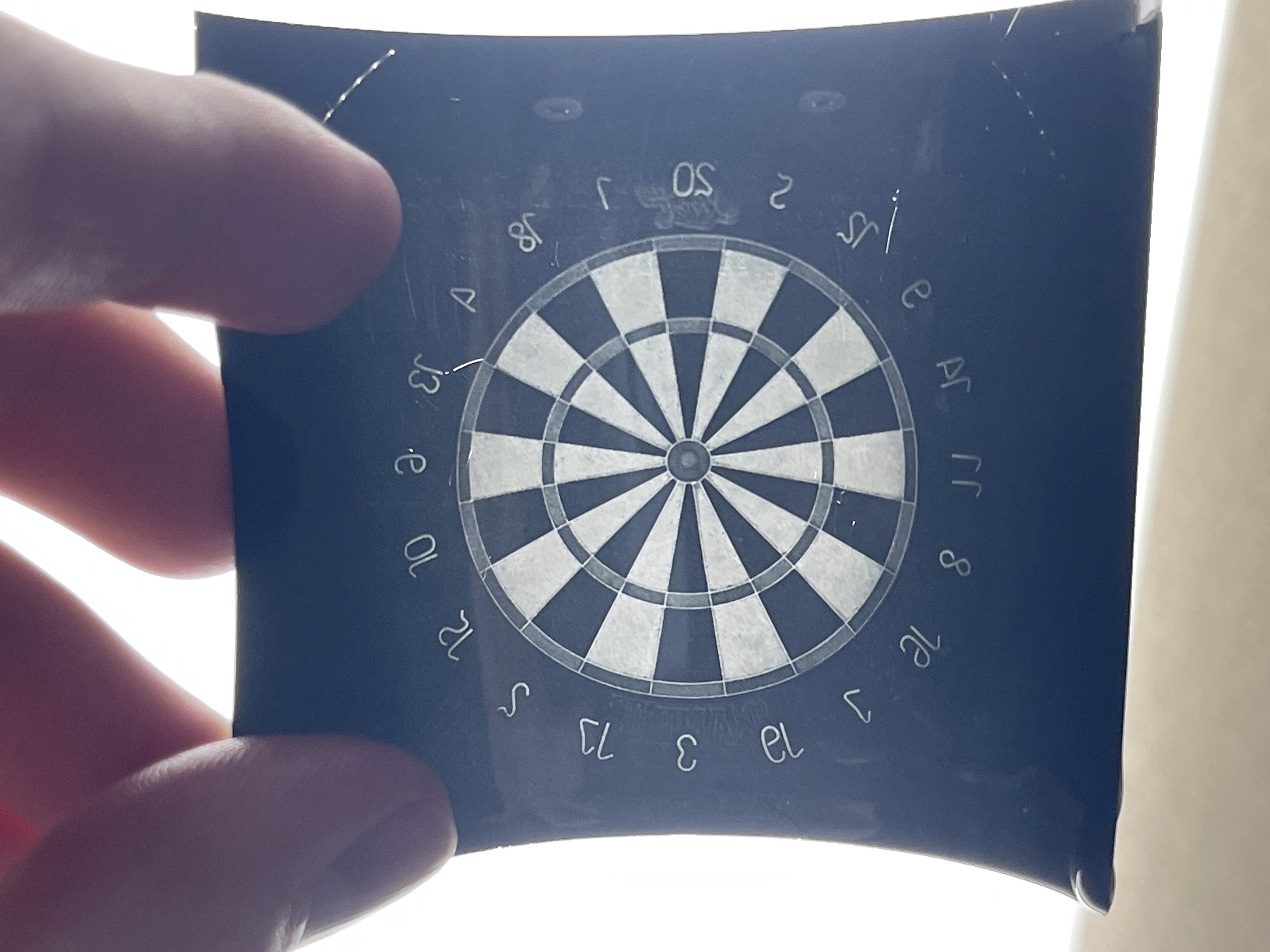

Still need to work on first dev (24 mins in Dektol 1+2 LOL)
You need more Dektol stock and less water. I used two parts Dektol stock to one part water and 12 minutes, with good results.
Well well well, look what we have here!

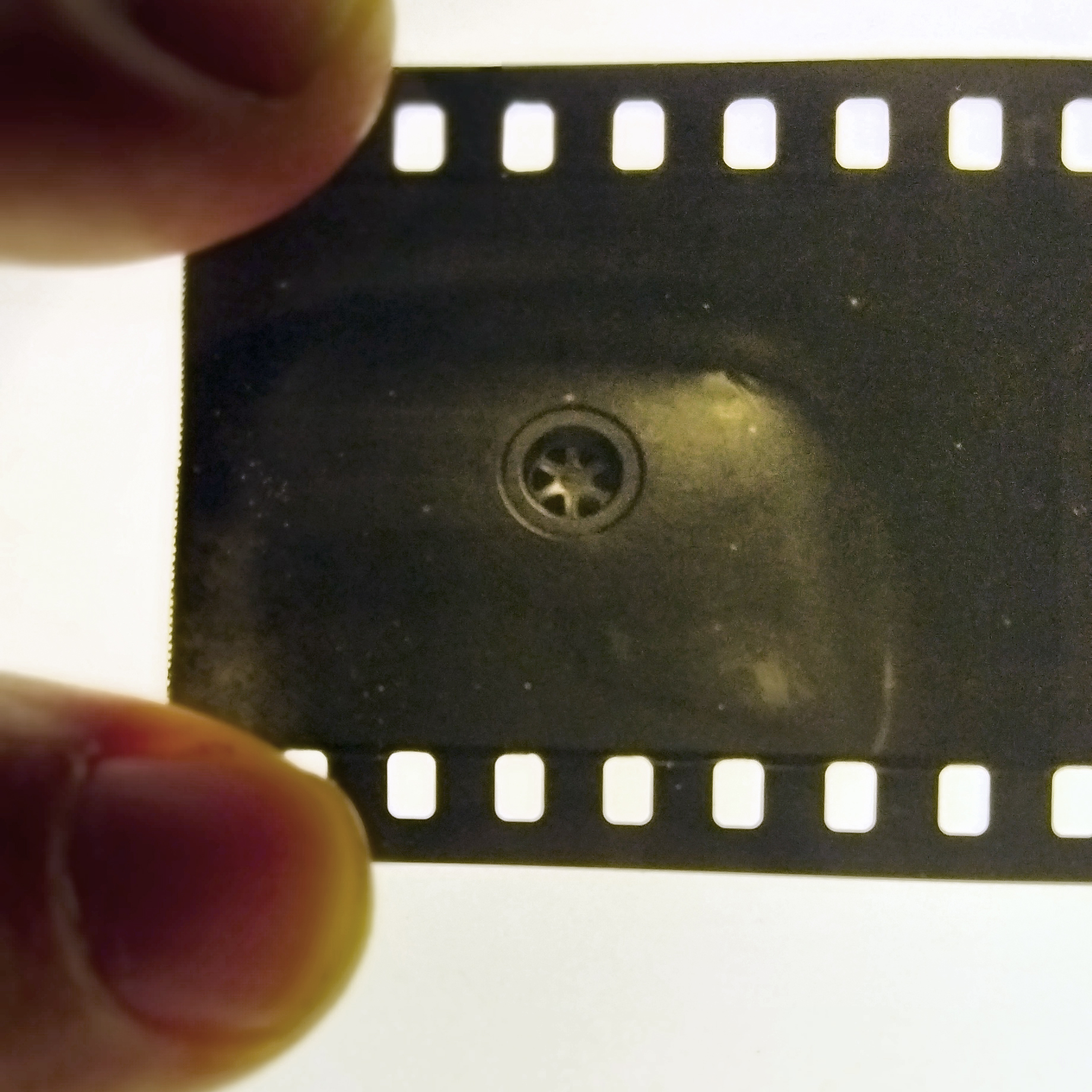

Still need to work on first dev (24 mins in Dektol 1+2 LOL), and it could probably do with a stop of over-exposure compared to box speed, but this is my first passable positive!
On a side note, this slide is almost impossible to see unless held up to the light, is this normal?
Hey, good progress. This is nice and lacking in stain and looks quite even. So you are on the right track. Bleach time may be close to right and second developer may be close as well.
I suggest you get a little sodium thiosulfate crystals and add 1g per liter to your first developer. (NOTE do not put this in the second developer). This won’t affect pH noticeably because it’s neutral as @Anon Ymous said. It will lighten your highlights. You may need to then adjust dev time a bit, too. The slide should not be so dark that you can’t just hold it up and look at it.
Well, I don’t have any hypo powder at the moment, so I’m just using straight dev. This was 12 minutes in HC-110 A, and I think it could use a bit of extra dev time. Gonna shoot a roll at 100 ISO and dev for 14-16 mins in HC-110 A tomorrow.

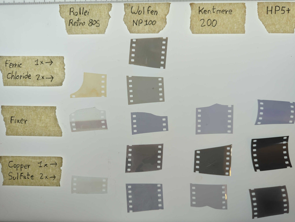

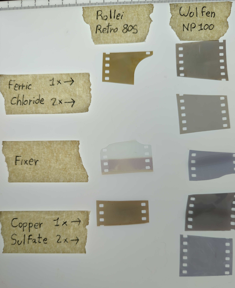

Result: After a second pass through the bleach, for 3 out of 4 films that I tried (Rollei 80S, Kentmere 200, Wolfen NP 100), I was essentially able to get to the film base. For the 4th film (HP5+) the second pass makes the film more transparent but still pretty awful.
I couldn't get enough cut-outs of Rollei 80S, so I have to show you the results in two photos:
Photo #1: After only 1 pass through the bleach. The middle film strip went straight to the fixer, so it shows what the film base looks like. I do not know why the Rollei 80S one has a colored band. I can tell you that the part that became clear was inside the film canister and the part with the color was the bit sticking out. 🤷‍♂️ In any case, after 1 pass, there's a significant amount of fog.

Photo #2: Second pass through the bleach. Here I also show the results for the last two films. With the notable exception of HP5+, the second pass through the copper sulfate bleach seems to get you all the way down to base fog, or thereabouts.
