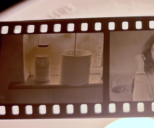

I remembered that I had a semi-successful roll from the citric acid bleach in the drawer here. Quick snap to show that it does work, but I didn't finish work on a final bleach with citric acid. You can see there is still some staining and the Dmax is too low. The frame with my daughter looks much better, but I'm not posting that one. You can see the edge of it here to see how it looks. My household ammonia is 5% and I was diluting it 1:1 with water.
Did you by any chance use a clearing bath? And do you (or anyone else) think that a clearing bath might help with this staining?
Yes, and yes, as mentioned above. Take a look at my blog post for the one I have used with the better peroxide bleach that contains citric acid.
I didn't see see any mention of a sulfite clearing bath, only ammonia, which is a part of the bleach, not a clearing bath. That’s why I asked. I’ll take a look at your blog post, though.
@MCB18 sorry, there are a lot of posts by now. This clearing bath will clear silver citrate. But by now I am not sure which bleach formula you intend to try (or already tried?). If you can give a summary of where things stand and what you are going to try, we can be more helpful.

I plan on trying the copper sulphate and salt bleach with citric acid as the acid lowering the Ph first. However, I was wondering if that yellow stain seen above would be removed with a sulfite clearing bath. If that yellow stain is Sodium Citrate, then it seems like the answer is yes. If it can be removed, then I would like to try the citric acid route first, and maybe I don’t have to use sulfuric acid in this process.
Ok, so like I said, there is no really paved path with that bleach yet: you will have to do some experimenting. I demonstrated that it works, but did not spend enough time to formulate everything to make clear slides yet. I don't think anybody will be able to tell you exactly what to do because of that.
As I mentioned, I think that that a sulfite bath will clear whatever staining is left, because I think that it is silver citrate that was not cleared by the ammonia. It *should* dissolve in the ammonia, so it could also be that I did not leave it long enough in the household ammonia. Or, I did not agitate enough. But if you find that you still have staining with ammonia alone, try the sulfite clearing bath I posted above. That is the one I used with the peroxide bleach that had citric acid and, following the instructions I posted above, it clears it.
