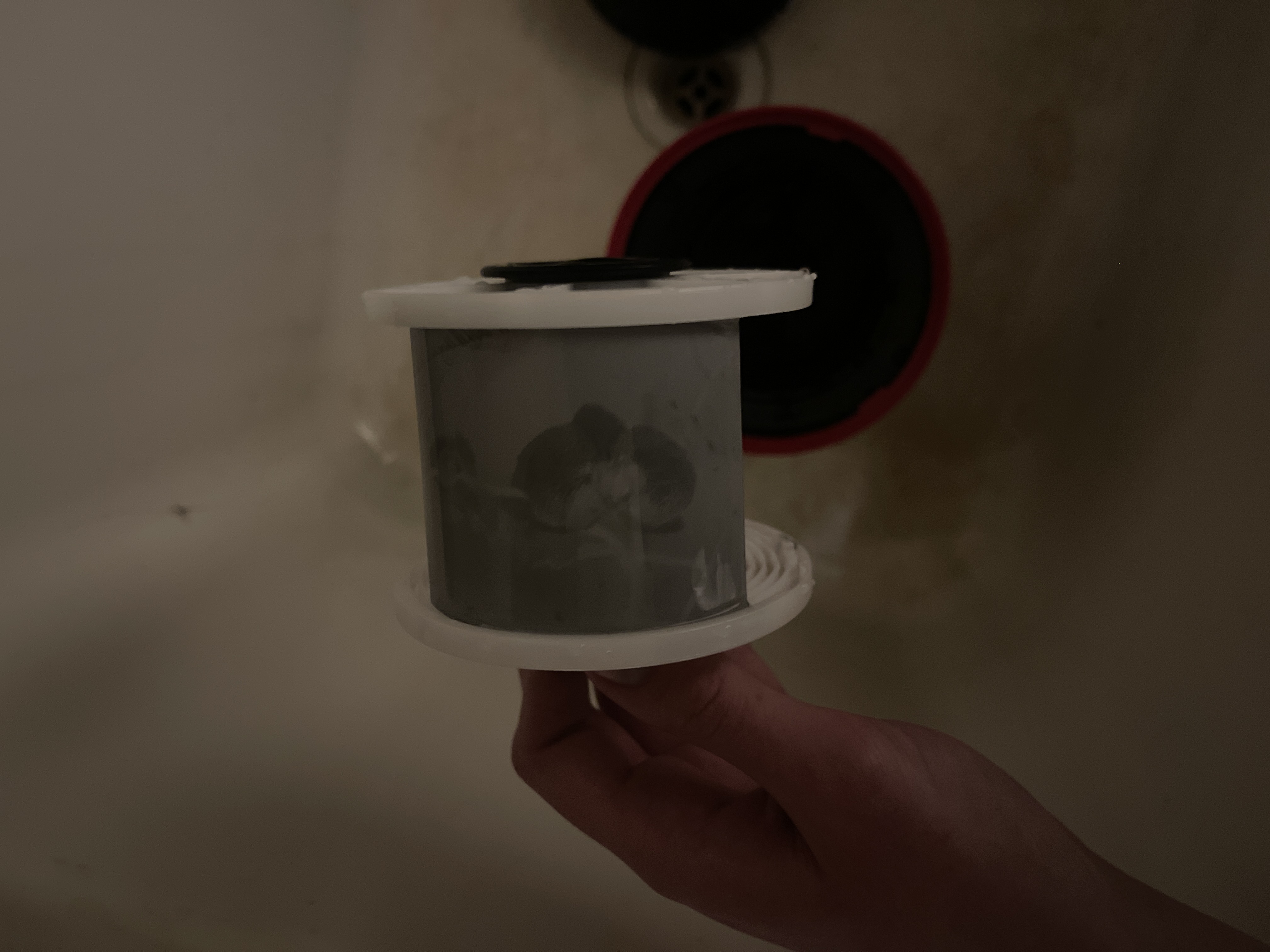

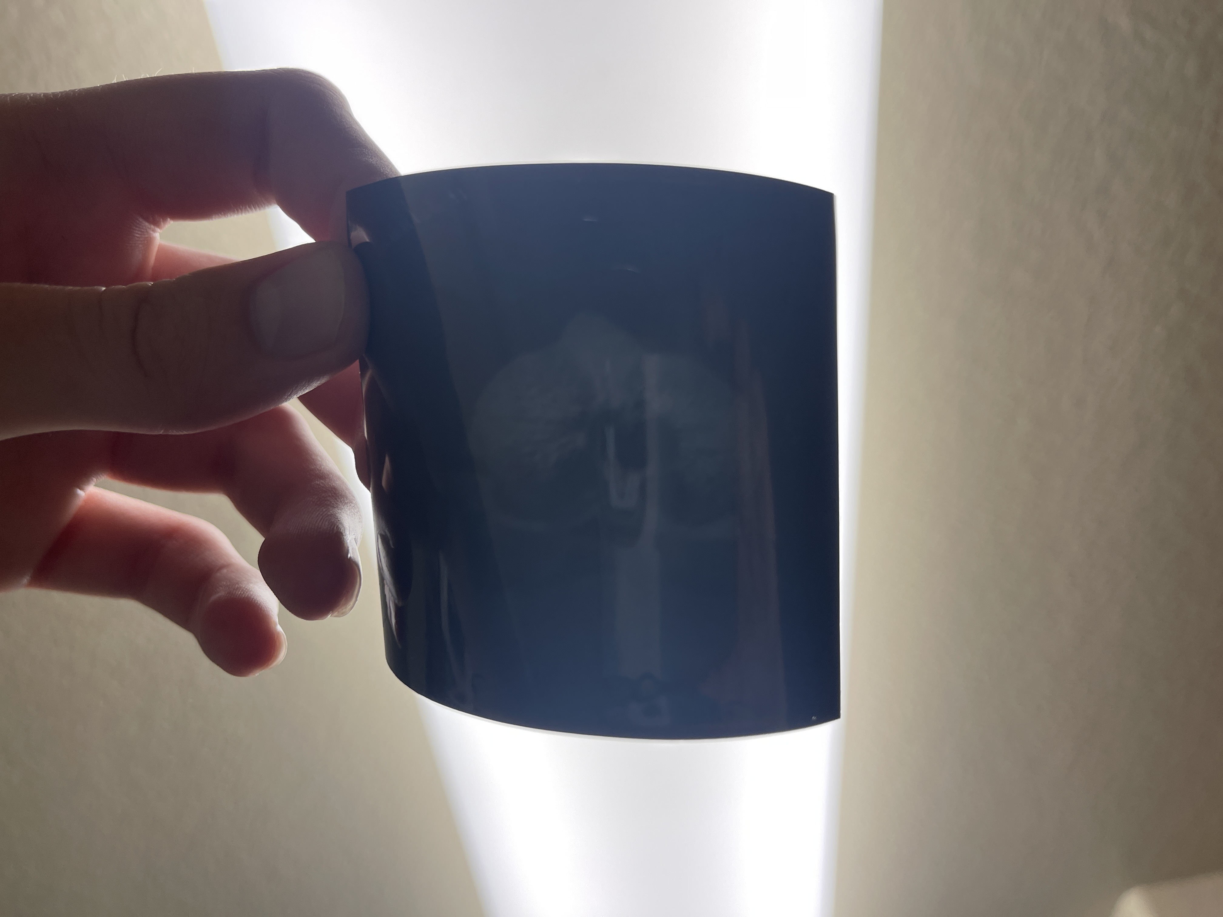

Well well well, look what we have here!
Still need to work on first dev (24 mins in Dektol 1+2 LOL), and it could probably do with a stop of over-exposure compared to box speed, but this is my first passable positive!
On a side note, this slide is almost impossible to see unless held up to the light, is this normal?
