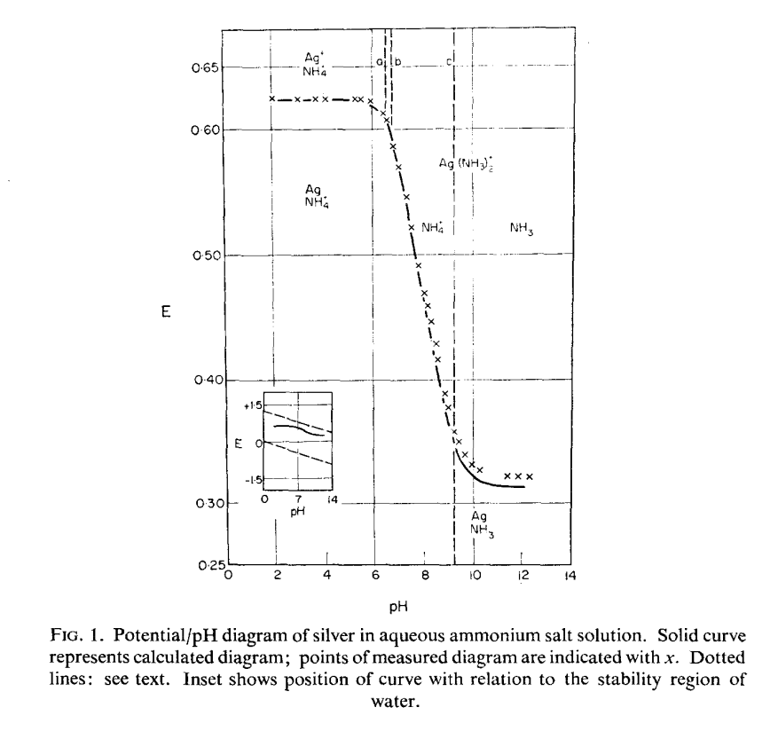

I poked a bit into this topic (Silver Chloride soluble in Ammonia but not in Ammonium Chloride), and discovered the reason for this effect: Silver will happily complex with NH3 but not with NH4+. The shift from the latter to the former happens somewhere between 8 and 10, and most likely neither the Ammonium Chloride, nor the Ammonium Sulfite bath had that high pH.
Since Ag+ has a different redox potential than Ag(NH3)2+, the shift from one species to the other can be easily seen in this chart.
If anyone wants to repeat the test with Ammonium Chloride or Ammonium Sulfite, then a high pH must be dialed in. Sodium Carbonate should do the trick. Since Ammonium Chloride brought up to pH 10 will have the same awful smell as Ammonia, this is really only worth it for people with a near infinite source of some ammonium salt.
Thank you! I really appreciate this detail level, it helps a lot. The chart really helps. So indeed if I had not dumped out that solution I would just add some carbonate and see what happens. Next time. I am now personally reflecting on what the heck I would do with 25kg of ammonium chloride! Between that and the sodium thiosulfate you have a lifetime supply of good fixer.
