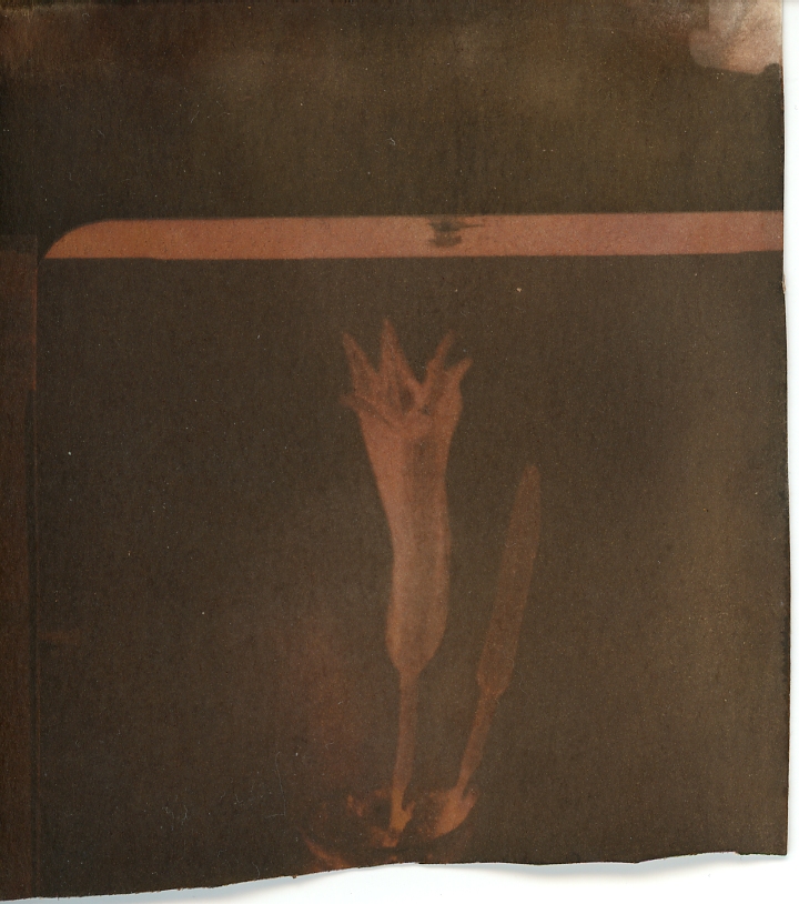

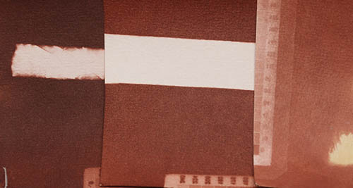

The variation I get is pretty wild. Here is the same paper that I tried during the las couple of weeks. If that's the normal sensitivity of the process to humidity/temperatue/coating then it is unusable and I should give up. But maybe it something else.
I built a special exposure unit for cuprotypes that gives 15 minutes exposure and every time I intend to throw it away I think maybe I should still experiment a bit more.
.View attachment 360494
Never seen such significant variation between test strips processed under identical conditions - unless I deliberately changed the chemistry or processing - within a short span of time. I can't pinpoint what is happening with your process from far so I won't conjecture on what may be happening in your case. I doubt if this process is particularly more or super sensitive to process variables than others out there. @fgorga has printed far more than I with a series of prints, may be he will be able to tell you if this much variation is normal with this process.
'Just printing' rather than focusing on super DMax and nailing 100% reproducibility might serve to bring some enjoyment back into the process for you. Build up a collection of suitable negatives over time and print a subset each time you have a coating session. Not every coating or print will be acceptable but eventually you're bound to produce some prints that are exceptional.
I'd rather have a bad print of a negative than a step wedge with good DMax 😀

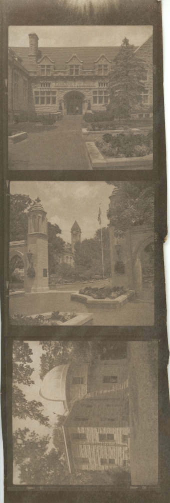

I mixed 25mL of sensitizer and gravity coated it onto some canson watercolor. No proper exposure unit or sunlight, so I used a DLP projector's blue channel to contact print a 4x5 positive into a paper negative.
Inversion and scan of the toned print.
I've got 3 more sheets of this size but the lack of a proper UV source is a pain. There was probably a stop of density lost to underexposure here.

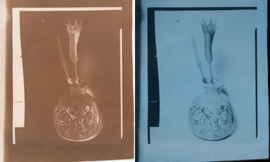

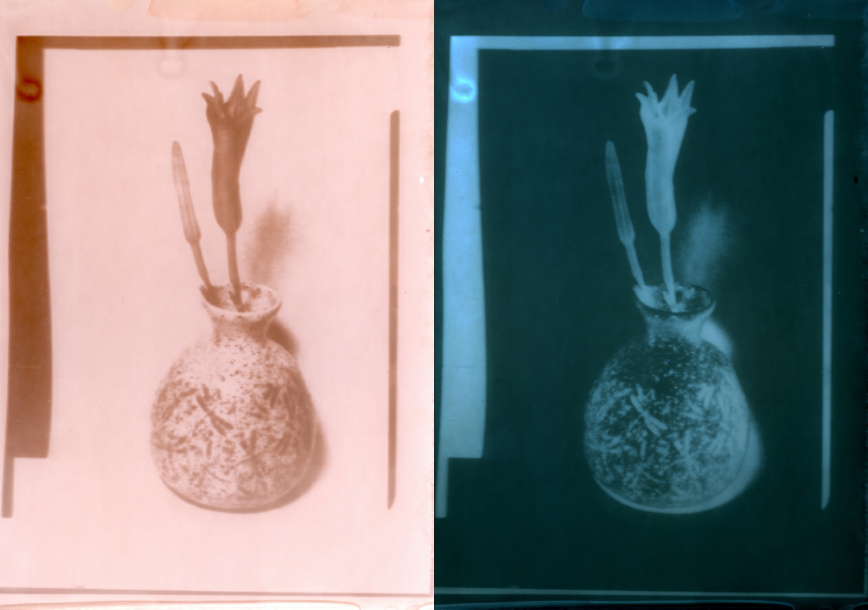

Same paper (a day old) but with a thinner positive (+1 stop) and a more powerful exposure of 45 minutes (240W DLP @ 12 inches; but surely the micromirrors and UV coatings make the effective power much lower). Probably a bit over-exposed here, though.
Since the original bit of film was a positive, I've included the inversion of each print scan for reference.
Scan directly after exposure (no washing)
Scan after washing and toning in CuSO4/Citrate/Ferricyanide
I'll probably snip off the bottom edge and give some 2nd toner experimentation a try.
Very interesting. Could you not use a blue digital negative straight from the computer and project it to get it to print?
:Niranjan.
I used a white screen as a 'dumb' light source for contact printing the above. I've gotten good results with cyanotype & salt prints in the past with direct digital projection but haven't tried it with a cuprotype. It should work, in theory.

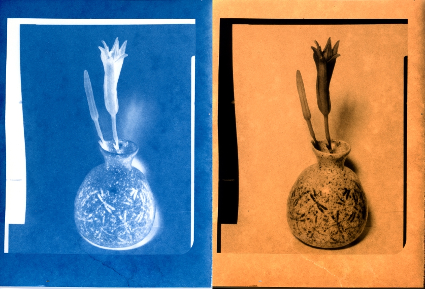

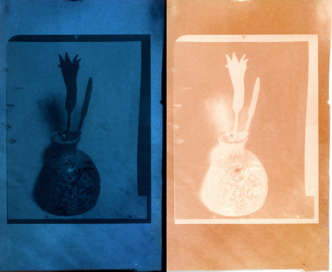

And just for comparison, an untoned 'new' formula cyanotype of the same positive, same paper (but acidified), ~30 minute exposure.

One more quick example this evening to use up my last scraps of coated paper.
After simple ferricyanide toning, rinse, and optionally drying; immerse the print in a *very* dilute solution of silver nitrate for several minutes and rinse well. Mild bleaching of the image occurs but will be developed back in the next step by immersing the print in a *very* dilute film/paper developer.
The silver seems to prefer the copper compounds and will develop out to some extent, altering the tone of the image. It didn't help (or hurt) with contrast in this case but a lot of that is down to choice of some random 6x6 negatives.
(both unedited scans)
I had earlier chopped up the first print (from post #105), tried this, and got much more speed, Dmax, and highlight fog. These are from the same coating batch so it goes to show how some subtle variations can produce interesting results.
You are basically replacing copper with silver making silver ferrocyanide which on develop gives silver image. Interesting, but a longer way to get a developed out salt print!
:Niranjan.
Yep, it is likely a combo copper/silver image at this point. The silver treatment was very mild so most of the copper image remained. This doesn't appear to work with the 'complex' toner which perhaps points to better image stability. I wonder if the residual silver in used fixer might show a similar effect.

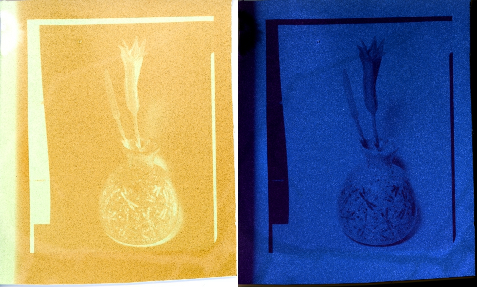

Printed via projected digital negative of the cyanotype above; simple toner.
Unadjusted print scan & inversion.

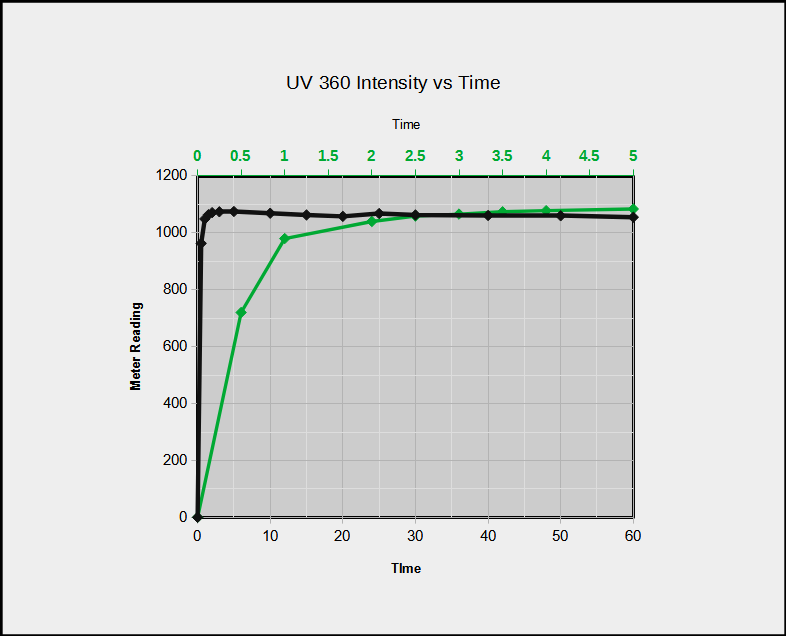

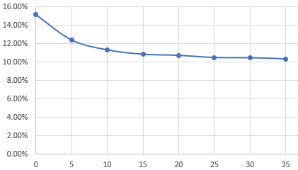

I bought one of these in the 365nm flavor. Then I measured what is happening to the intensity (with a UV meter I have measuring primarily at 360 nm) as you turn on and found that intensity decreased drastically losing about 50% within about 15 minutes. at which point I stopped. The unit also became burning hot in the back.
Because I have a UV meter hooked up to my light source anyway (I just never use it...), I figured I could also track the actual UV output of mine. Heres what the plot looks like:
It's fairly consistent to your findings, although the light loss is only around a third of the initial output. After about 15 minutes the output has settled mostly.
Like yours, my unit also gets quite hot, but I don't mind. I've been using this particular setup quite intensively for months now with exposures lasting up to 45-60 minutes. It works very well; I'm quite happy with it.
I am sure if I had used a fan directly over it, it would have changed the amount of drop off. Perhaps my unit just didn't have adequate cooling features. This is how similar measurements look like on my unit with 18 CFL spiral BLB bulbs in a 12x16 space fitted with one of those computer exhaust fans.
The green line is for warm up where it shows about 4 minutes or so (top x-axis) is enough to come to a plateau. The black line (bottom x axis) is for readings after 4 minutes of warm up followed by 5 minutes of rest. This would be important if the exposures are in the range of 10 minutes or less. For longer exposure perhaps the initial period is not that material.
:Niranjan.
I think your curve comes from amalgama heating inside the cfls. I'd give it a couple of minutes for mecrury concentration to stabilize.
The led units I posted are pretty bad inside. There is like 5cm blob of glue for 20x25 board. That the only spot of contact with casing. But still fan seems to lower its temperature. I think when I mount pcb from these lamps onto a metal palte I can improve thermal contact(more thermal paste) and thus improve external cooling.
