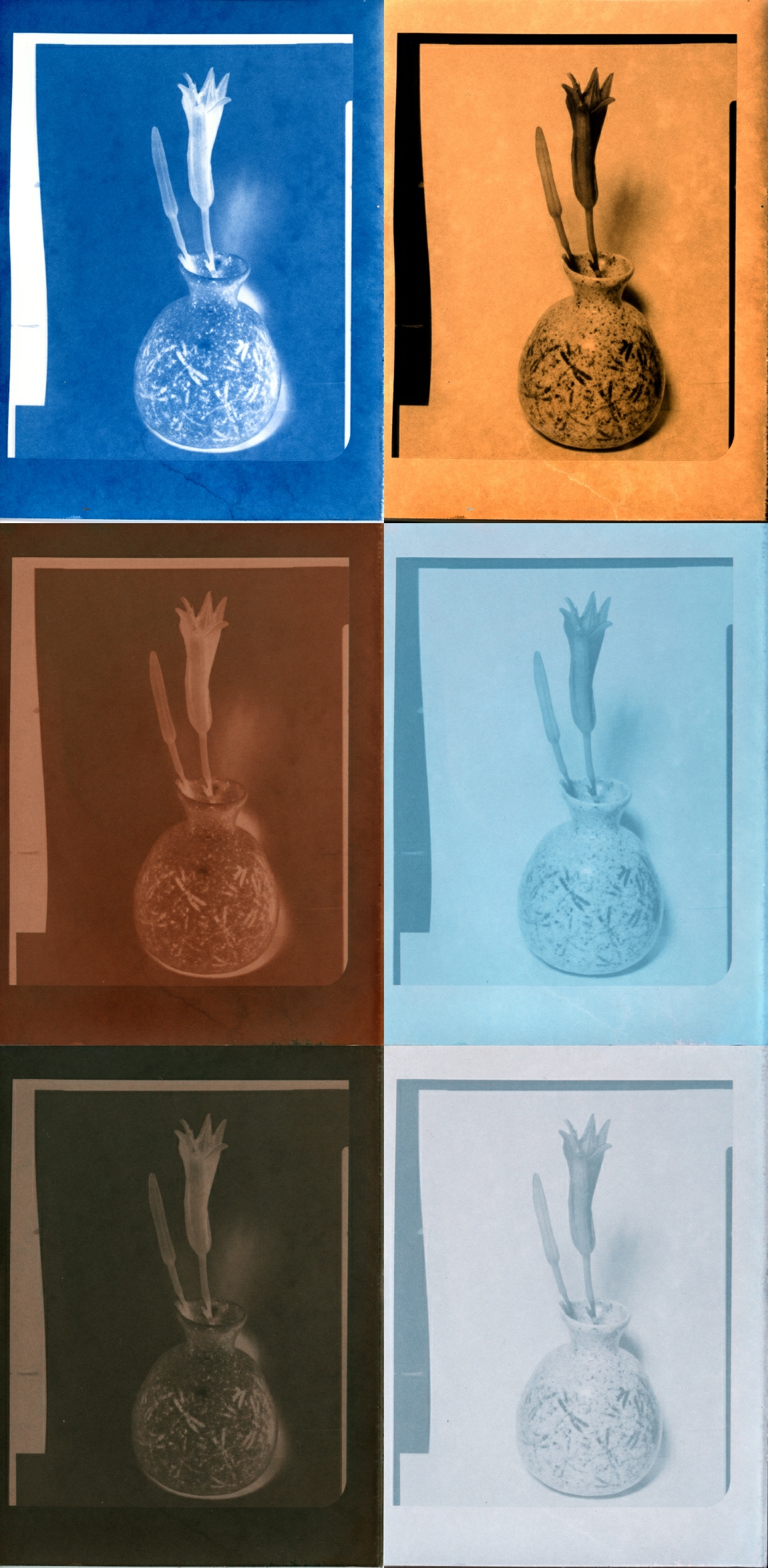

I sensitized the cyanotype from the previous session, re-registered the positive, and re-exposed it. The cyanotype blue survives the initial coating but is gone by the end of exposure. Presumably the existing pigment is being donated to the cuprotype, perhaps contributing to density. Washed, toned in 'complex' toner, washed, and finally iron toned. Instead of the listed formula, I concocted something using ferric nitrate, sodium chloride, sodium sulfate, and muriatic acid. The toning effect seems similar.
Top to bottom: original cyanotype; cuprotype overprint, complex toned; previous plus iron toning
The results would have been pretty magnificent had the highlights remained clearer after the reprint & first toner. Mystery fog... perhaps chemical or even just simple overexposure. As with any print 'it looks better in the hand than on the scan'.
The paper is holding up very well so I'll try to see how many processing cycles I can put it through before it's totally wrecked. Fun stuff 🤓 ⚗️

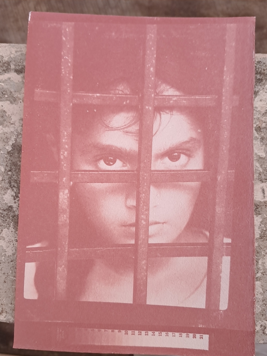

One more round of silver intensification and iron toning. I'll probably seal the print at this point and look into surface treatments. Adding a bit of gloss would be nice.
A first attempt on Strathmore cold press watercolor 500. half-frame 35mm -> 4x5" projected digital negative; complex toner w/ citric acid, iron-toned; auto-corrected scans.

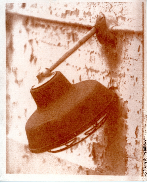

dear All,
As we finally had some sun again, I have some developments where I get some positive instead of negative with help of the Copper Sulfate. Be it probably more a fill in of the underexposed part reversing to stand out.
I have put this print in FeSO4 and then the copper part darkens. I probably should have tried first to bleach to remove the Prussian Blue first. Picture taken where it is still in the washing water.
The print is now drying I will add tomorrow the result.
Some details
FAC+Tartaric+Copper Sulfate as emulsion layer
Short exposure 20 minutes
development with
Ferricyanide+ Tartaric acid - brushed on exposed print
size A4
note: this paper was coated 8 month ago and still working fine
After exposure before development
Anyway, Copper Sulfate with Cyanotype stays interesting.
Regards
Jan.

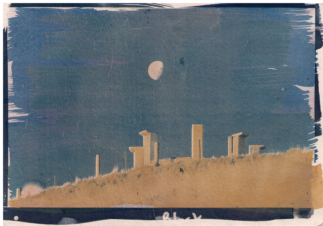

I got interested in cyanotype a couple of years ago as an alternative, fairly safe, simple, and affordable way to do something a bit more arty with my photos rather than just have them sit on my PC.
I know a bit about chemistry, and knowing that silver is what is used for traditional photography, wondered if there were any other transition metals that are photosensitive, and that led me to the alternative photography website. Turns out there are a few, but either they're expensive, toxic or both, but cuprotype caught my attention because it's cheap and fairly non-toxic.
The yellow and pink results interested me, as I can't get those so easily with cyanotype - well yellow to an extent, but the other toned results are not so different to what I could achieve with cyanotype.
What really interested me was the possibility of combining processes to get duotone or more in a single image.
Looking at the yellow and pinkish red, of cuprotype untoned or toned with KFeCN and knowing that I can tone cyanotype to get a reasonable black, I wondered if I could make CMYK images.
I've enjoyed experimenting with toned cyanotypes and that extends the range of possibilities, but they're still monochrome. I've hand coloured a few using watercolour pencils or paints, but though lightfast, since they're watercolour, they're not waterproof.
This isn't ink, it's photosensitive chemistry, and I think I read here or on alternative photography that order matters, as cyanotype chemistry applied over cuprotype can convert cuprotype to cyanotype.
Here's an effort made from 3 separations:
Black: Cyanotype toned with instant coffee for about 5 minutes. Gives more of a blue/black than true black, but I found it stains the paper less than other toners.
Blue: Traditional cyanotype
Yellow: Untoned Cuprotype using CuSO4, FAC, Sodium Thiosulfate recipe.
I deliberately brushed the layers on a bit irregularly, as I want more of a painterly look than a 'perfect' reproduction. I have an inkjet for that!
Actually everything is done on a budget. I use an old laser printer someone donated to me, and a sheet of glass out of an old fridge to hold the negative in place during exposure - hence the scratch marks on the image, and some blotches from where the printer drum is getting tired.
I exposed in the sun. Being in the southern hemisphere with clear skies and close to the ozone hole, there's plenty of UV around most of the time.
Second image is CMY (I didn't bother doing a black separation)
I did cyanotype first, then cuprotype and toned it with KFeCN, then finally cuprotype without toning.
I realised subsequently after reading here, I should have washed longer to remove residual unexposed cuprotype chemicals, and I'm not sure whether the CMYK separations in Photoshop are ideal for this and whether there's a better way to produce negatives, but at least I've demonstrated that the principle works.
Also, I suspect the cuprotype emulsion ends up toning the cyanotype, so I'm not sure if there's a way to retain a blue sky.
I was careful to select images where there was clear separation of colours in different parts of the image so they'd be more likely to work.
Image below is a cherry tree in blossom on a grassy hillside, so it actually was pinkish. The top image had dry grass and the structure actually is golden yellow.
Certainly not photorealistic colours, but I still like the aesthetic, and will keep experimenting.
I'd be interested to know if anyone else has tried this kind of process and what sort of success they've had.

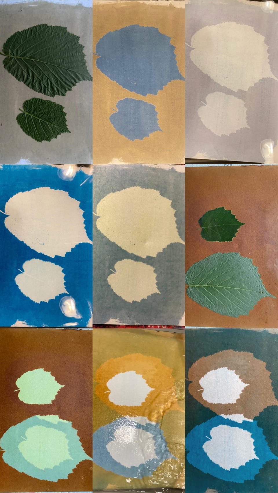

Just a test to see if I could combine the Cyanotype and Cuprotype, I did a while ago.
Size A5
Paper Clarefontain 250gr aquarell
I have started with the Cyanotype, normal mix of 2:1 FAC + KFerri and 10ml of dest water
Exposure 20 mins of UV light Top row and developed is pict nr 4. and dry
then add the layer with the Cuprotype mix based on the Hypo formula
2:1:0.5 FAC + Coppersulfate + Hypo in 10ml of dest water.
I weight the chemicals and add all together then add the water and put in the sonic bath to quickly mix a small batch of emulsion.
Adding this on top of the Cyanotype. I noticed it bleaches the cyanotype. (pic 5)
expose in UV light for 40 mins (double the cyanotype, just a guess)
Develop by first rinsing in tap-water picture 8
Then put in a bath of 1:1:1 KFerri + Kferro + Tartaric acid . I used 3gr of each + 150ml of dest water.
This brings suddenly back the Blue and brown-orange color. It looked amazing when wet. When dried it looks like picture nr 9. More muted but very intense colors.
I was surprised about the whites, they seem not to get any of the staining from the coppersulfate with this.
I have tried to do this with some printed negatives but it needs a good density.
cheers Jan.

Here is another version along the lines of bromo-cuprotype but more closely aligned with Jim Patterson's 2007 cuprotype that used ammonium thiocyanate as the developer. If you recall, the original cuprotype sensitiser contained only FAC and copper sulphate. Ammonium thiocyanate couldn't be added to this sensitiser as a precipitate forms upon addition and hence a separate development step involving thiocyanate is needed. It turns out that with a modification, a cuprotype sensitiser containing thiocyanate can be prepared without precipitate formation:
Water: 5 ml
Copper sulphate: 0.5 g
Trisodium citrate: 2.5 g
Ammonium thiocyanate: 0.5 g
Ferric ammonium citrate (green): 1 g
Dissolve the ingredients in the same order as above. Use ~2ml to coat A4 sized paper. Expose for 2-3 times longer time than Jim's 2007 Cuprotype. Develop in dilute citric acid solution. Wash and tone in potassium ferricyanide.
I made only a few test prints and but the sensitiser works well. I also tested sodium tartrate (tartaric acid + sodium carbonate to be precise) in place of trisodium citrate and that also works. Both citrate and tartrate form a complex with copper(ii) which prevents the formation of the precipitate. Upon exposure to UV light, copper(i) thiocyanate is formed which when developed in ferricyanide forms copper(i) ferrocyanide.
I don't find any significant advantage of this sensitiser over Jim's 2007 Cuprotype, except for the obvious reduction in the amount of Thiocyanate needed.

Results from this variant are very similar to what one gets from Jim Patterson's 2007 cuprotype.
Here is a test print. I would have liked to give it a bit more exposure but judging the adequacy of exposure from the print-out during exposure is rather difficult with this process as copper(i) thiocyanate is white/pale grey in colour.
Nice work, Raghu. Sodium citrate to the rescue!
You said exposure was 2-3X Patterson's original method - how does it compare to hypo-cuprotype?

Thank you for sharing, looks like a nice brick-red. I was wondering if you would use a rinse of the Kferri-Kferro bath on it like I did in the post above for the multi color example, if it would clear the whites. (bath of 1:1:1 KFerri + Kferro + Tartaric acid . I used 3gr of each + 150ml of dest water.) and intensify the darker parts. I guess it would become more darker brown for the parts where it was exposed in that case.
Copper stays very interesting.
Tartrate can also be used and is what John Mercer used in his photographic experiments in 19th century to prevent Thiocyanate from formin a precipitate with Copper(ii). :smile:
I have not printed hypo-cuprotype in recent past. I am thinking of doing a comparitive test of all known (to me) cuprotype variants but it will have to wait till October or later. Vincenzo Caniparoli has a couple of new variants and I have seen very nice results from his processeses on his FB TL. But I don't have access to details of his processes yet.
That's an interesting idea though I'm unable to fathom what ferricyanide and ferrocyanide do to reduce stain. However, tartaric acid could potentially help as it is copper chelate. I didn't add dichromate as restrainer in the sensitiser and on hindsight I should have.
For intensifying, in a different test, I have tried developing in copper sulphate + tartrate + thiocyanate and it seems to work (sample size = 1). But I didn't do more tests because developing in a thiocyanate broth defeats the purpose of adding thiocyanate to the sensitiser. 😀 Your idea of toning in ferricyanide + ferrocyanide + tartaric acid could potentially help if the plain ferricyanide developer isn't converting all copper(i) thiocyanate to copper(i) ferrocyanide. John Mercer used ammonium chloride with ferricyanide in his experiments to convert copper(i) thiocyanate to copper(i) ferrocyanide. That could be another avenue if I were to redo this experiment again.
