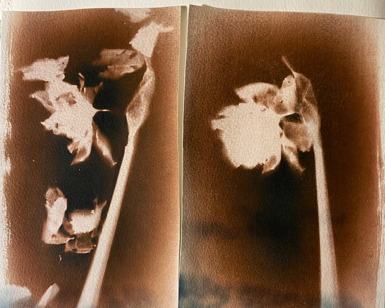

I exposed here some flowers and the top one is the oiled paper-negative previously used for the FerroBlend. No new oil applied.
Exposure with UV 365nm flood light direct on top of the glass for 10 minutes.

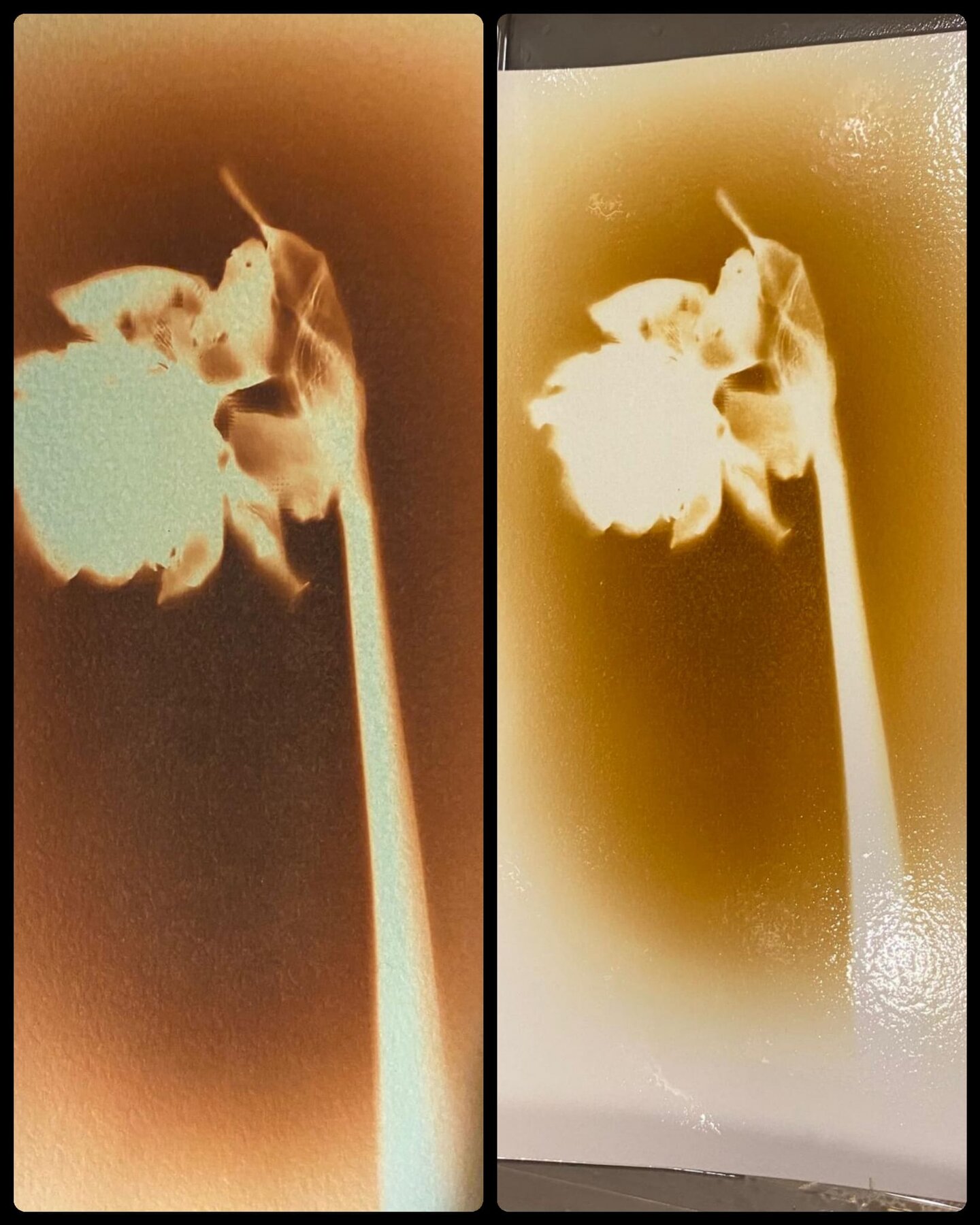

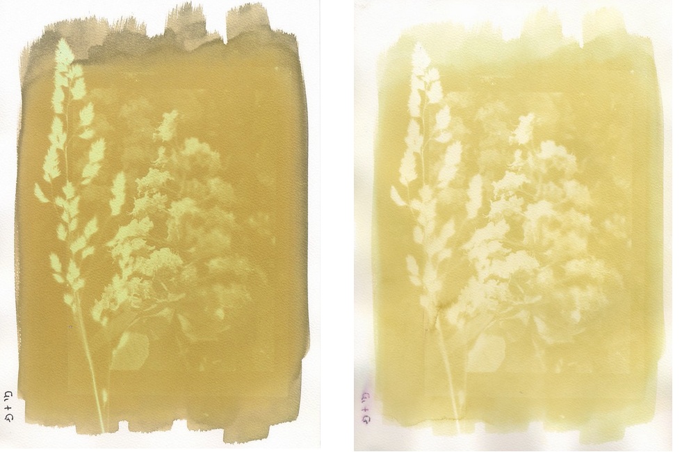

Interested by the pfd by Vincenzo, I wanted to do some quick tests, to see if we have a process only reacting with the paper fibers or a solid forming somehow. I wanted to make a strong solution and keep it simple for my test. I think my initial recipe was more 2gr FAC 1 gr copper sulfate and 0.5 gr Thio. So for now reason I took above. Just made sure I noted it down. For the tests I used a UV Floodlight direct on the glas, so exposure is between 7-10 minutes only then. I tried to get an idea first with some tests and the UV flashlight, but noticed the sensitivity is very low, probably 5 - 10 times less than normal cyanotype with this recipe.
Having some samples thereafter, I noticed Vincenzo mentioned that after exposure the color should be dark brown when it was a solid forming. He seemed to have found that is not the case. So for that reason I added my samples from after exposure and after wash in that post.
Then the "development" with K-Ferri + K-Ferro mix solves the problem of the clearing. The print will develop in the dark chocolate brown, the whites will be almost stay white. (same as in the 2 color example I posted in this tread earlier)
