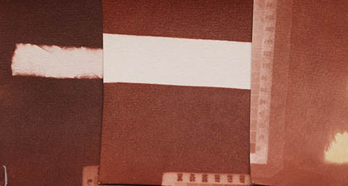

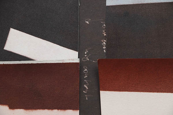

I think it is the coating-exposure step. After exposed sheet comes out it is either lighter or darker mustard. Then it is mostly consistent. Darker yellow images tone to darker brown and lighter to more washed out brown. At this stage I don't even have to do the first toning step to tell how it will turn out, it is already clear from the freshly exposed image.
I was thinking of buying new batch of copper sulphate and sodium thyosulphate. Not sure if it makes sense from chemical standpoint but it's cheap to try.

I have test strips. Lower left is sucessufful coating, after cu-kfecn toner. Above is it but partly toned with iron toner (nmp's recipe). Lower right is less sucessuful batch, but when toned with iron toner it is still pretty dark (upper right image). Middle is VDB. It is hard to judge absolute values by photo, in real life differences look more striking. VDB level is achievable not even with my best coating.
I don't like the idea of partial toning, but I think it is manageable if I tone the whole series in one batch, like we do with cyanotypes and herbsl toners. If I could achieve the lower left level of hatchet's brown consistnely I wouldn't even bother with second toning.
I also tried iron toning after simple kfecn toner with little luck. It does not wash properly of my papes staining highlights blue after iron toning. And the overall tone is sort of dirty and washed out. So I'd stick with cu-fecn and optinally iron toner after.
As I understand longevity of iron toned cuportypes is not studied, while for van-dykes we now for sure that they fade. Both options of getting brown are not perfect. I think Jim Patterson wrote somewhere that his cuprotypes look fine after 10+ years, but he probably meant those without second toning.

Looks like you are getting fairly good Dmax's, particularly the iron-toned ones.
Regarding reproducibility, like all other alternative processes, some more than others, many factors contribute to the outcome so we try to control them as much as we could. Like humidity, temperature, concentrations, freshness of the ingredients etc which are of day-to-day variety. Even how much liquid is brushed on will make a difference. Lot of practice is needed I guess to be consistent in the brushing (or rod coating) technique. Frankly, I don't trust drop system of adding various components - I use weights. It is not as convenient but considering I have a tendency of forgetting the count halfway, it works better for me. For humidity control I always equilibrate my paper at least overnight in a saturated salt chamber kept at 78 C and keep the sensitizer components at the same temperature because my work area conditions are at the mercy of seasonal changes.
Also, regarding iron toning, what it is really doing is making cyanotype out of cuprotype (or copper toned cyanotype) so longevity presumably would be expected to be no different from a regular cyanotype.

The variation I get is pretty wild. Here is the same paper that I tried during the las couple of weeks. If that's the normal sensitivity of the process to humidity/temperatue/coating then it is unusable and I should give up. But maybe it something else.
I built a special exposure unit for cuprotypes that gives 15 minutes exposure and every time I intend to throw it away I think maybe I should still experiment a bit more.
