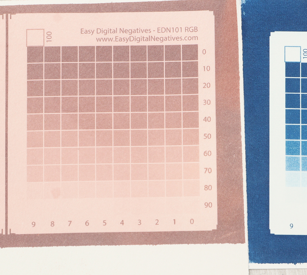

I have attached stepwedge for paper with less staining. Toned in KFeCN an then in citric acid. Compared to cyanotype (right) it is quite pale.

That does look rather weak...don't know what to say. Paper is an obvious variable, with everything else being more or less the same. In my experience, the un-buffered papers seemed to give higher Dmax. If you have one of those, like COT320, or Hahnemuhle Platinum Rag, etc. you can try and see if there is improvement.
The other thing that helps with the Dmax is adding copper sulfate to the ferricyanide toner which gives greater density of copper ferricynide than using potassium ferricyanide alone (however the boost of density in the subsequent acid treatment is more muted, higher hypo formula works better in that case.)
You can also replace citric acid with sulfamic acid which in my experiments gave higher Dmax.
Finally, are you exposing it long enough? Is this Sun exposure or you are using an artificial source? You said after 1.5 hours, you still saw difference between OHP and non-OHP areas. Perhaps there is room for improvement there. 1.5 hours is already pretty long, though.

The stepwedges I attached are on Canson XL.

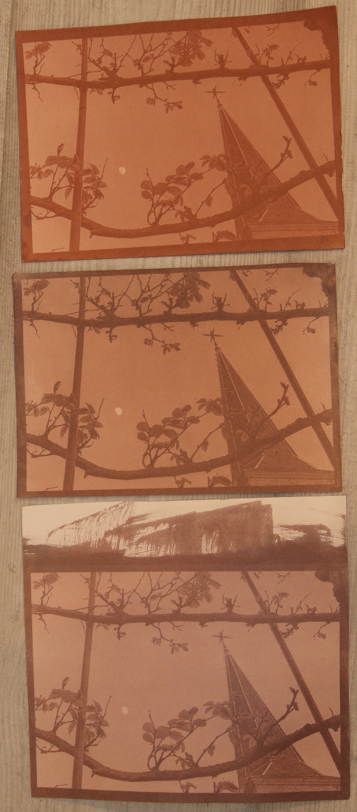

Today I have tested the last paper I had. Canson Graduate. Unlike most other papers it soaked in sensitizer like crazy, it was wet not even for 20 seconds so I am not even sure I could coat it well. The test print for Graduate is the lowest one and a lower right corner of the frame looks reasonably dark. Upper two are Canson XL with and without citric acid (and I think different sides of paper). For the last one I used quite a bit of polysorbate - 3 drops of 10% solution per ml. If I can reproduce that level of blacks on Graduate I think it is workable. Also you can notice that difference between coverred and uncovered parts. This is because I calibrated exposure for other papers and not Graduate. And the sky is lighter again because I used correction curve for XL.
In reality darks are not extremely dark. Maybe slightly lighter than they look on pictures. I do not have a scanner, this a photo with automatic exposure metering. The stepwedge I posted before might have been slightly overexposed. But still it is clear that compared to cyanotype it is pale.
I use the same 2% solution of KFeCN for all test because I don't have much of it at the moment. I am thinking maybe concentration should be increased.
When doing citric acid toning I noticed that it does not make darks much darker, it is more of shifting hues.
Unwashed exposed prints look quite dense. Then during washing half of this density is washed off, even for Canson Graduate. If it wasn't I think darks would be very good. So maybe I should look for papers that soak more sensitizer.

The passage I have quoted from your latest response suggests to me that this is a paper issue. As @nmp (I think mentioned above) the light sensitive chemistry needs to soak into the fibers of the paper far enough that it does not wash off when processing but not too far so that it cannot absorb light during exposure.
Adding some surfactant (Tween-20) can help with the first problem but it can also make the second problem worse. There is no way to know what works best for a particular paper except by experiment.
When I have similar issues with either a new paper (and a familiar process) or a new process (and a familiar paper), I usually don't bother try and troubleshoot. I simply move on to a different paper.
All of that said, I was unfamiliar with "Canson Graduate" paper and so looked it up. Which paper are using? Canson Graduate seems to be a group of papers two of which (the watercolor and the mixed media) might work and two of which (the sketch paper and the drawing paper) I would not expect to work. The reason I say this is that the first two are designed to work with wet media and thus might have the right balance of absorption properties. The second two papers are designed for dry media (pencil, ink, charcoal, etc.) and are likely to be way to absorbent for alt processes without further treatment (but lets not go there right now!).
The other 'problem' with these papers is that they are inexpensive, beginner papers. Nothing wrong with that but in my experience such papers are not generally suitable for alt process printing. Too many 'shortcuts' and additives used in making inexpensive papers just seem to interfere.
In general, I try to stick with rag papers or papers that have at least 50% cotton content. Such papers are much less problematic with alt process printing.

Actually the 3rd one doesn't look too bad. As @fgorga said, if the paper is too absorbent, and the sensitizer goes too far down in the paper, there is a loss of Dmax as well. That's why there is actually an optimum amount - too much then wash off, too little then not enough conversion. One way to counter the issue of greater absorbency is to increase the concentration of the final sensitizer. In this case, you can increase the solids content of the CuSO4 (from 10%) and/or Na thiosulfate (from 10%,) then adjust the amounts added in ratio of the 50% FAC accordingly. Thicker solution should stay closer to the top and also provide greater reactant spatial density giving rise to higher Dmax. Up to the point when the wash-off mechanism takes over, that is. Of course, you can also stop adding the Tween 20 in such a paper.
The other recommendation I would make is that you can use brushing for ferricyanide toning instead of dip toning if you are short in quantity - with a higher concentration solution, say 20% instead of 2%. But you require a very small quantity even if you apply generously and also, since you would be using it one shot, there is no worry of depleting and replenishing.
