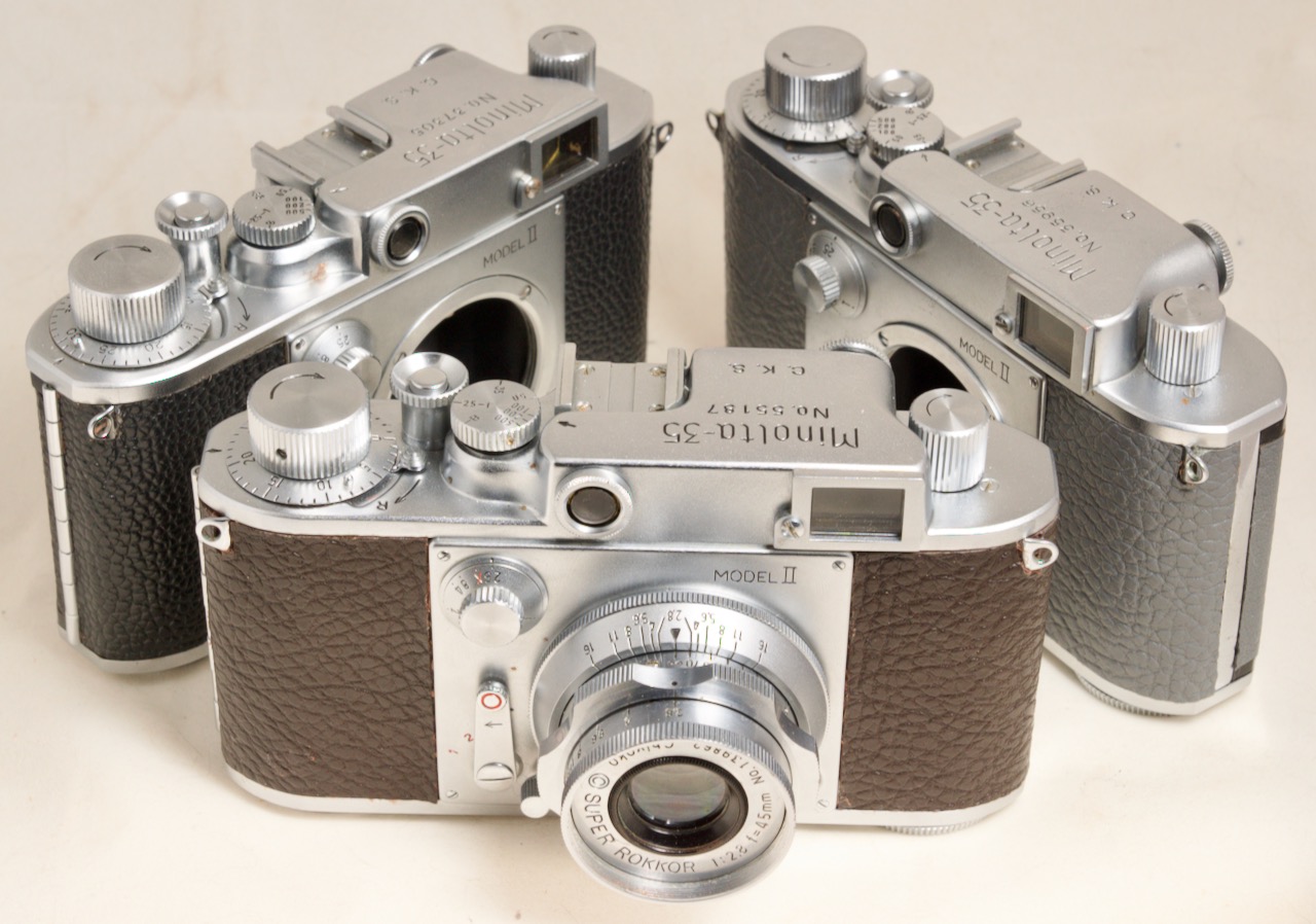

I'm messing with Zorki cameras right now as a learning tool. I picked up a couple jammed Zorki 4s for cheap on eBay and have one working nicely. The second one I got working but I think would need a complete tear down to work well, if then. I decided to part that one out for some bits I need to complete a Zorki 1, so today swapped the nice rangefinder on this one over to the better working one. It is turning into a pretty decent camera now, though that slow speed mechanism is diabolical. Of course that is why there are so many jammed Zorki 4's going cheap.
The rangefinder was even still in adjustment after the swap, though I'll touch up the vertical alignment the next time I have the top off.
I want to make a working Zorki 1 and hope I can pull enough parts from the extra Zorki 4 to make up my missing and broken bits. Either way, it will be a good learning experience and I sure don't need a second Zorki 4. I think the basic shutter mechanism is similar through the range.

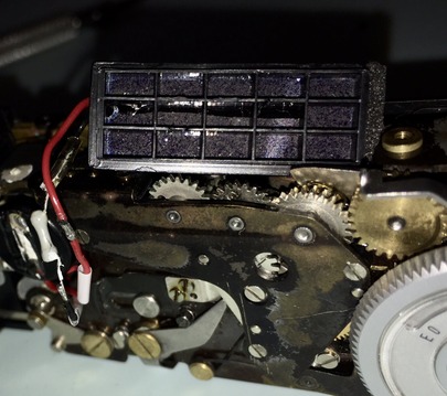

I fixed a "It doesn't work at all" Chinon CE-2, badged as a Sears 2000ES. After cleaning contacts for the ASA dial and exercising the shutter, the light meter came back to life first, then the shutter started working, and then the aperture measurement and autoaperture started working again.
I am waiting on some light seal foam, and I'll finish this one up.

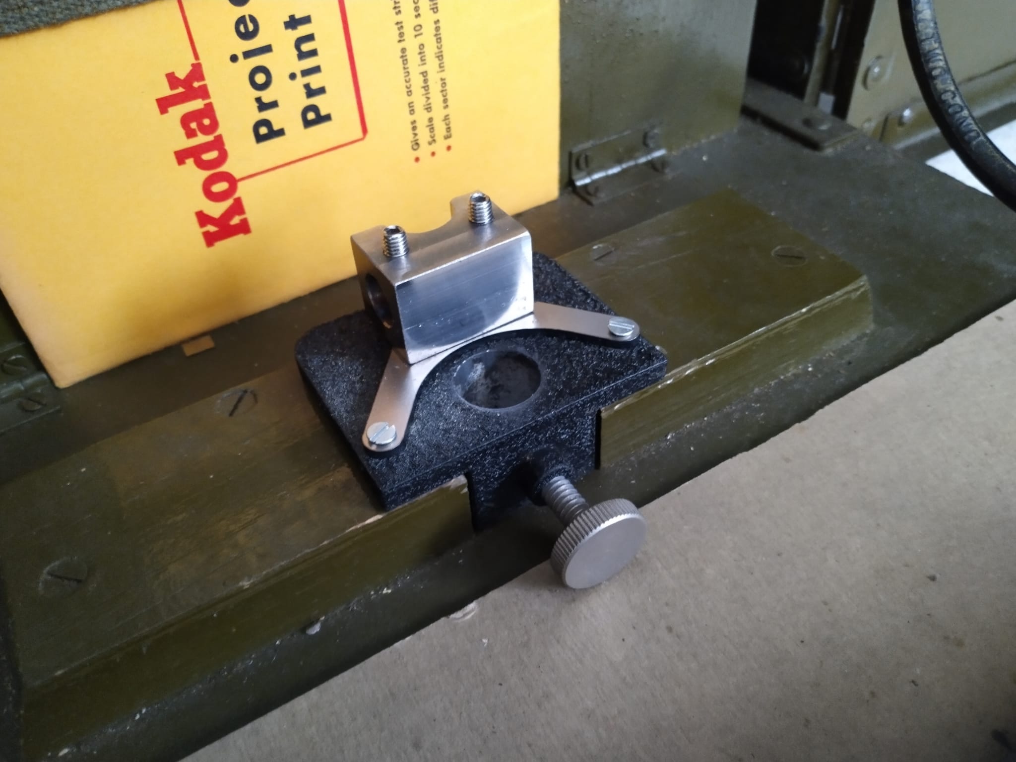

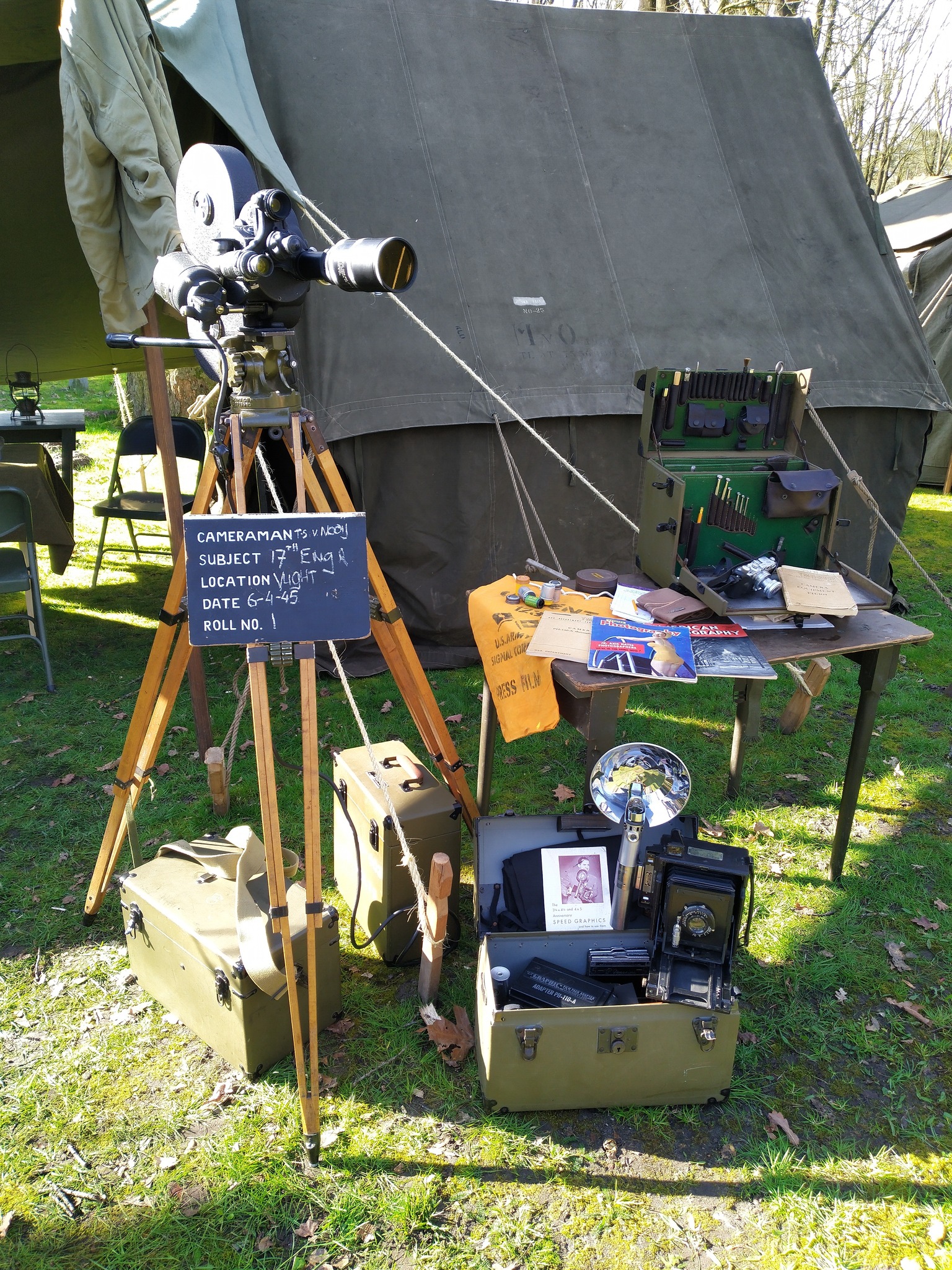

An acquaintance with access to some CNC equipment helped me out, and created this bracket for the copy lights that goes inside my Portable US Army dark room kit.

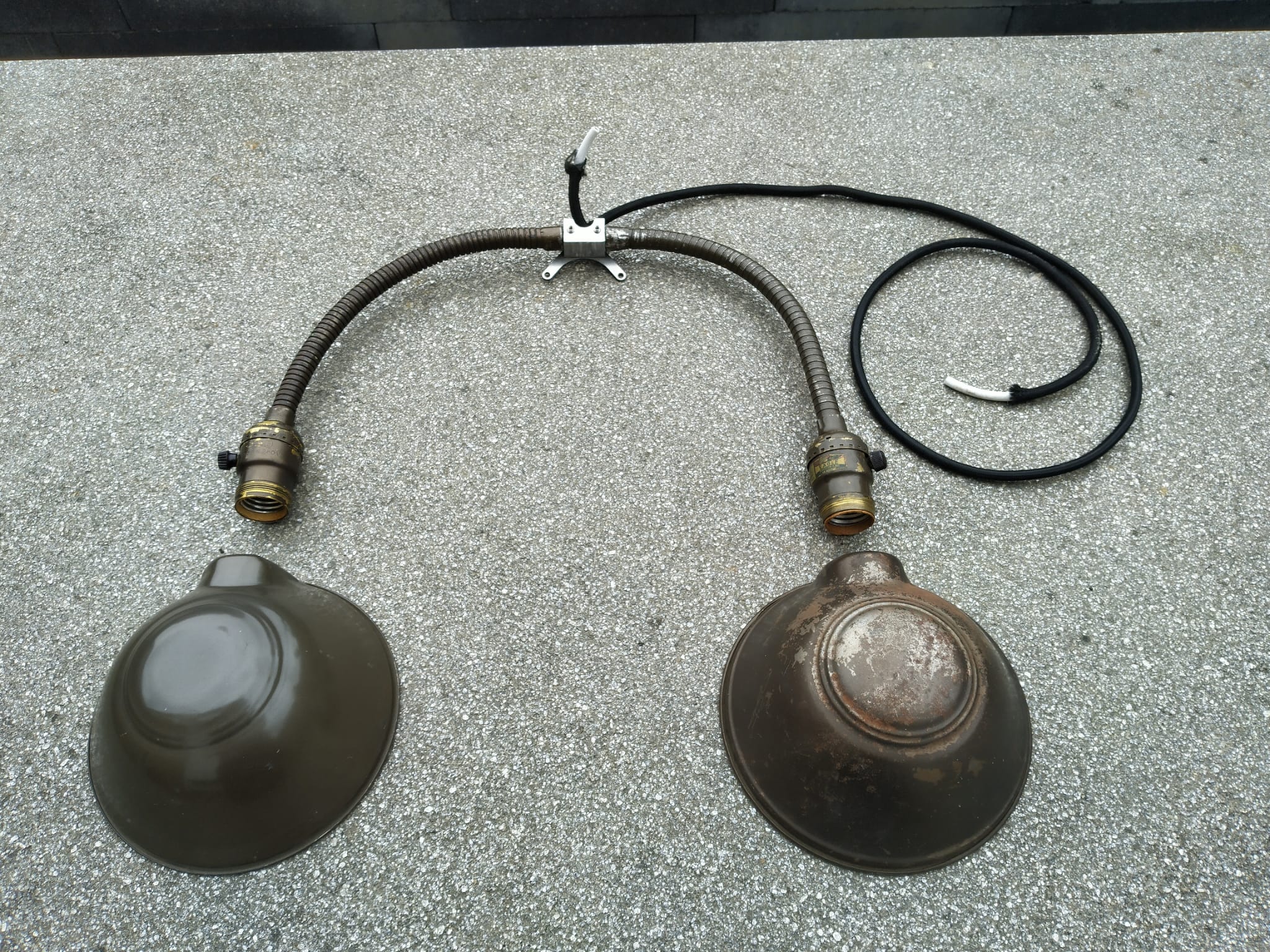

I'm in the process of wiring them up.
It'll get a coat of black paint once done.
Still need a vintage household plug for the other end. In the meantime it'll get a temporary modern one ....until I get round to raiding ebay.

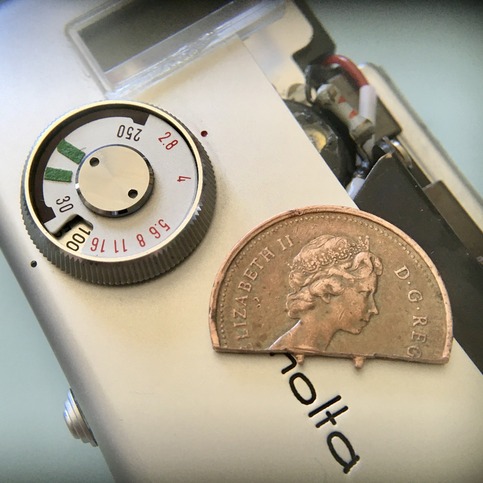

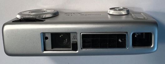

I’ve been trying to fix the exposure meter of my Minolta 16MG, for the past few days, and had to concede. At first, I thought I’d find an adjustment screw but there were none. Then I tested the resistor but the value matched the color code (2.2k ohm) which led me to the conclusion that the selenium cell was just too weak. In a last ditch effort, I cleaned the cell but it changed nothing. It needs to be pointed directly at the sun or else the needle barely moves. Oh well, at least the camera is mechanically sound and can be used even without the exposure meter. I put tiny pieces of tape on the dial to indicate the approximative position of 1/60 & 1/125, cleaned the closeup lens and replaced a seal. Oh, and I found a use for my remaining pennies :D
Note: You have to appreciate the built quality of these little critters, Minolta did a beautiful job.
For those that don't recognize it, that is a $1 CDN coin that @Helios 1984 has re-purposed.
Don't worry - I won't report the apparent breach of our legislation protecting the integrity of Canadian currency! 😄
I took care not to damage Her Majesty's portrait 😇

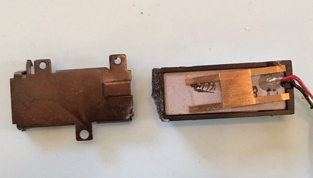

Don't know if this counts as a fix; it feels like a cheat. My Canon A-1 has had a variable fault with one of the electromagnets for the shutter; it held on too tight, so it didn't release the shutter straight away. When I pressed the release, the mirror would flip, then there would be a short, variable delay of maybe one to five seconds before the shutter finally released. When it did release, the exposure time would be correct though.
I tried to clean the mating surfaces of the electromagnet and its metal block. That didn't help, but one of the ways I tried was using the glue on a thin strip of tape; trapping that between the magnet and the block when I cock the shutter. I discovered that with the tape in place, the delay doesn't happen (but it comes back as soon as the tape's removed; so my 'cleaning' didn't help). So I have cut a little patch of tape and stuck it on the little metal block, and just shot a roll and a half of film with no problem. I'll have to check it now and then, to see that the tape and its glue aren't wandering about; but I'm fairly happy with my solution.
I guess the problem isn't dirty surfaces anyhow, but maybe the electromagnet core, or maybe the metal block, has become weakly permanently magnetised. Maybe this is my come-uppance for leaving my shutter cocked for too long?
Not 100% sure for the A-1. But for the AE-1 the Canon engineers had a more sophisticated design. The magnet is permanently magnetized. And the action to release it is to send a current in the winding that cancels momentarily the permanent magnetization. This avoids current drain when the camera is just waiting.
That's mostly correct. The two magnet coils on the U-shaped magnet generate a stronger magnetic power with reverse polarity than the permanent magnet, so that the anchor is released and goes off, the shutter starts.
This anchor is made of soft iron and should'nt remain magnetized - sometimes it does, then the anchor remains unreleased.
Thanks for that, both! Clever Canon. I must say I was already impressed that even with an obvious fault, my A-1 was still exposing correctly.
So maybe now I should worry that the problem is with the electromagnet's coils; maybe they have lost some of their oomph (how? don't ask me! micro-electronic mice have chewed the insulation and left a partial short-circuit?)
I guess whether the problem is a weak coil or over-magnetised metal, there is a possibility that it could get worse and my fix may stop working. I'm happy to have an apparently perfect camera again for the time being.
Thanks again!
Just remove the anchor and hold a demagnetizer (electromagnetic coil, feeded with AC) on it.
Maybe that is enough to solve the problem.
