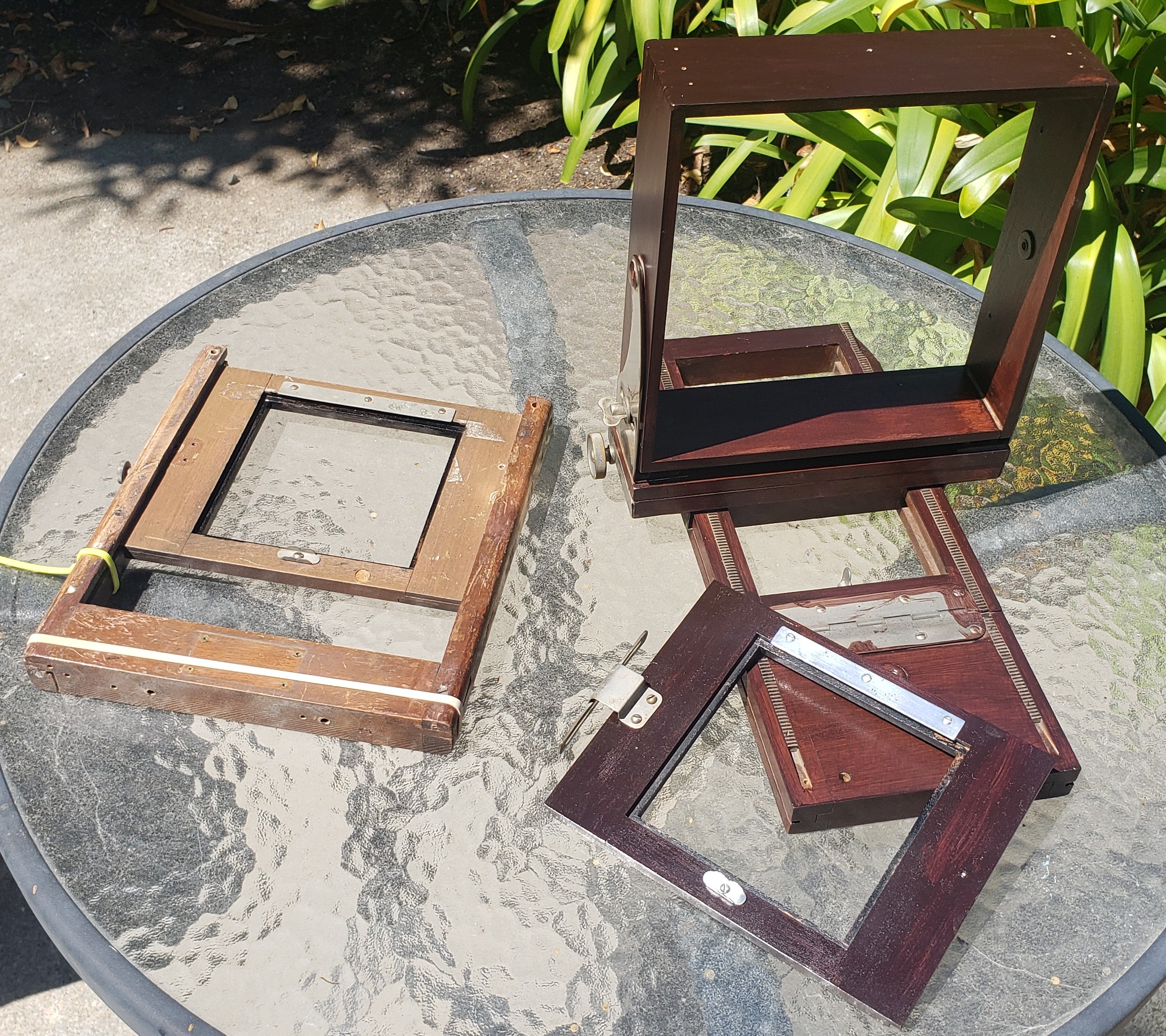

Bringing a 'barn find' 5x7 back to life.
Waiting for the glue to dry on the piece on the left.
Depression-era repairs are a pain to undo.

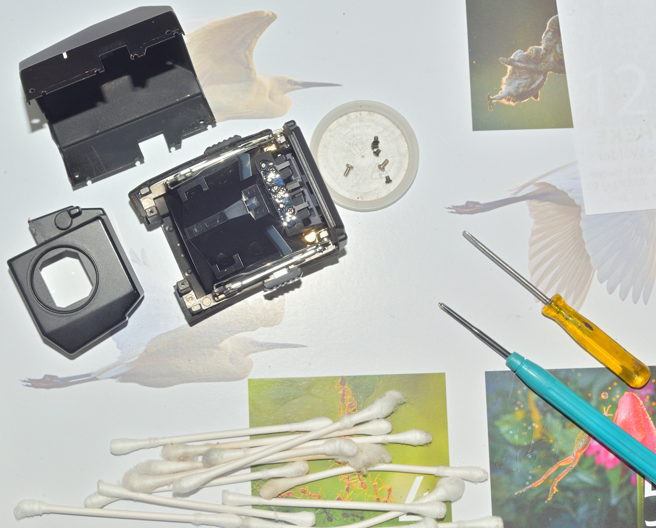

A NIKON DE-3 (viewfinder prism attachment) came to me with fungal infestation on the glass surfaces.
Opening the case was a bit difficult because one of the four screws had a damaged head due to overtightening, an the surrounding rubber seal was still very firmly glued.
After cleaning the glass surfaces of the prism and the eyepiece lenses which was easily achieved with isopropanol and glass cleaner, just re-gluing the surrounding rubber seal took some time...
Thanks, interesting!
How did you solve the problem with the damaged screw head and the glue?
I unscrewed the screw with a flathead screwdriver and after screwing it back in I filled its head with black paint so that the bare brass is no longer visible.
All that was needed to remove the rubber seal was a blunt flathead screwdriver and a lot of patience.

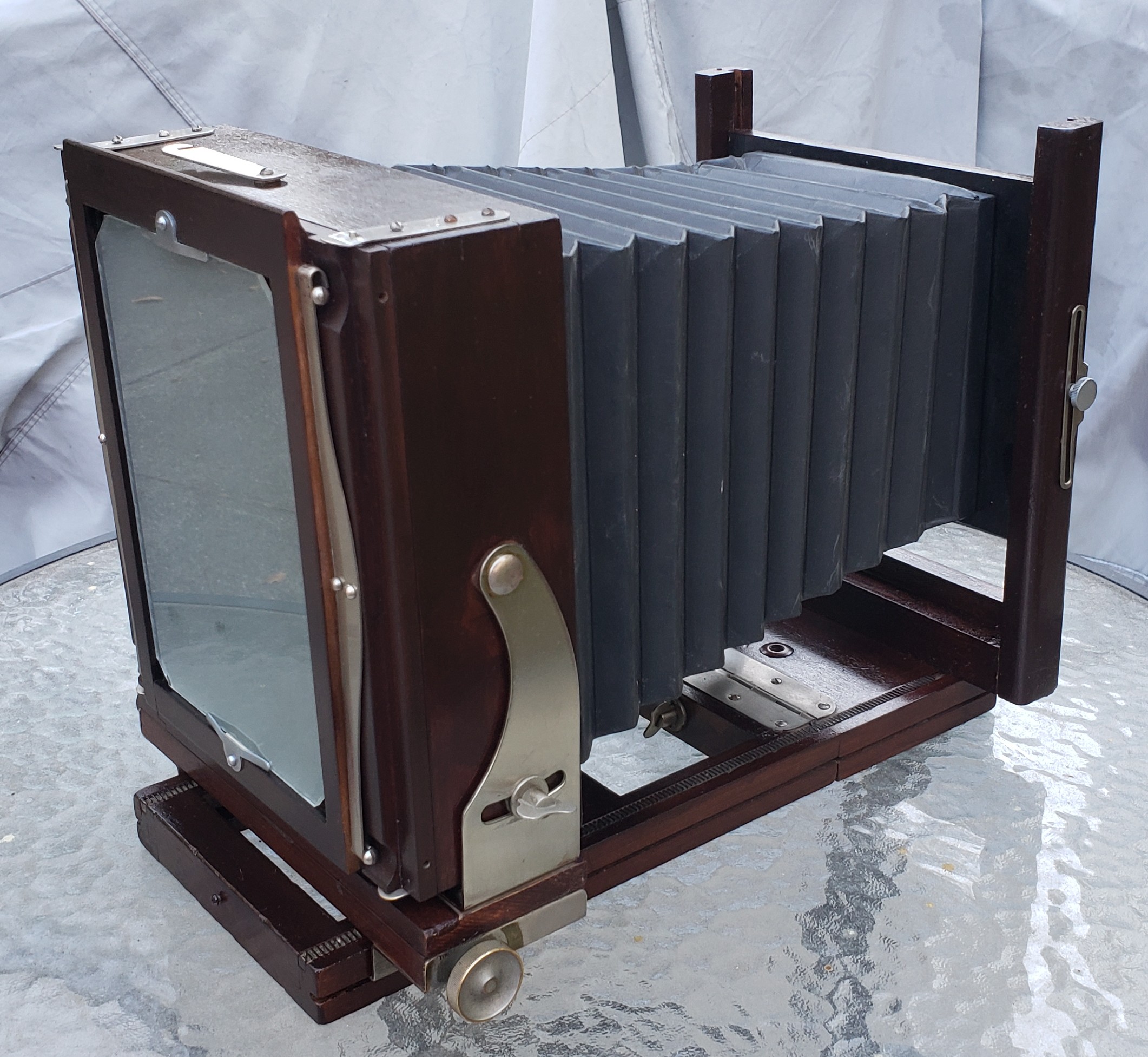

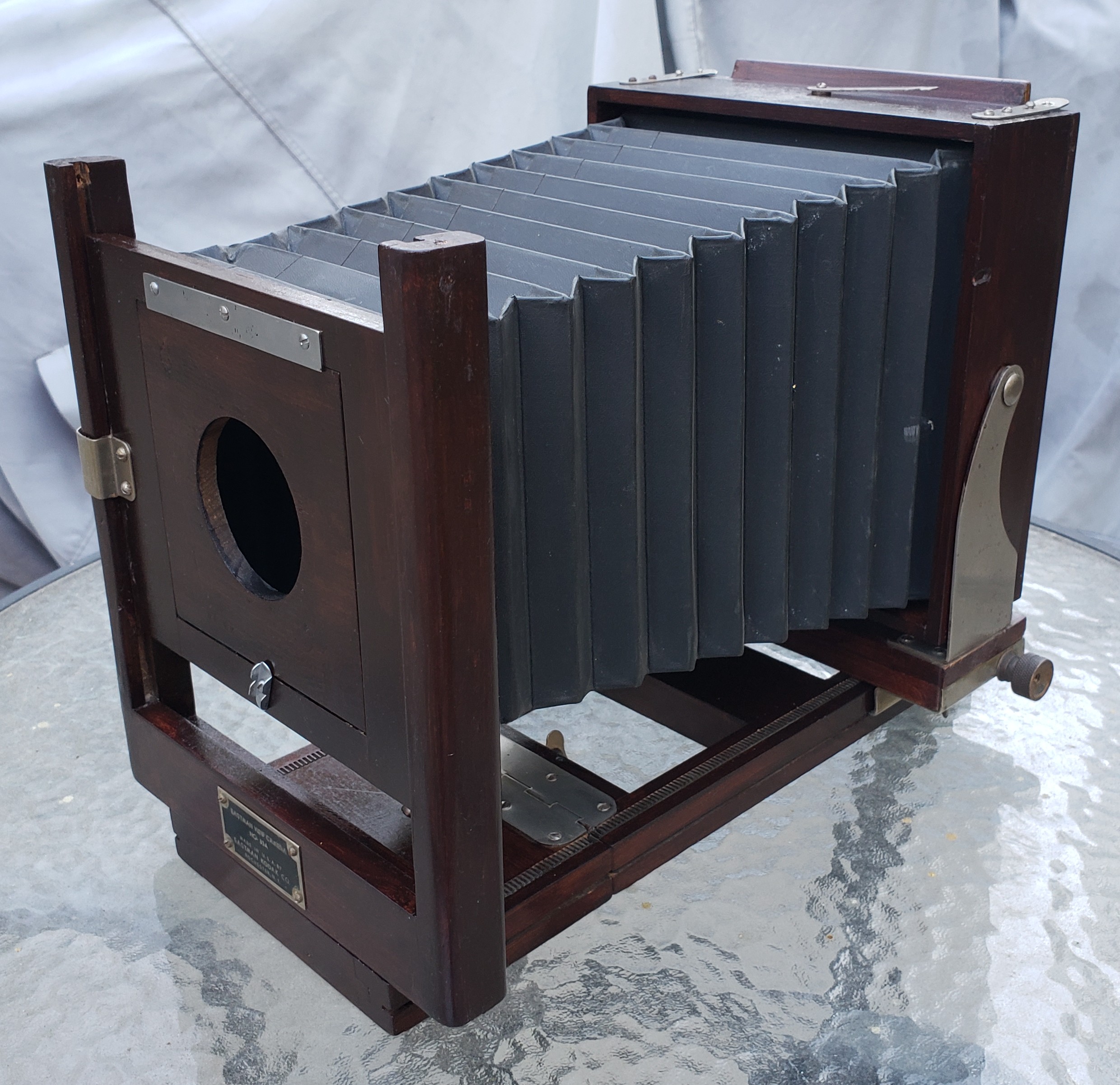

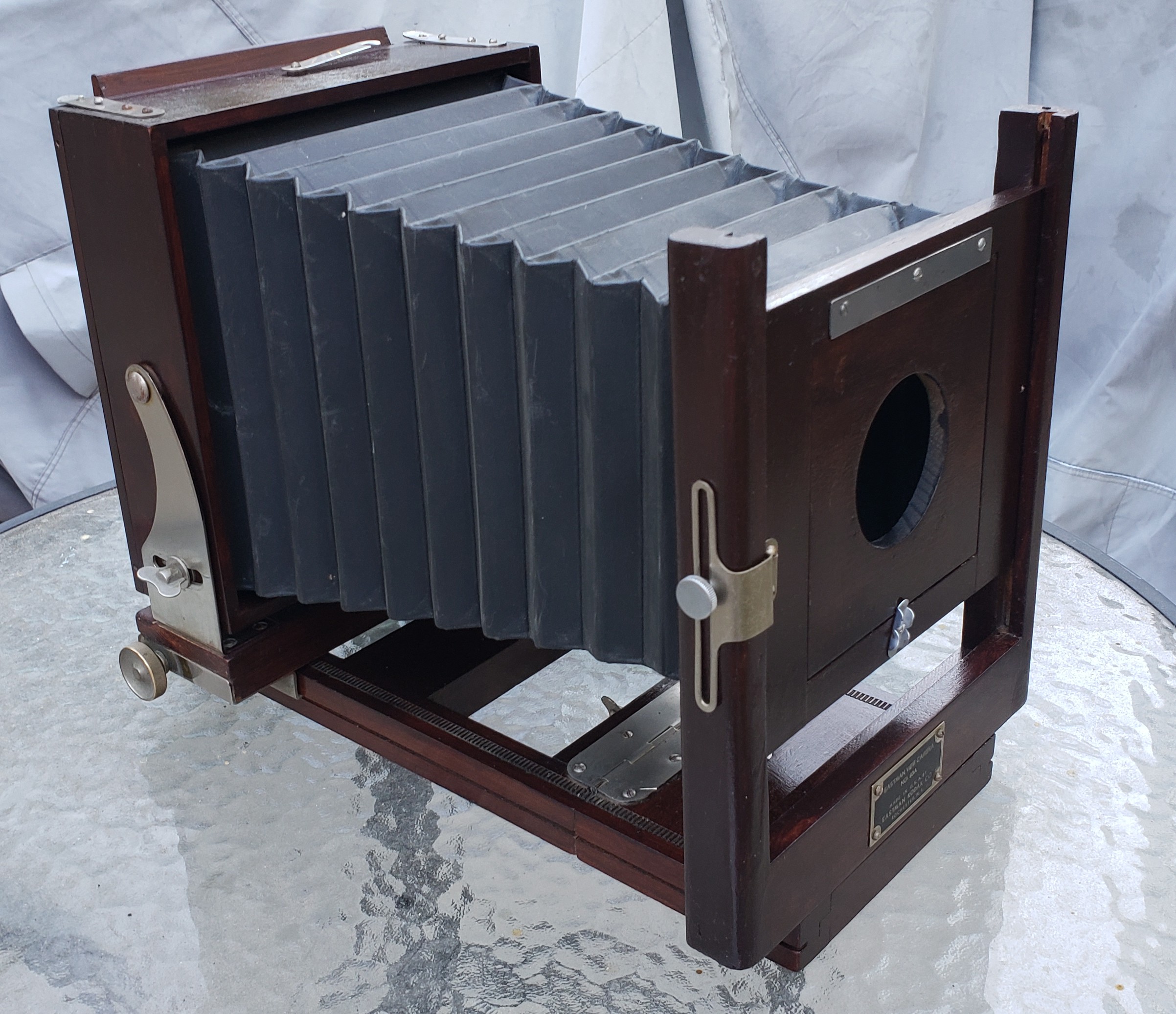

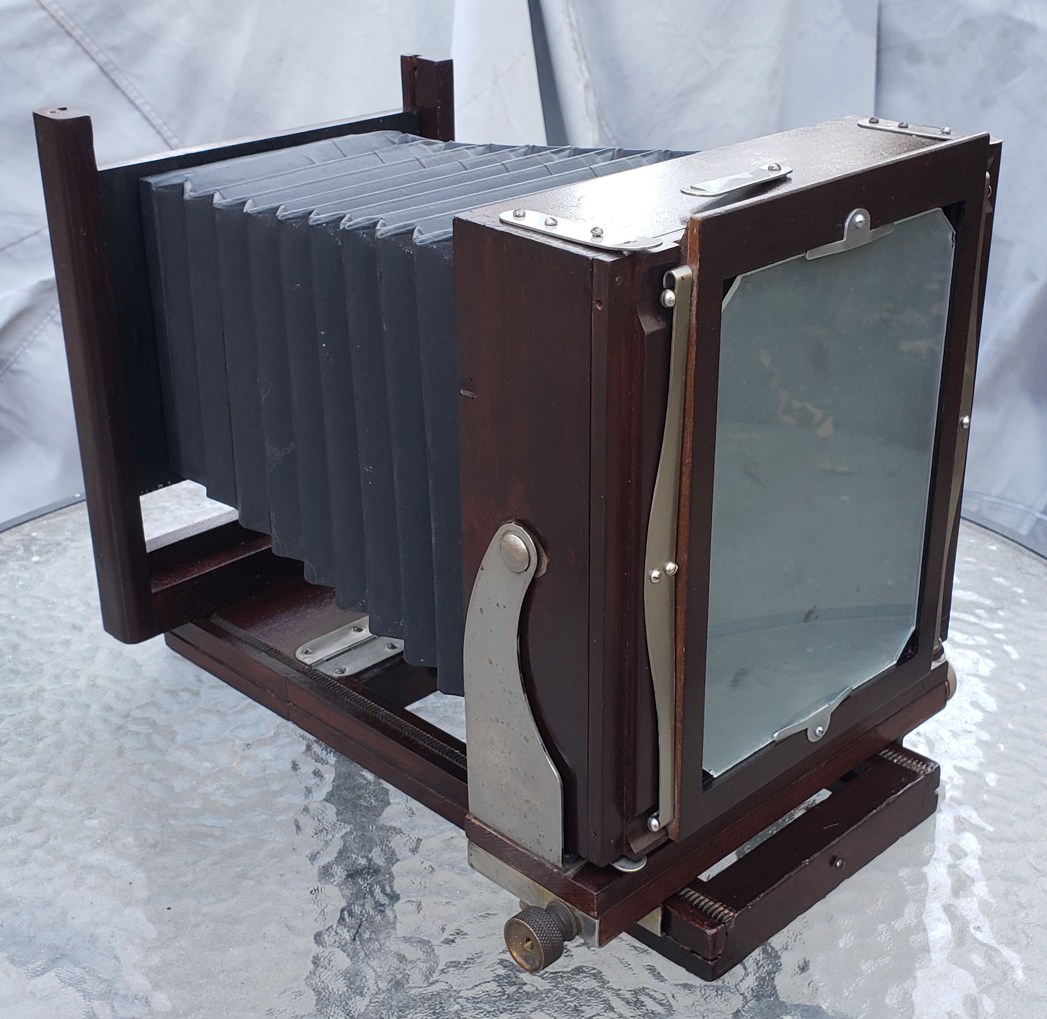

Barn-find 5x7 restoration complete. 👍

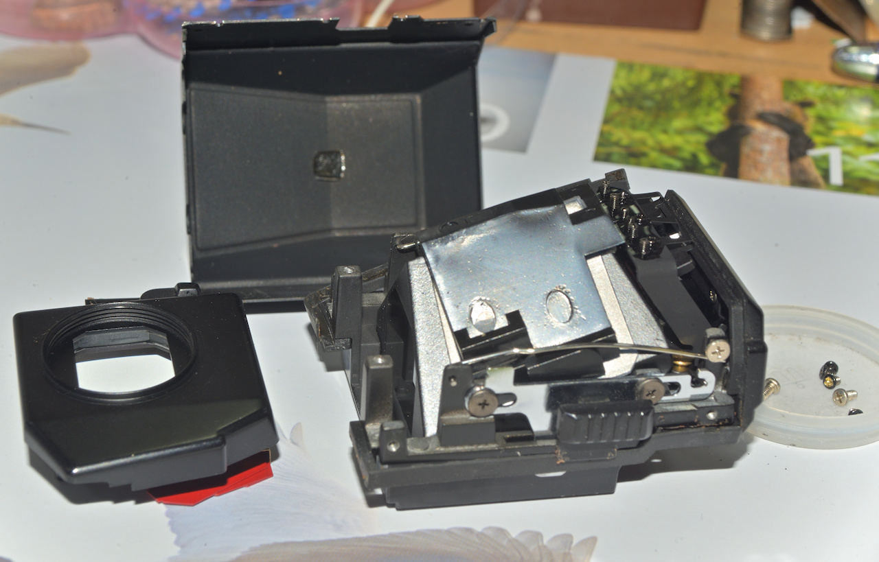

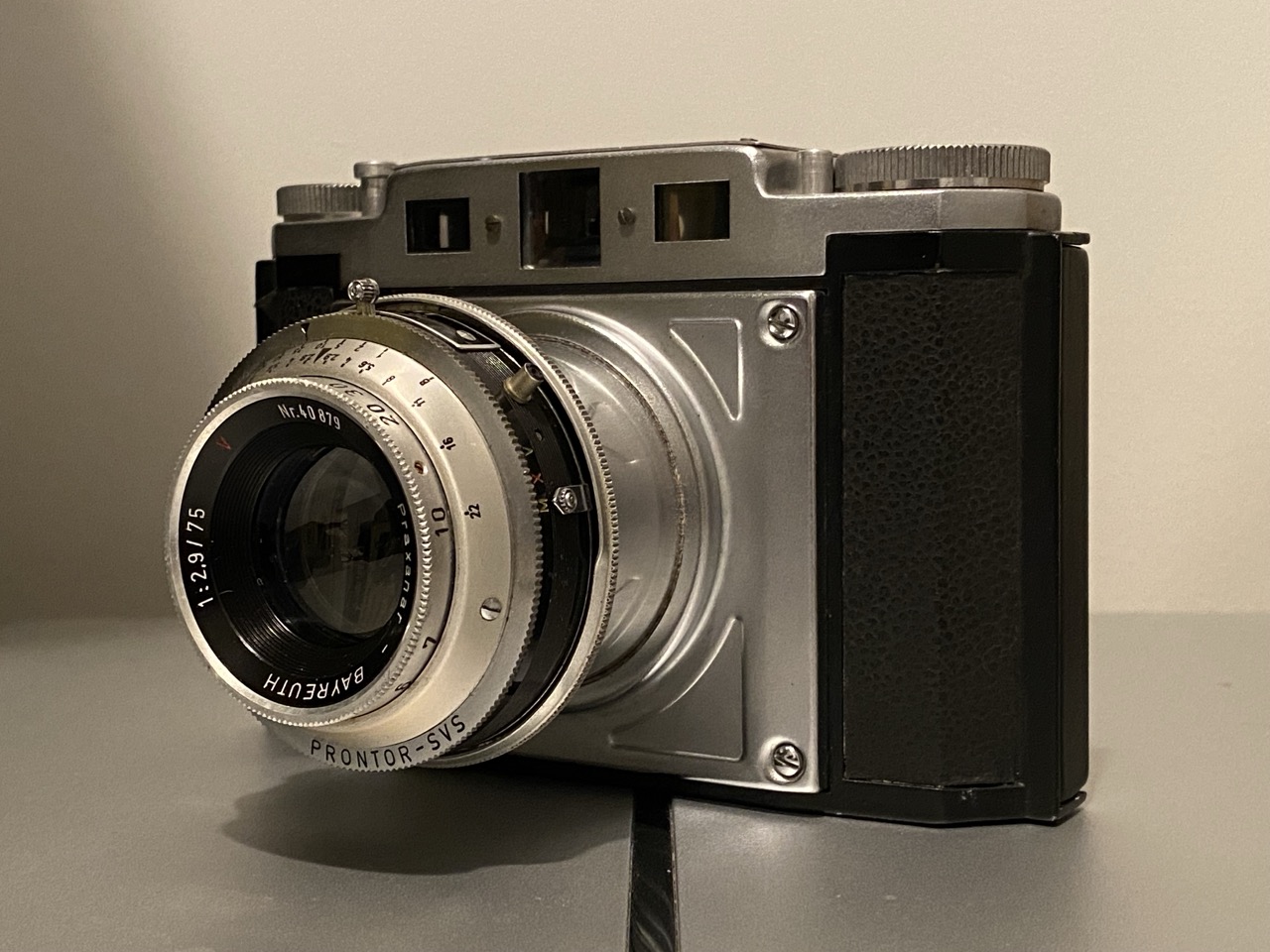

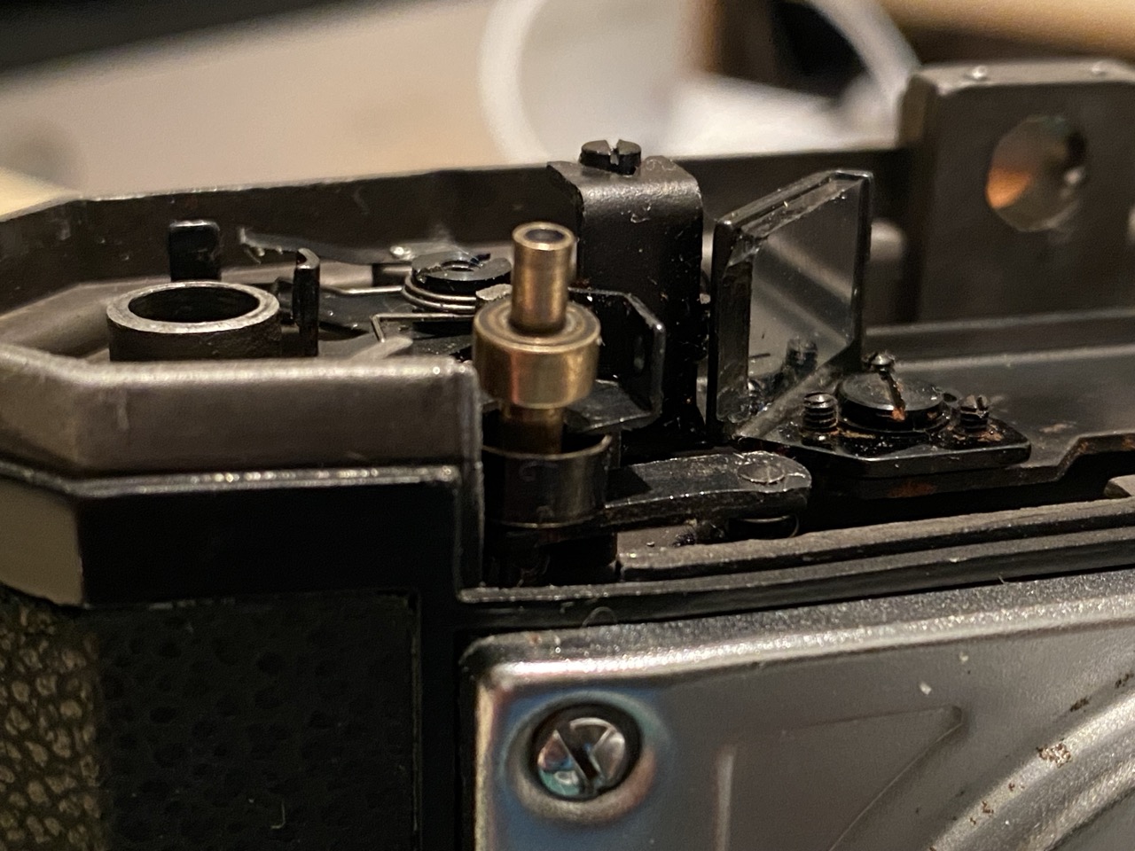

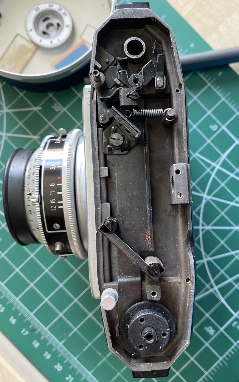

Over the weekend I replaced the half silvered RF mirror in my Brain Gloria. The RF "mirror" replacement wasn't too challenging, but finding the unknown number of parts making up the shutter release mechanism that took their chance to make a bid for freedom did provide a challenge.
Camera:
Top off. RF mirror replaced is the larger, lower one in the picture below:
How many pieces were there, and how do they fit together. I found to bits (the release and a brass collar), but it wasn't until later in the day did I find a small spring on the floor. A bit of experimenting and I managed to work out the correct order and orientation of the three parts.
Brass collar (bottom), spring and shutter release in shutter interlock / double exposure prevention mechanism:
