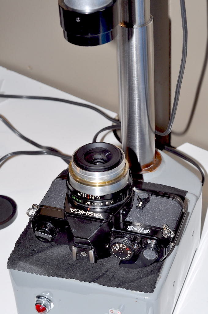

Set infinity focus on this Yashica ML 35mm/2.8 lens.
In this case the foucus ring can be removed, the helicoid can be set at the infinity position, then the focus ring can be re-attached resting up against the infinty stop.

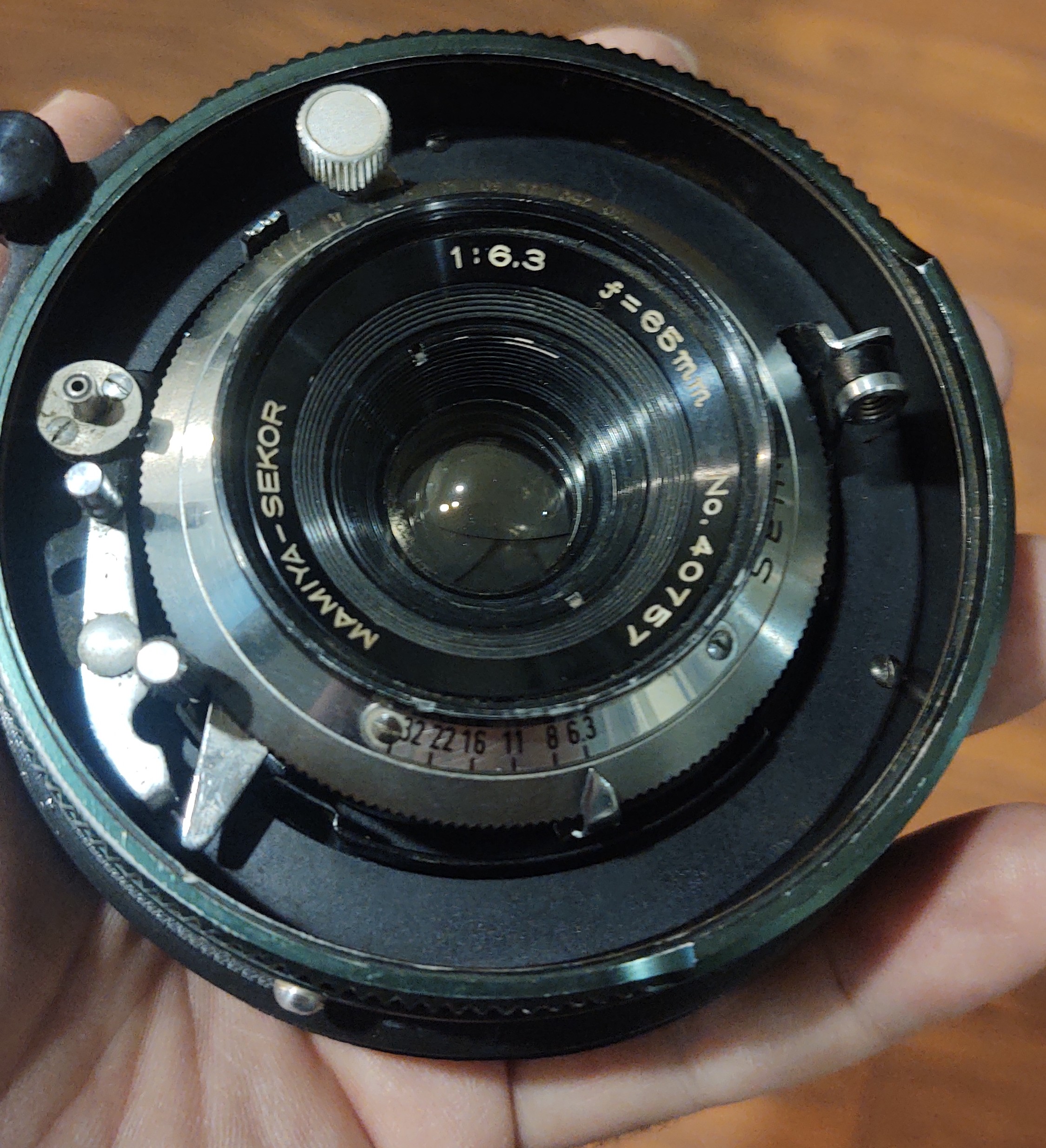

Did a quick refurbish on a really ugly Mamiya 65mm for the universal 23. Focus was super stiff. Shutter did not open at all. And there was fungus on the lens. Everything is working now. Lens looks much better. I'll be trying to build a 3d printed camera for it next.

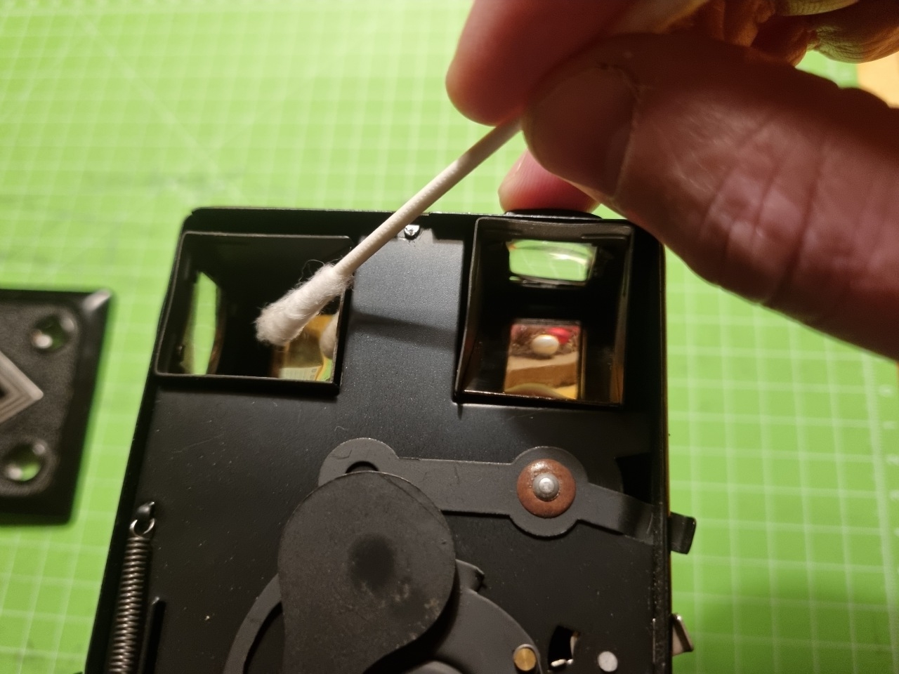

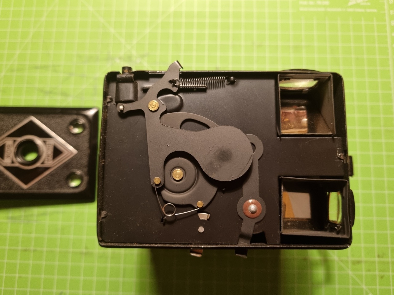

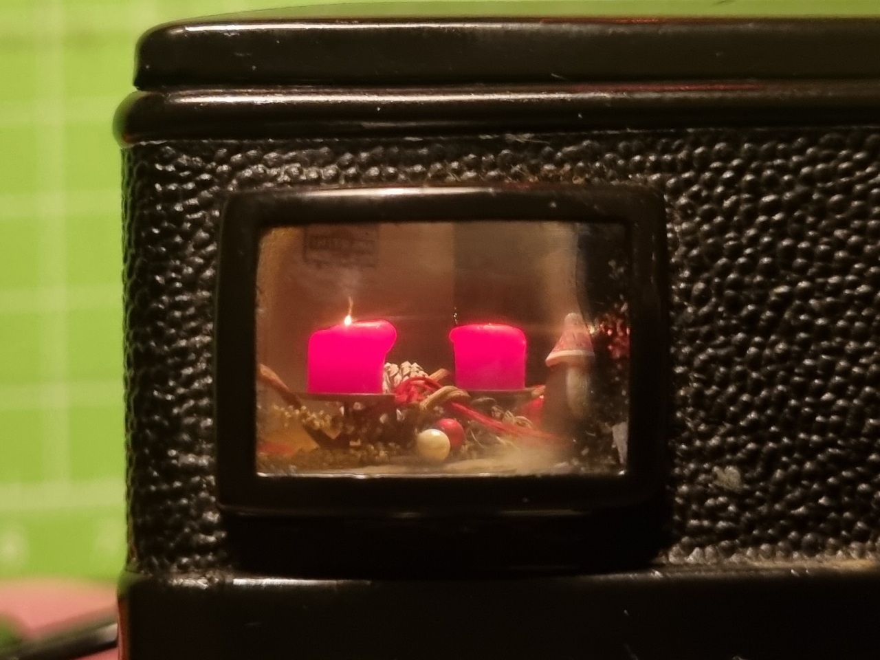

After I found out how to get access to the machine room of my Bilora Box I cleaned the viewfinders.

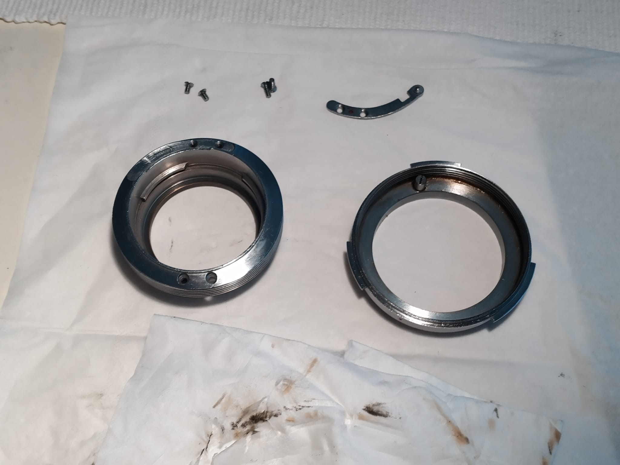

Spent the last week, on and off, smoothing out this unknown Contax-to-LTM mount.
The focus threads and RF coupling tube were both binding inside the mount. It was so tight it would just unscrew the lens from the camera.
I applied a fine abrasive polish on the offending parts a few times until the focus was turning smoothly in the mount again.
Tested it on the Leica M-E with a Jupiter-8 after reassembly to verify the focus and it is spot on.

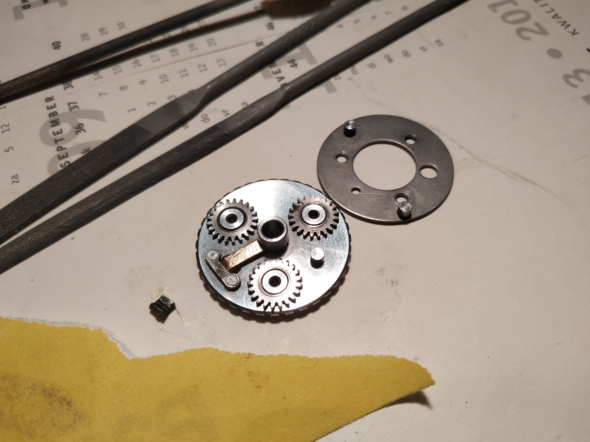

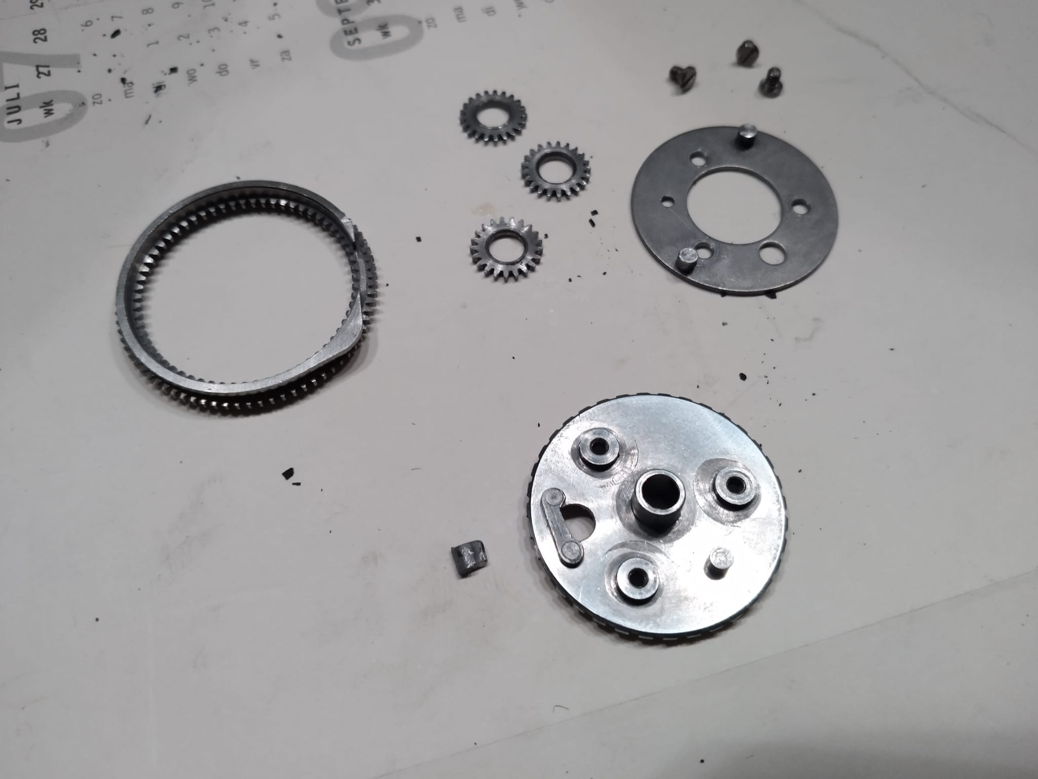

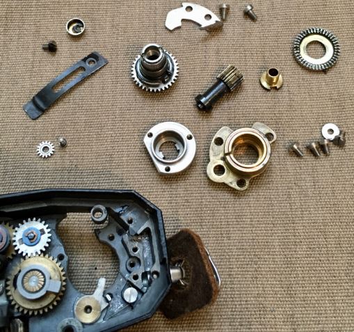

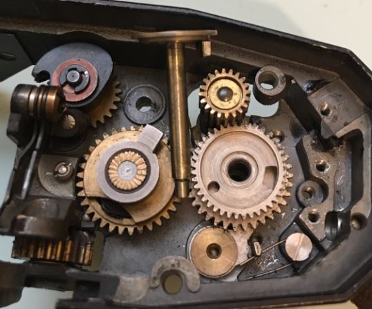

I am dealing with a broken 'tooth' on the carrier in this planetary gearbox inside a Graflex Combat KE-4
Cut a brass strip and shaped it like an "L", refined it until it would clamp into this position.
But I couldn't get the new "tooth" properly angled so it would disengage with the underlying cam when required to decouple the shutter/film winding from the spring motor drive.
So prototype no.2 will be more "T"-shaped with the tooth sitting further back towards the center of the carrier.
While I was at it, I also replaced a disintegrating shutter curtain.
Biggest worry will be reassembly, where everything needs to mesh just right. But I have a PDF of the service manual (US Army TM 11-2343) that should help a lot.

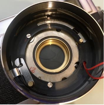

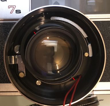

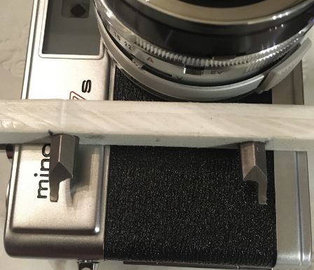

I cleaned the inside rear element of my Hi-Matic 7s which had small snowflake-like humidity spots. As for the retainer ring in my previous post, I made a spanner wrench for the front group.
Also,I thought I could swap the CdS cell for one that I salvaged on a Zenit TTL but it was the wrong size.
Note: 38mm from end-to-end.

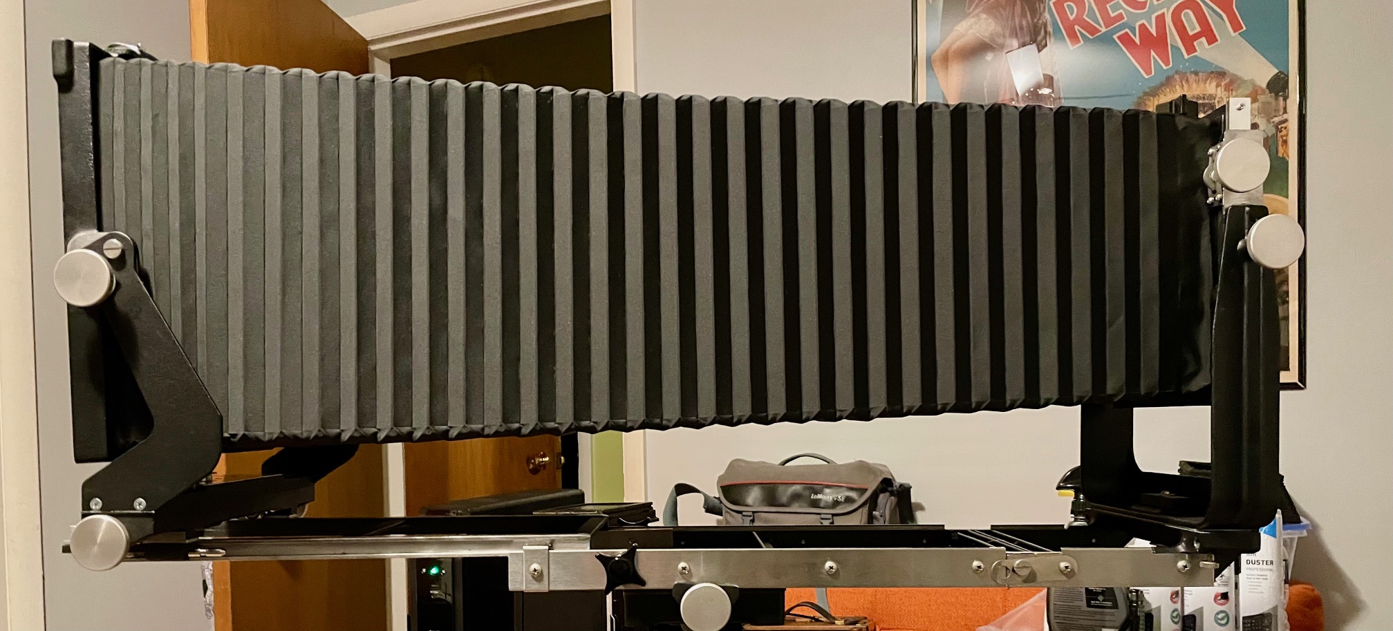

Got my new bellows installed on the Calumet C1. A bonus with the new bellows is that it is thinner and collapses much easier.
I must say, the C1 is very easy to service and change out the bellows.

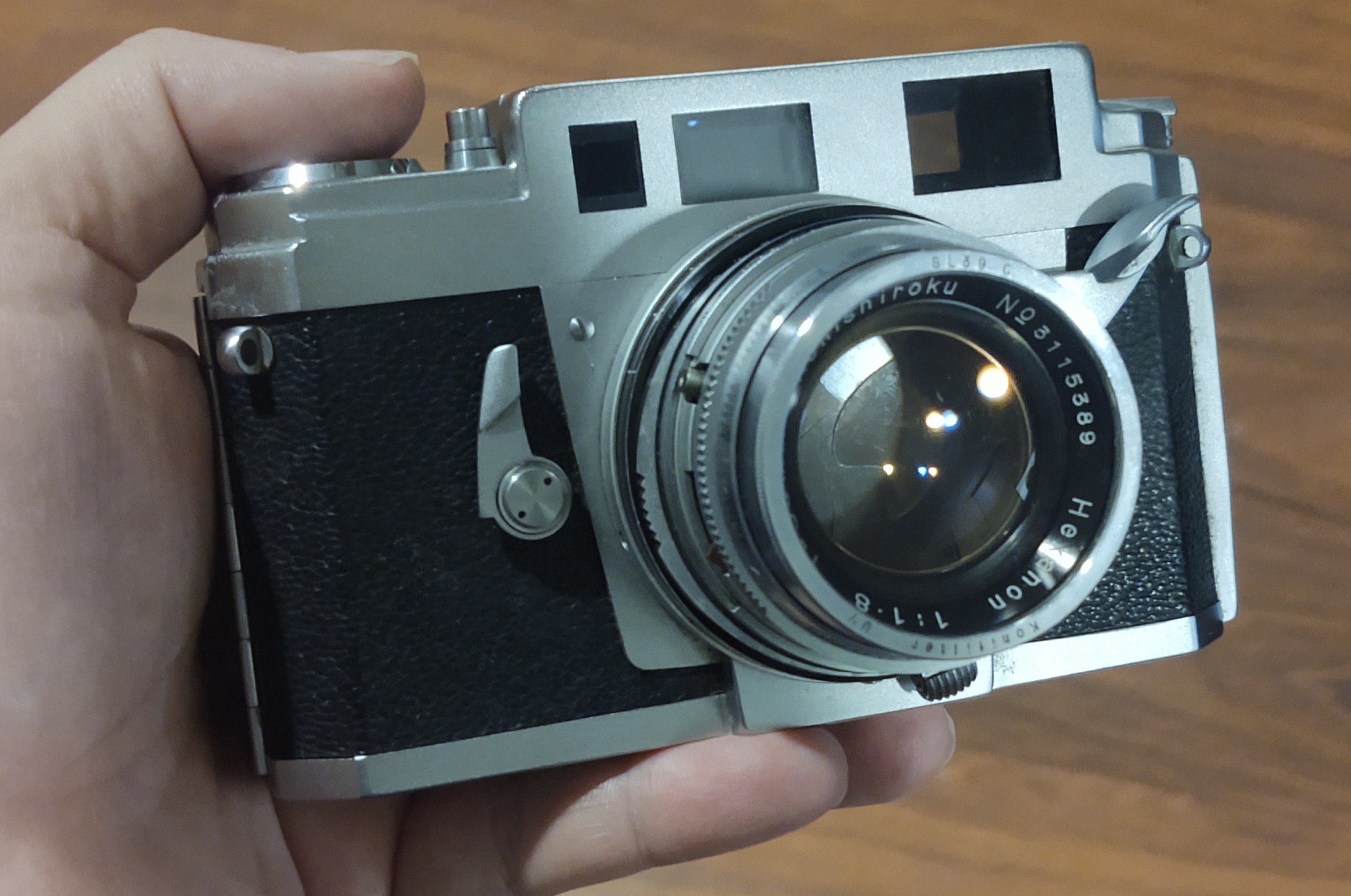

Very happy I was able to get this Konica iiia working again. It was in bad shape when I received it but now really clean and working. Next will be to run a roll of film through it.

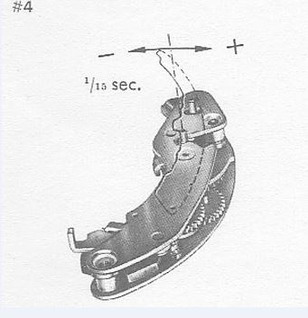

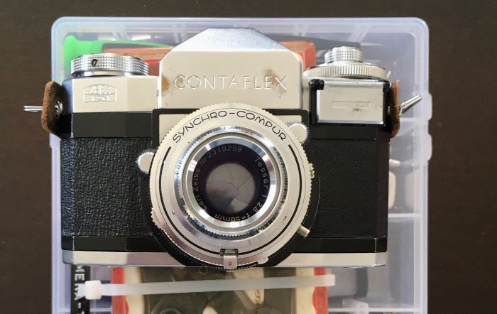

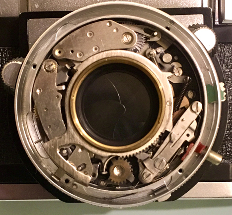

A long overdue shutter speeds adjustment on my Contaflex IV. I serviced the shutter over 2 years ago but never revisited it to adjust the speeds because the camera gave me so much trouble that, after fixing it, I was done. So, after several tries, I got what I believe is the best balance I can get out of this old bird. It's leagues better than how it was before.
1 sec - 1.24
1/2 - 1/2.1
1/4 - 1/4
1/8 - 1/7.6
1/15 - 1/15.7
1/30 - 1/30.3
1/60 - 1/54.7
1/125 - 1/97.2
1/250 - 1/162.4
1/500 - 1/264.5
Turns out, my flashlight was too weak which caused the fast speeds readings to be off. I double checked my adjustment, and tested again with a fully charged light stick. Now, I get 1/133, 1/222, and 1/357 *thumbs up.
I made a new light baffle for the mirror of the Contaflex IV with some light tight material. The original was made of light craft paper which was falling apart.
And while I was reviewing a reference video of the advance mechanism, I spotted an awfully loose cog due to an equally loose retainer nut.

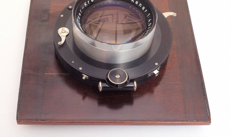

Glued a 1.8mm thin strip of mahogany-to the top edge of an Agfa Ansco lens board.
This lens board came with a different 10x8 Agfa Ansco camera and a 12" lens in a Betax #5. It was a touch loose and the slider holding it in place only just gripped the top of the board.

The Contaflex IV is finally back in one piece, after a few weeks on the bench. I overhauled the advance mechanism, cleaned the prism unit, lubricated pretty much everything, and adjusted the focus & the split screen. While revisiting it, I learned a lot of things that are not in the service manual. Things like how to adjust the split screen focus by adjusting the mirror stopper screw or resets the advance mechanism without taking off the mainspring. I also discovered quirky stuff like the prism unit preventing the shutter actuation if screwed 1/2mm too close to the bevel cog or, my favorite, actuation issues if the lens carrier sits a tad too low on the body. Took me a while to smoke out the gremlins, but I'm quite pleased with the result.

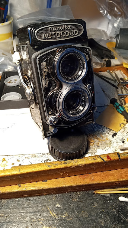

Fixed a Minolta Autocord. New one for me—never been inside one of these but I like what I saw. This one was refusing to fire and the winding crank was very very stiff. I guesstimated a fossilized grease problem, and that’s what it was. I took the right side plate off and cleaned up the gears but the shutter still refused to fire, so I took off the front plate. Flushed out the shutter and the winding-to-shutter linkages and took off and cleaned the taking lens elements. Did a little black paint touch-up and took the VF off to find a fogged-up mirror inside. New skin and mirror ordered from Hugo so maybe it’ll be done next week!
I’m impressed by the innards of this camera—robust gears and fairly simple mechanisms. The moving parts are easy to get to and this one had no issues with its focus mechanism
