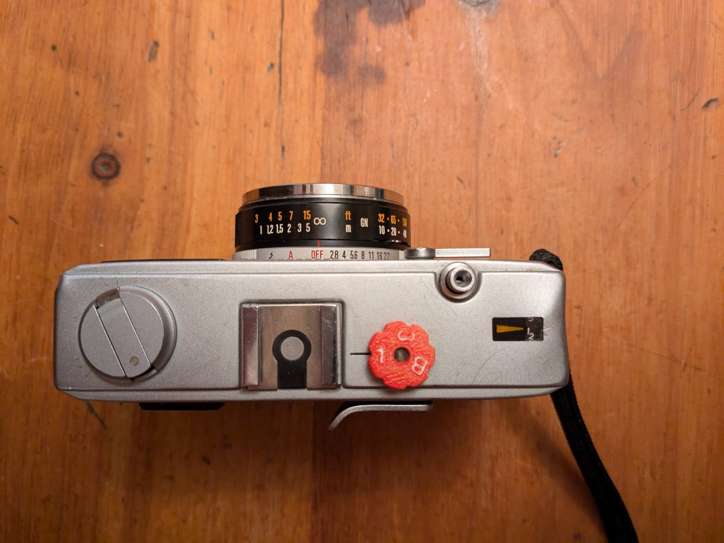

This Olympus 35RC was missing its shutter speed selector.

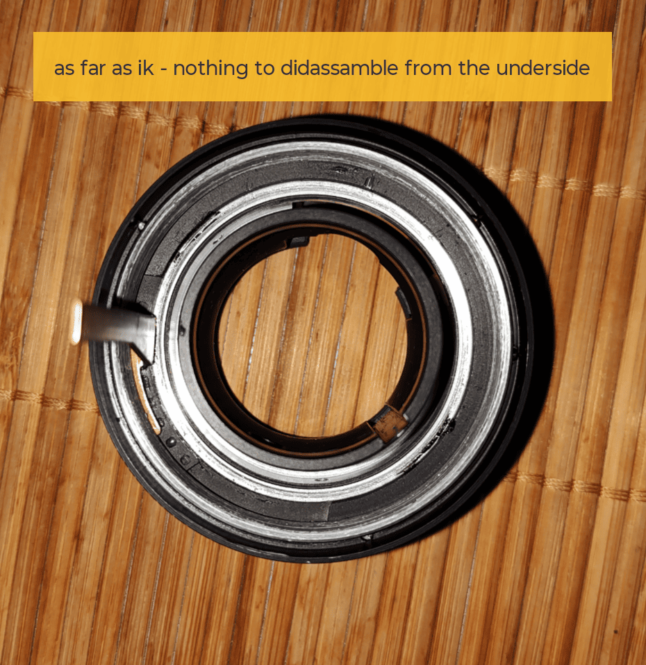

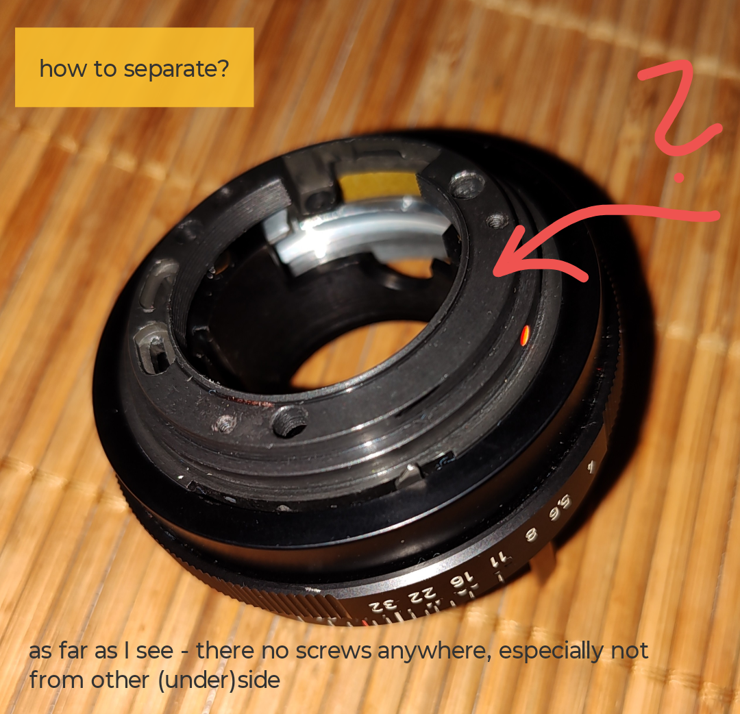

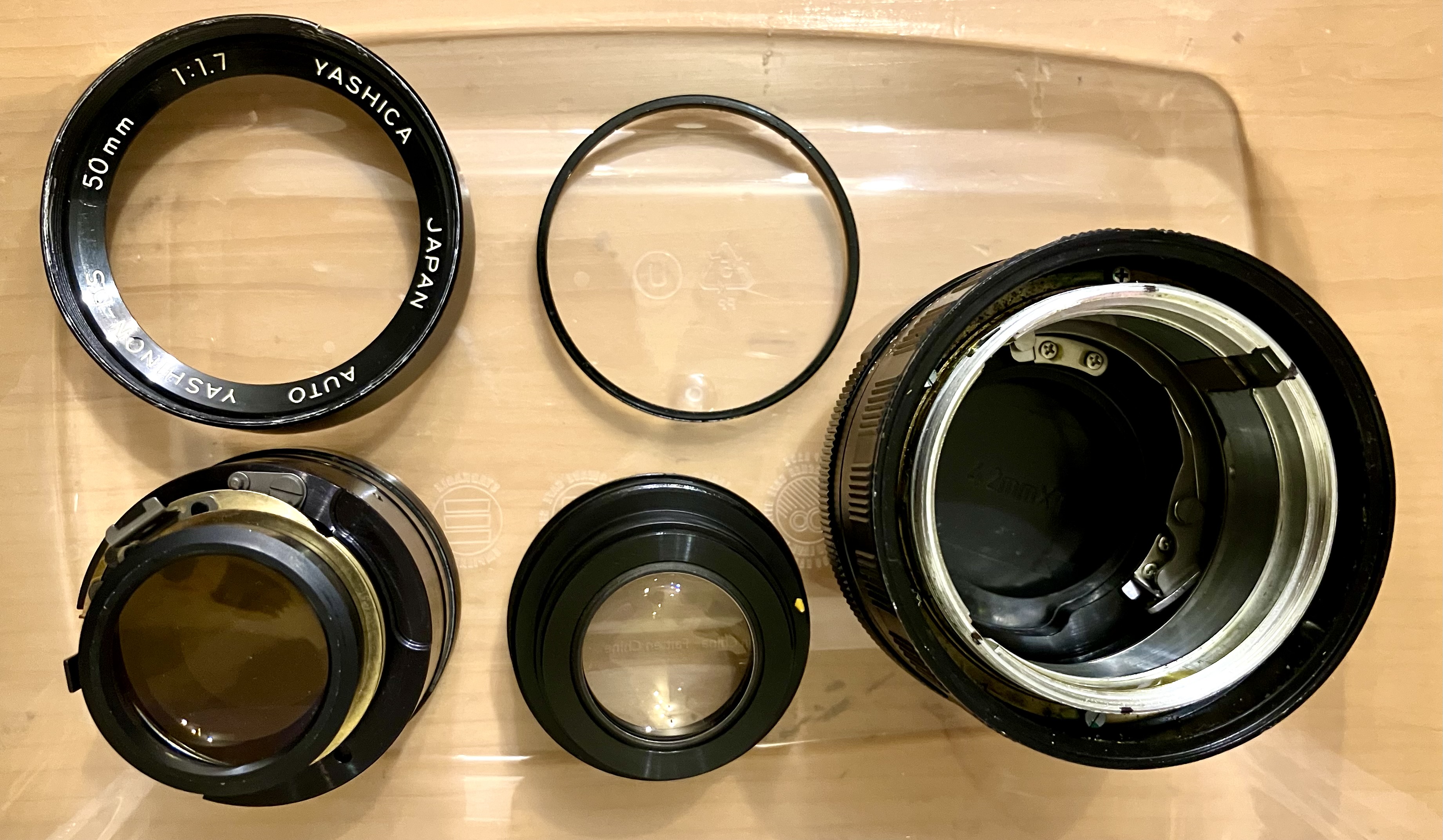

I've started to disassemble the Auto-Yashinon-DS 50mm f/1.7 that I purchased yesterday. This is such a model of practicality; Unscrew the filter ring, the front element retainer ring, and the front element, then just pull the whole rear element/aperture assembly for servicing.
Note: I fixed the filter ring which was slightly bent on 2 spots.

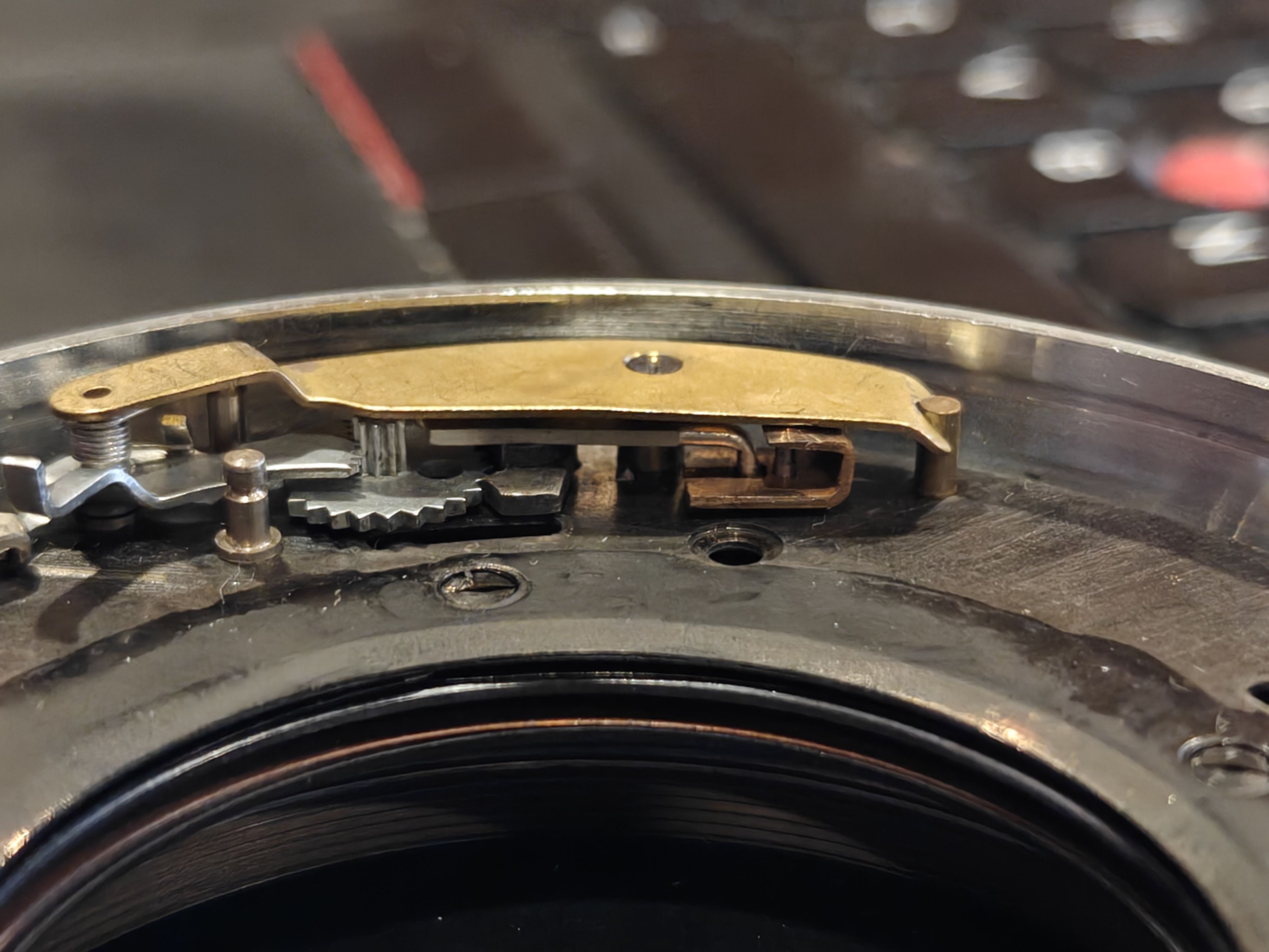

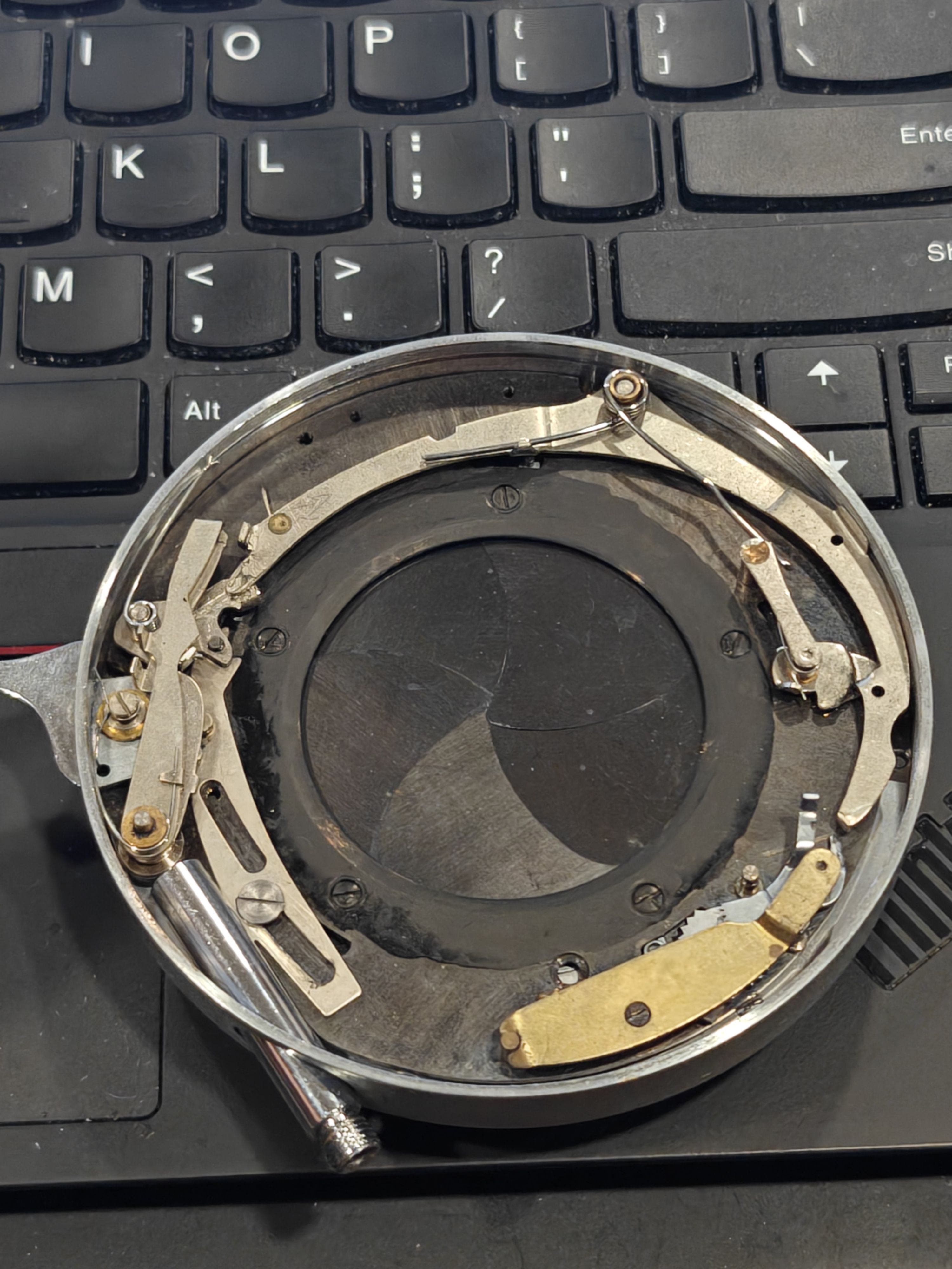

Received a wollensak alphax shutter in the mail from our very own @AnselMortensen and gave it a quick overhaul. I love how little these Alphax shutters changed over the years and how simple they are.

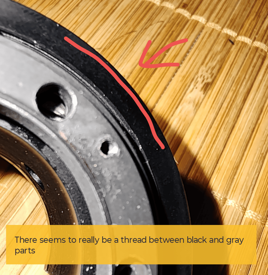

I'm not going to do it now, but I'm looking for good instructions on how to disassemble this exact lens. I'm considering relubricating the helicoid; however, I'd like to be sure I don't mess up the optical alignment. Do you know where I can find a good set of instructions on how to do it?
Here's the instructions I used, years ago.

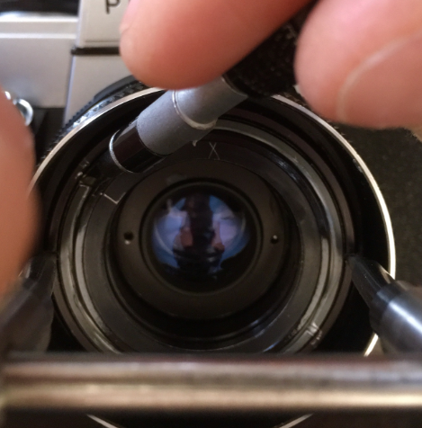

I had to relubricate the helicoid and focus ring because they were so difficult to rotate that it hurt my fingers. The inner helicoid is easy, you remove the back, a few bits, and you can unscrew the unit from the front. Just make sure to note where it comes out or else you spend half an hour trying to find the correct position. Also, if the focus is smooth enough and the infinity focus is fine, I'd leave them alone. They're held together with a retainer ring instead of setscrews, and it's a finicky to re-tighten the ring without messing the focus.
Here's what I'm talking about.
On the picture, I'm pushing the outer helicoid counter-clockwise with a flat bladed screwdriver, as I'm tighting the retainer ring clockwise with a spanner wrench.
