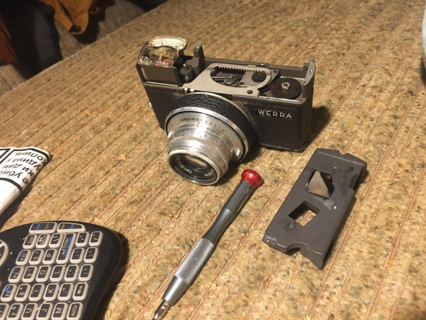

Werra 2 was jammed. In this case problem was in mechanic part of film advance, not shooter.
I have cleaned it and take out plastic peace from viewfinder that where on the lever for gears. Be careful when opening top cover by unscrewing flat screws from the side, you will need a force.
Interesting for Werra 2 is part under top cover that has hols for mirrors for rangefinder that will be introduced in Werra 3.
Kliking now happily to shoot something thru this optics!

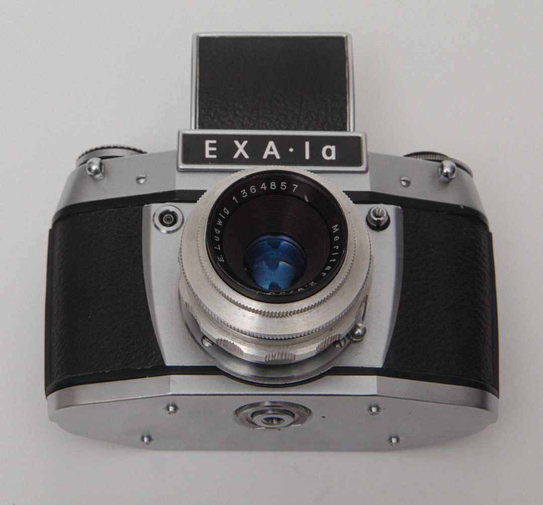

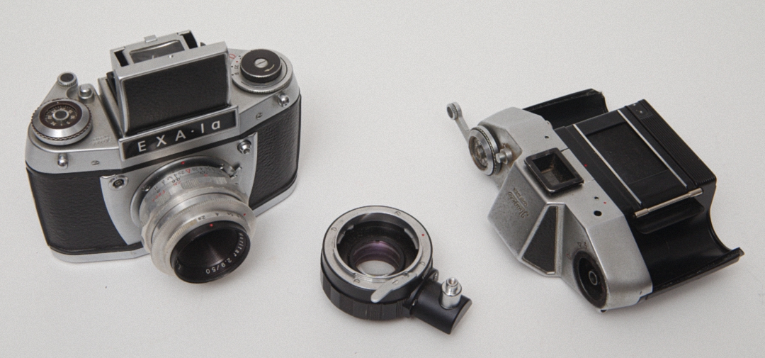

I bought this Exa 1a few years ago from a collector but it was missing the rewind lever. About a month ago I bought a broken Exa 500 for £1 at a camera fair, it was fitted with an unnamed 2x converter. I will strip the 500 for parts. I removed its push fit rewind lever and the Ia is now complete and fully functional.
I have now removed the remains of the sicker. The camera and 50mm f2.9 Ludwig Meritar lens are in excellent condition. It is not the lens that came with the camera when I bought it, that was a mint looking Domiplan, however the lens is useless you can't even focus it, the front element has been damaged, it's not scratched at all but is hazy.
It appears it only took me 11 years to get around to fixing this Exa 1a, a quick APUG search shows I bought the camera in 2014 :D
The Meritar must have come in a job lot, I know I never specifically bought it. I do have other Exacta camera a Varex IIb and an Exa II, and a few lenses, extension tubes, bellows etc.
Ian

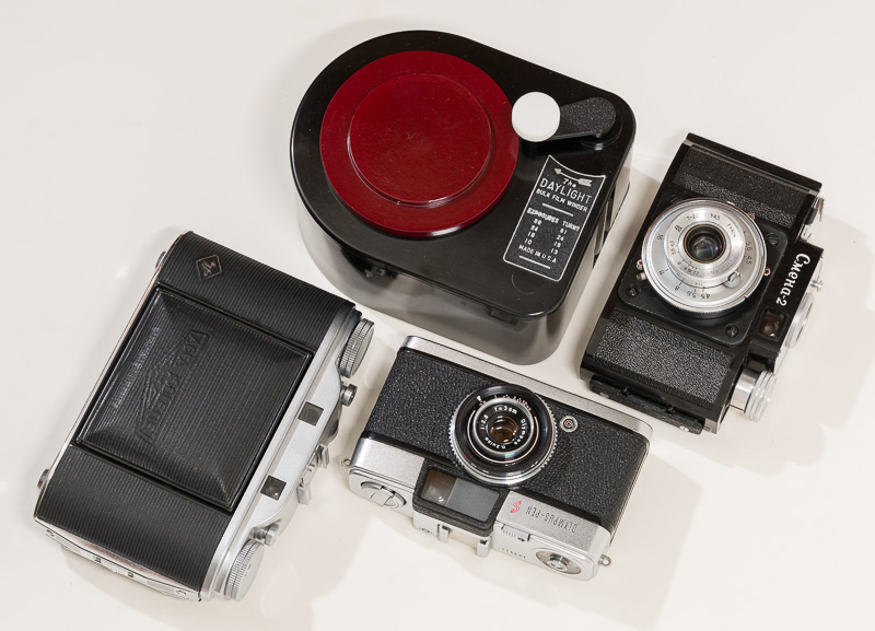

Bulk-film loader is a recent $5 thrift store find. As found, it was missing the crank, and the Bakelite was chipped. 3D-printed the former, and a combination of JB Weld and paint made for a near-invisible repair of the latter.

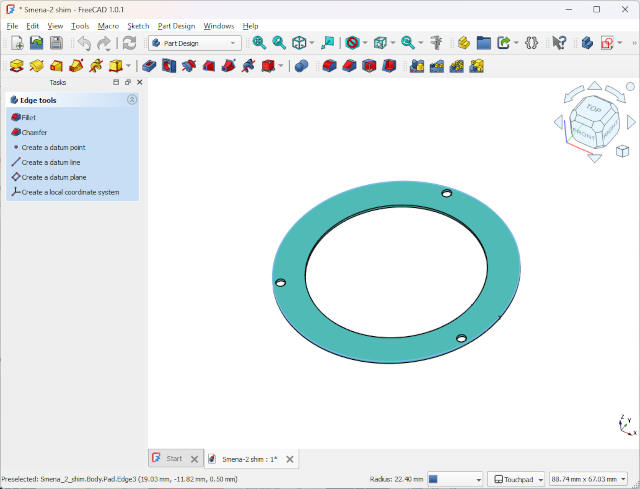

The cameras aren't new to me, and I had previously cleaned and lubricated them, but earlier attempts at collimating the optics weren't satisfactory. But that changed with the arrival of a Reveni Labs autocollimator! Agfa Isolette III and Olympus Pen-S were a breeze to adjust. But despite being the simplest camera of the bunch, the Smena-2 had me baffled: While I could collimate the lens easily enough, the factory index markings weren't lining up properly. After awhile (far too long) it dawned on me: Camera was missing a shim!
So I recreated the missing part in FreeCAD, and 3D-printed it. If I had a cutter, I might have preferred using that, but I knew that this was going to be a pretty thick shim. True, I could have simply hand-cut the part, but I'm always looking to improve my CAD skills. I needed to make adjustments to the thickness, and 0.5 mm ended up being just about perfect.

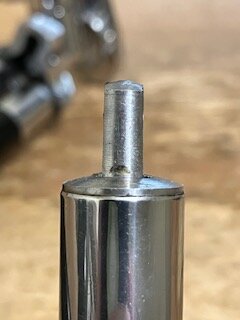

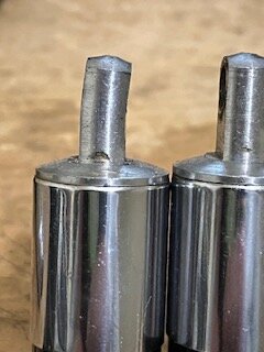

I straightened a crooked lug on one of the legs of my new-old Tripod. Fortunately, it's made of brass and so was easy to bend back into shape with a propane torch and light persuasion.
Good job.
Keeping our own gear in shape is the best away to keep our hobby/business in good shape and moving forward in this throwaway age.

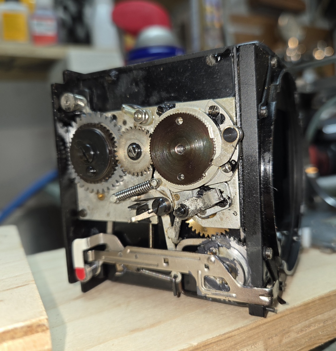

Jury still out on this Hasselblad 500c a friend gave me. I managed to fix the two backs. But the body is stuck cocked. I'm in the cleaning process, will put a bit of lube on it to try and get it going. I'm not going to ruin it by disassembling all the springs etc. I can get it back together.

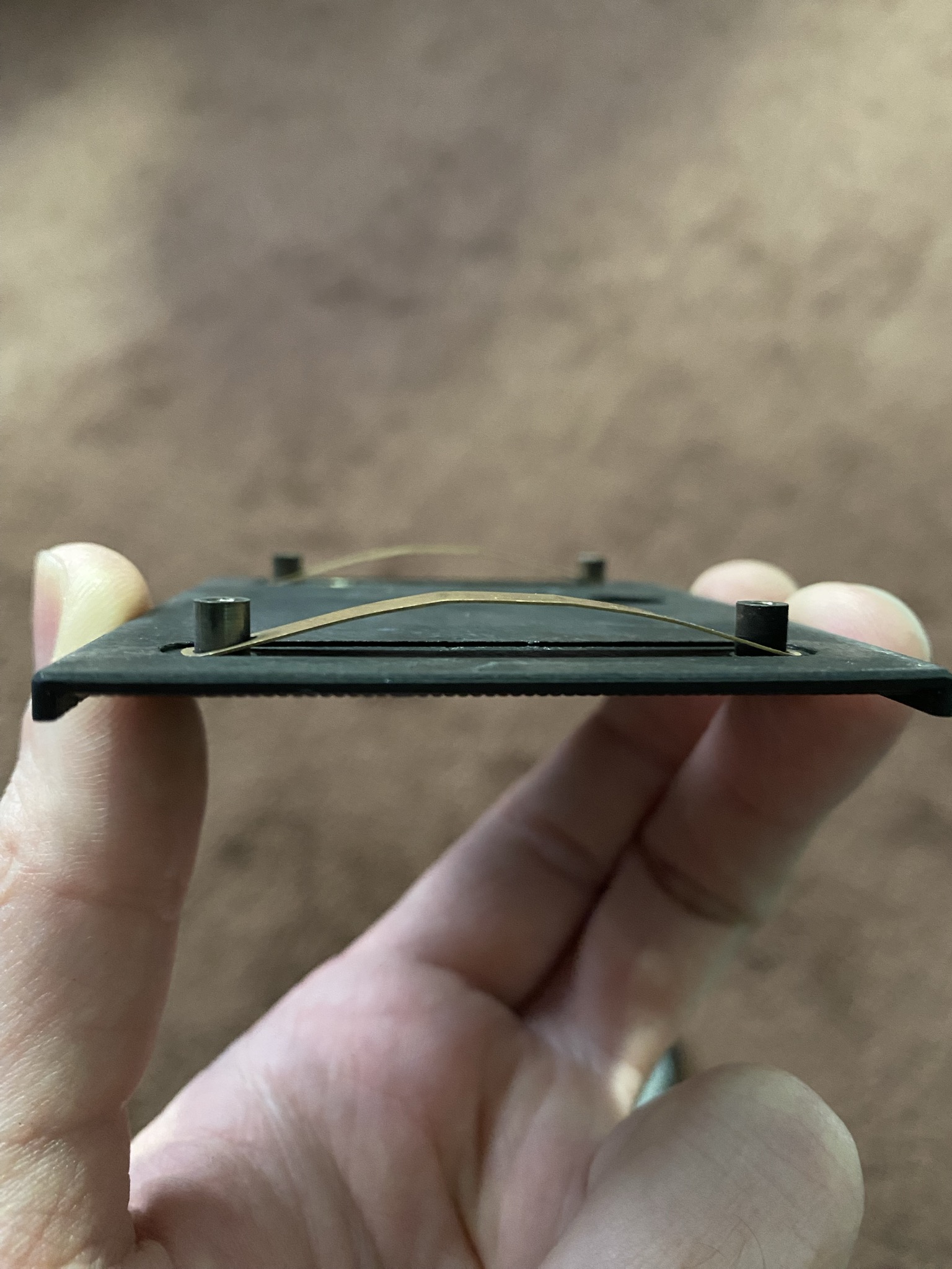

I tried to increase the pushing strength of the pressure plate on a 6x9 back, I found that is the cause of my back-focusing problem. It pushes very tightly now but I don't know if it will ever be able to hold the film flat enough for full aperture shooting. Just 0.4mm film center bulge can cause a 15cm back-focus at 3 meters.

I gave it a bit more contact cleaner and a few drops of a renowned penetrating oil. Set it in a tray, I'm dealing with my darling wife's expectation of some of my delicious chili, and we have a blizzard scheduled here for tonight 😎.
My friend gave me the camera 3 lenses 50, 80, 150. I think this may require an expert. My goal is try to free it up but not break it! First do no harm. 😊
