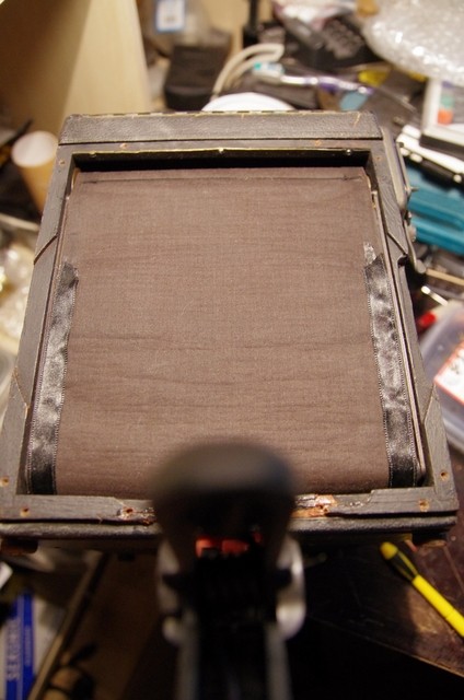

Fixed 4x5 RB Model B shutter curtain I broke yesterday while soaking with furniture polish. Running dripping wet shutter is not the best idea, the curtain broke on 3/4 window.
Two strips of silk ribbon and Gütermann HT2 glue. Appears to be running fine.
