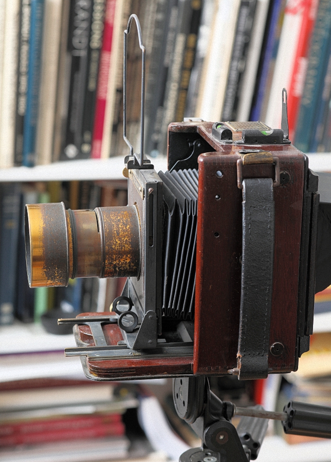

Put a brand-new bellows on an old Seneca 8x10 that's been lying fallow forever, it seems. Process was slowed down by me buying the wrong Seneca bellows-- for a Competitor instead of the Improved Seneca View that I have. But I built an extra wooden plate to join the bellows to the front standard, and it works. A couple test shots proved it to be light-tight. Very chuffed with the outcome!

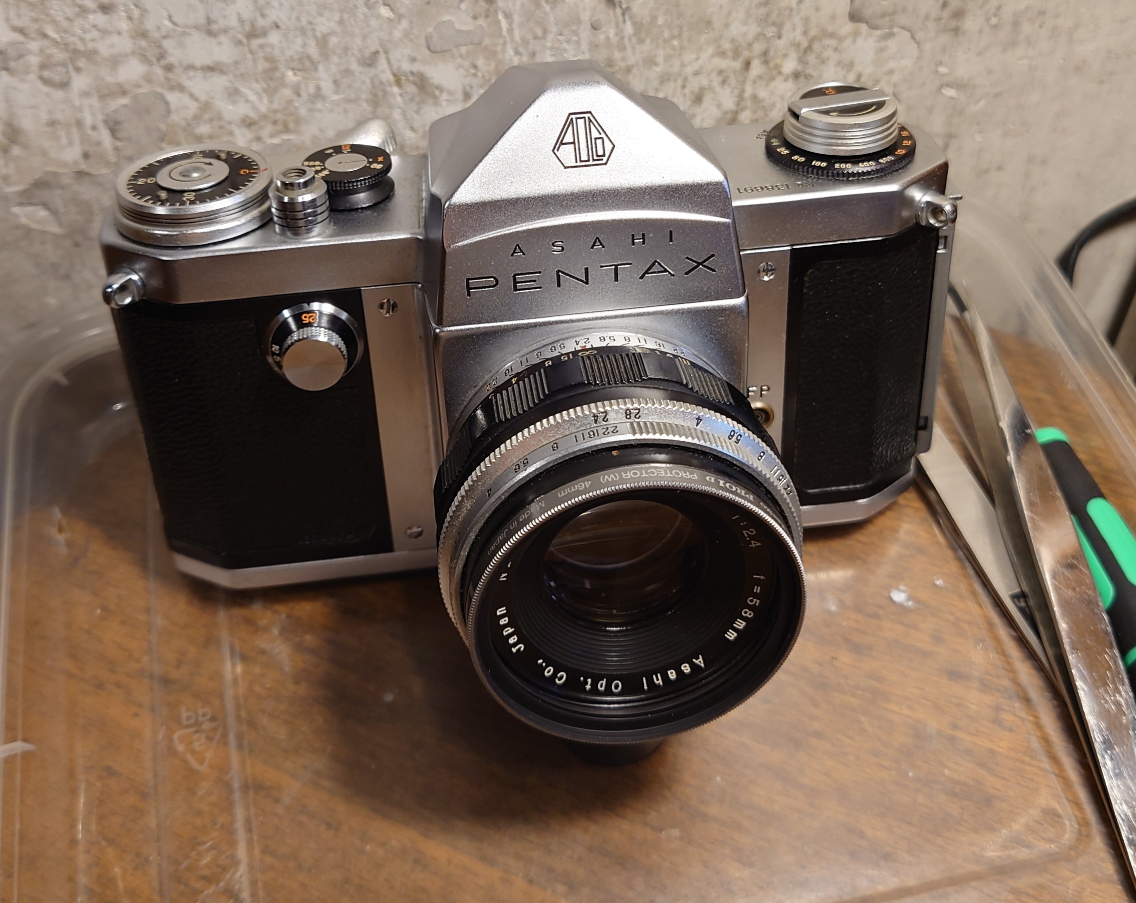

I got 2 Asahi Pentax AP from junk, one of it could have been in fire with burnt marks with some ? White powder stuff there . These white powder removed almost all black paintings on dails. And the inside has lost many gears , there is nothing I could do and so I just keep it as spare . Thank heaven for the lens, it is Takumar 58 f/2, not at the best condition but workable.
And the another one, this , has successfully restored as much as I can.
An interesting area is the low speed timing gear from AP is unique. Actually ech generation has it own design on this gear, particularly from model K to S2. They look very similar but in fact the large copper wheel installation is reversed among these 2 models.

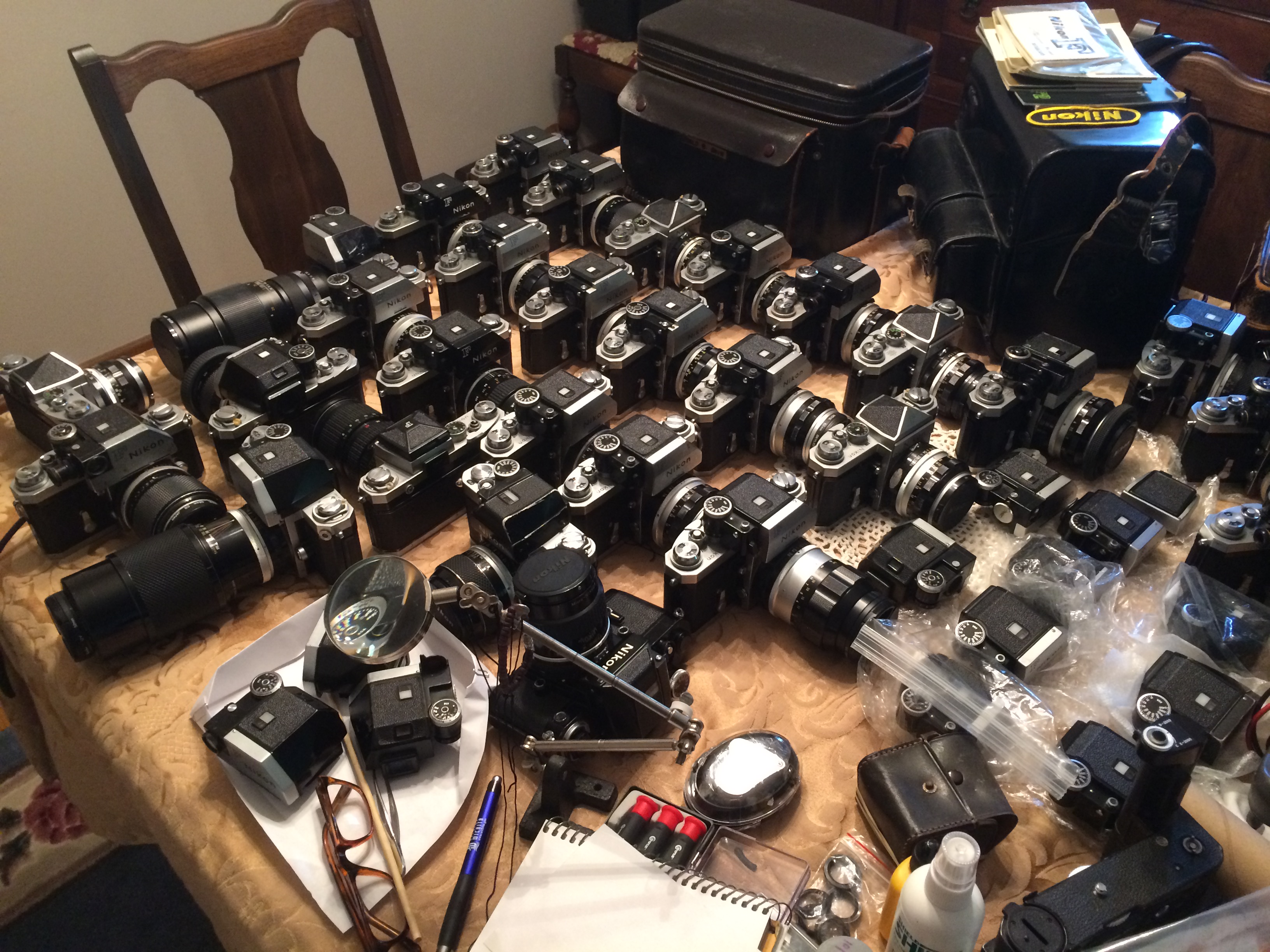

I have literally hundreds of 35mm cameras, (pic is just a few of my Nikon F and F2 cameras), so each day I’m fixing something.. light seals, electrical issues, etc.

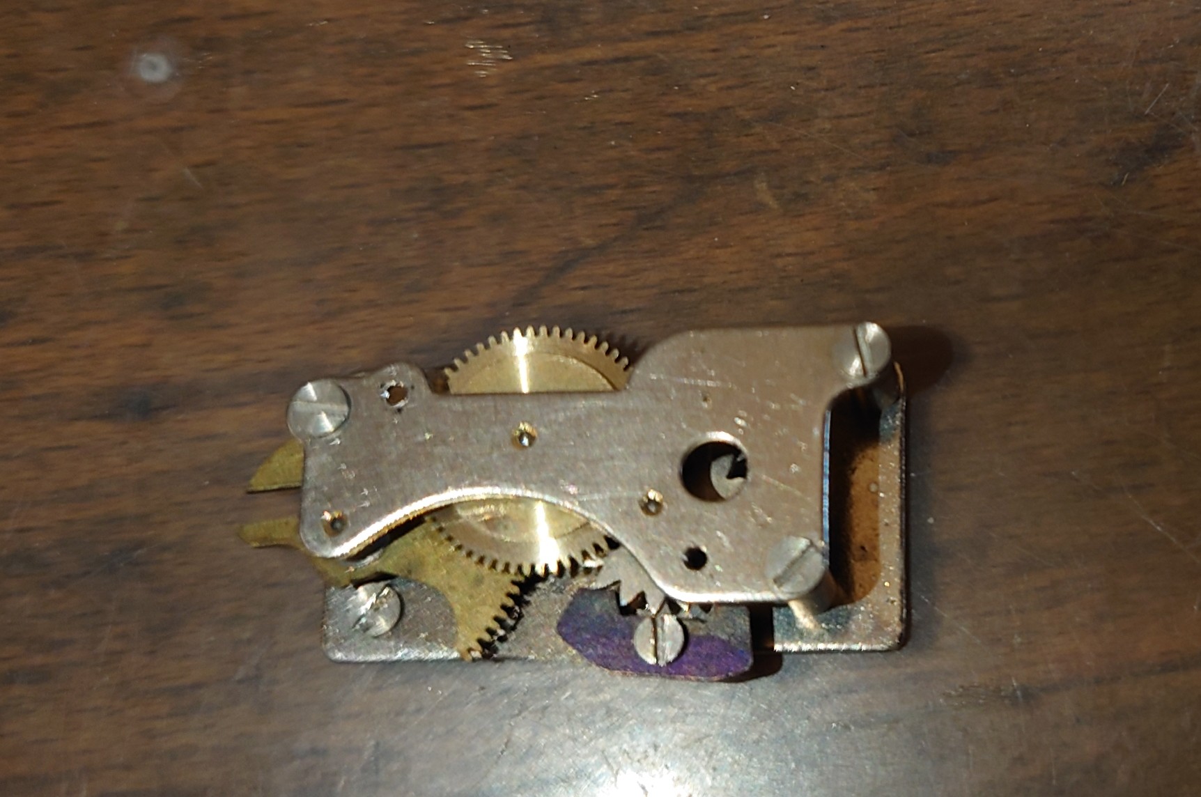

Looks very similar to the one you find in a Leica III.
Yes . The interior construction is like a LTM camera with a mirror box added, particularly from AP to K models.
The flaws , especially with model K , is from it's early design that the 1/1000 speed is actually an additional speed added on the original 1/500 speed design . And this very first generation of auto-aperture trigger rely heavily on user to quickly press and hold the shutter release button.

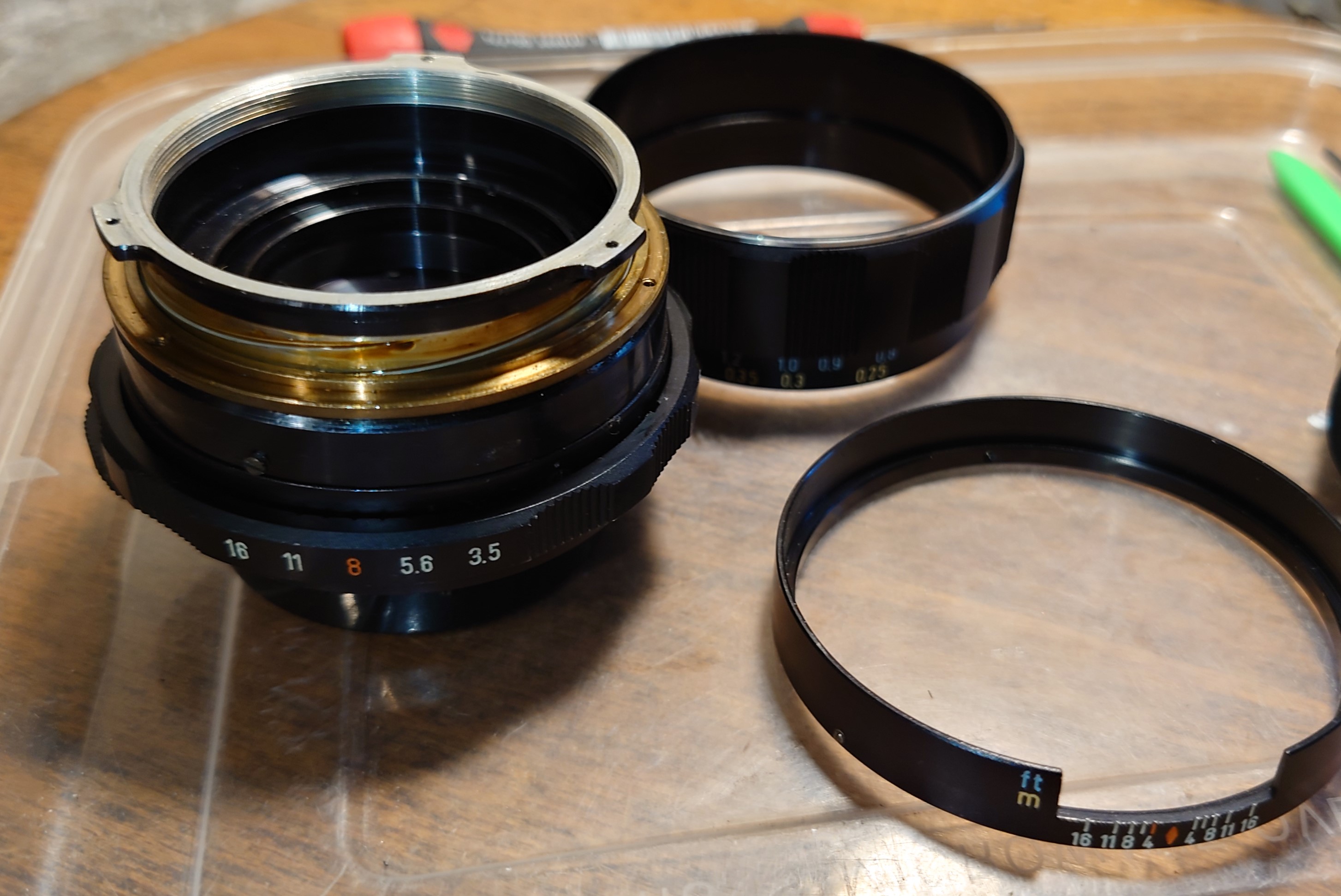

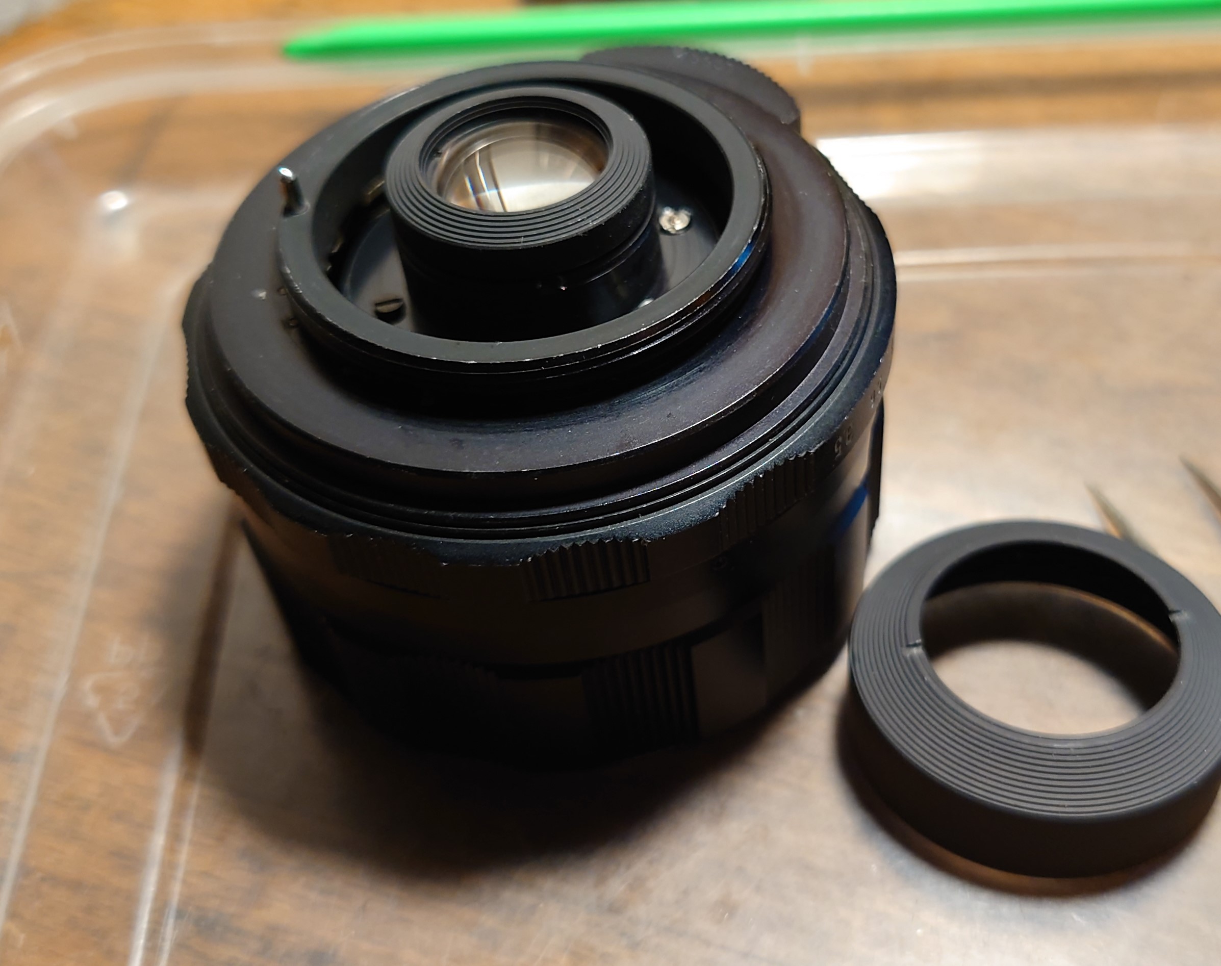

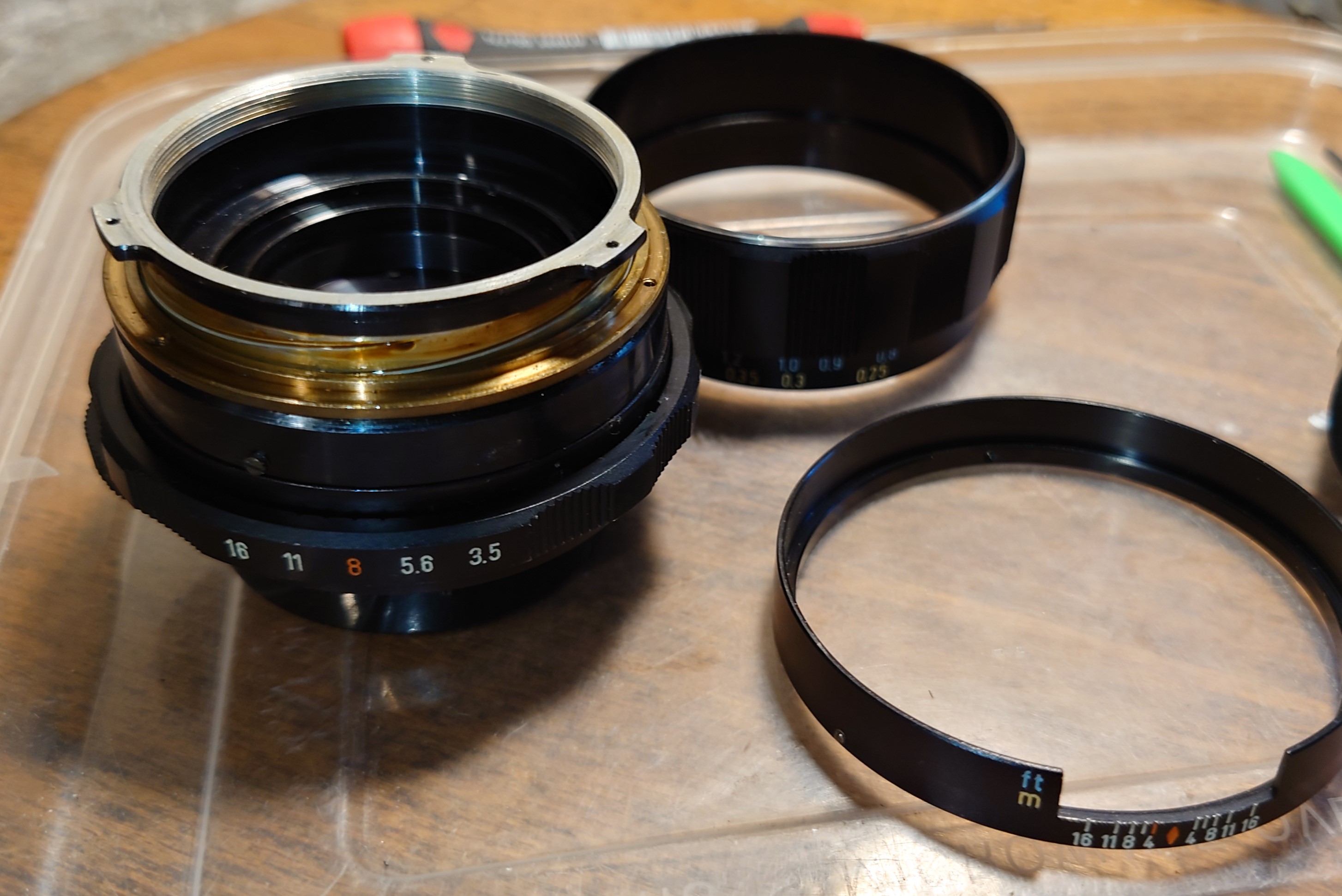

Fixed 2 lenses today, : Auto-Takumar 105/2.8 and Super-Takumar 24/3.5
The 105/2.8 has a stiff focusing unit. I found it been serviced before and there were some damages left behind : the screw for aperture control has been over tightened and loose , one of the metal guide for focsuing is lost. I cleaned and replaced the grease . of all the parts. Removable screw seal is added to the loosen screw to prevent further loosing .
This "Auto" version is old but I am dlad the previous technician didn't loose any washers otherwise I would be headache .

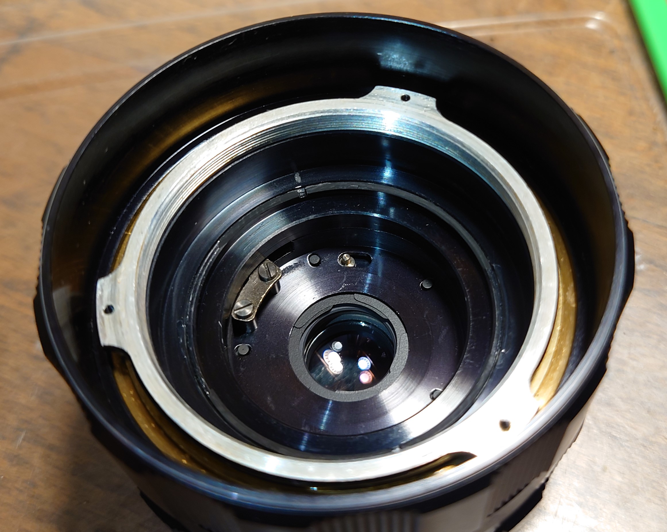

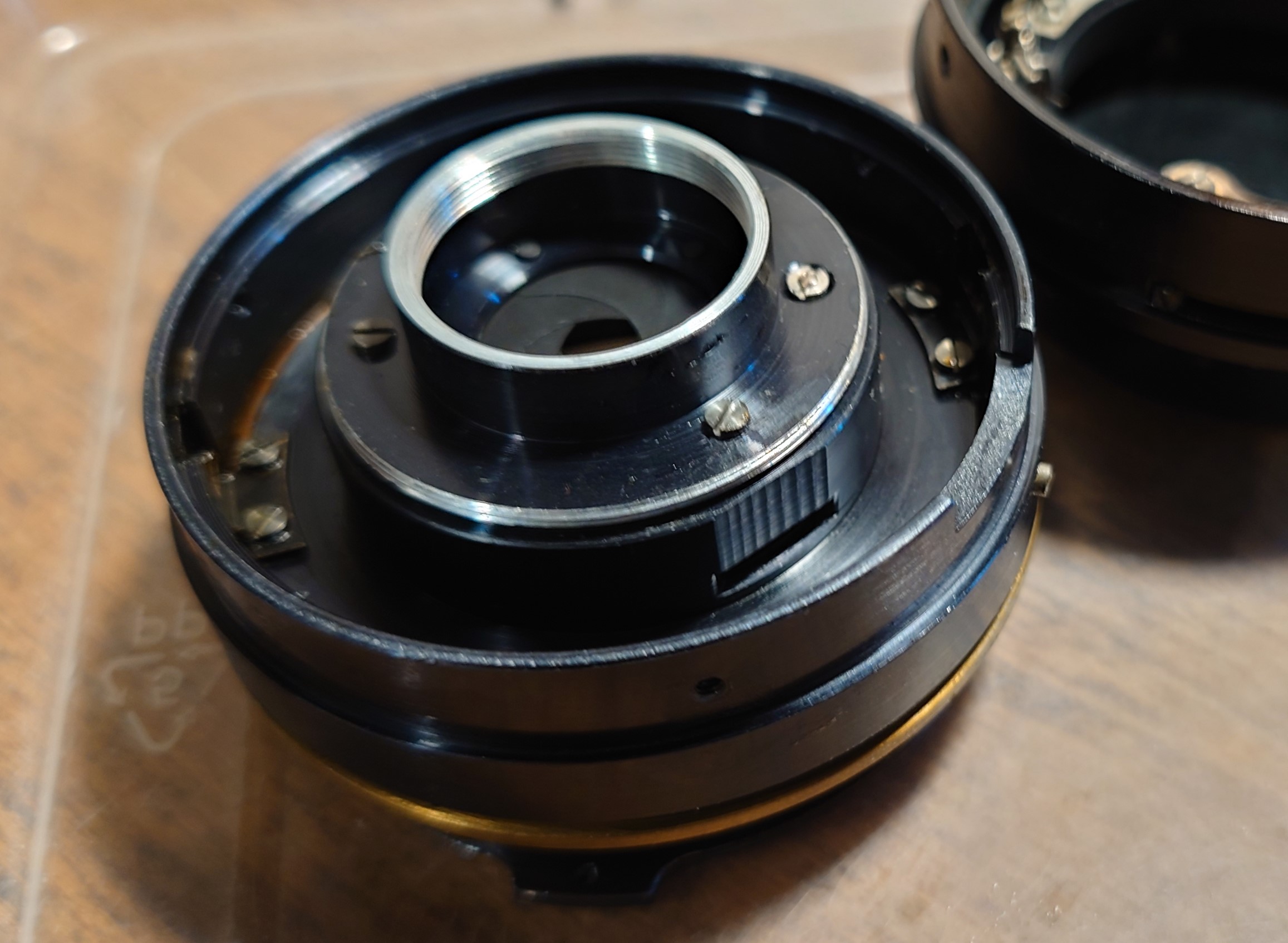

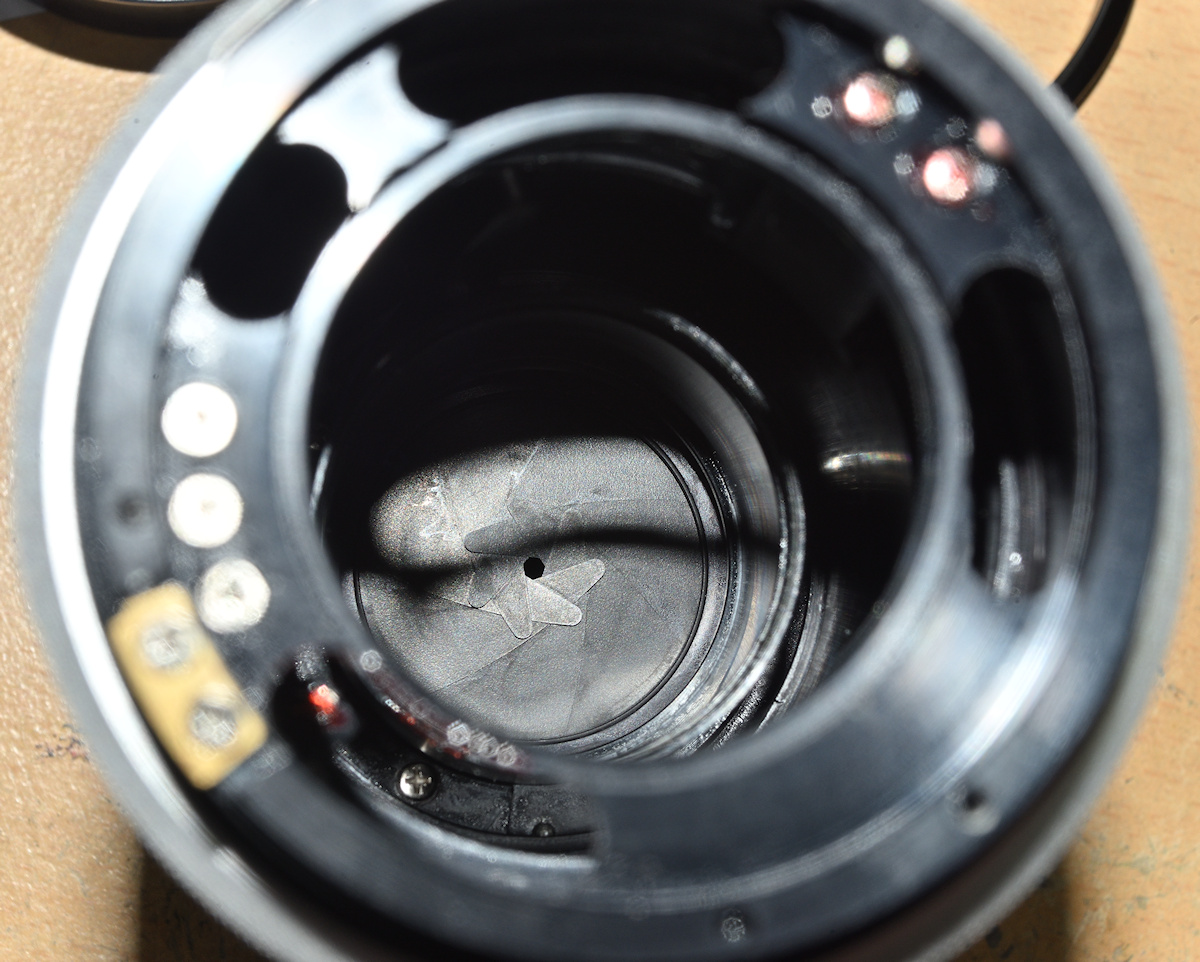

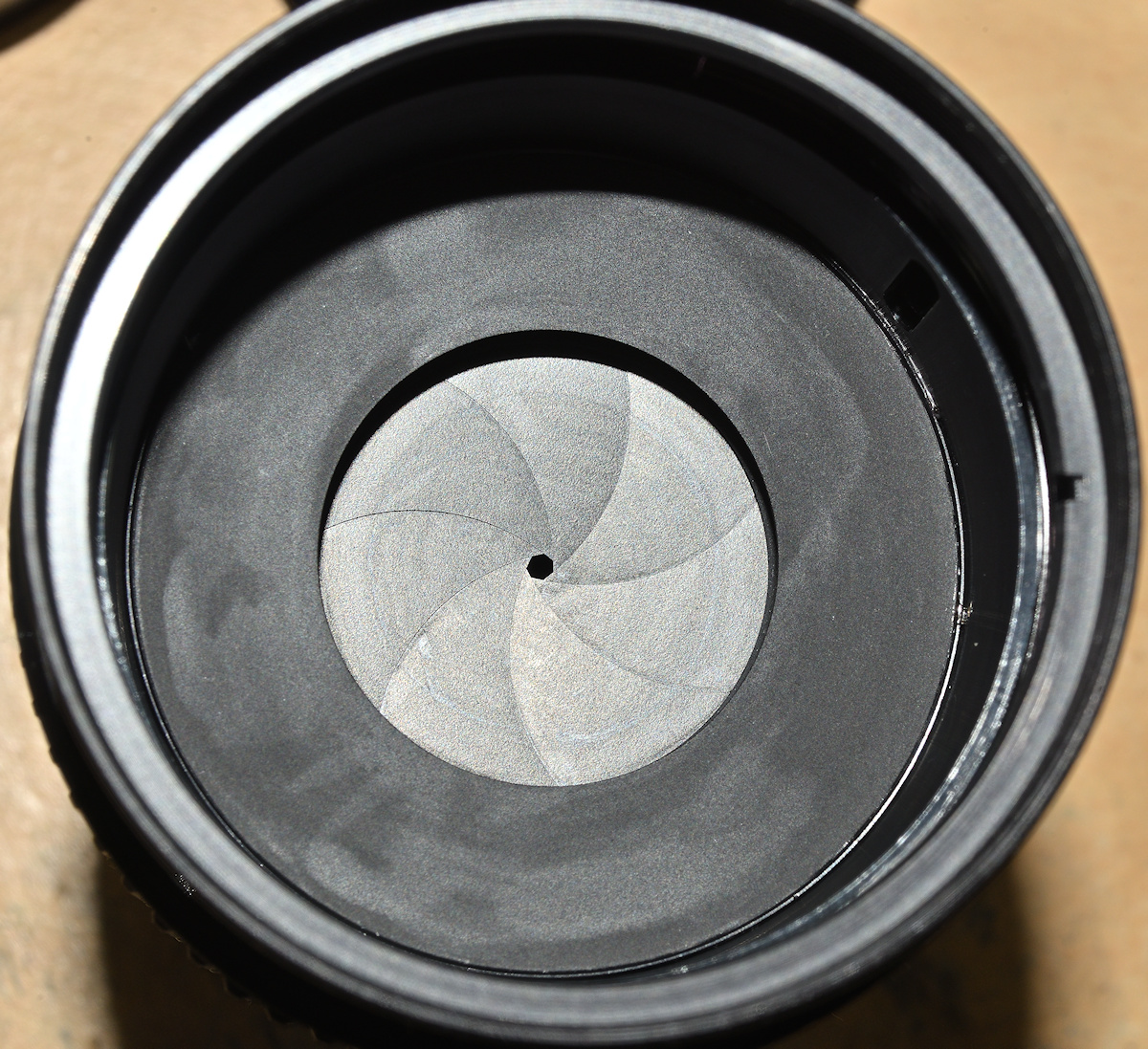

The 24/3.5 is another story. It has never been opened but the aperture blades not working .
To service a 24/3.5 one must beak the factory seals and remove the core unit completely with the focusing helicoids.
The aperture unit seems hold by 3 screws as if it could accessible from the bottom. It is not. These screws are just there to hold the non-tunable base of the aperture.
To take the blades out for cleaning , one has to remove the upper lens group, and a *sealed* retaining ring .
Before taking off the ring, make sure to mark its position . This ring is not tightened by default so that there are space for the aperture blades driving plate to move .

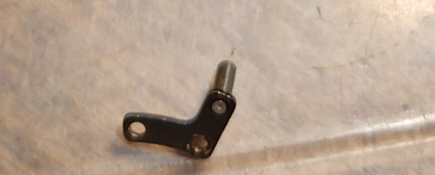

This driving plate also has 2 screws for the lever . The lever has to be taken off before the driving plate.
This is the area (the slit ) this this lever to comes out.
So after cleaning , just put all back in order. It is nothing special there.

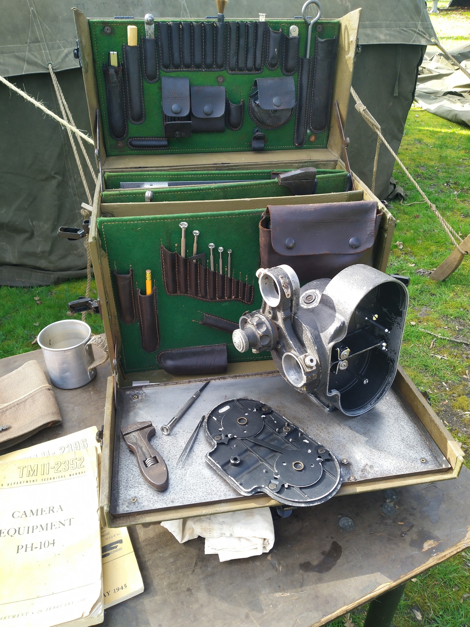

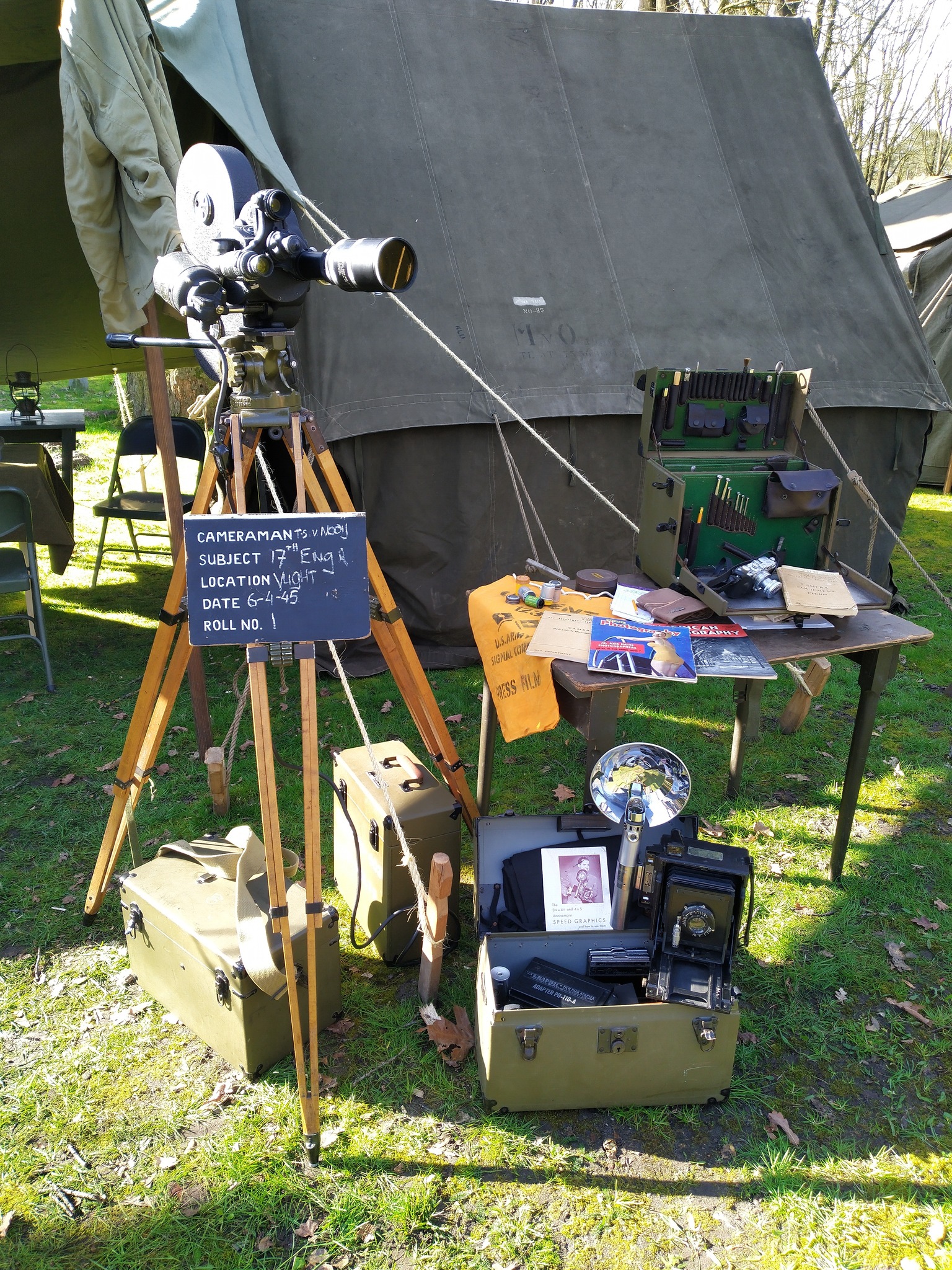

Making some process on restoring this (Aerial?) Cameraman's Repair Kit.
Repaired bad joints, replaced missing corner protectors, patched up and replaced parts of the upholstery and added new 'feet'.
Fresh coat of olive drab and still working on painting the hinges and latches black.
Will probably get round to restoring the inside somewhere during the week. Mainly repairing some loose dividers and re-glueing some of the leatherette coverings.

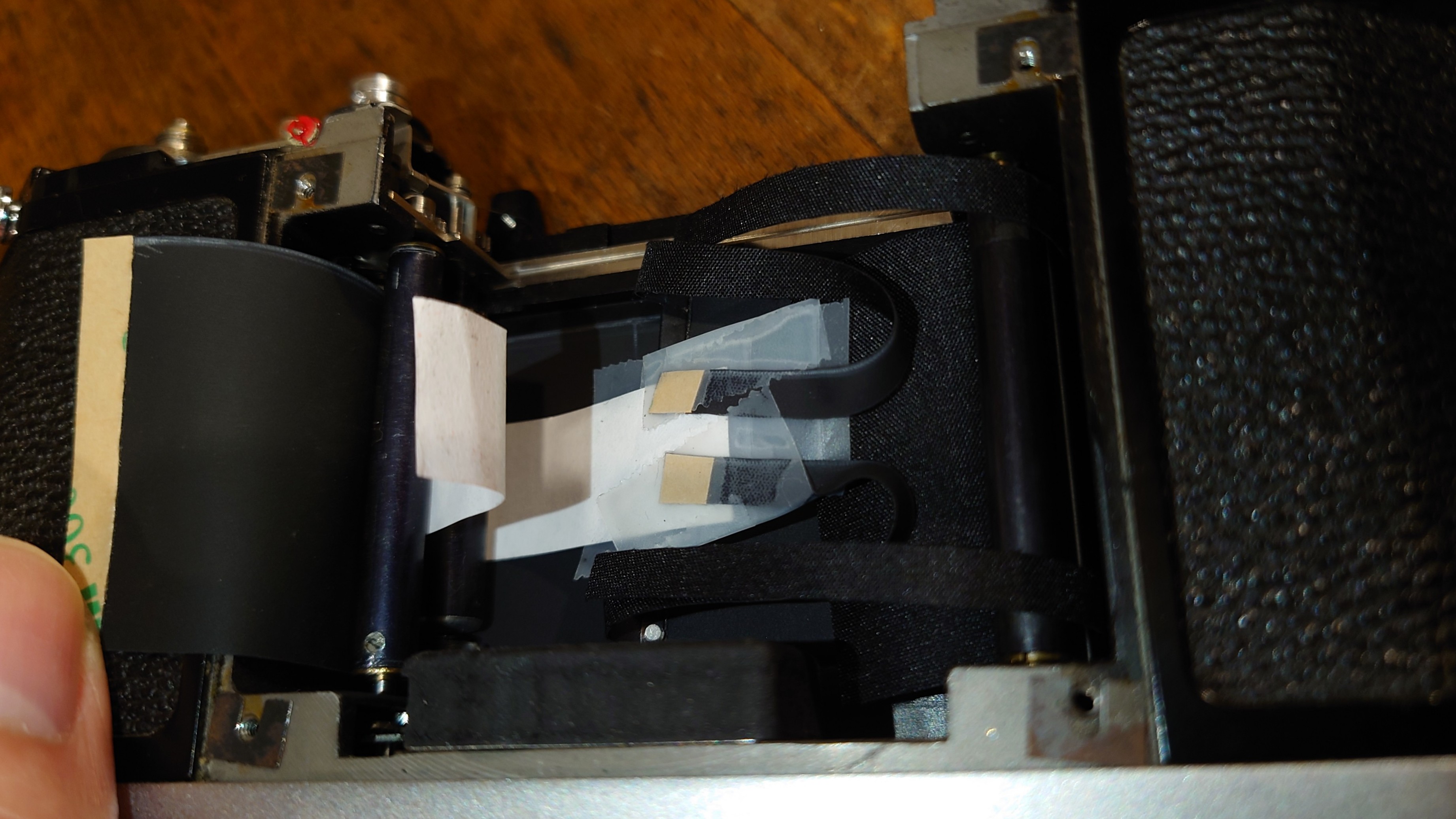

Changing the Pentax SV shutter curtain. Now I am adjusting the 2nd curtain( closing curtain) 's opening.
Also I am testing with double sided tape as well, this is 3M 300LSE , which believed to be the strongest I could ever found. The width here used is 5mm .
To draw the curtains ends over the rollers I just used a paper memo stick . It works better than a plastic film.

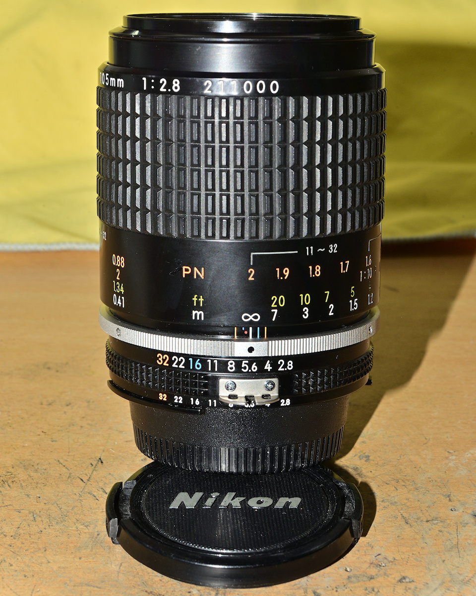

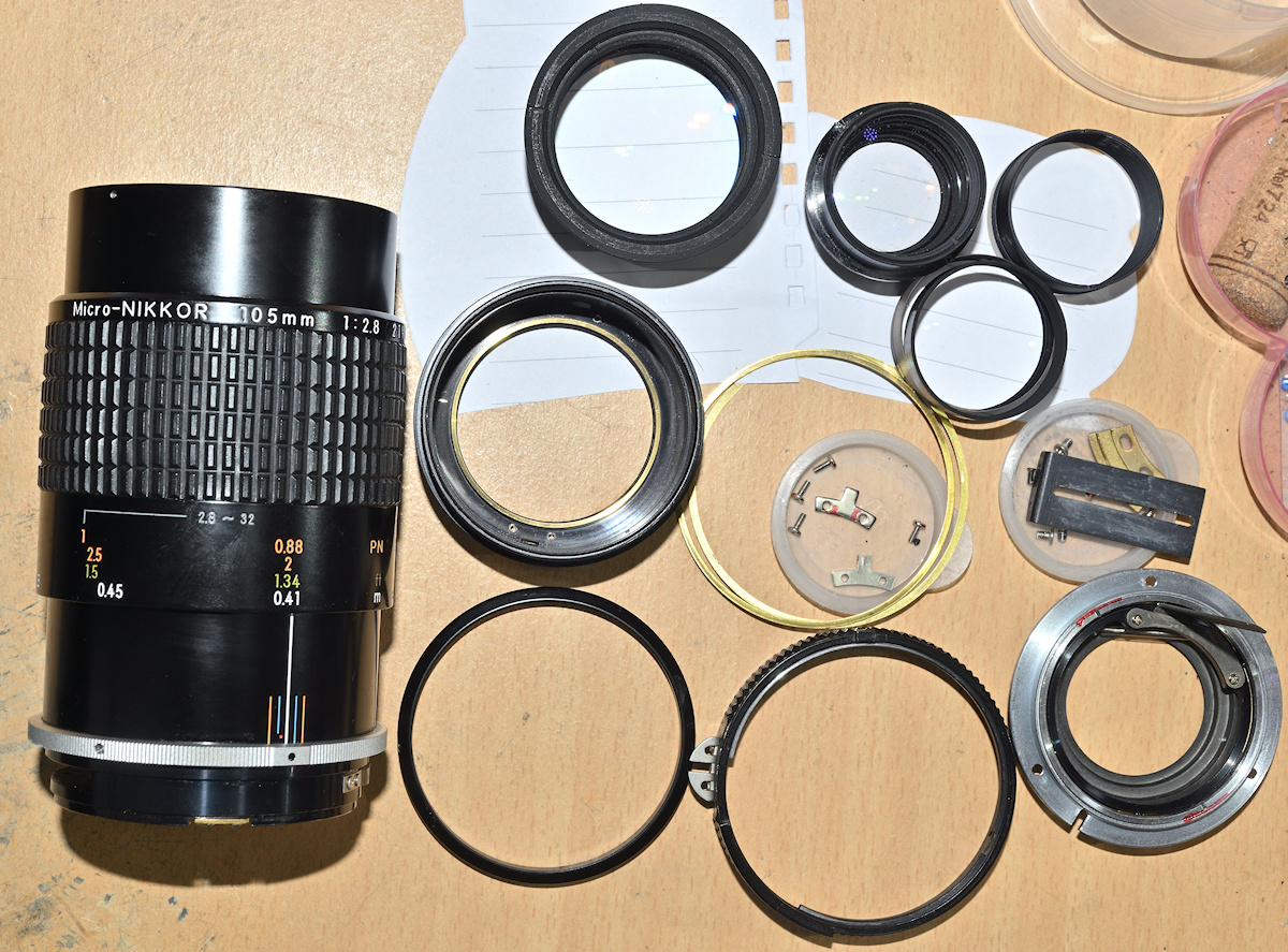

Yesterday I made an old Nikon MICRO-NIKKOR 105/2.8 useable again - the aperture was sticky with oil and the focussing was absolutely impossible due to hardened grease.

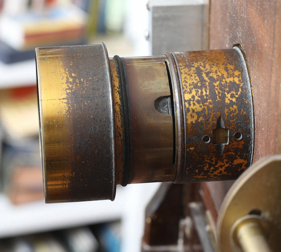

Made a lens board for mt Squire & C,o, Shepherd Maker 6" f4.5 Carte D'Visite Petzval lens. Initially I made a board to fit my 10x8 Agfa Ansco but found there was an issue focusing with my 5x4 reducing back. I could only focus without a Waterhouse stop,
The original Waterhouse stops would have had folding tabs. I'm missing the pinion fittings. Shepherd also began making cameras in the mid 1850s, these were sliding box cameras., Squire & Co appearto have taken over in 1864, going bankrupt in 1867.
So I then made a lens board for my wide angle ore-Anniversary Speed Graphic.
The lens was given to me attached to a 1930s professional Ensign lantern slide projector, along with a few hundred lantern slides, there is only one image with an early car, there's a Royal Mail coach in one shot, they seem to will date to the 1890s early 1900's.
The owner/photographer F.W. Pilditch, was a neighbor of my friends father's family, he was secretary of Aston Photographic Society in 1898.
The lens itself is a well corrected Petzval with no swirliness :D Now to get some Waterhouse stops made and shoot with it.

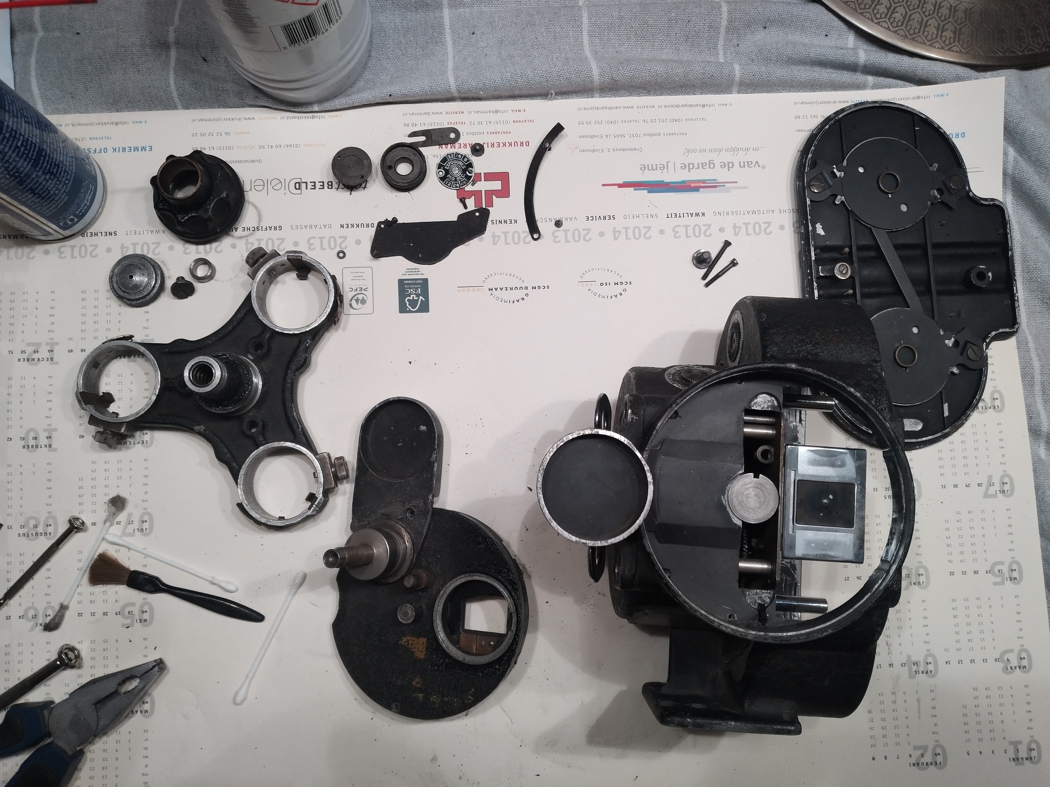

Received this Bell&Howell 71-Q Eyemo last week, used by the US Army Air Corps in 1941 as the A-3 Bombspotting camera.
It was starved of fresh oil, suffered from hardened grease and a bit of oxidation.
So I spent a few hours up to my neck in Eyemo guts. Luckily I had the technical manual at hand.
It is missing a set of screws, the ball bearings for the turret lock and the gear and cover for the external motor drive / rewind crank. Nothing that prevents it from working though.

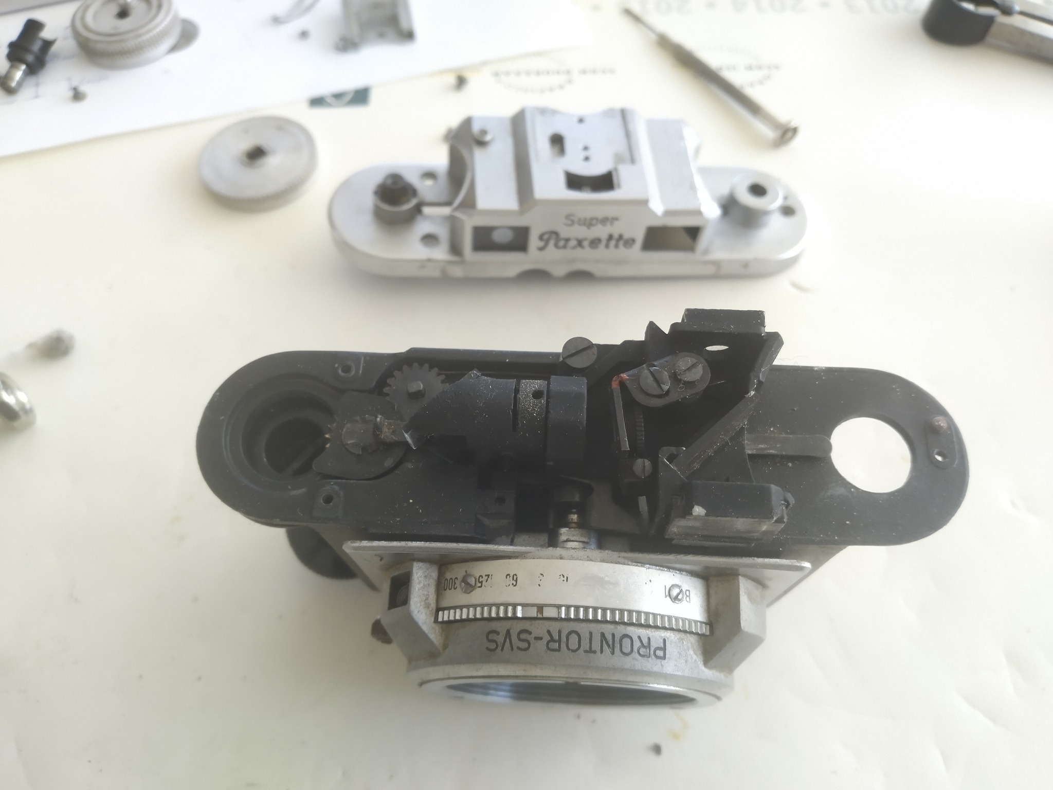

Revived this Super Paxette II, before I send it off to a friend who's daughter showed some interest in old cameras.
It seems to have suffered from moisture damage at some point in its life.
Cleaned off a lot of surface dirt.
I freed up the slow speed escapement which brought the thing back to life.
Reapplied the shutter speeds, printed on a strip of paper covered with tape.
Cleaned the haze out of the lens
VF is still a bit murky due to the deteriorated half-mirror.
Also sending along a Voigtlander Vitomatic and Vitoret and a couple of rolls of expired film.

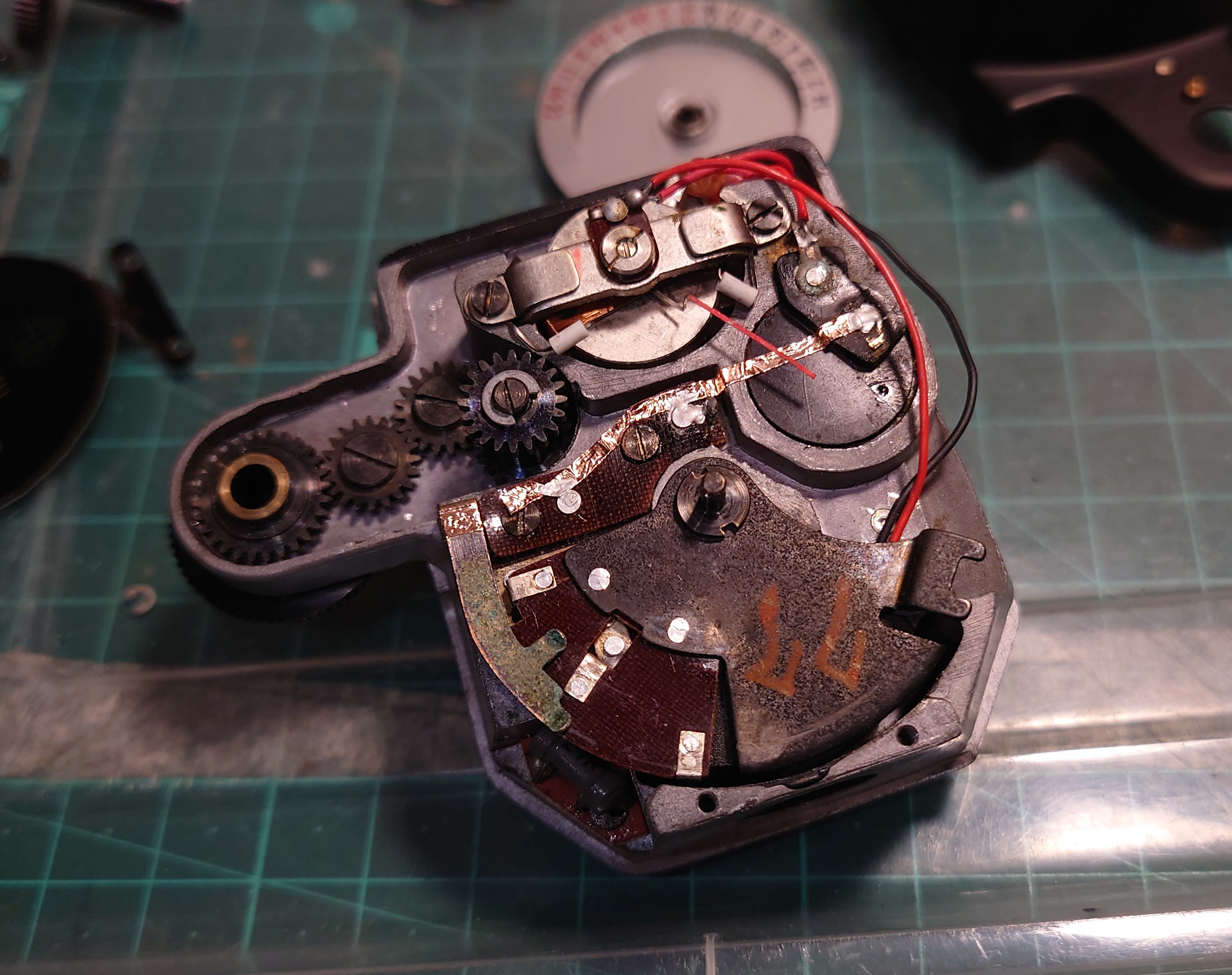

I don't like rust on copper and so as the old solderings that can't be desoldered. Thank for today's teach I can remake it work in this way:
Single sided copper tape with electric conductive adhesive that do this job. It is not a perfect but still works.
It is a Pentax Meter (round shape, with batter check function) designed for old S3/S2 models.

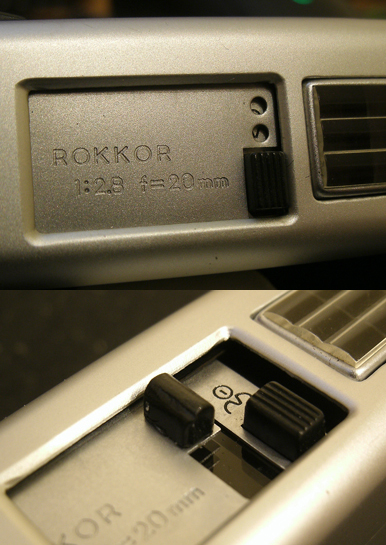

I acquired this Minolta-16 MG, a few weeks ago, and didn't notice that the sliding lens cover was missing its knob. So, I made another one with a piece of hard plastic that I shaped with my rotary tool and glued into place with a minute dab of Shoe Goo.
