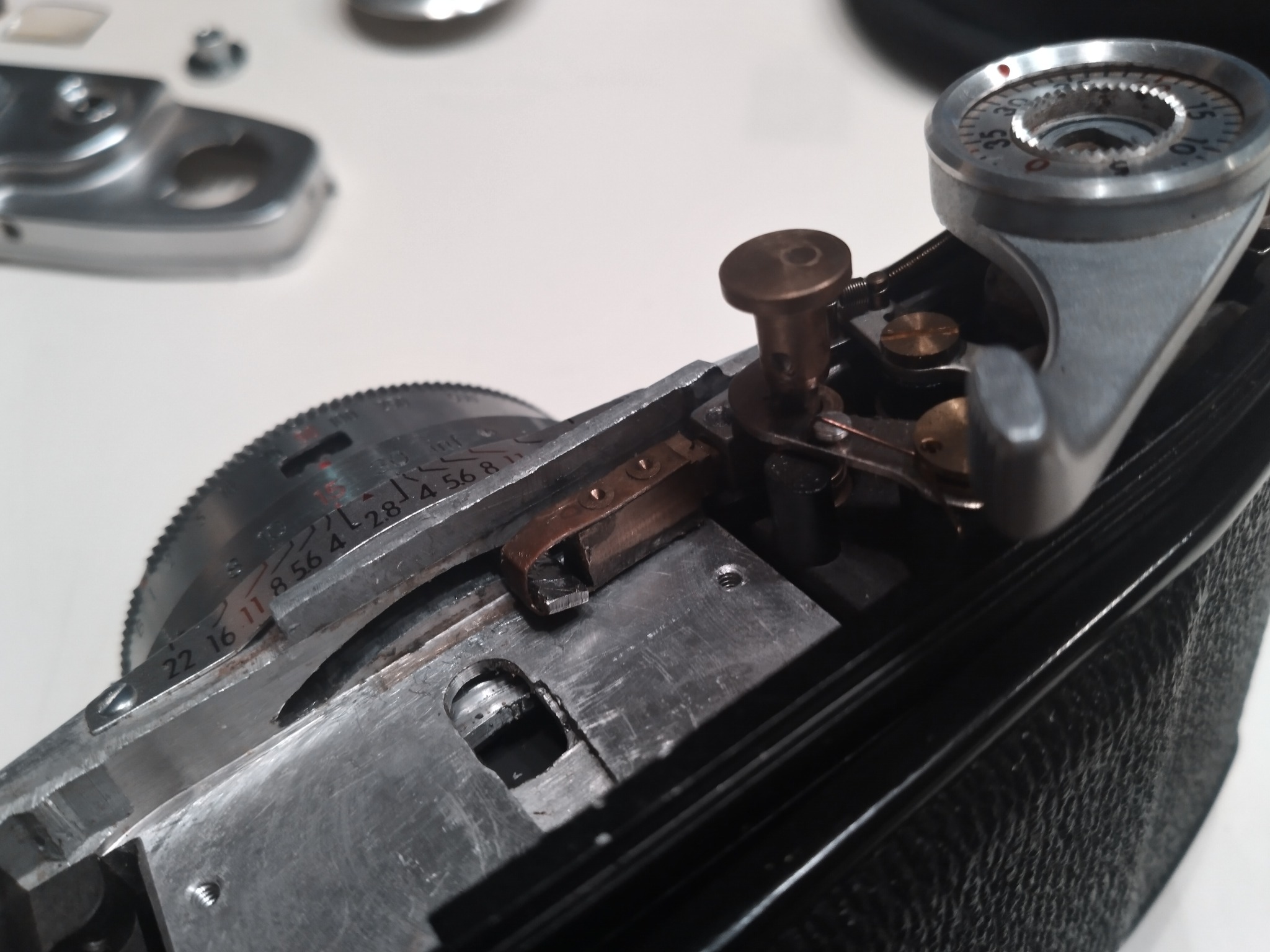

Someone gave me a Graflex Century 35 / Kowa Kallo 35 earlier this week. They missed the fact that it wasn't working when they bought it.
Winding crank was jammed, shutter release was blocked.
The push bar linking the crank with the charging lever on the back of the shutter barrel had become disconnected somehow.
Then someone probably had tried to crank it, HARD, bending the lever and jamming the push bar between it and the rangefinder unit.
This in turn prevented the crank from unlocking when you press the release.
After bending it back and hooking it back up, it seems to work as it should.
The bar needed a little adjustment to fully cock the shutter.
One part in the shutter itself was a little sticky as well, but that cleared up easily enough with a little TLC and exercise.
So now I have a working Century 35. The Film Gods demand that I feed it some film soon.

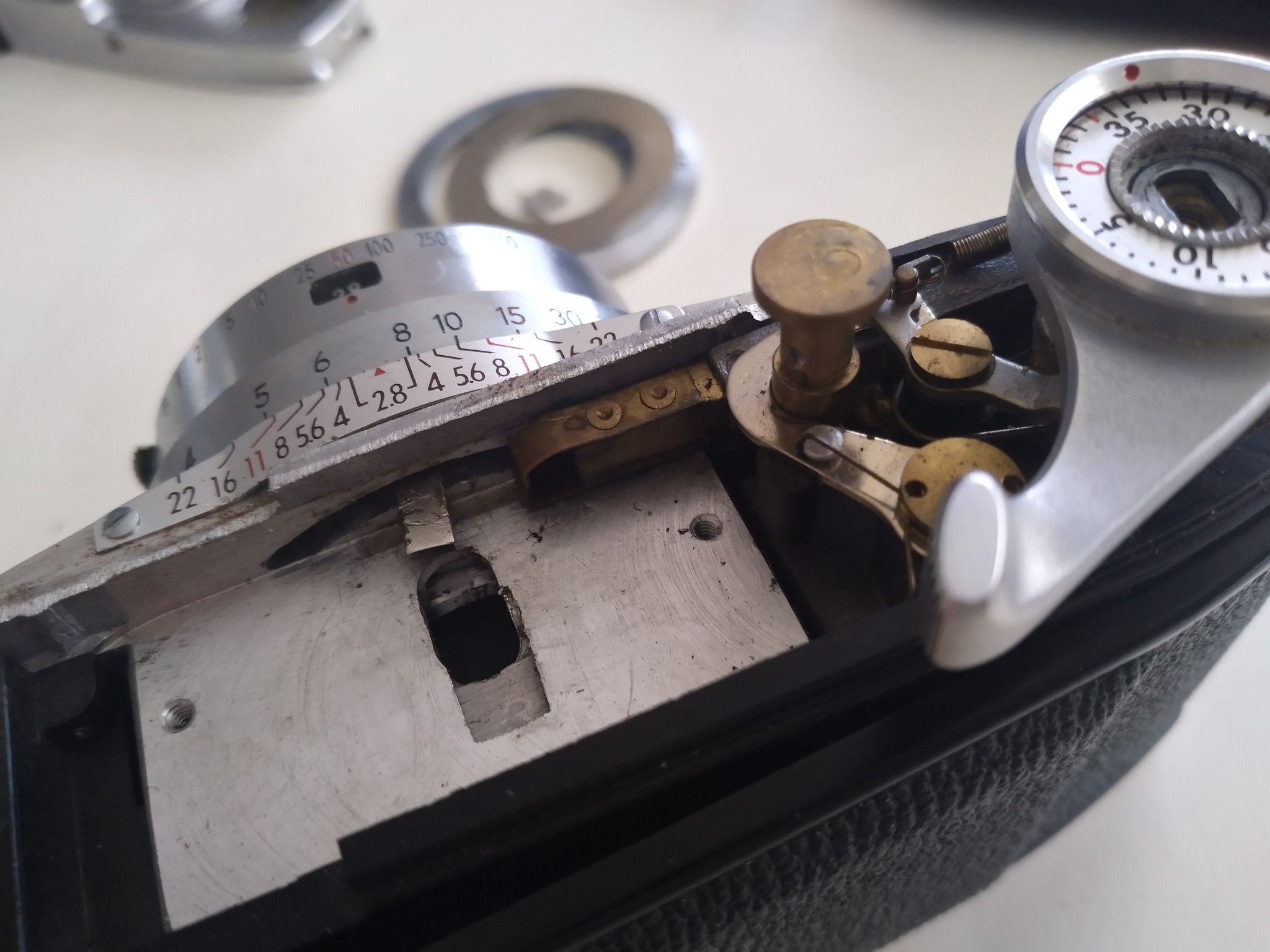

I bought a Kowa Kallo 35 for $13 2 weeks back. The problem was the film advancer. After tinker with it I found that the small spring that forces the hook around the shutter didn't have enough tension to engage. I see now from your photo that I was missing the grey piece on it too. I took a spring from another type of camera I have for parts and that fixed the issue. Had also to fix so the film advancer wouldn't slip and now it is working.
I just love the sound and feel of the film advancer on this camera. Will for sure put film through it.

Great! Glad my photo was some help with your own repair.

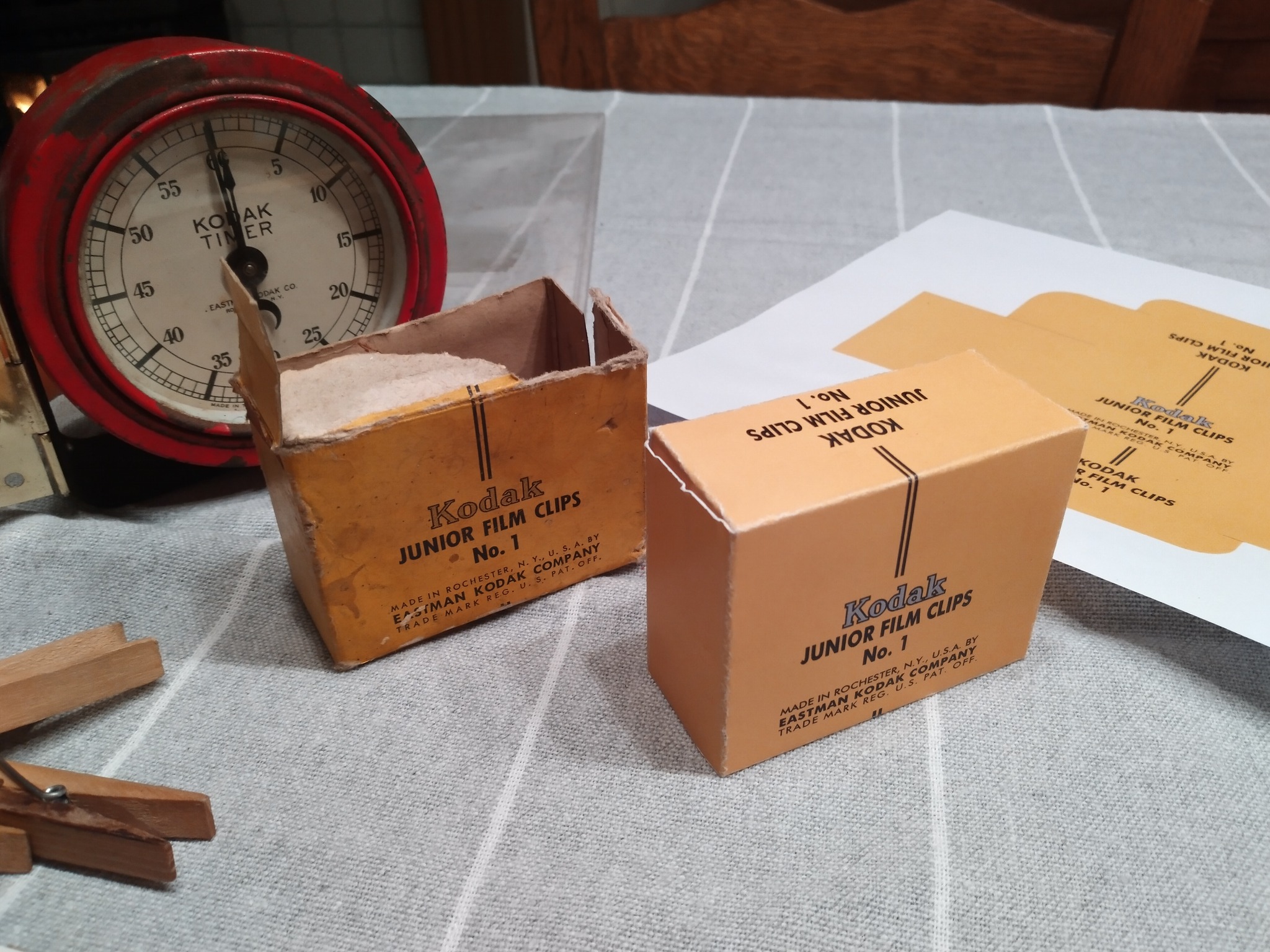

I crafted a replacement of my 1940s Kodak Jr Film Clip box No.1 to go in my US Army Photographic Set. A friend created the printable-PDF for it based on my original. He made PDFs of several 1940s film and chemistry boxes for me as well.
I also fixed the two spring clips back into shape that are inside the Kodak Timer so that it sits a bit tighter inside the bracket and no longer tends to falls forward all the time.

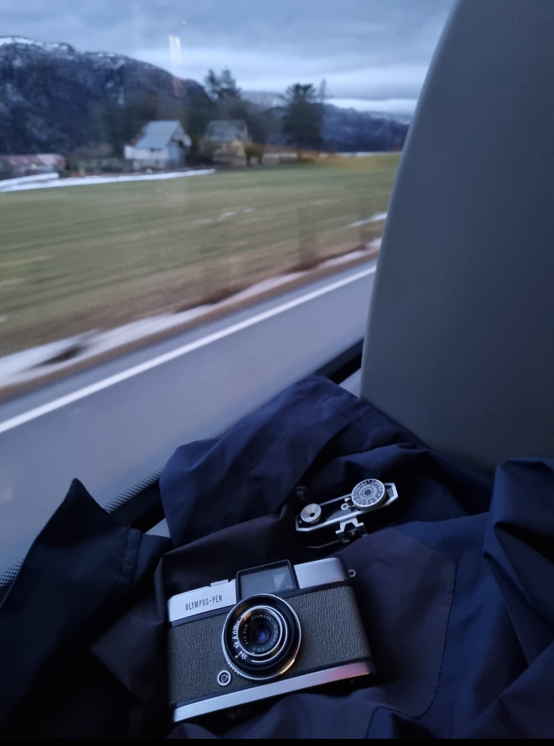

Repaired a broken Olympus Pen (original version). I am not sure it is 100% calibrated so will be interesting to see after 72 shots 😅
