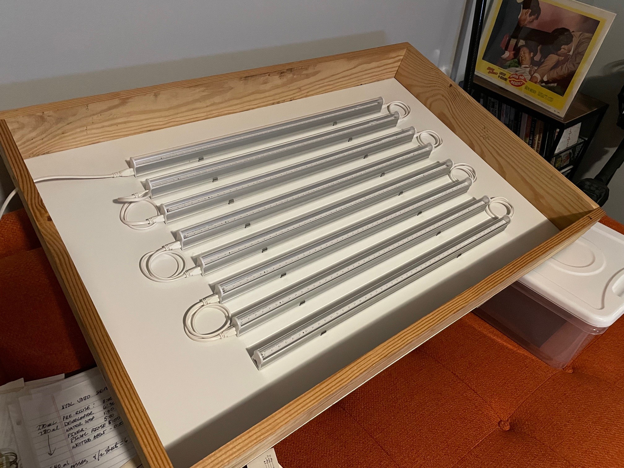

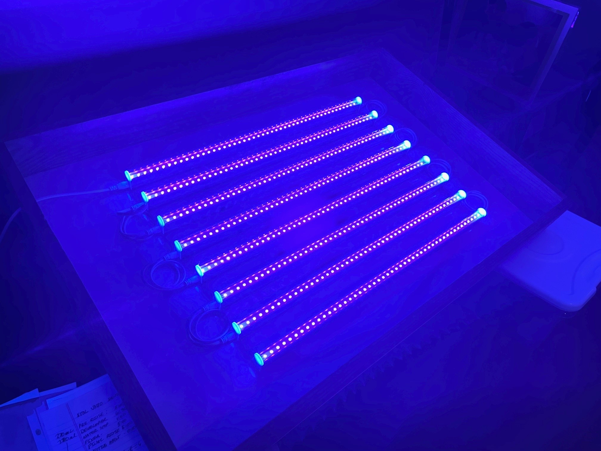

Top part of UV exposure box completed. Building a collapsible frame to allow for more compact storage. Running out of room in the darkroom...

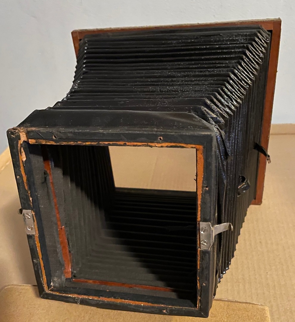

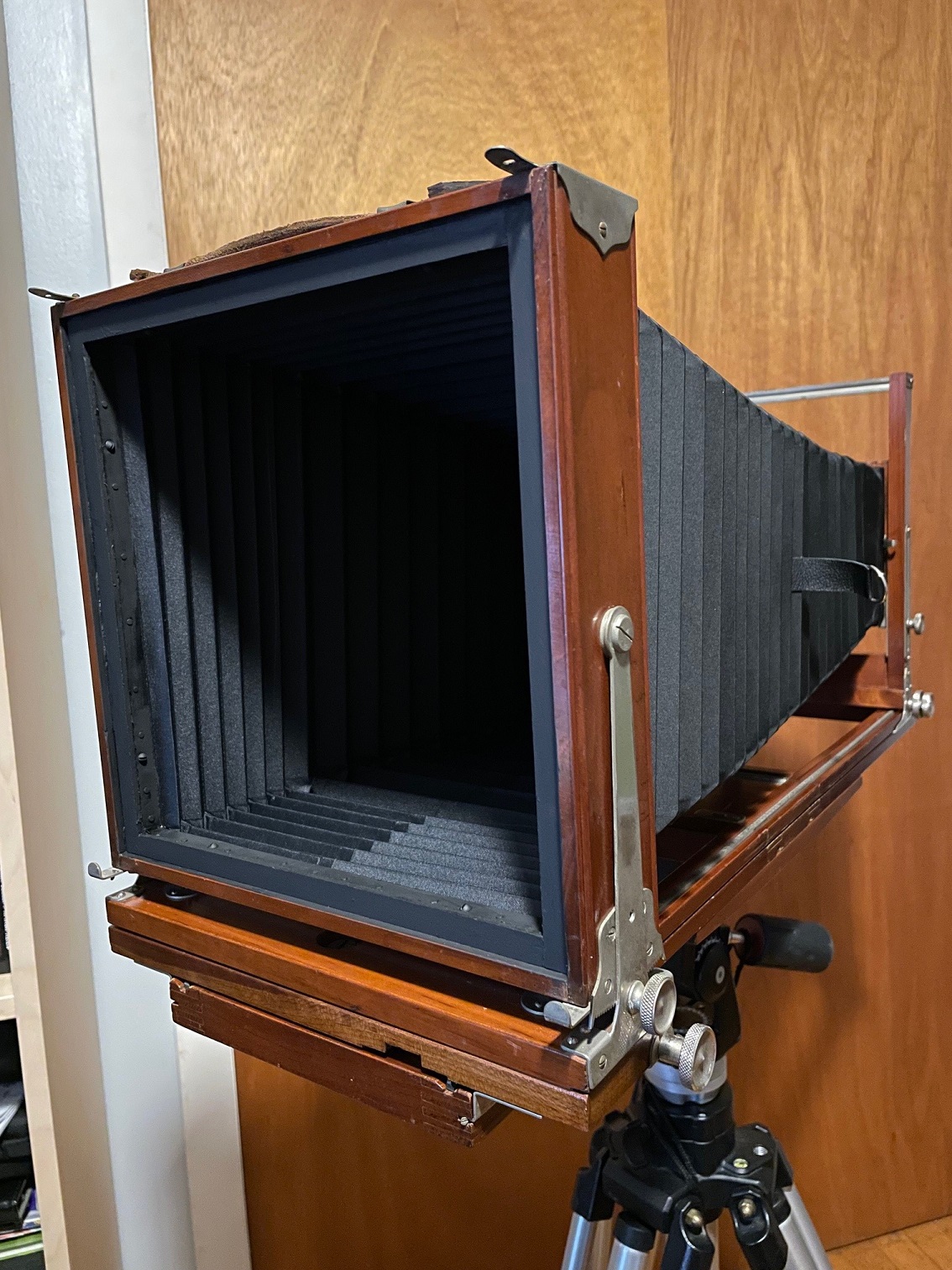

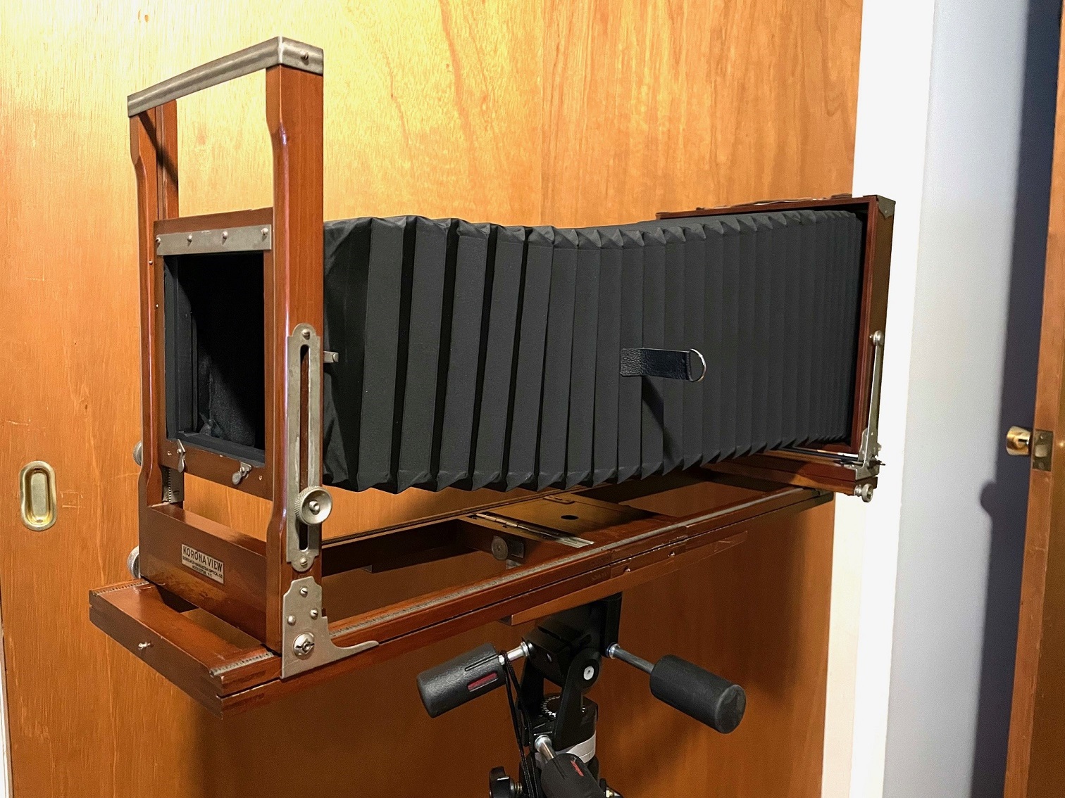

New bellows for the Korona Whole Plate finally installed and interior woodwork repainted. Removed Packard Shutter; will use it in front of any barrel lenses I decide to try.
The bellows frames fell-apart when extracted from the old bellows, so I had to re-glue them. Trying to decide if I will remove and polish the bright work. Don't know if I want to chance the woodwork falling apart, but the nickel plated steel is pretty dull.
Old bellows in frames to illustrate...

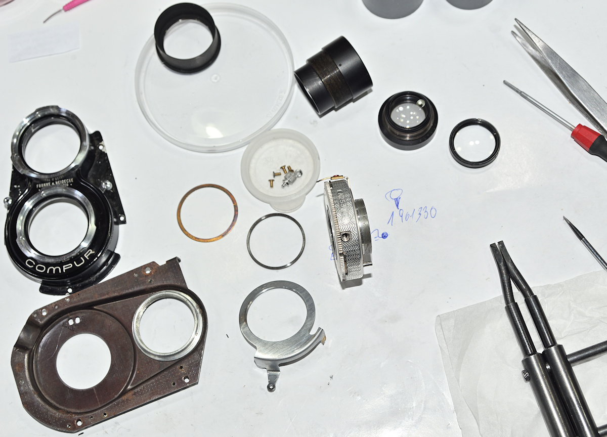

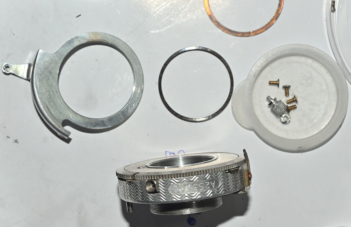

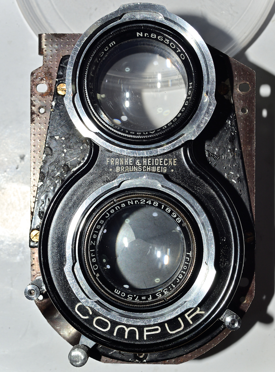

One of my customers sent me the front plate of a FRANKE & HEIDECKE ROLLEIFLEX 3.5 (he refurbished the body himself) because the aperture was stuck wide open and nearly no shutter speed was working.
So I disassembled the plate and the shutter & aperture cover, cleaned everything from hardened oil and assembled all parts again.
Now it works fine.
Now it works fine.

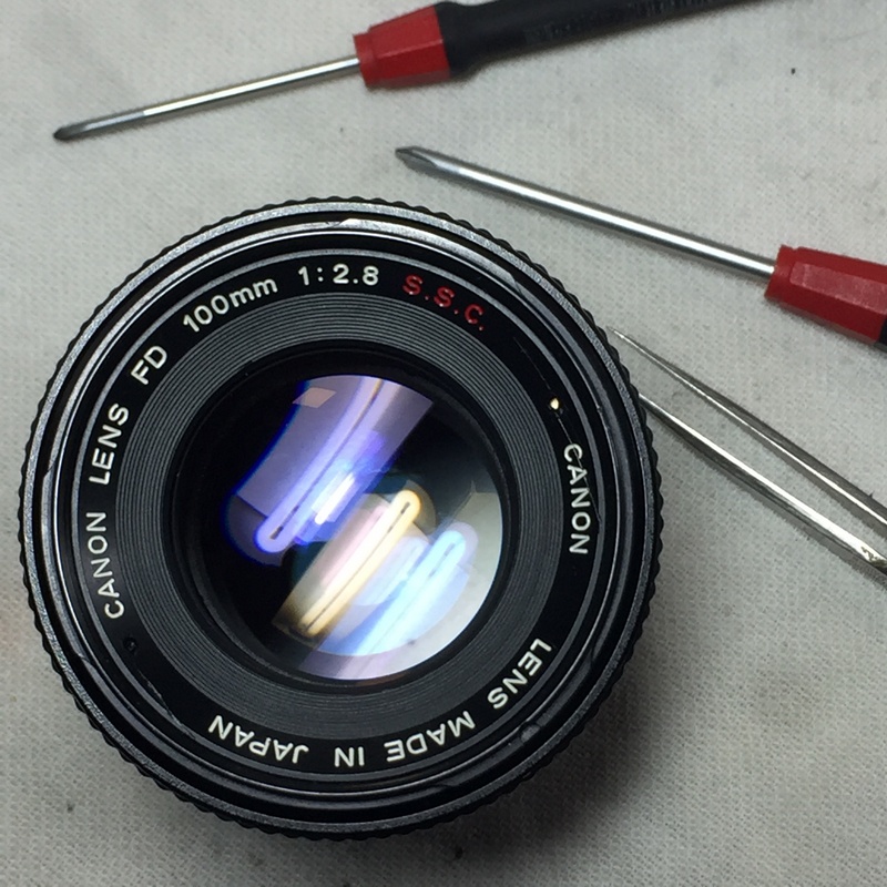

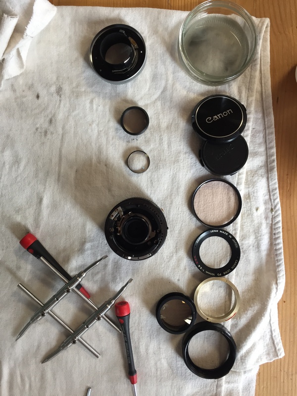

Partial dis-assembly of FD 100/2.8 SSC for
  • Cleaning dust on optical surfaces, left from previous intervention on aperture blades;
  • Cleaning the breech ring, not turning freely because full of grit/grime.
Very helpful videos by mikeno62. Three screws fastening the breech were quite stiff; must buy proper JIS screwdrivers, because exact fit to the screw is crucial in difficult cases.
