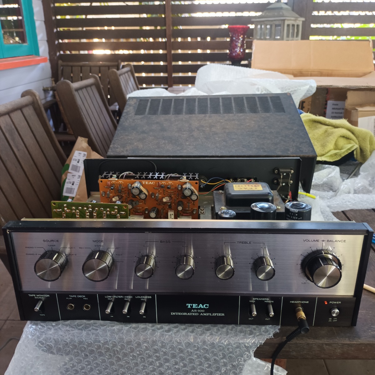

On the other hand I bought a rather neglected and dusty TEAC AS-100 amp. I already have one and they are great, built like a tank. They generally go for good money these days, got it cheap because of the appearance and the fact the seller said it was down a channel and the switches and pots were noisy, sold as junk.
View attachment 361076View attachment 361075View attachment 361072View attachment 361070

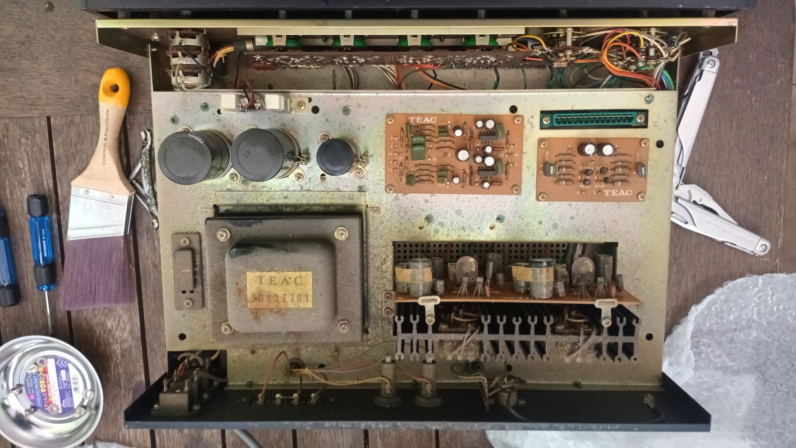

Must of been sitting in a shed for a very long time, but cleaned up nicely.

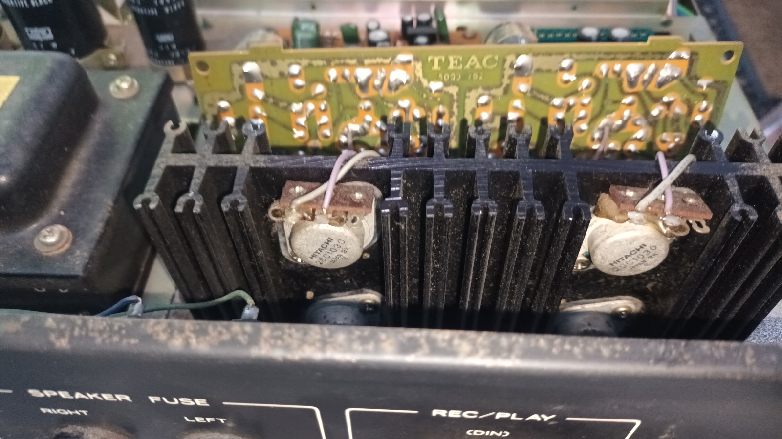

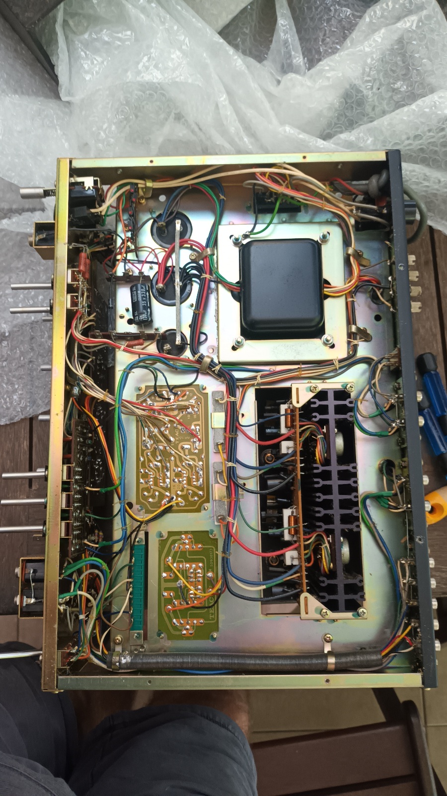

The underside was spotless
The circuits are original and unmolested

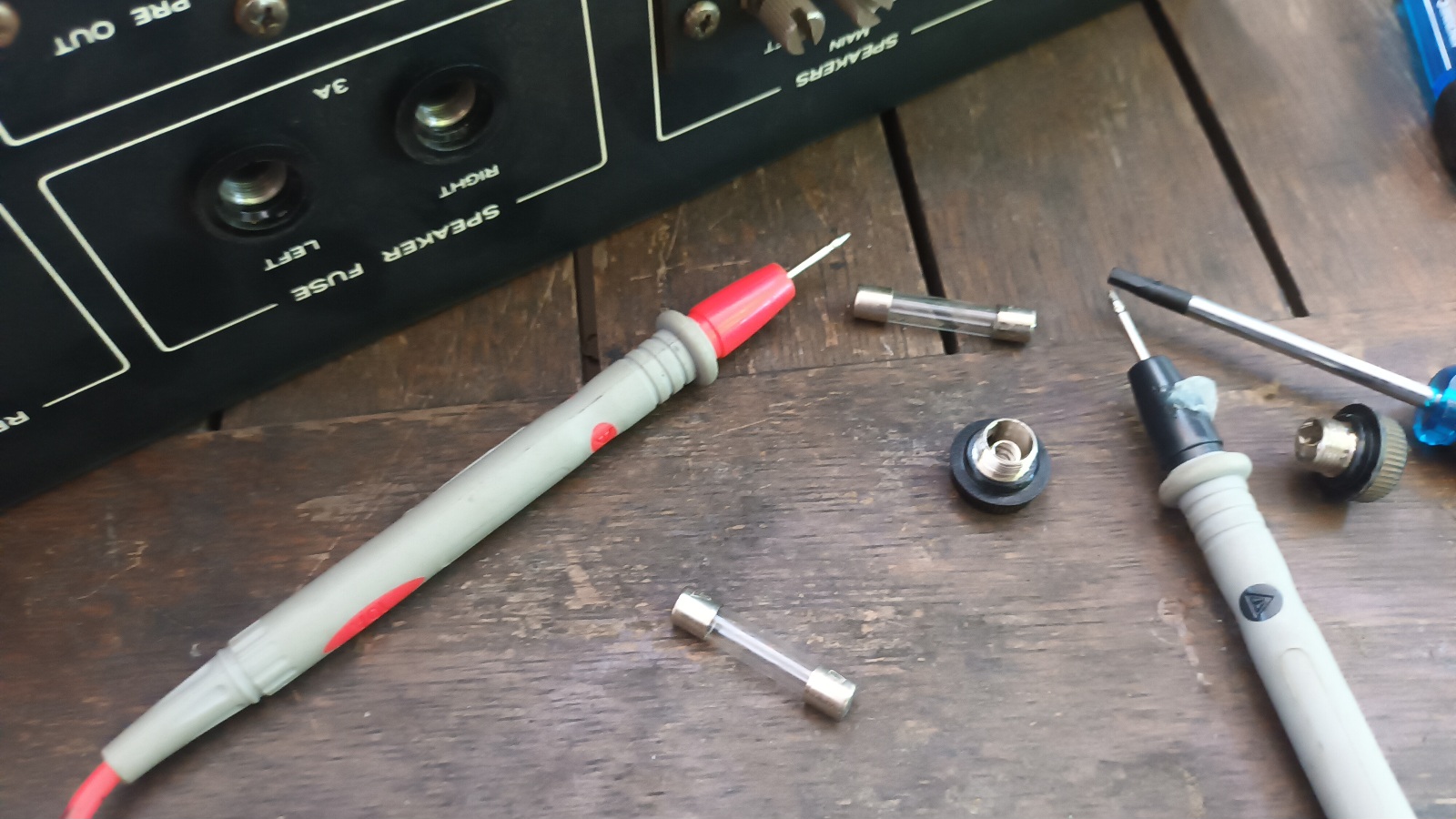

One speaker fuse was blown, hopefully the cause of the bad channel.

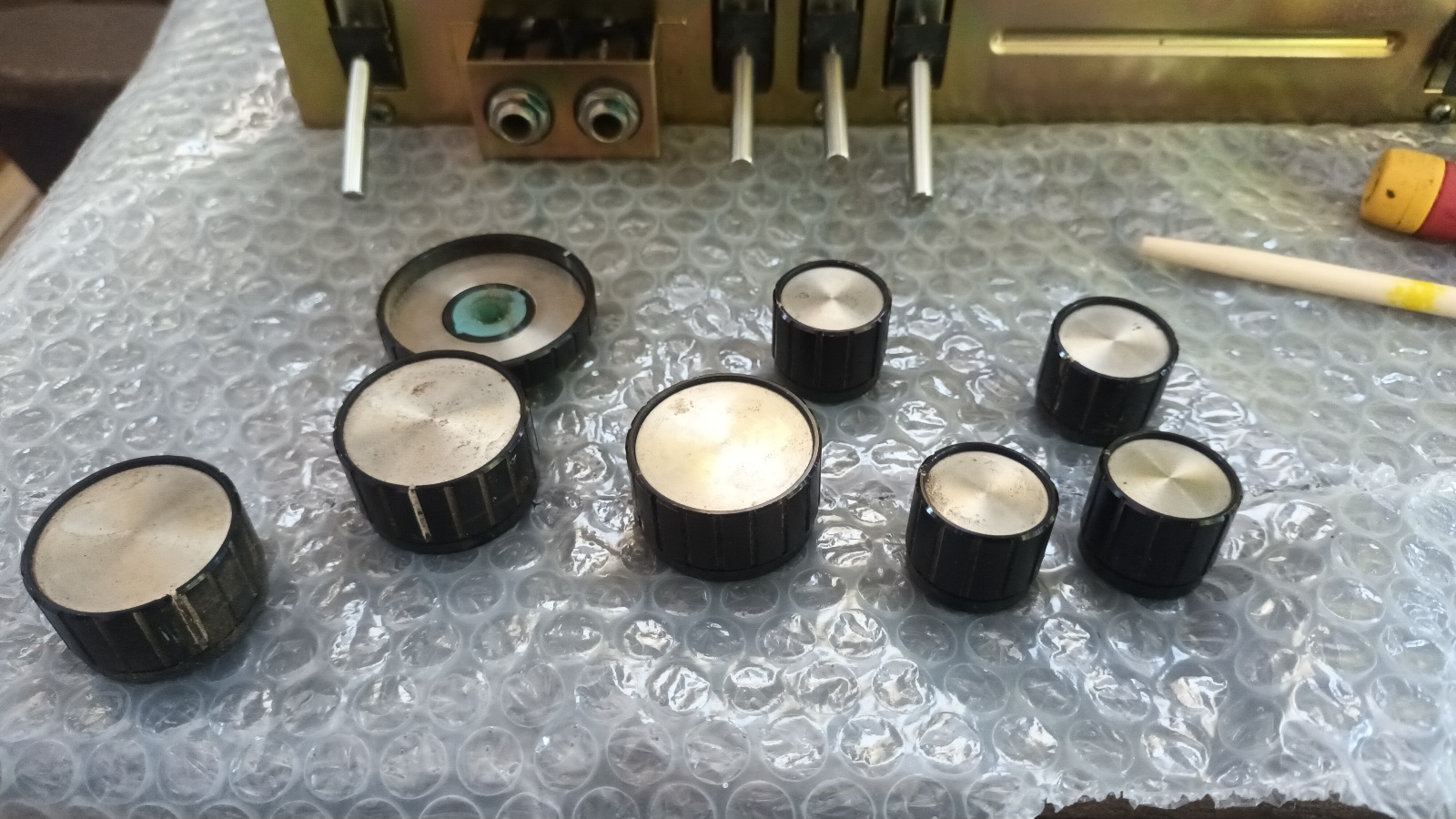

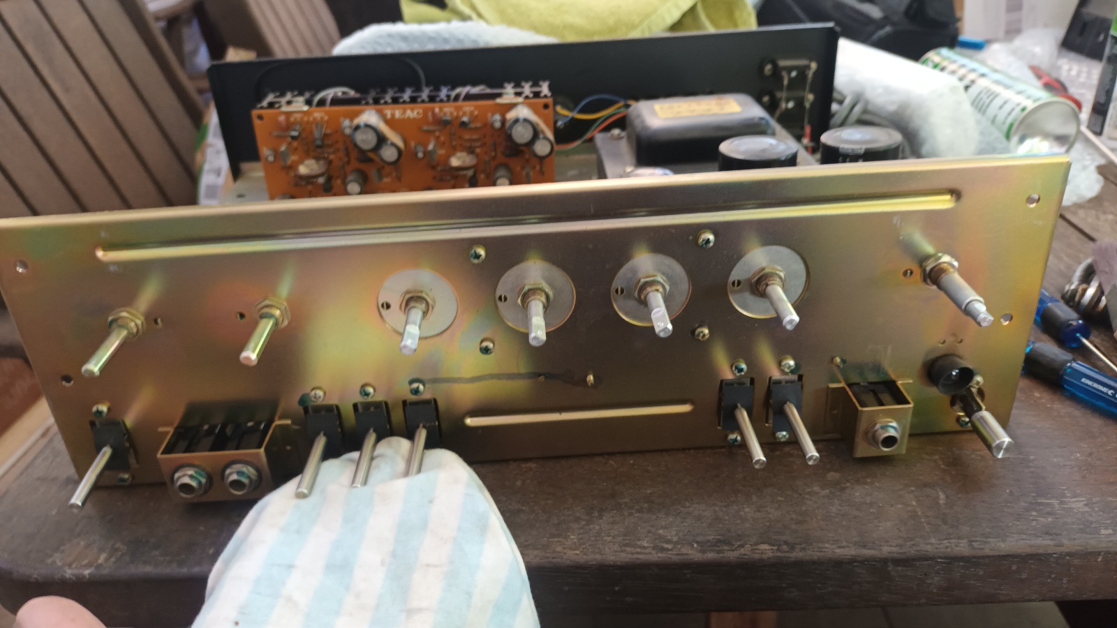

Dirty knobs.

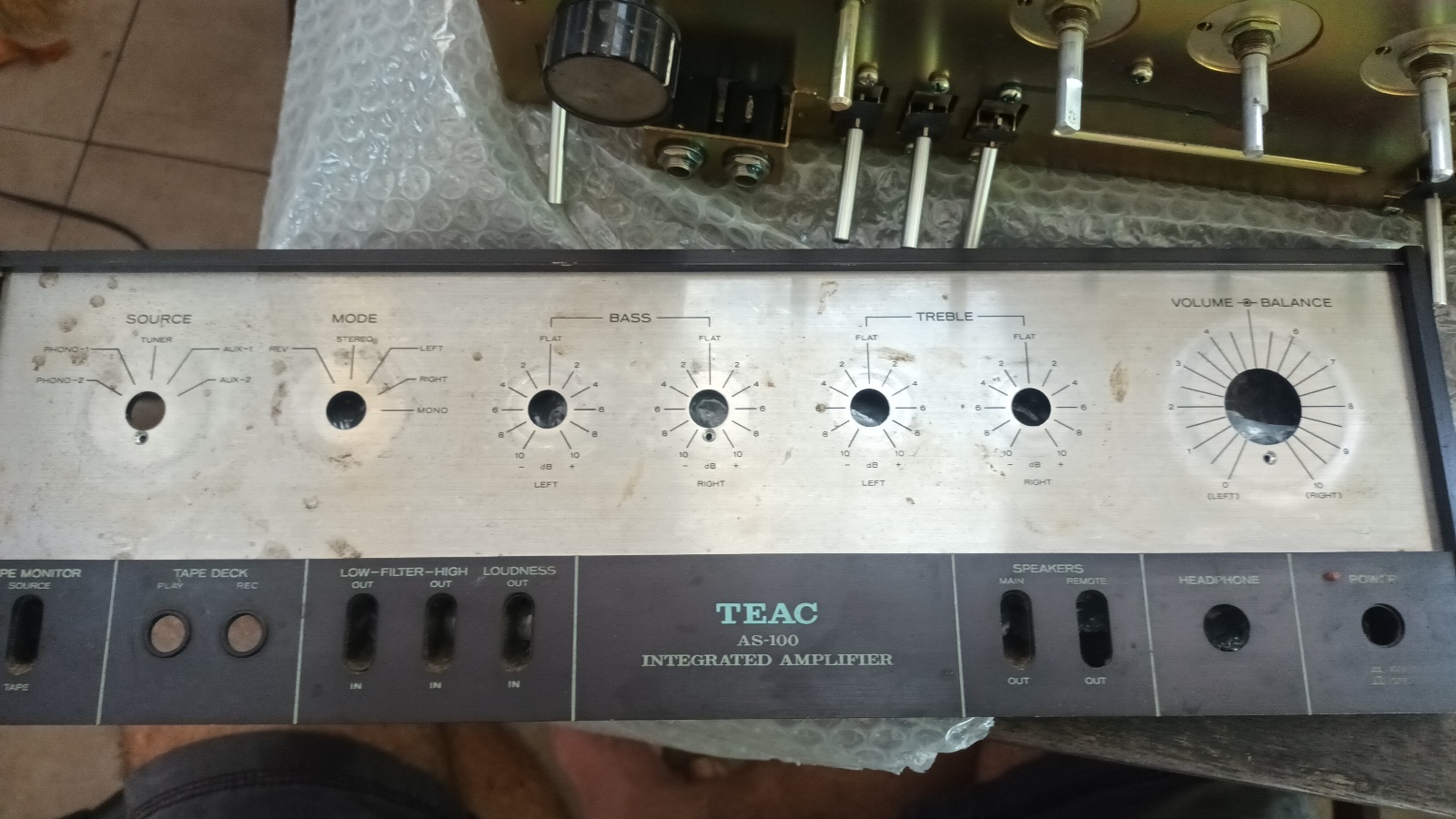

Cleaned face plate

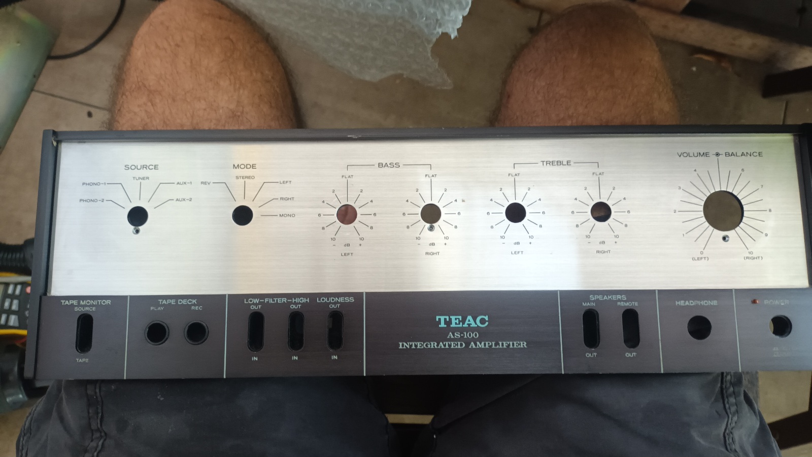

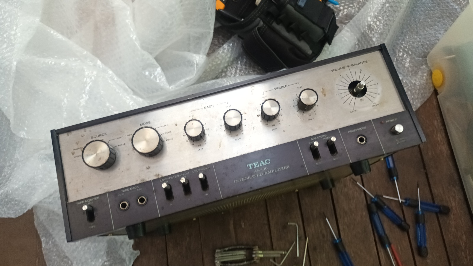

All cleaned up, cleaned the Pots and switches and all is working again and sounding good. Need to repaint the metal shell.
Impressive, you still have space to work here and you can see individual electronic components and their connections.
However, I would be afraid of the mains voltage present 🥶
I have good eye sight and great restraint for not putting my hands where there not supposed to be. I didn't power the amp up till after it was cleaned. I think that would give the caps plenty of time to discharge.
It's a nice solid well built amp I thought might be interesting for someone.
I've been building and repairing amps, record players, tape players, pre amps, tube amps, projectors etc. as a hobby long before I started photography.
It was just a basic clean up, I'll make sure to put up a warning if I show anything real scary.

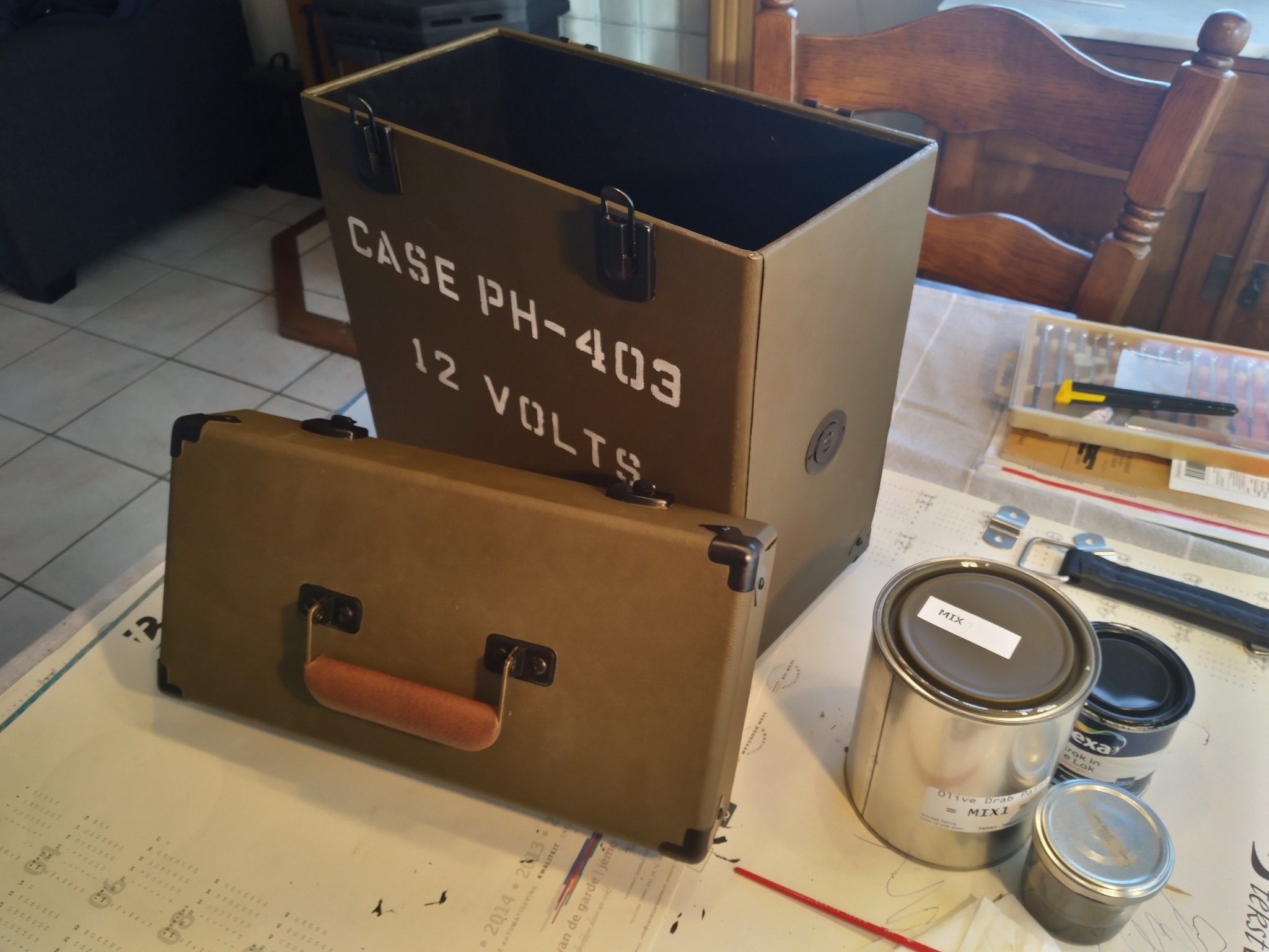

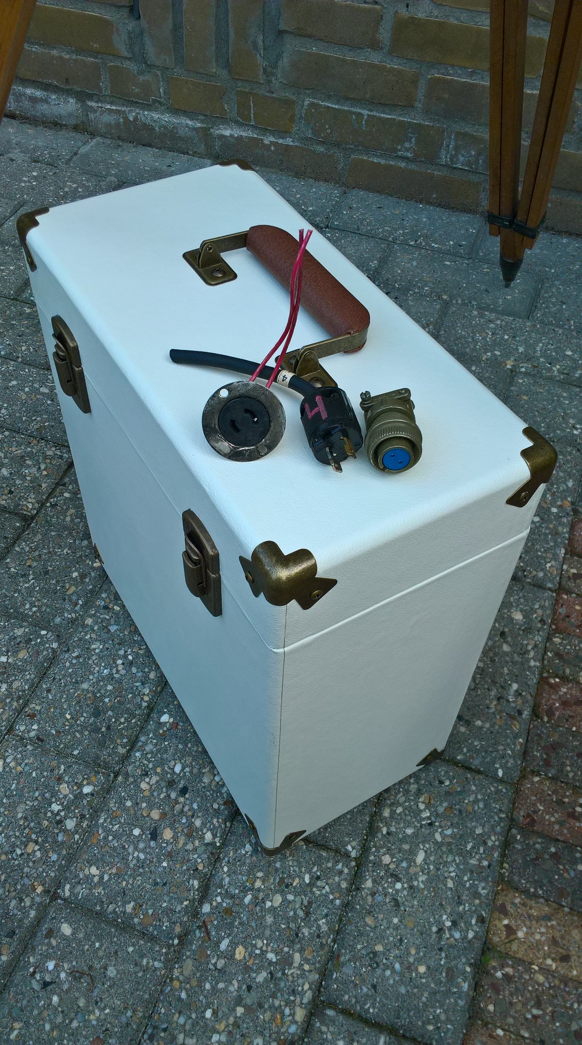

Beautified a DIY battery box to power the motor-drives that attach to my military B&H Filmo/Eyemo cameras.
I've never come across an original of one of these cases, so I made one from a LP-carrying case and a Hubble Twist-Lock connector.
It houses a couple of gel batteries.
Ordered a reproduction nomenclature tag for it.
Nice. I have never seen one myself, and that's coming from someone who attended a University that their film equipment collection consisted mainly of WWII surplus B&H 16mm cameras. There were many of the detachable motors, but we tended to just use the spring wind motor.
Now I have seen many Auricon and Maurer "suitcase" battery packs for field sound recording; what a nightmare they were to use.

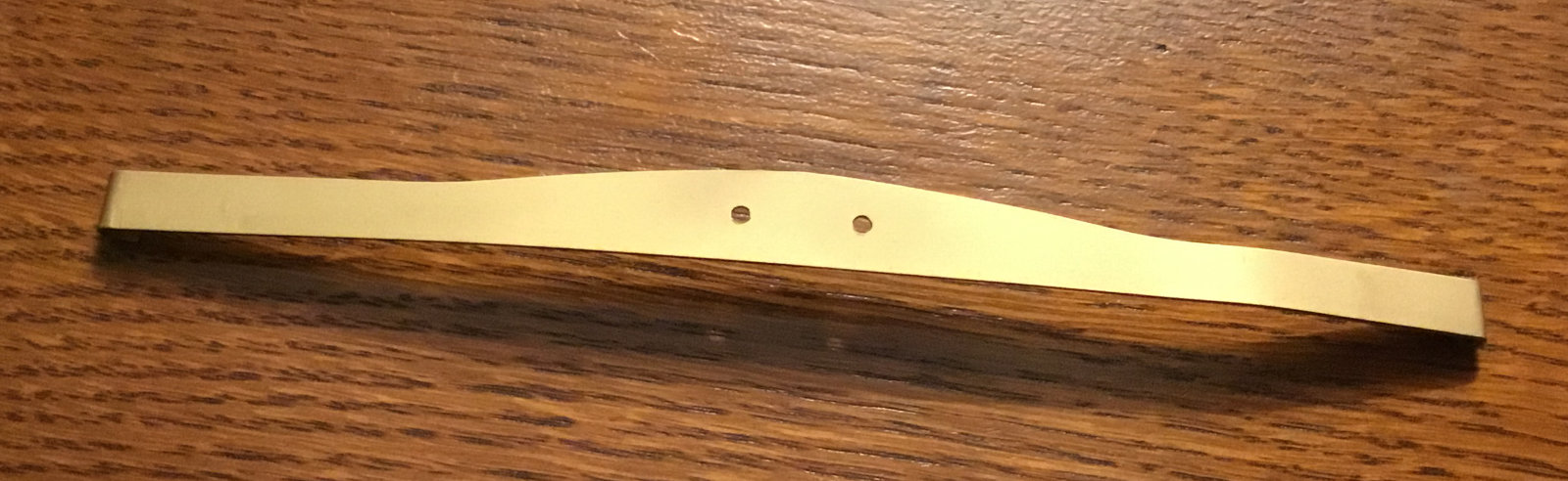

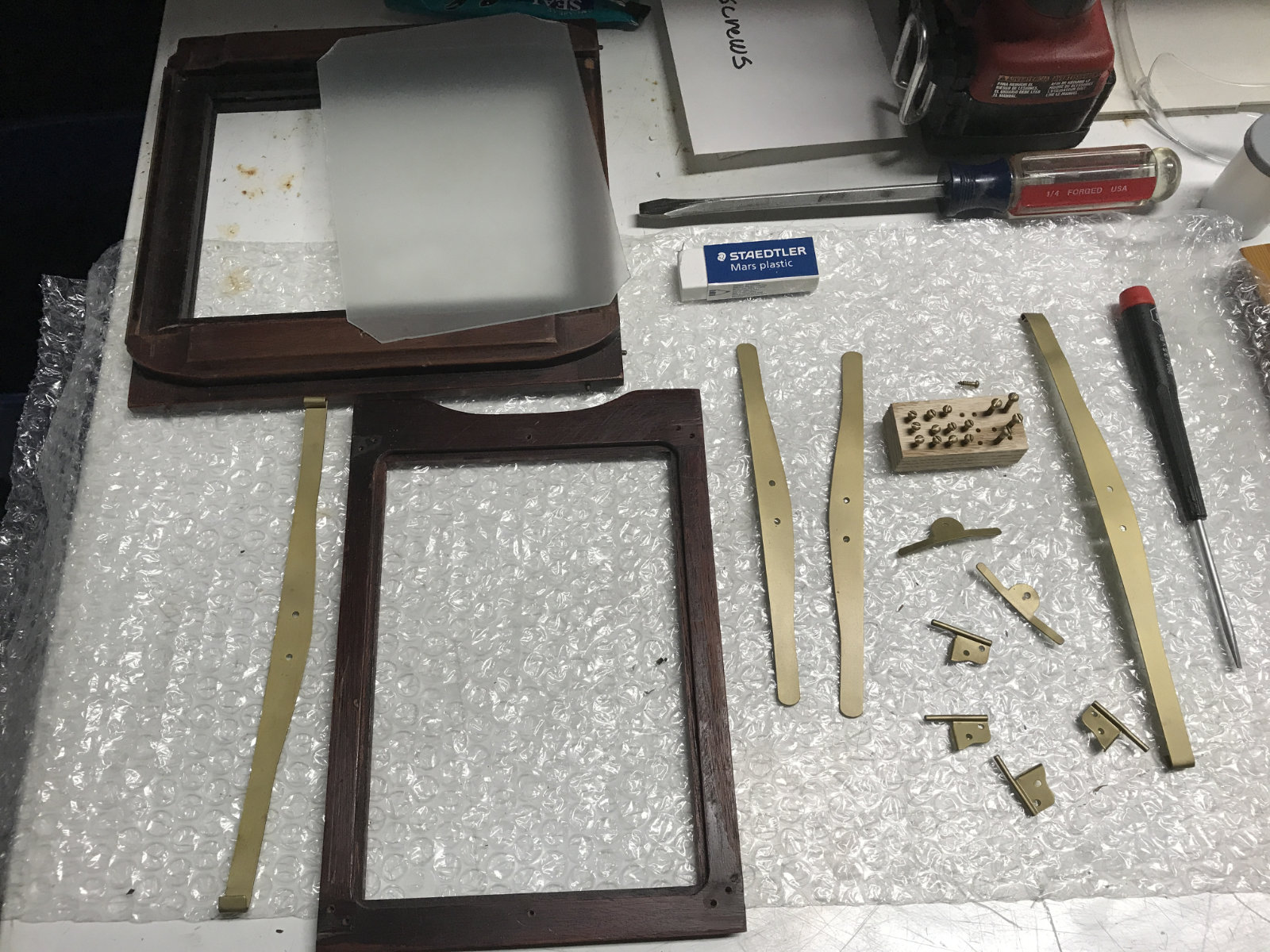

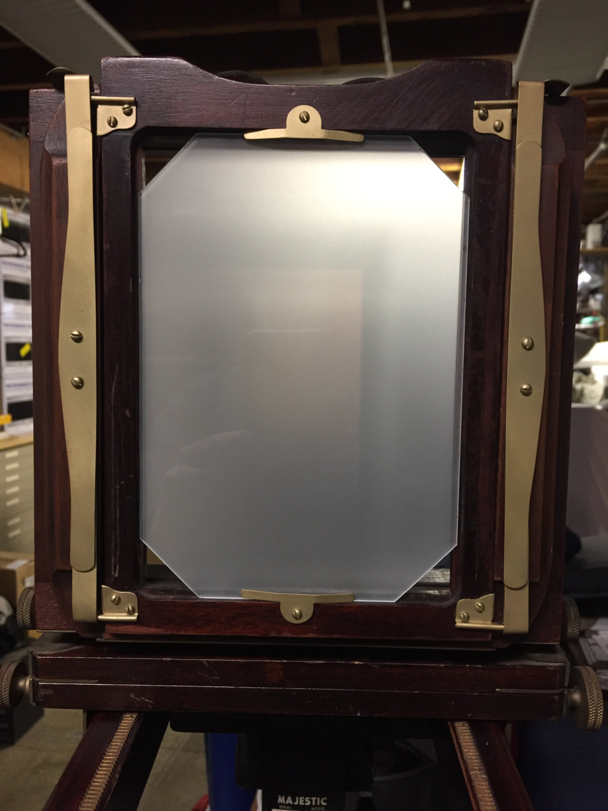

I’ve got an Eastman Kodak 2D 5x7 that’s in moderately rough shape to restore. The first order of business was to order new bellows, which I now have in hand. Lol, I actually got the bellows 2 years age truth be told. Sometimes it take me awhile as I have way to many projects.
The Next thing was to figure out the best way to refinish the brass hardware. I didn’t want to lose the satin finish that came on the hardware ware originally. So I bought a small bench top media blast cabinet and some extra fine glass bead. Got everything set up and tested it out last night and I’m very pleased with the results. This is one of the springs for the film back with a clear coat of satin lacquer. I think the original finish on the brass might have had a little tint in it and I may play around with that, but in the mean time, I’m pleased with the results.

Wow, the box looks great. Did you build the box or is the a box you repurposed? Either way it look great.

Well done!
Well done!
Thanks! I’m still investigating clear finishes for the brass. Just sent an email to Ceracote inquiring about which finish they would recommend. The spray can lacquer is easy but probably not that durable. The Ceracote finishes look promising. If anyone has used Ceracote it would be great to here your experiences.

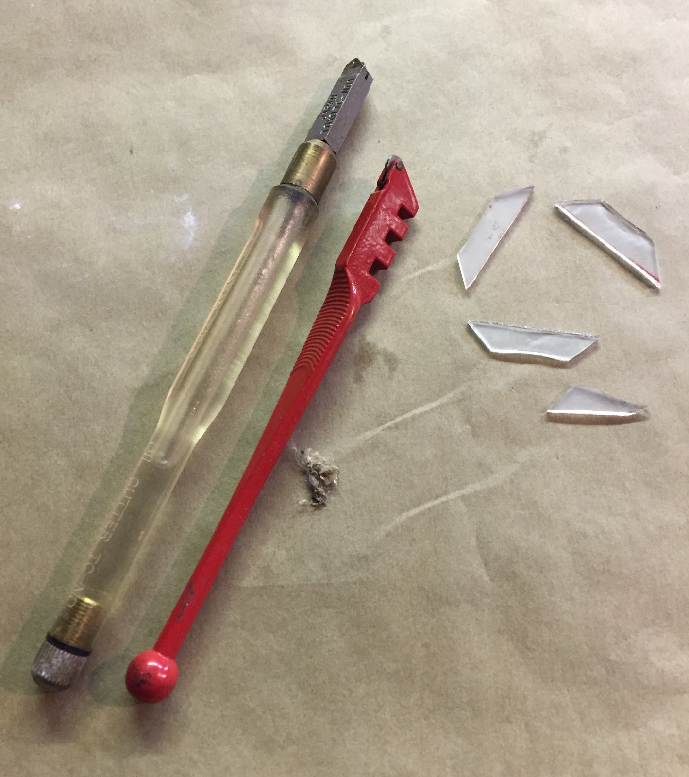

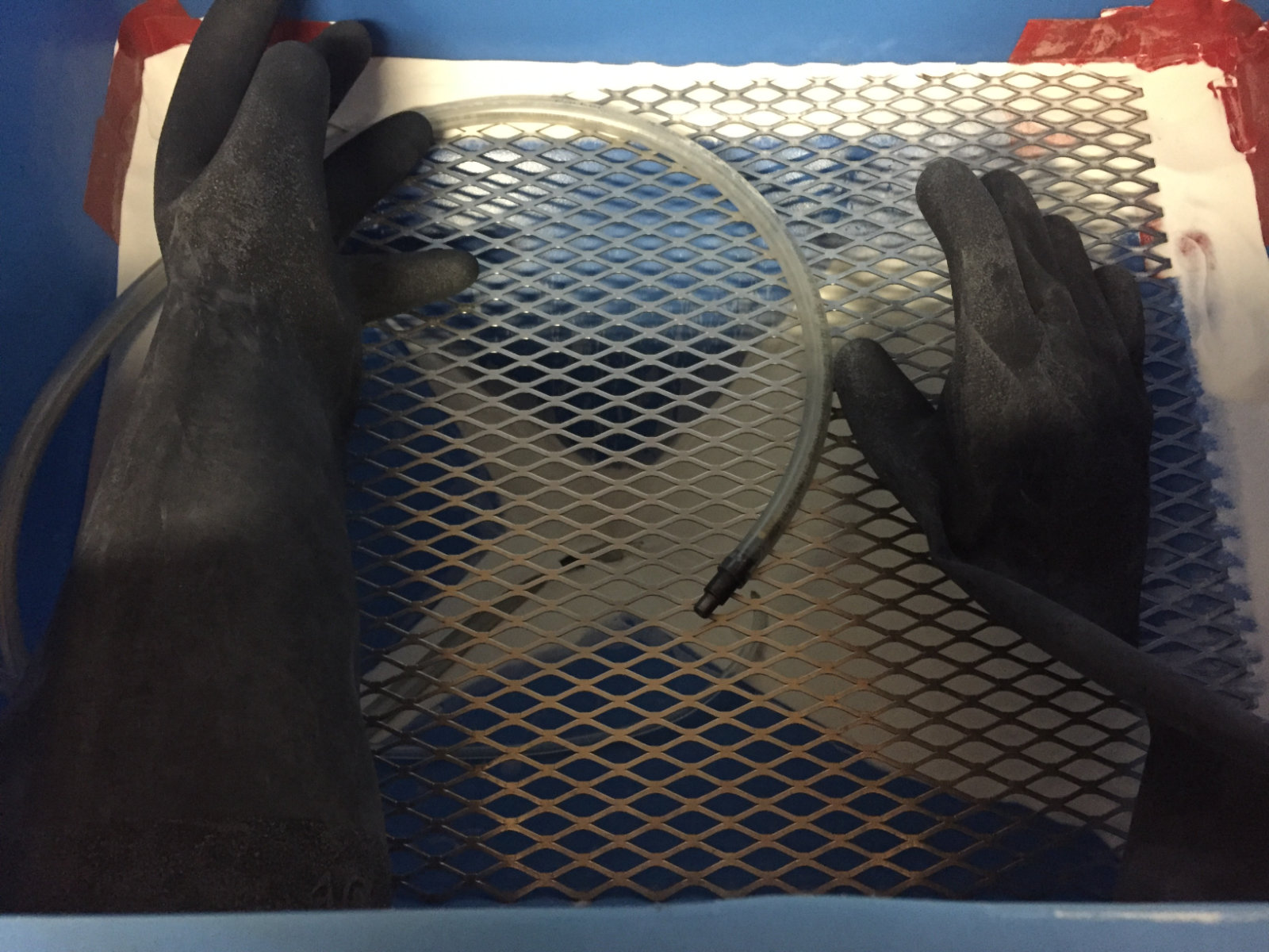

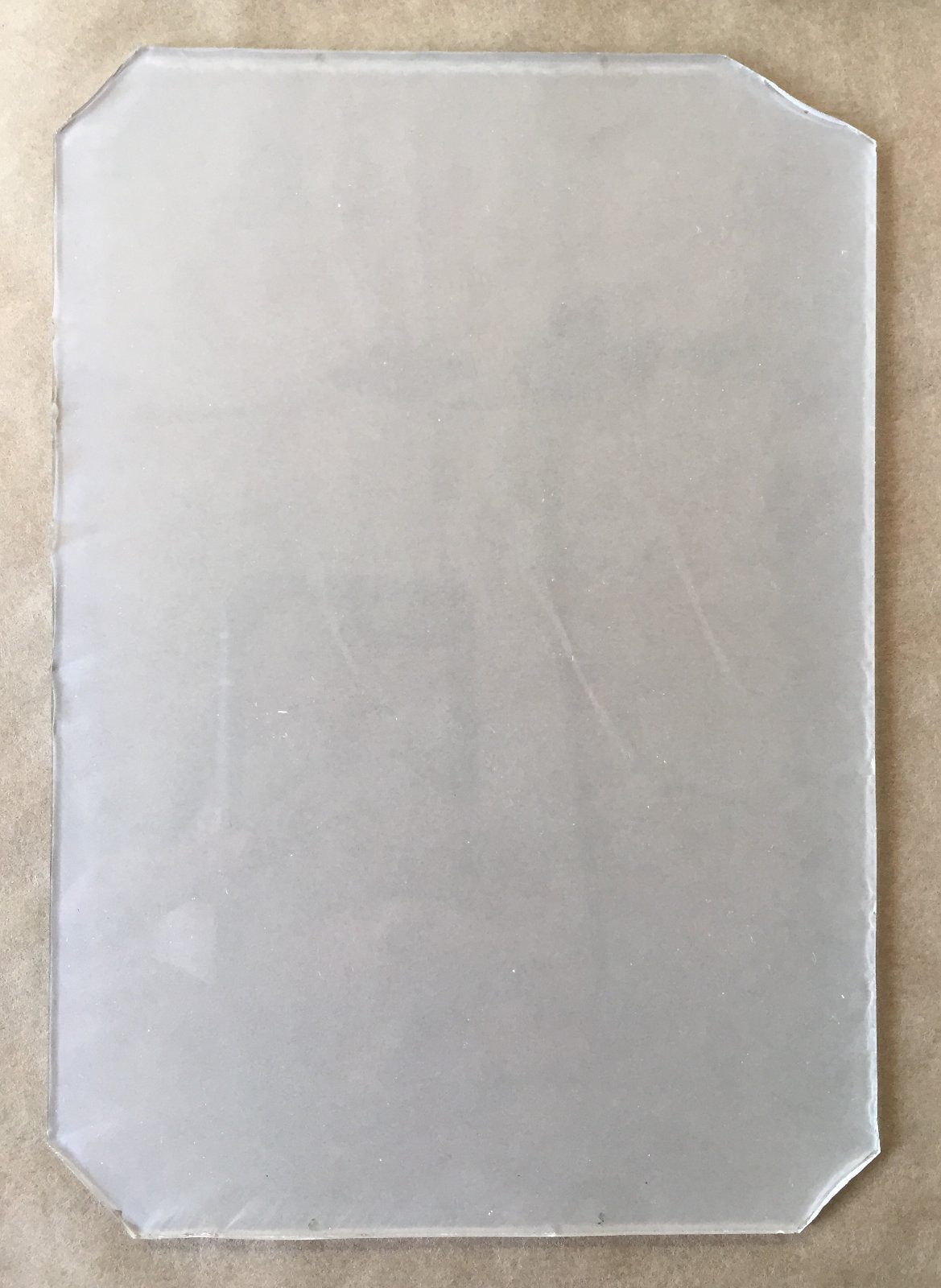

So the ground glass for the above mentioned camera had very unevenly cut corners. I recut them and cleanup the edges of the ground glass. I also reassembled the ground glass back with the refinished hardware. I have a bottle of Cerakote MC-2200 Multipurpose Clear on its way to test on the brass. I’m hoping it will be more durable than the spray lacquer. The next hurdle is to figure out what to do with the wood finish on this camera. The previous owner did a hack job of trying to restore the camera and has partially stripped and/or sand the old finish. He also had the ground glass frame on backwards, focus must have been way off. I will probably end up completely disassembling the camera and refinishing all the wood. I’d really like to bring the camera back to dark red mahogany finish that it came with. There’s also a some wood repair that needs to be done on the front rail. Basically I’m testing the waters and sneaking up on a full restoration.

Looks great. I love these old cameras. I have taken a clean first, with wood, see what is what before removing old finishes. Looks like you're fixing prior missteps. Good work.

I've got 3 'small' gel batteries in it and it's already pretty hefty to lug around.
This is one shown in the 1950s Directory of Signal Corps Equipment,
The WW2 one is similar but they have a split-riveted hard fibre body, like the Graflex cases of the time. A friend in the US has one of those in his collection.
The box itself is a record carry case. It's dimensions are pretty close to the thing I'm trying to recreate. I only painted it and added the Twist-Pull socket.
There are still a few things I can change or add to improve it, like the top handle, the D-rings for the carrying strap and the corner reinforcements

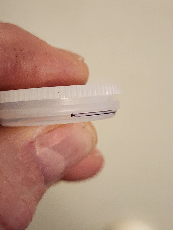

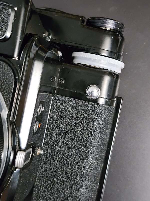

Bought a Pentax 6x7 very recently with a metered prism (not working) but came without the shutter speed adapter.
Not wanting to spend 50+ dollars for one I came up with a replacement.
I used the top of a Fuji 35mm film container. I cut off the bottom, slightly sanded it for flatness and it slides over the shutter dial nice and snug. Works perfectly.

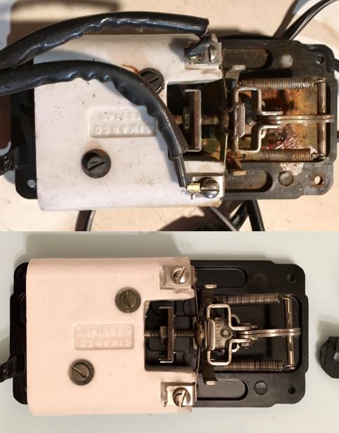

I just finished this 1952 Singer button-style foot pedal which was in a sad state. It doesn't look like it but there are a couple hours of job in the picture below heh.

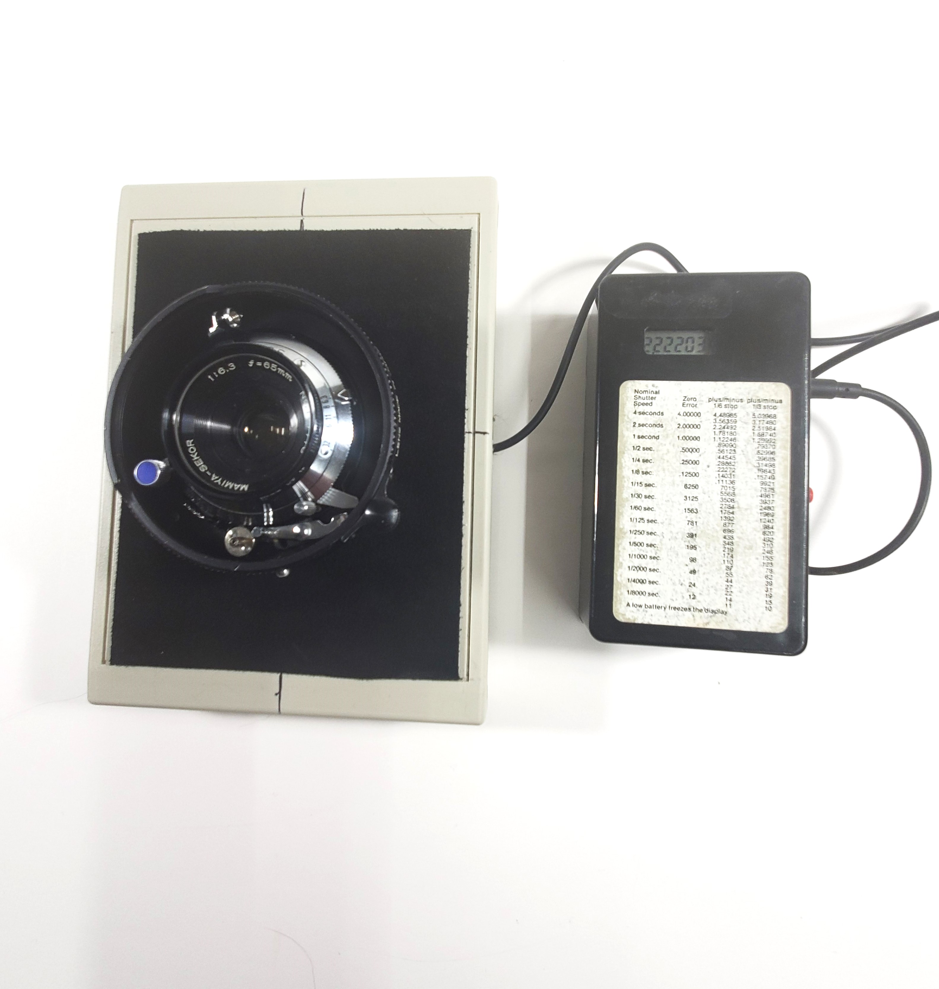

I found a hack on line that allowed me to make a level base for testing shutter speeds with the Calumet Shutter Speed Tester. A good fix instead of either having to balance the lens on top of the tester or trying to test lenses horizontally.
Interesting!
Could you tell a bit more about the Calumet which is unknown to me. Is this a current product?

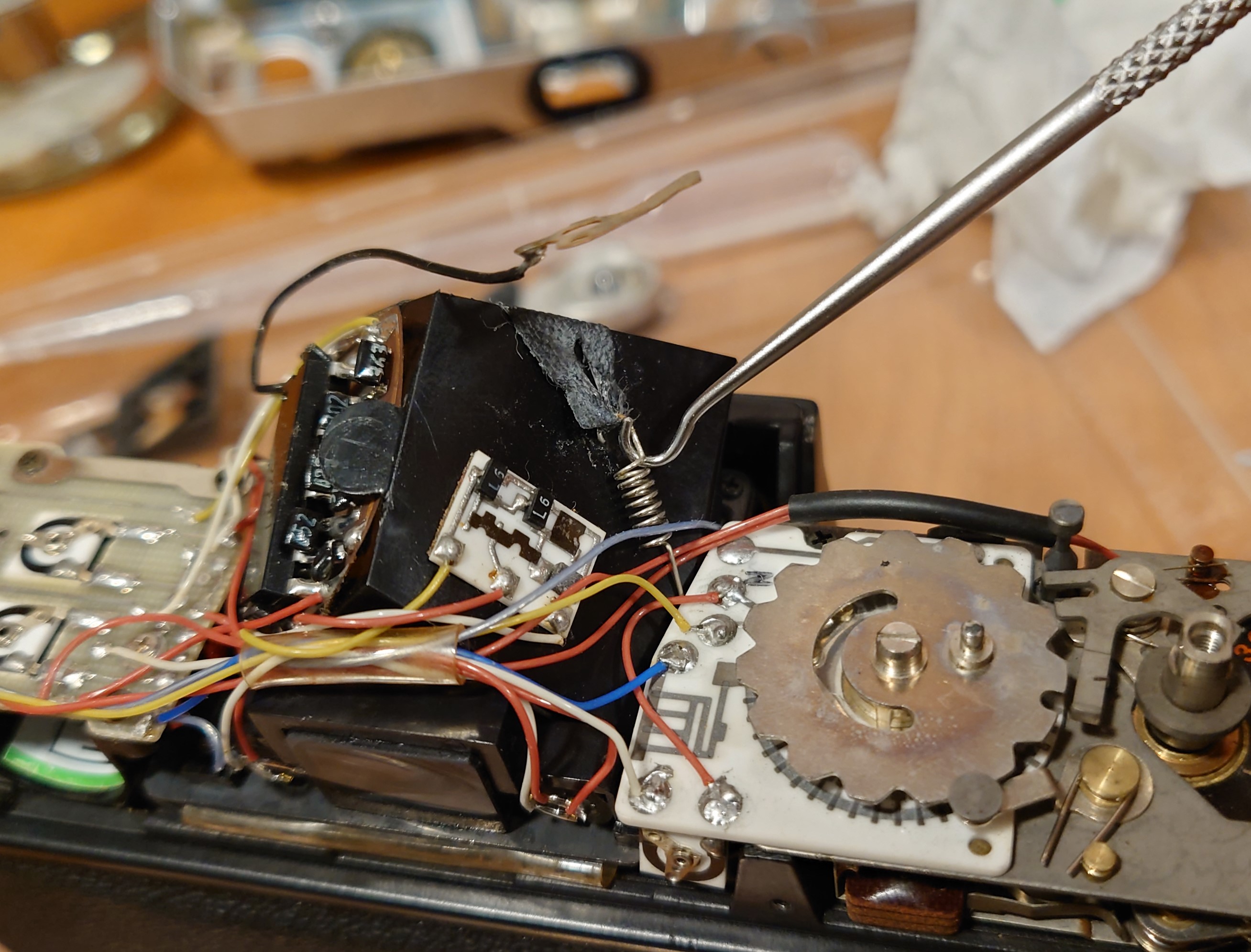

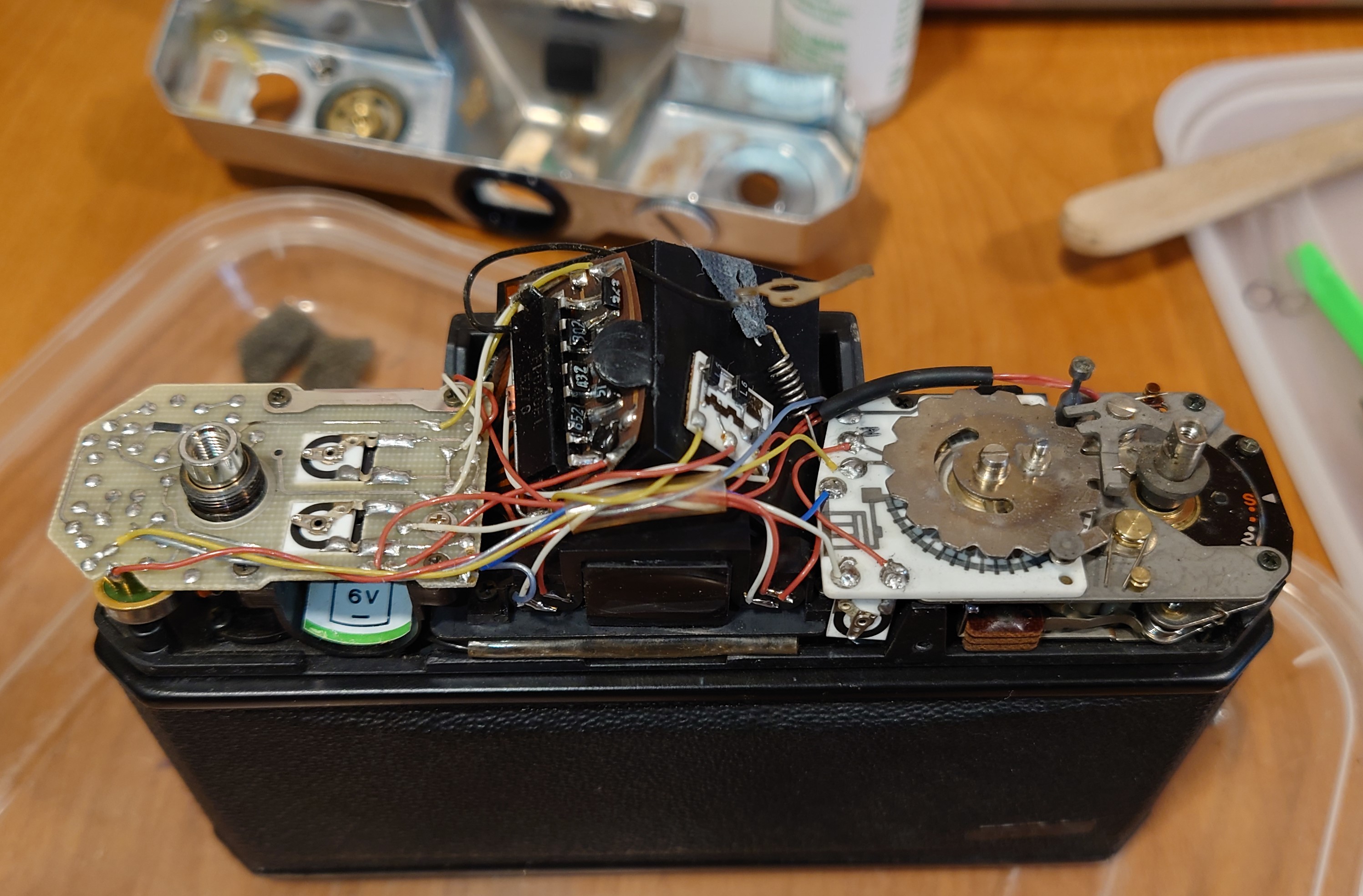

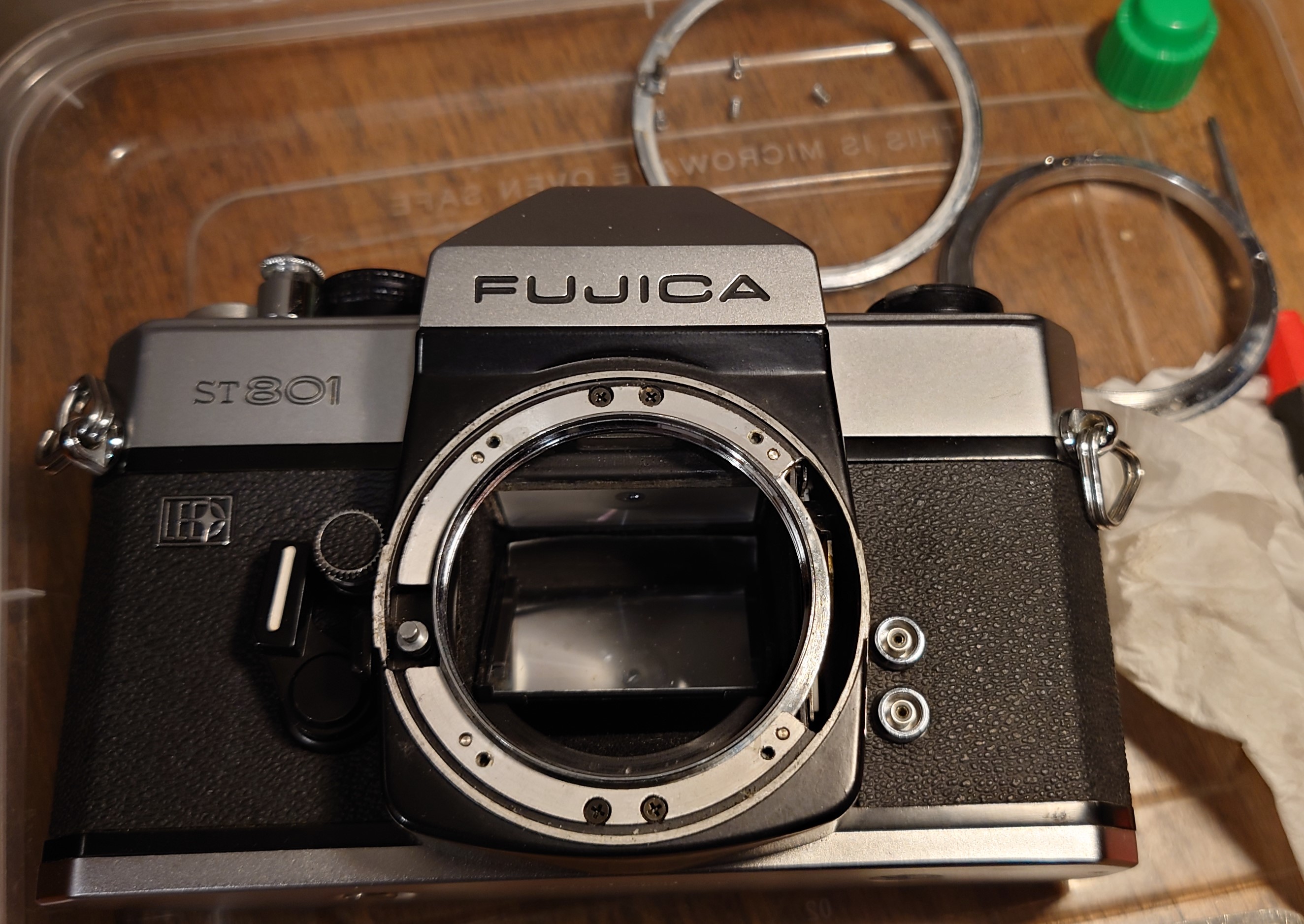

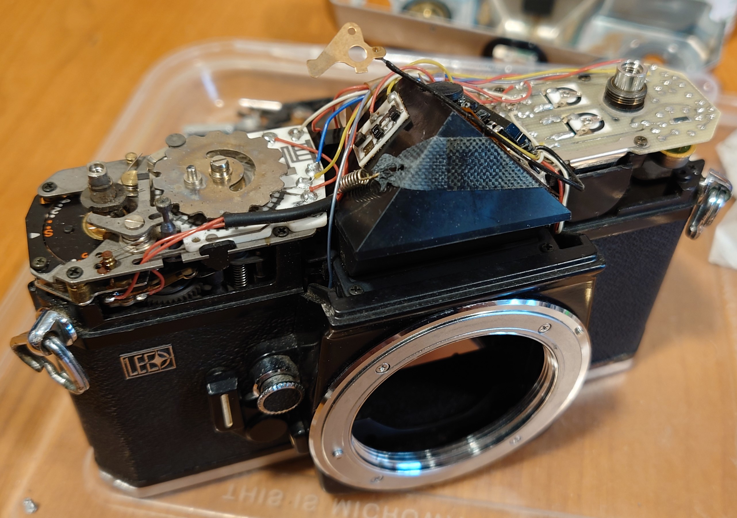

Another Fujica ST801 cleaned today. The Fujica ST 801 is a fun M42 camera to own. The LED exposure meter is a real advance tech back then .
As said previously, one has to make sure no static in working it out .
Above: After top cover removed . Under the hot shoe has a screw to attach the flash wire (black) to the hot shoe. Nothing real tricky there.
Most of the foams are dead as it aged , and so just remove them and put a new one
Above : The Left side has a transparent plastic ring on the rewind side. It is for insulation , don loose.
The top cover also has transparent plastic film for insulation
You can see the main IC chip is on the left side of the prism, and thats why using static-proof tools are recommended.
As for the prism, lift up the spring on the right side using the spring hook. Be careful with the chipset next to it
This spring usually has been glued on the another end.
But I have met few that doesn't have this chip set and the spring didn't glued on .
After that, just left up the rubber-like cover slightly and slowly pull out the prim for cleaning .
The focusing screen is just below it.
The viewing lens and the metering sensor are also there . Cleaning them if necessary.

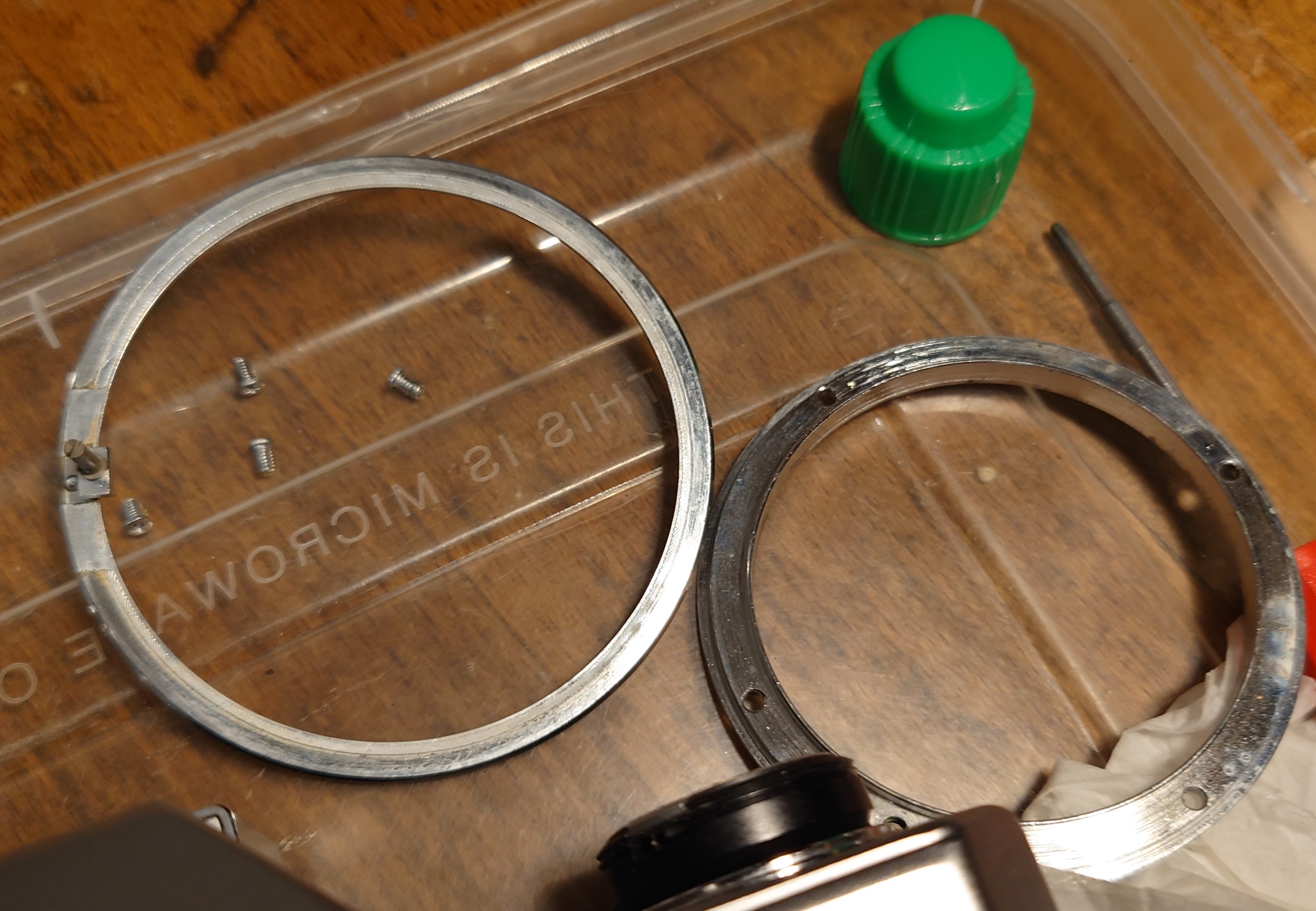

And here is a the aperture ring disassembly:
Removed 4 screws of the M42 mounting ring , simply lift it up and there is nothing special about .
