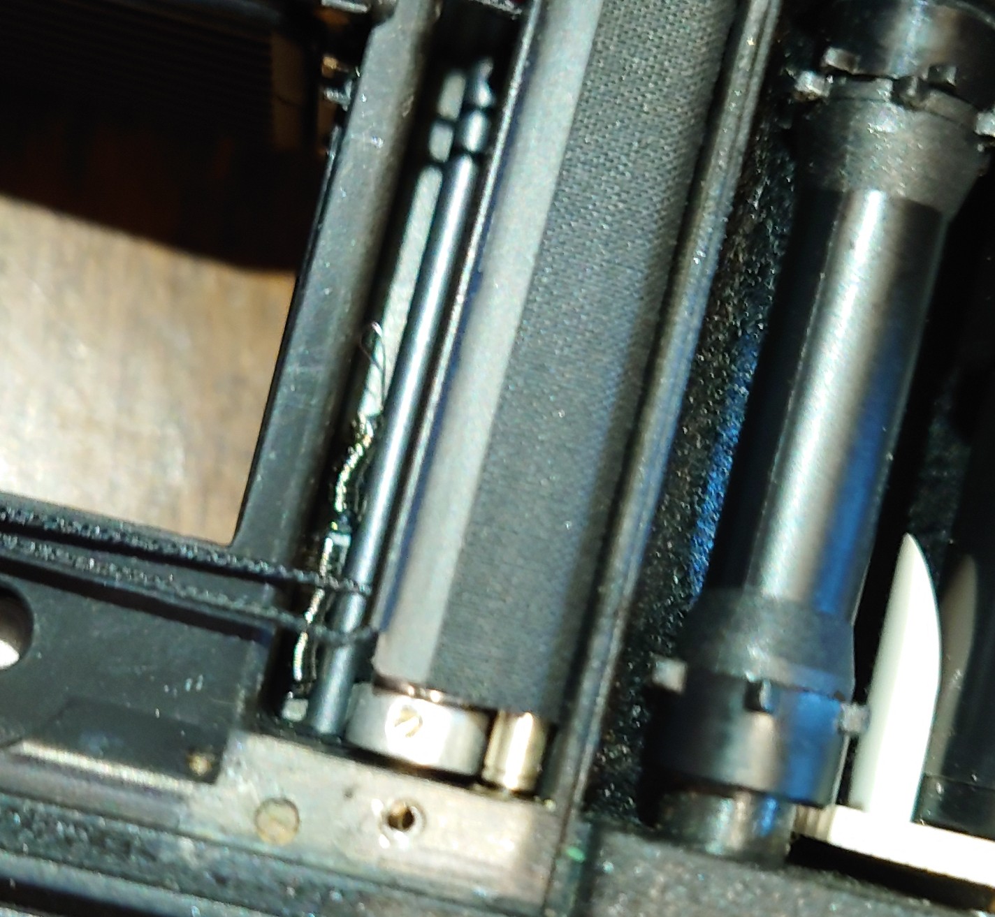

A jammed Rolleiflex SL35M . The winding level can't run in complete cycle and it it jammed .
So I opened the shutter box cover and found this
Obviously it is not part of the shutter mechanism, likely from lens?
Just WHY it was there???

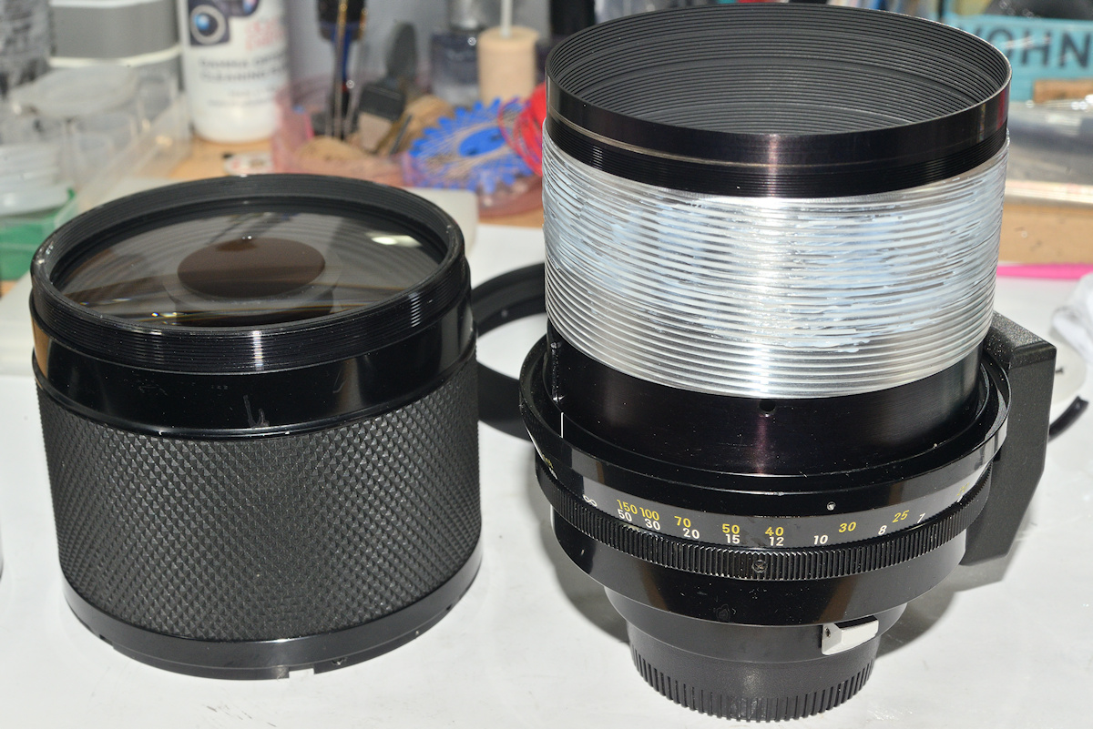

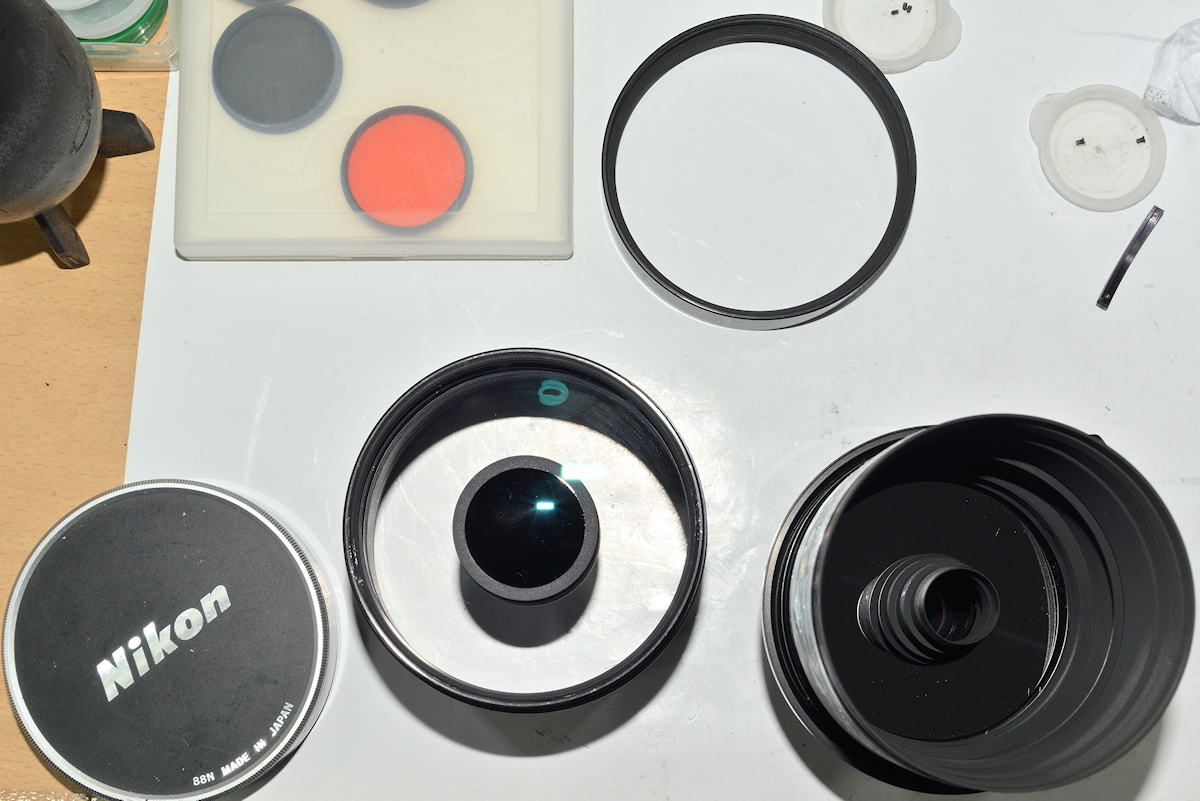

Today I opened, cleansed and regreased a fungal Nikon Reflex Nikkor 500/8 C with loose focus:
Now it works fine:

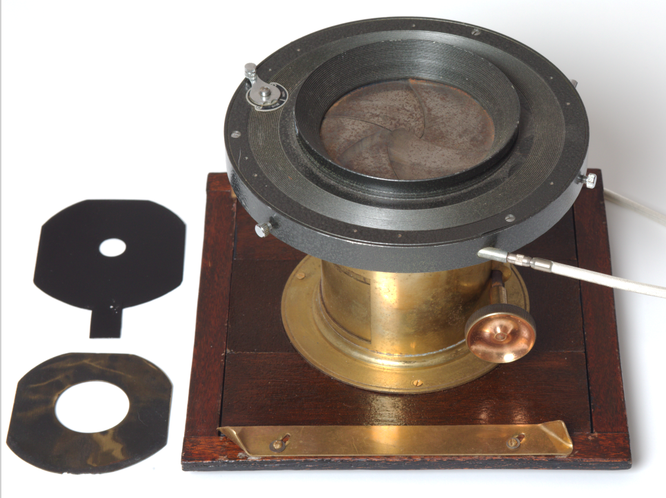

My Gitzo studio shutter. I have used it for a couple of studio sessions, because it has flash sync, and fits some of my larger barrel lenses.
When I went to use it last month it failed, no flash sync, as it wasn't fully opening. A simple fix, some careful lubrication.
I really want to use it with the lens in this photo this year. The lens is a Dallmyer 2B Quick Acting Portrait Petzval, f4 9", its serial number shows it was made 160 years ago, and it's listed in the Dallmeyer stock book.
I've just tested the shutter and now the flash sync works :D

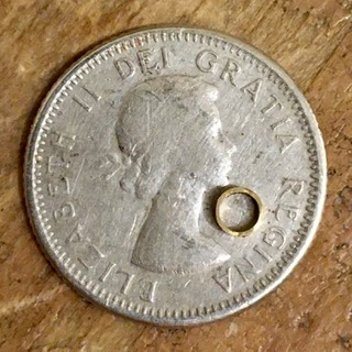

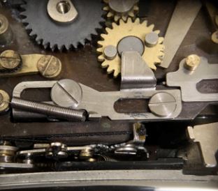

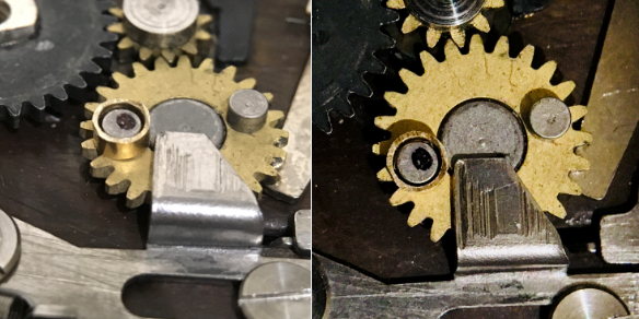

Update on the Minolta-16 MG-S (fixed)
The camera developed a weird problem as I was testing the shutter. Every second actuation of the cocking mechanism, the cocking sliding plate wouldn't move far enough to cock the shutter. It was missing that 1/64 of an inch to complete the task. I thought I'd misaligned something but it turned out that one of the cogs of the cocking mechanism has one side of its inner race thinner than the other. According to the service manual, this cog is integrated into the main chassis and cannot be serviced... So, I came up with a solution to remove the slack, I made a tiny brass sleeve to go over the post of the problematic side. It works perfectly, and the beauty of it is that it doesn't need to be fixed in place because the top cover sits so close to the cog that the sleeve cannot escape. I just applied a tiny amount of molybdenum grease to avoid unnecessary friction.
10cents coin for scale.
View attachment 359043 View attachment 359042
That's a great solution. Elegant even :smile:
