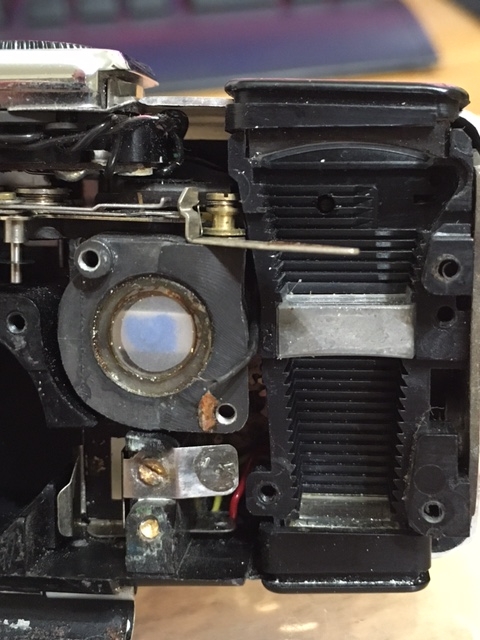

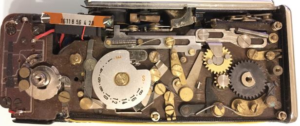

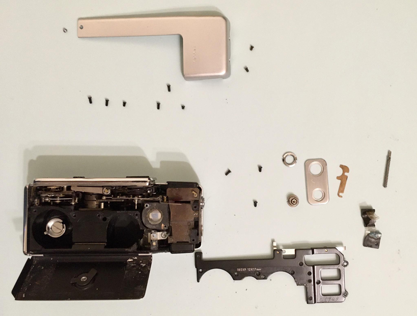

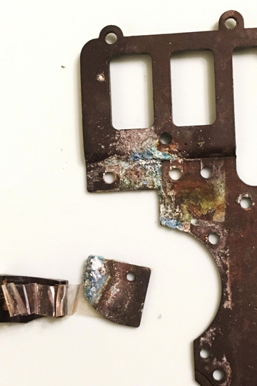

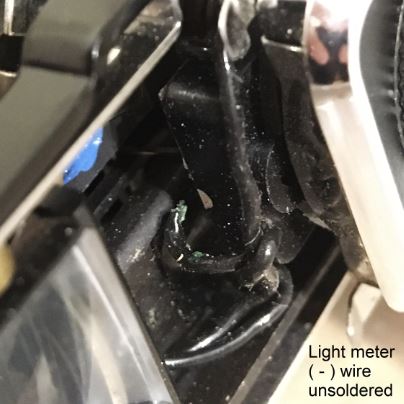

I've started working on this Minolta MG-S that I purchased on eBay for a few bucks. The shutter was more on the miss side but, after working it a wee bit, it’s getting better. A mercury battery leak forced me to drill out 2 of the screws that held the back plate. I should be able to remove what's left and find suitable replacements (I hope) in my canister of tiny screws. The viewfinder had a lot of debris inside but it cleaned nicely. The light meter is inoperative due to verdigris on the wires, I hope I'll be able to fix it without having to replace the wires.
Edit:
A moments ago, I noticed that one of the leaf blades wasn't seated on the E.E guide post. This explains why the aperture looked funny.

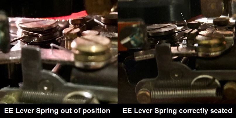

Update on the Minolta 16 MG-S

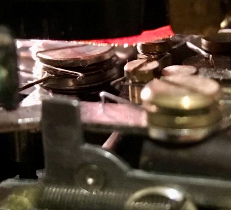

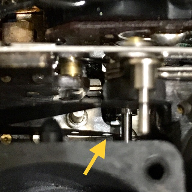

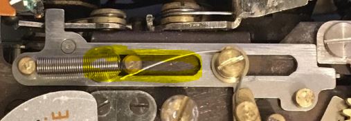

I spotted this suspicious spring while inspecting the mechanism. According to the service manual, it is the Electric Eye Lever Spring ( part #4013-04 ). I have yet to confirm where the end of this spring goes but I’m fairly sure it’s behind that post in the back. I think it is what’s causing the shutter’s erratic behaviour.

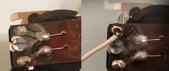

And here we have a corroded & unsoldered wire that should be connected to the electric eye. I think I’ll replace the whole wire instead of trying to clean the ends.
It appears that I was correct in assuming that the end of this spring needed to be seated behind the post in the back. The service manual doesn't show where it's supposed to be so I just followed commonsense and Bingo now the shutter operates normally. The way it works is that the EE lever is shaped like a stair with tiny steps and, as you cock the shutter, it is pulled away from the light meter needle so that the latter can move freely. When the release button is pressed, the EE lever springs back and stops right where the needle is (Ex: f/5.6). It must have been dropped at some point and it messed up the mechanism.

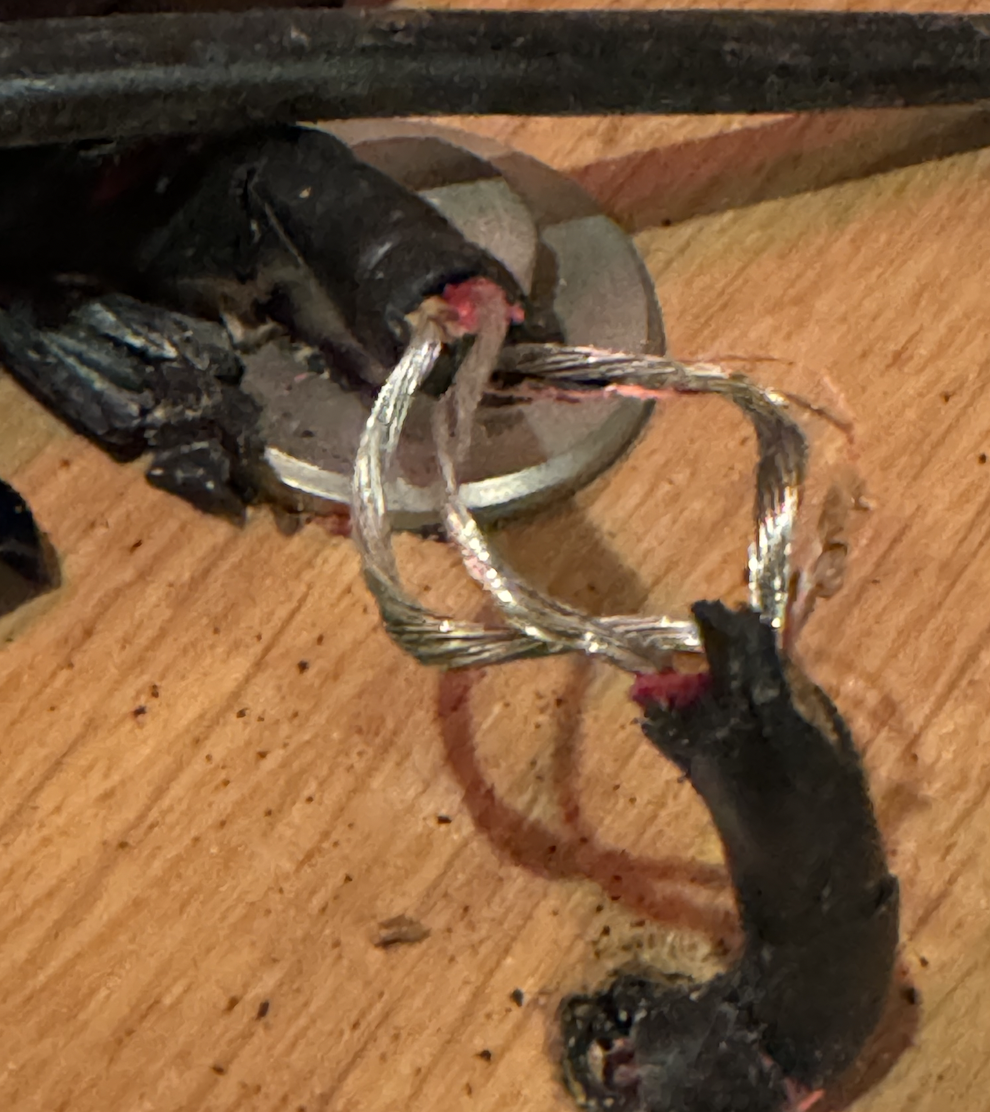

My Focomat 1C has been flickering ever since I got it (about 2 years ago). I thought it was that the plug at the top of the tube wasn't fitting in well, but then I noticed a bit of visible arcing in the plug itself (very nice). I opened that up (because it is held together with screws) and tightened the connections. That didn't stop the flickering.
When I got the enlarger, I checked the power cord to see if it was in good shape - since I have a Valoy II that needed its cord replaced immediately (bare wires everywhere). I thought the wires in the Ic were good. The cord between the light and the tube is perfect.
I wanted to access the outlet at the top of the tube since I thought the connections in there may also be loose and thus cause the flickering. To get that outlet to come out, you need to release the clip on the cord at the underside of the baseboard and push the cord into the tube. I did that. The result was:
The insulation turned to powder when I moved the cord.
So I had to rewire the entire enlarger - expect from the light to the top of the tube. Even the power cord, which I had thought was ok, was actually full of checks and nearly shorting out where it was attached to the enlarger. Took over an hour, since every wire end in the cord I bought needed tinning before putting it in the connectors in the enlarger.

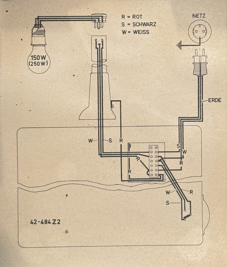

For your enjoyment, here is the wiring diagram Leitz was kind enough to include inside the shield on the underside of the enlarger:
Wow. Lucky you didn't have a fire!
Well, the great thing about an enlarger is the fact that you don't ever have it on unless you're right in front of it. But it's certainly something to consider whenever you plug in something that old. I imagine every one of those should be rewired, at this point.
Simple way to do it would be replace the cord to the light bulb to plug directly into the timer. But I like that it plugs into the top of the tube.
I've replaced the corroded wire on the electric eye, this has to be the smallest solder spot I've ever done. I haven't soldered the other end to the battery contact yet but the meter tested positive when I hooked the wires to a power source. Also, while I was playing with the cocking mechanism, I noticed that the shutter actuation sliding plate (the manual calls it a "Diaphragm Plate Set" ) was dragging and would sometime stop short of actuating the shutter. A quick look at the reassembly procedure informed me that one area of this part needed to be greased for a smooth operation. After applying a tiny bit of molybdenum grease Molykote G-N, it operates smoothly.
Note: The wire I used comes from a Pentax SFN. I kept the wires in case I'd need to fix a light meter and here we are.
