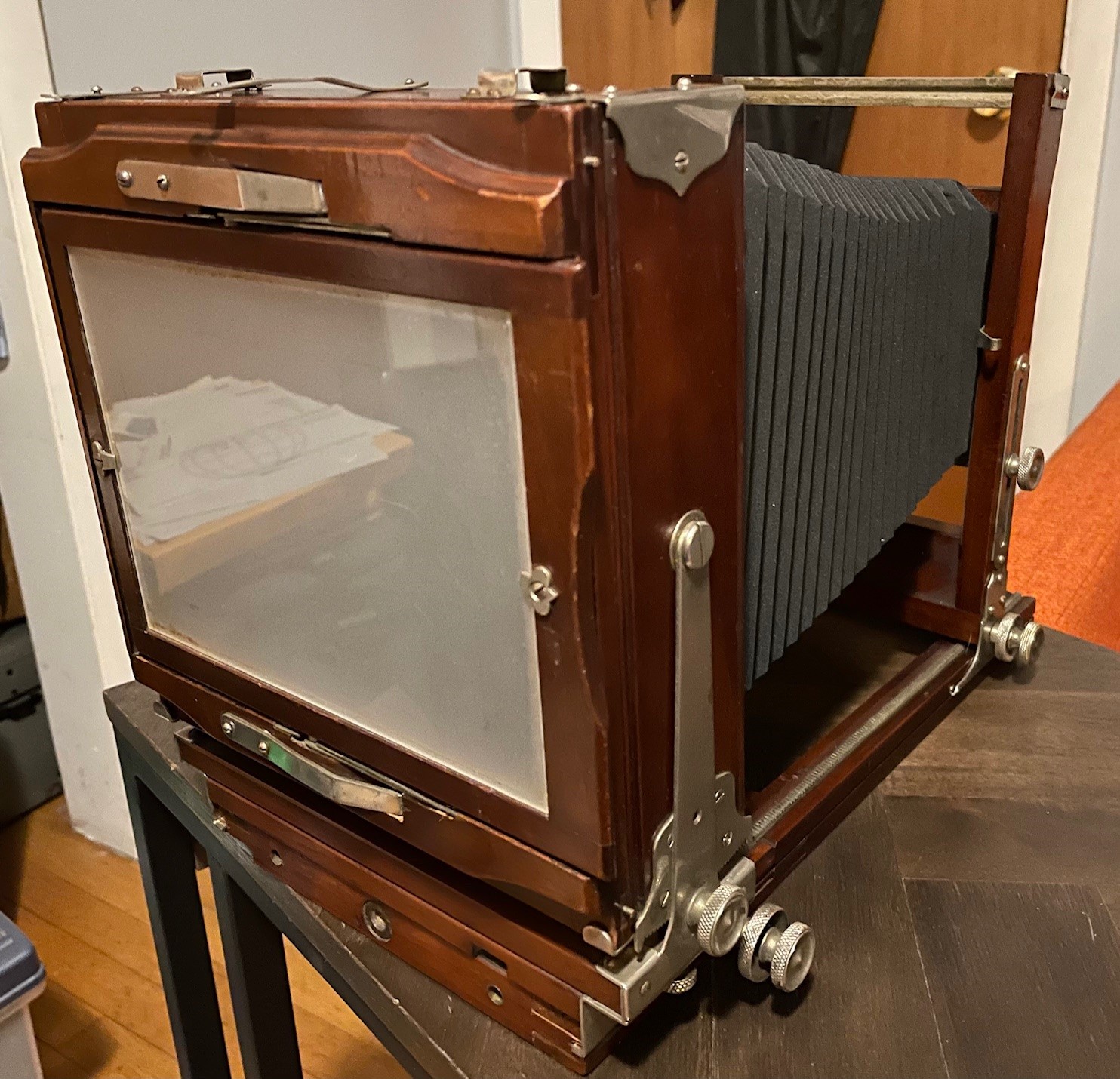

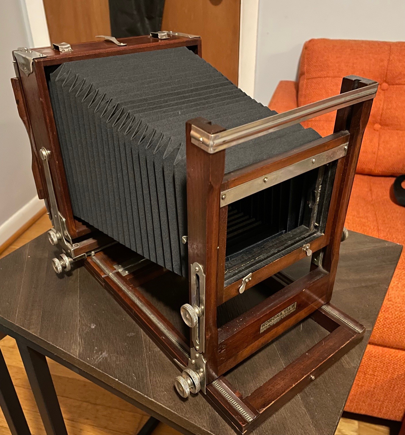

Had some spare time today, so I installed my new bellows on the 1909 (?) Korona 5x7 I purchased from @AnselMortensen. The process was not without some errors, (like having to install the rear frame 3 times), but it worked out in the end.
Need to make a lens board for this camera and a few other minor things before I can shoot, but this was a major hurdle.
View attachment 356775 View attachment 356776
Looks fabulous. 5x7 is so perfect. Makes great contact prints, plenty big.

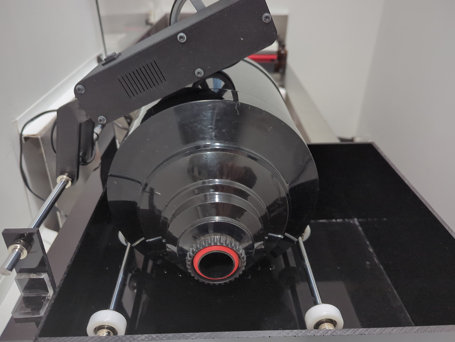

After a few months of tinkering, going back and forth with ideas, I have finally finished my rotary base thingamabob.
Had gotten a cheap Jobo Expert 3010, had to build something to use it on.
Built the water bath tub out of plexi, arduino running a motor. Pretty much a filmomat clone, where i got the idea from. Will run some film through it this weekend.
Looks great and a lot smaller than a ATL machine!
Would love to see a video of it running.

Here ya go.
Have it running at about 45 , rotates two revolutions in each direction. I heard 50rpm was the recommended speed by Jobo, Ill adjust if needed.
Way smaller thatn a ATL yes, and waaaaayyyyyy cheaper than anything on the market. Not as nice, refined as something bought, but should work just as well.
Here ya go.
Looks great! My ATL 2500 can rotate at 25, 50 and 75, but you can probably rotate at any speed you like and not have to have a machine that takes up the space of a refrigerator.
Is that a Sous Veid cooker you are using for temperature control?

Thank you!
Yes I set it at 50 because I read that was the recommended. I have it programmed to run 2 speeds on a 3 way switch, one for the 3010 and the other If I want to do 35 at some point, set a second speed with less rotations for that. I can also add a potentiometer to control the speed at some point if i need it, but figured Id make it as simple as possible.
Yes its a Sous vide, does a decent job maintaining temps, if was the cheapest one found on Amazon... :smile:

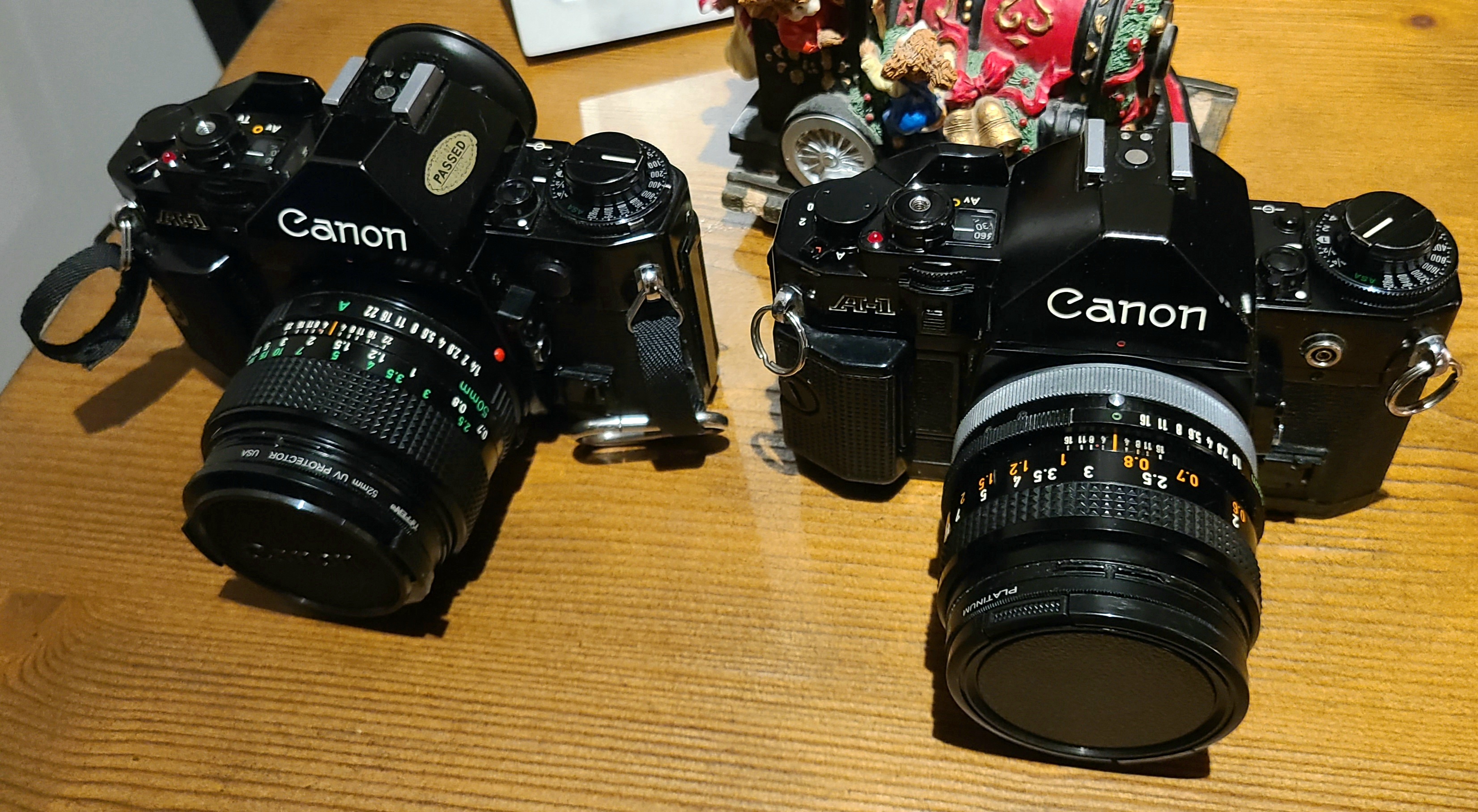

This was a good evening for me at the workbench. A little while back, I purchased 3 Canon A-1s as parts cameras. The first is truly a parts camera as it came with missing bits and was used to practice disassembly/assembly on. The second was locked up somehow and had an inop shutter once I was able to get things moving. I don't know what the issue really was but some cleaning and a tiny bit of oil here and there got things going again. I found the second shutter magnet corroded and replaced that. There was a corroded spring in there too indicating the camera got wet at some point. With a couple of parts robbed from the practice camera, I got it shooting quite well with the only remaining issue is that it displays the error message when a lens is rotated into auto mode. Other than that, the meter is accurate and with new light seals and a touch of oil to cure the cough, it now sounds and functions well manually.
The third camera seemed to be functional in all respects other than the display was dead. The camera was really dirty too. Tonight, I took a detailed inventory of what it needed and got to doing it. The light seals are still pretty good, but I'll replace them since I have spare A-1 kits on hand. Once I removed the top cover, there was nothing obvious wrong except I found signs of previous work in there that had not been done with the right tools. Since everything looked ok, I was thinking that whomever put it back together may have screwed something up. I decided to pull the ribbon cable connector to see how the cable was attached and found the connector less than tight. Not loose, but not tight either. All looked OK, so I replaced the connector with just a bit more torque and don't ya know, the display now functions again. All bits were scrubbed and waxed before reassembly and it looks like a new camera again (aside from the usual scuffs of life).
So, another A-1 has been revived and the collection is growing. I'm up to 5 now, including one bought new in 1980 by me. The parts camera will be disassembled again a couple of times while I try to learn how the auto exposure functions mechanically. I don't expect to have as much luck as I did tonight, but it's fun to try.

What is your experience with the A-1 regarding repairs? Are there any particular weak points?
I really wish I could claim to have some good experience or insight, but I'm still new to the platform. I've got 5 of them on hand right now, 4 of which are functional. Last month, I picked up 3 parts cameras. One of those has been used to practice disassembly and reassembly processes. I've not got a lot of experience in soldering flexible circuit boards, so that's what I've been doing a bunch of on that poor old abused camera. The 2nd camera was gritty and tight and once I was able to lube a couple of spots, it started to mostly work. Slow motion video showed an issue with the second shutter curtain magnet. I replaced that and the camera is mostly working. It still has an issue with auto exposure modes though. The third camera, I just got lucky on. I pulled the top cover and when there was nothing obvious, I decided to check the LED panel connection since that's where the problem was centered. The screw was buggered up a bit so I pulled the connection clamp and reinstalled it with a bit more torque because it was on the loose side when I removed it. That worked. Like I say, lucky.
The biggest issue with the A series for me is that they are intimidating when you pull the top cover. There's an amazing amount of stuff going on in there. But, when you start looking at it systemically, patterns emerge. At this point, I am limited to mechanical corrections. If the display was dead because of a bad chip or board, I'd had to have written it off as a parts camera. That's pretty much where that parts camera is. It's simply dead and nothing I've done has changed that in any way.
I've not really detected any weak points yet. There are some plastic bits in the rotary dials that may be getting brittle being over 40 years old, but I've yet to break anything while disassembling it. When you remove the mirror box, be really, really careful of the display ribbon. If that hangs up, it can possibly damage the LED display if it pulls it from the prism area. Make very good notes and mark wires if needed to make it easy to remember what went where. I'm sure that you know all of that already but I'm still learning on that abused body :smile:
