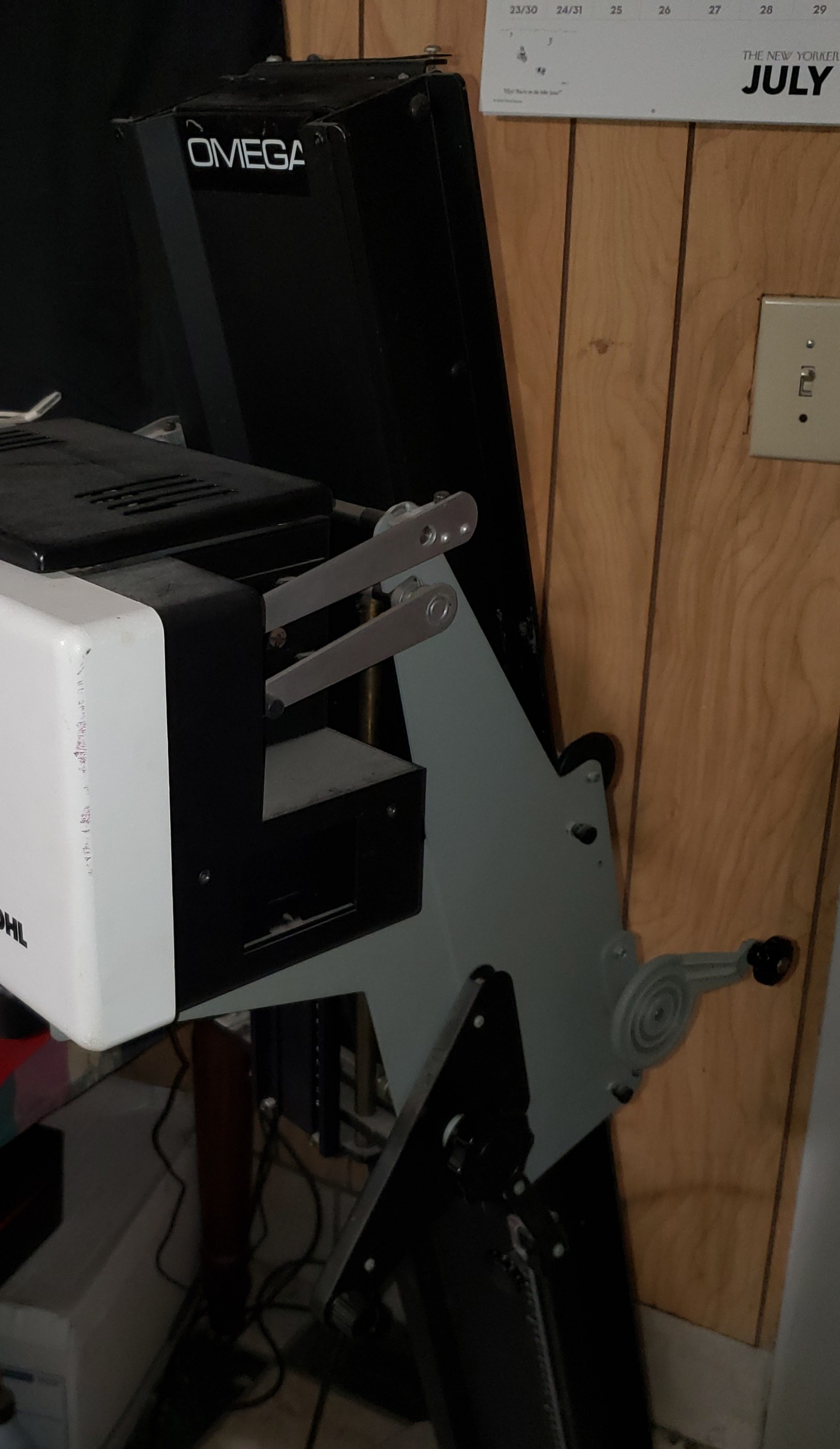

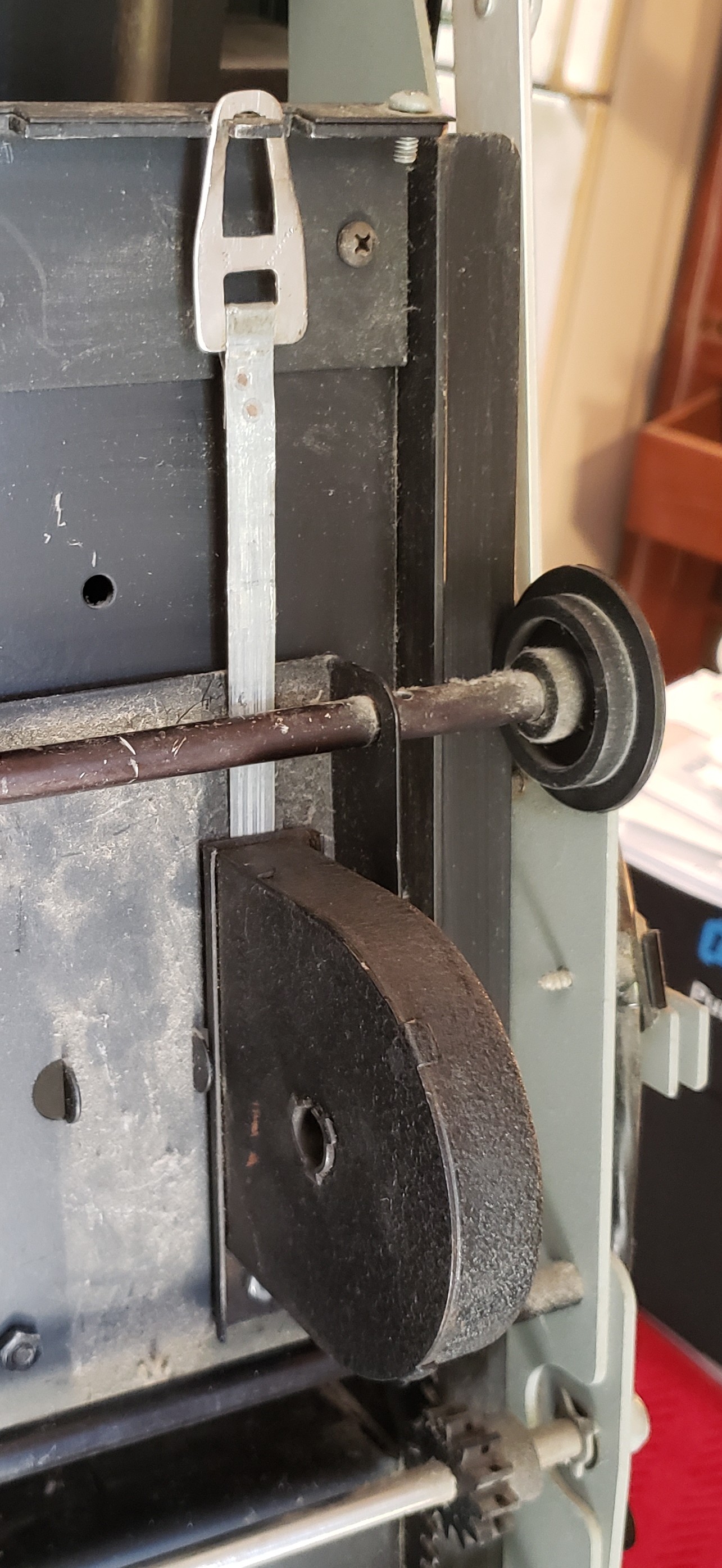

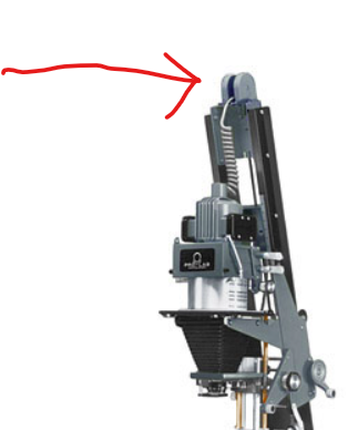

My D5XL enlarger was received with only one operating counterbalance spring.
I used it that way for ~15 years.
Well, that one spring gave up the ghost and went "SNAP!" right before a printing session.
Apparently, my enlarger is somehow different from most D5XL's out there, and 99% of D-type springs don't work...including ones purchased from KHB.
I found ONE used one on Ebay.
Installed it today.
Still have 10 fingers.
Meanwhile, the search continues for Unicorn Spring #2.

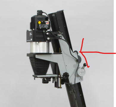

That looks more like a spring from a D2 or the earlier type of D6 than the more modern D5XL - although the mounting position is unusual.
I'm not sure why mine is so unusual... 99% of springs out there have a rounded 'hook' that doesn't work with my enlarger.
I'm using an Ilford 400 setup, but that shouldn't matter, this is a chassis issue.
The location of the spring is unusual - they are usually at the top of the column:
The way you have yours mounted looks more like the spring location for the other type of D5XL, which if I recall correctly, is here:
The end of the long spring is attached to entirely different connection points.
This ( the second photo ) is the way my enlarger was constructed.
But the column is from the older style.
I think someone who had the enlarger before you got it, bodged together something that is/was a mixture between the two versions.
Matt, here's a pic of my enlarger, the setup appears to be identical to your second photo.
It might have looked different in my earlier photo because the head was all the way up. <shrug>
It did look different! Sorry about the confusion - the D5-XLs that I'm most familiar with were all black, and I let myself be misled by the grey in your first photo.
Send me a PM, I'll check when I'm home. I think I have two of these springs that will work for you.

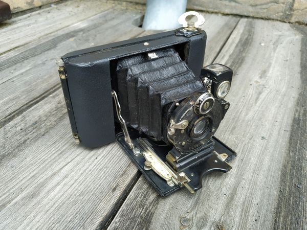

The Icarette project is more or less done now. A little more detailing of the rounded corners with some LET, but it's basically ready to take images.
The camera takes 117 film. so I will need to cut down the flanges on some 120 spools to make them fit.

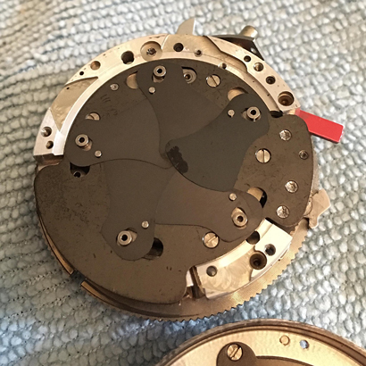

I've revisited the shutter of my Topcon-35L because oil got to the leaves. The last time I cleaned them was 6 years ago when I bought the camera.

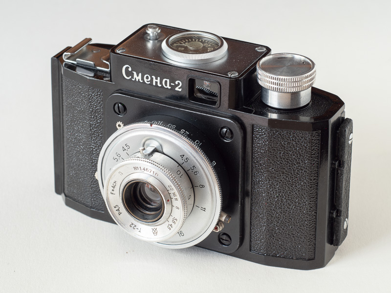

Completed a CLA plus some restoration work of a Smena-2.

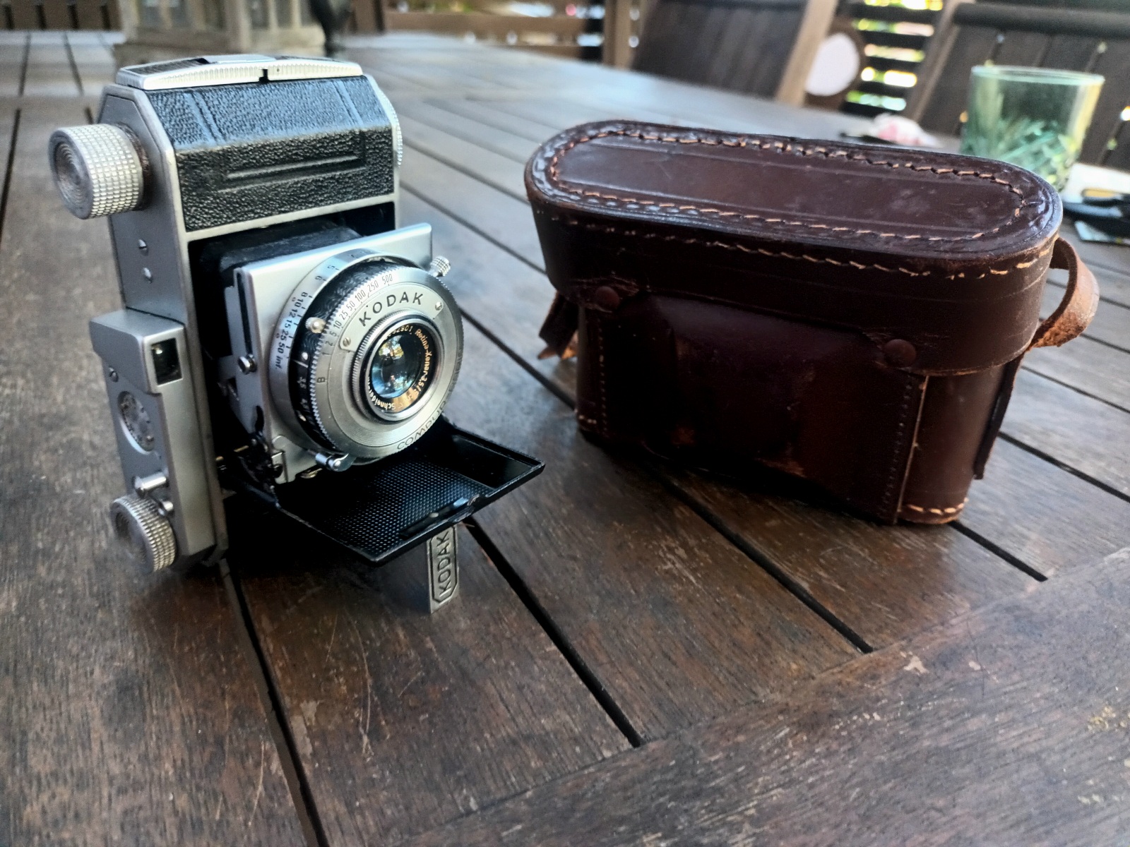

Picked up a little Retina 010 yesterday from the charity store. Wasn't working, gave it a quick clean and lube and now it is. Removed and cleaned the lens elements as well.
What a cute little camera.
Anyone know the filter size?
Love these cameras; so neat and compact! Looks like a nice example you found and you did a great job cleaning it up.
Be forewarned that they tend to multiply when left unattended, much like coat hangers.
I found listed online that the #1 takes 21.5mm screw-in filters with 27mm push-on lens shades/filters for the Xenar 3.5f or 27mm thread/32mm push-on for the 2.8f version.
I have a handful of tiny Kodak filters in this size range accumulated over the years, but sadly they tend to be degraded and practically unusable; I just keep them for display purposes.

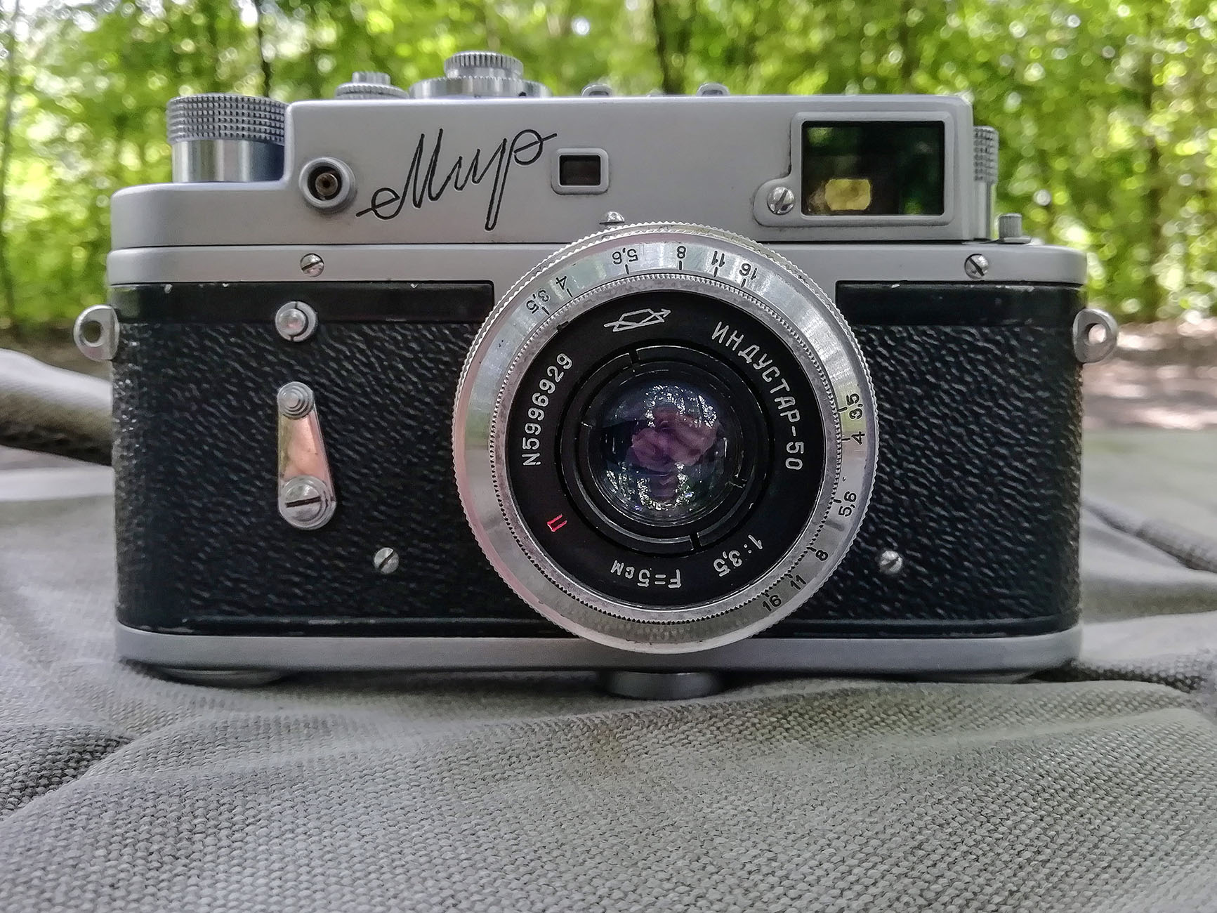

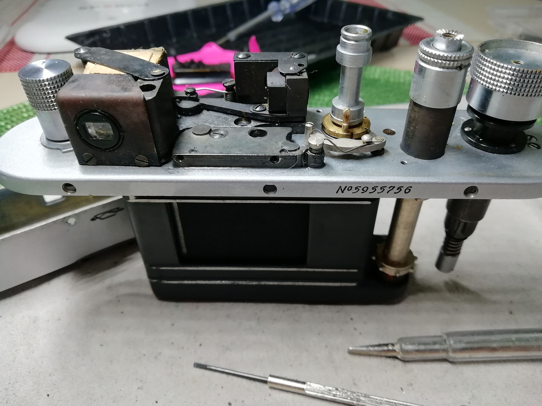

Mir. Simplified version of Zorki-4. without the mechanism of delayed delays. Minor cleaning and some lubrication. 1959 release
