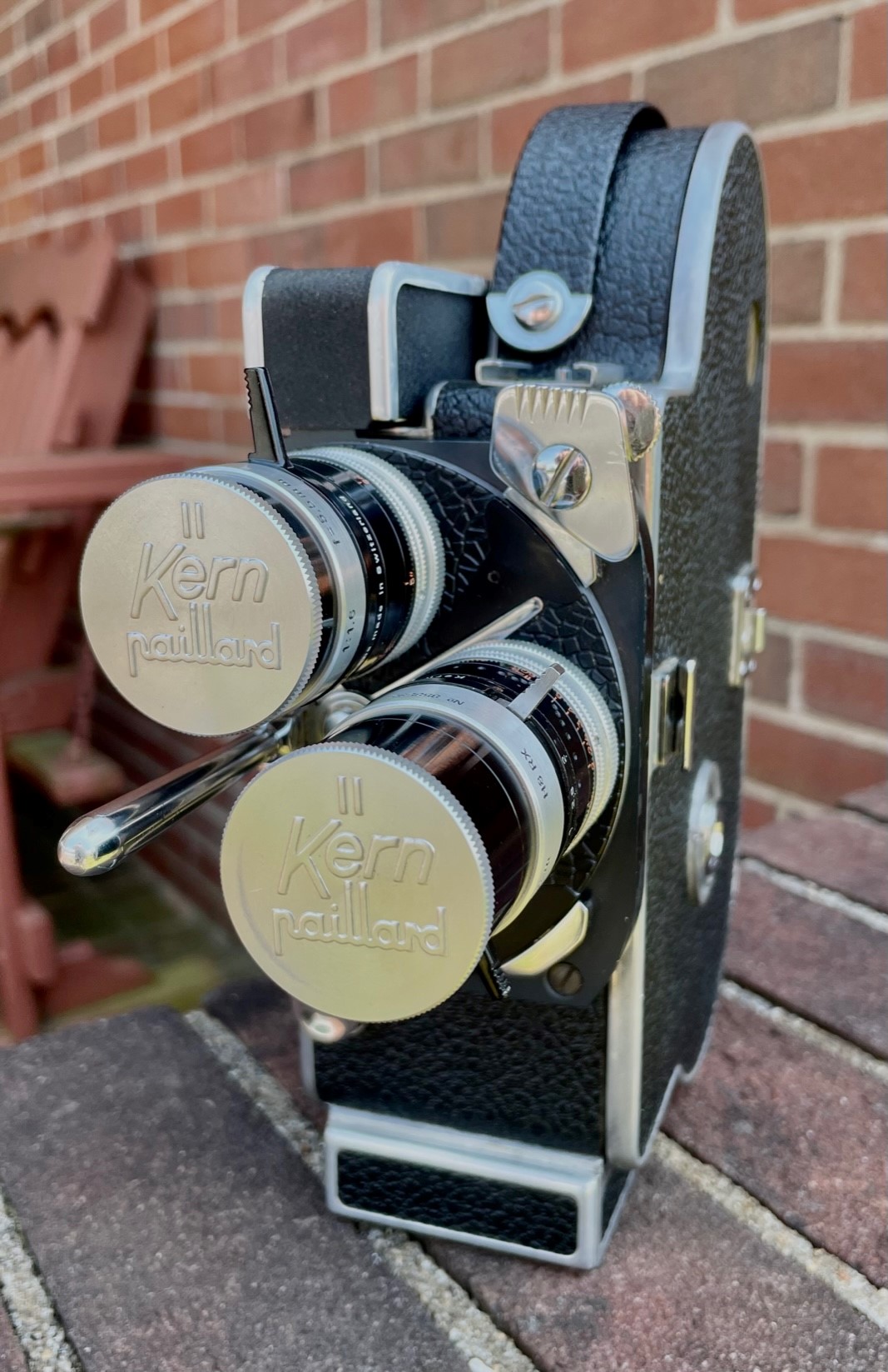

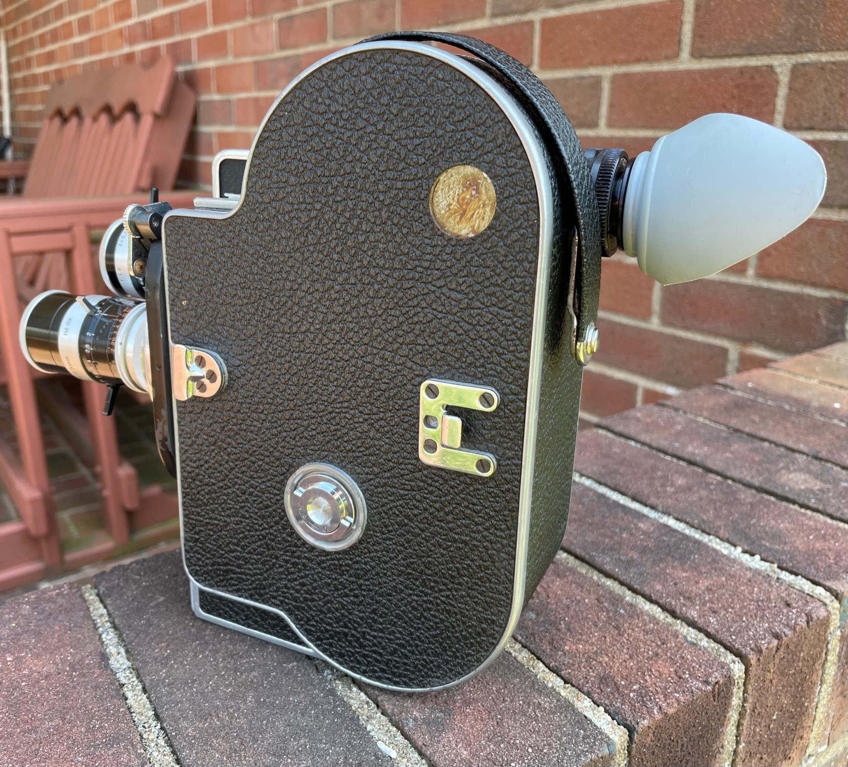

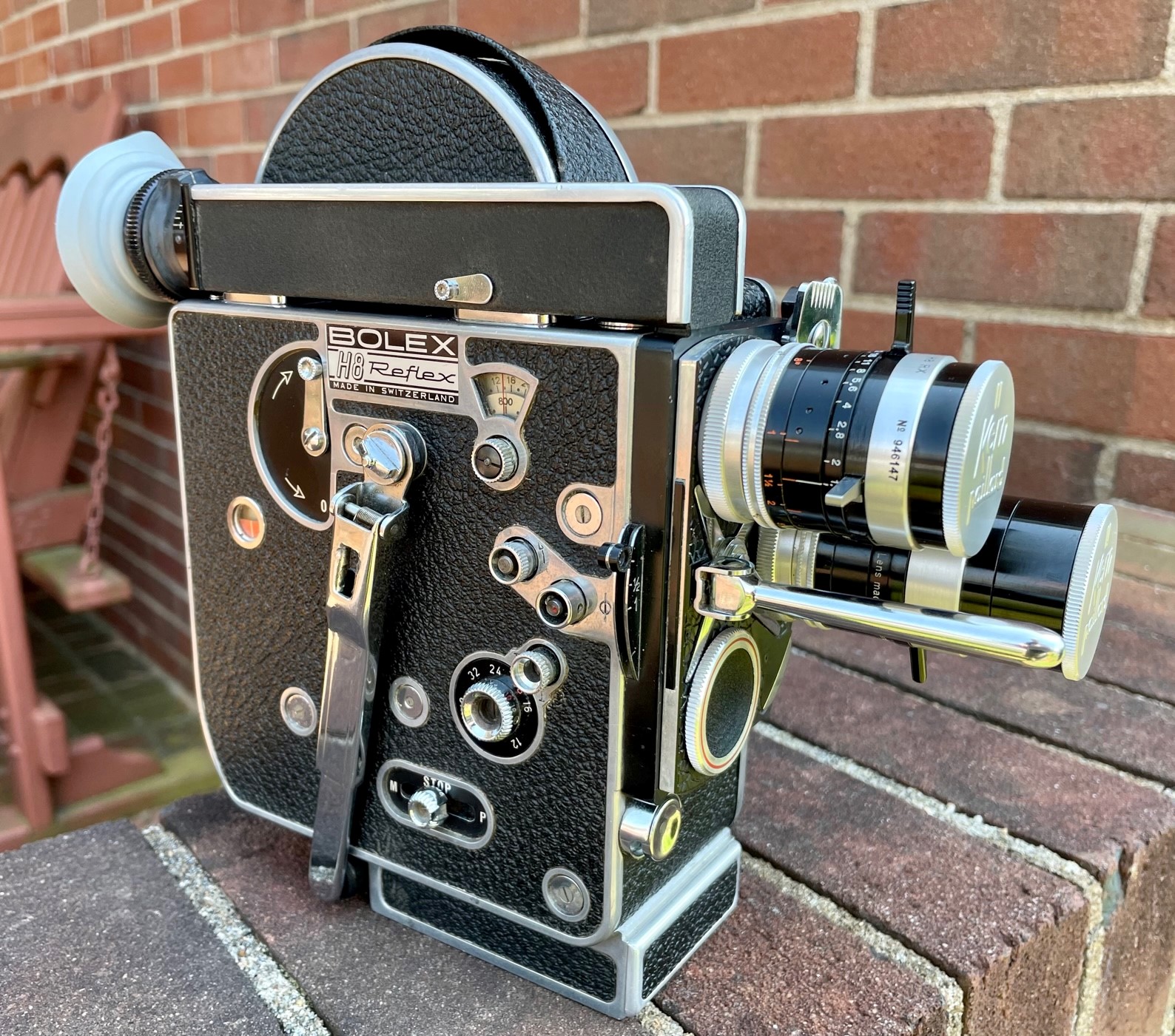

I just finished cleaning the viewfinder, prism assembly and the other reflex optics of my Bolex Rex 3 H8 camera. I bought this camera in very rough, inoperable shape and have been steadily working on it in my spare time as I collect missing pieces or replacement parts.
Lenses for this camera are very hard to find and can be quite expensive, so I had to play the long game to find the two I have.
It should be good to shoot a test roll now; the viewfinder is clean and clear and it will run a full wind with only the most tiny slowdown in the last 5 seconds of a full wind at 18 fps.
I have a real affinity for Bolex Cameras, as I ran a motion picture equipment check out cage at two Universities and had to do many self-taught repairs on all models of cameras to keep the students going. They are great cameras...
Next, I have full Bolex Titler that needs attention. I just love working on this camera line...
PS: if anyone has a round Bolex Logo for the magazine door laying around in their junk drawer, I'd be interested in buying it!

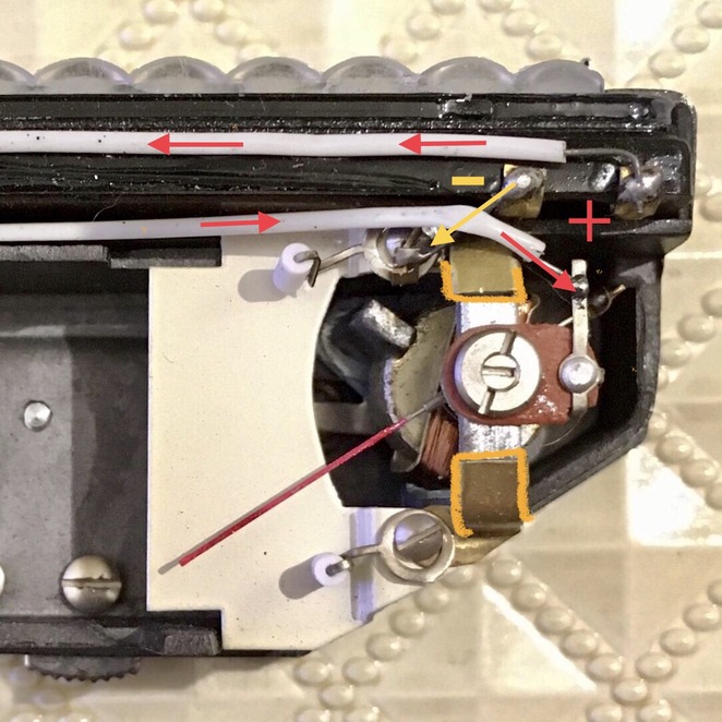

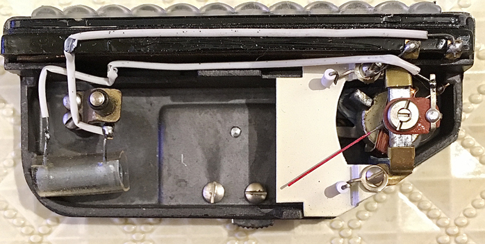

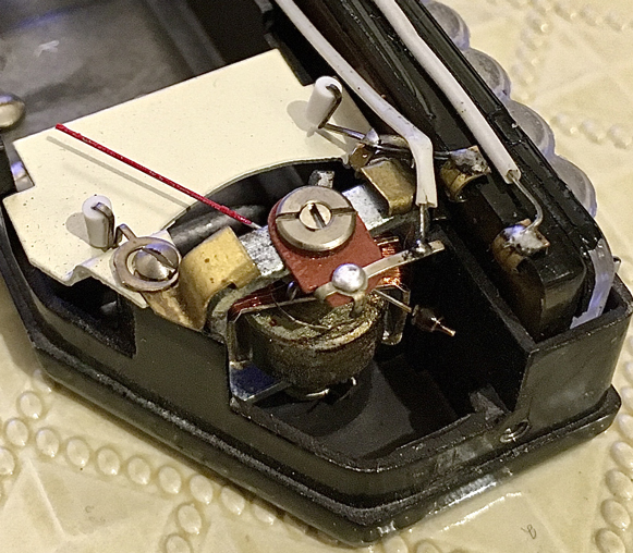

I've opened the inoperative Topcon-Meter that I picked up this morning with the intention of re-ionizing the selenium cell which I believed was dead. However, after playing with the meter a wee bit, it turned out that the cell is very much alive. The problem appears to be a bad solder joint which I haven't identified yet.

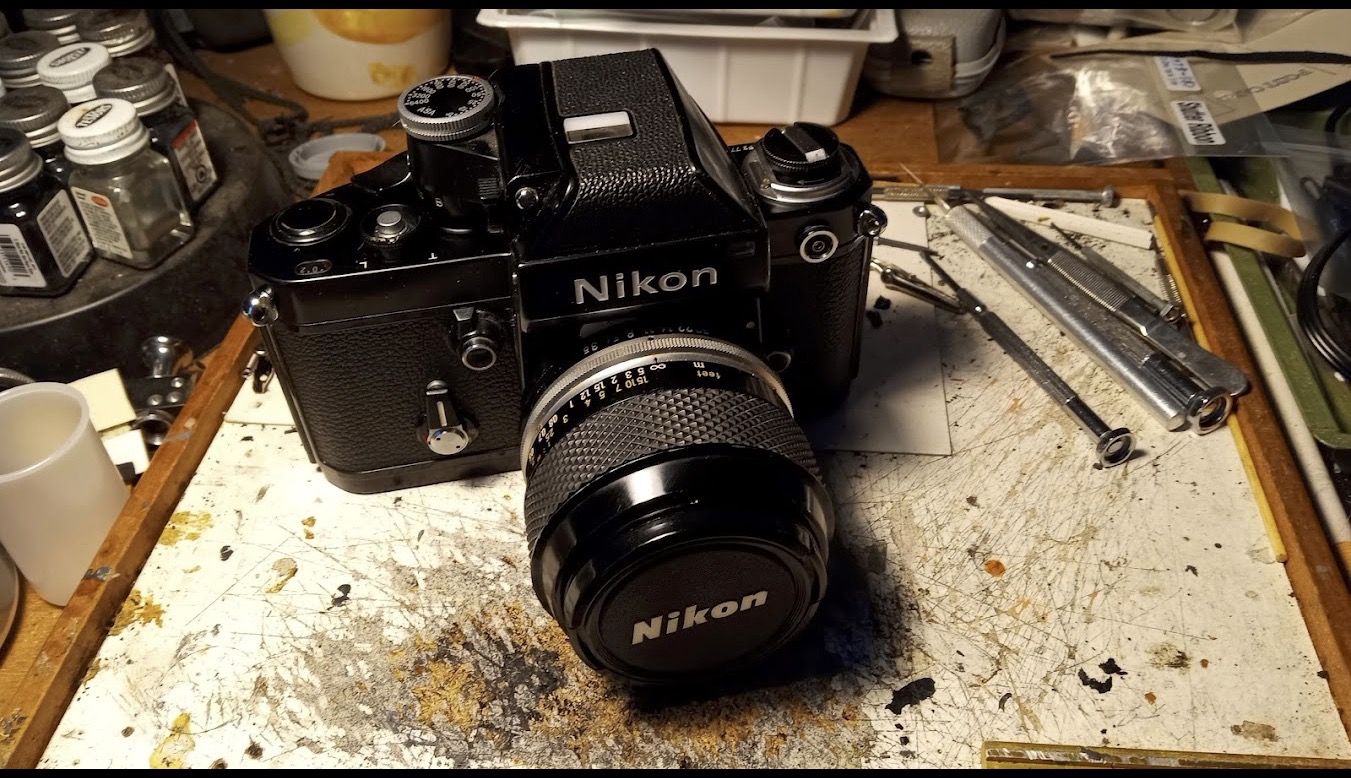

Picked up a Nikon F2 body "parts or repair--inoperable" for $80. Crunchy advance/cocking gear train. Popped the top right-hand plate and the bottom, cleaned out lots of crud from the gears and cams and did a little lubrication and it's nice and quiet now. The DP-1 and the Micro-Nikkor were in the arsenal already and not part of the purchase...
View attachment 343057View attachment 343058View attachment 343059
Beautiful restoration job! Many moons ago I had an H16 until I discovered Kinors and started shooting 35. The Bolex was more fun though. I even had a Clive Tobin synch motor. Sigh.
Yeah, I once had a pair of Silent-era B&H 2709's and a Konvas, but life happens and they had to go to pay bills. Life goes on...

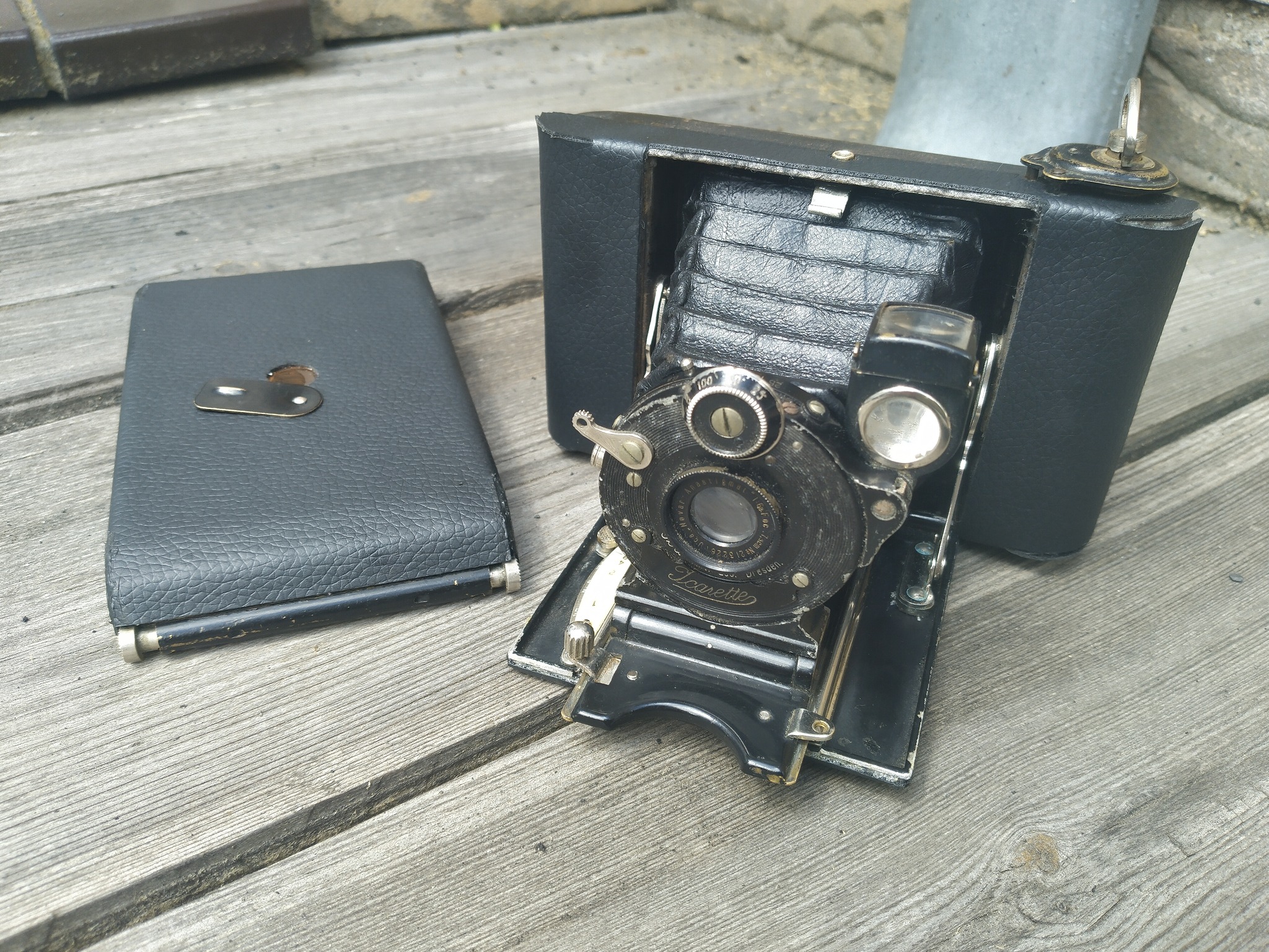

Couple of weeks a friend asked if I had any interest in some of the cameras he was given after another friend had passed away.
I wasn't really that interesting in any of them, but I reminded him of the going rates for some of the more collectible ones he had.
He did challenge me to fix one of that was worse for wear....a very tired-looking ICA Icarette.
Which is now very much a Work In Progress Project.
The leatherette was mostly gone or peeling off due to the rust on the body.
It needed a few taps from a rubber mallet to open up.
It is missing the red window, the latch, one of the knobs to draw out the lens onto the drop bed.
So yeah, this thing is going to be a challenge.
Cleaning off the old leatherette and rust.
One obstinate screw refuses to let me remove the drop bed from the body. If all else fails I'll drill it out.
Sourced some parts from the bits box, and bought some new self-adhesive leatherette. Slightly too thick, but it'll do.
And then I found a latch, very similar to the original on one of my parts cameras....
Currently I'm in the process of adjusting the latch so it'll fit properly and then either rivet or epoxy it onto the body.
Then the new skin can go on.

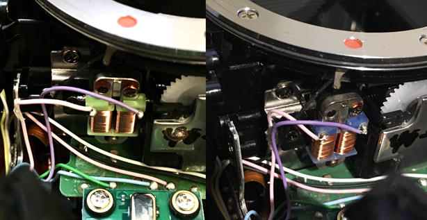

I've replaced the solenoid plunger of my Pentax K50.
Edit: I didn’t work, the aperture still stays fully closed when the Live View is on and the camera won’t stop down when the aperture ring is on A.
Humm
- Did I receive a defective or incompatible solenoid?
- Did I properly soldered the wires?
- Does the camera has a bigger problem?
Edit:
I re-opened the camera, and the joints were fine. Out of ideas, I tried resoldering the old solenoid but switched its U magnet with the new one. It worked, by gum, it worked! The live view and modes are back.
Update on the Topcon-Meter
It is fixed *thumbs up 🙂
I found out that the brass retainers were integral to the circuit and not there only to hold the needle mechanism. The circuit was open due to a small amount of play between the retainers and the mechanism which is why the needle was irresponsive. After moving the bottom retainer a wee bit inward to remove the play and make a solid contact, the needle started responding to light normally.

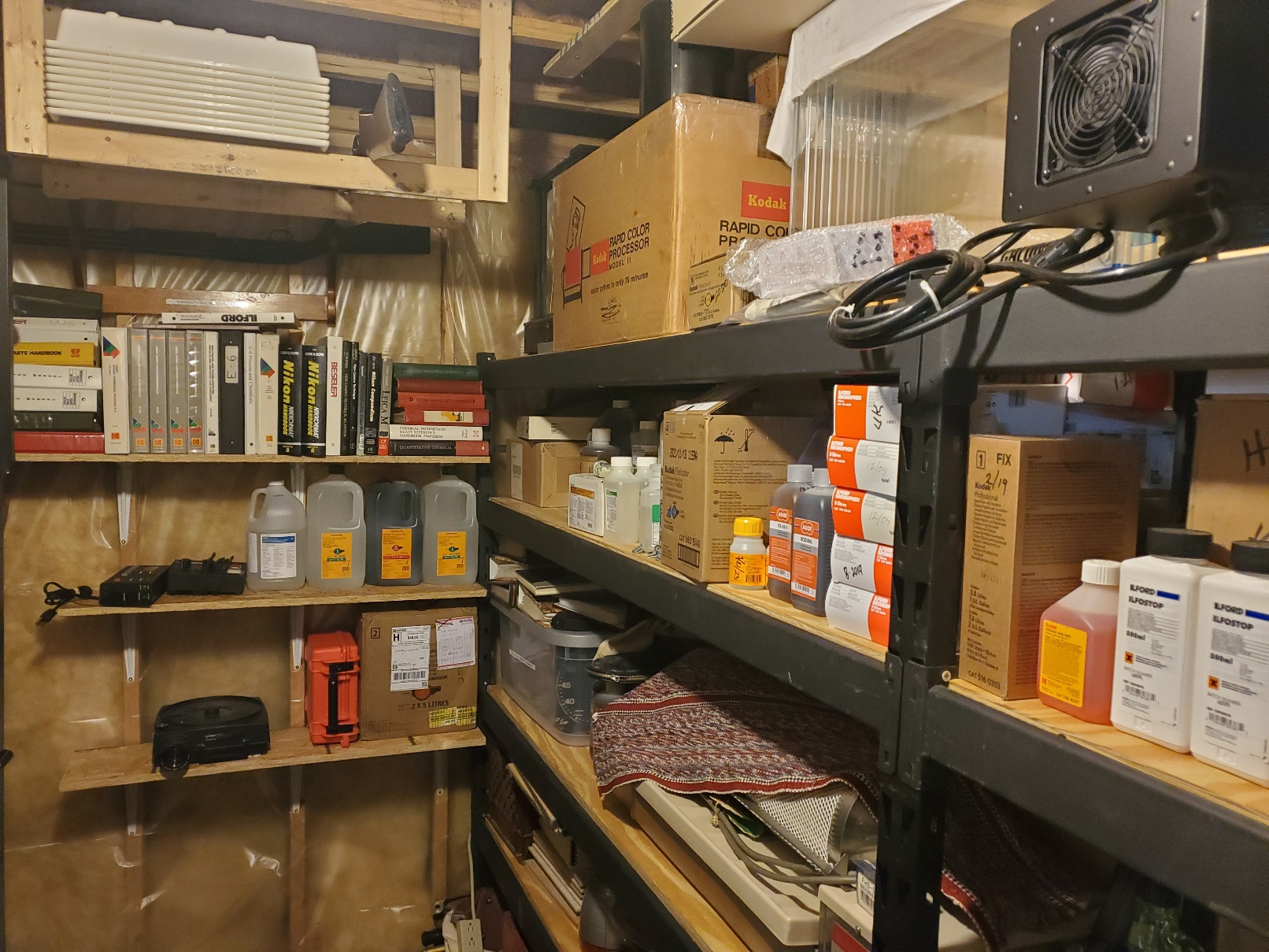

I like the "2 of 19" notation on your box of Kodak Rapid Fixer.
Unless of course it is supposed to indicate February 2019 :smile:
Yes I bought a bunch of Kodak branded stuff when Tetenal got into trouble, I really like the Tetenal made Kodak stuff. I bought 6 or 7 of those boxes of rapid fixer, February of 2019. I panic bought Ilford Bromophen Twice! First time was when Ilford got in trouble, you can see a couple boxes marked 2004, made in England. Second time was in 2019 same time I have just about everything to get by, that's not half of what I have squirreled away.
Room is air conditioned always. Cool, dark, dry stuff keeps forever.
I'm looking forward to seeing this when it's reassembled.
It's getting there....
I've epoxied the new latch to the back cover. Reskinned and riveted the cover for the red window in place. The corners have been rounded off and sealed with LET.
Cut and attached the new skin for the front of the body shell, but still need to finish the corners.
The bellows have been treated with leather conditioner.
The shutter blades were cleaned and haze cleaned out of the doublet lens.
Some black paint is in order to touch up the rough spots.
I still need to find/make a small replacement knob for the rail lock, though it's not necessary for it to work.
Also need to polish or replace the 'mirror' inside the brilliant finder
That said, it's starting to look like it might actually take pictures at some point in the near future. :wink:
