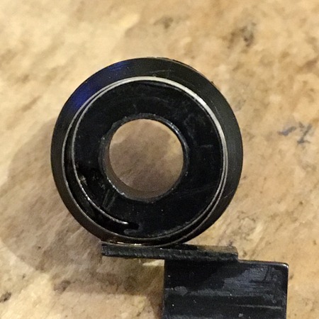

I’ve fixed the advance mechanism of my Instamatic 714. The end of the main spring snapped off due to excess resistance caused by an improperly re-rolled film and user error… Fortunately, I was able to disassemble the mechanism, snip the damaged end of the spring and reshape it with my rotary tool and a cutting wheel. Finicky business to say the least.
After the fix, the advance work normally.

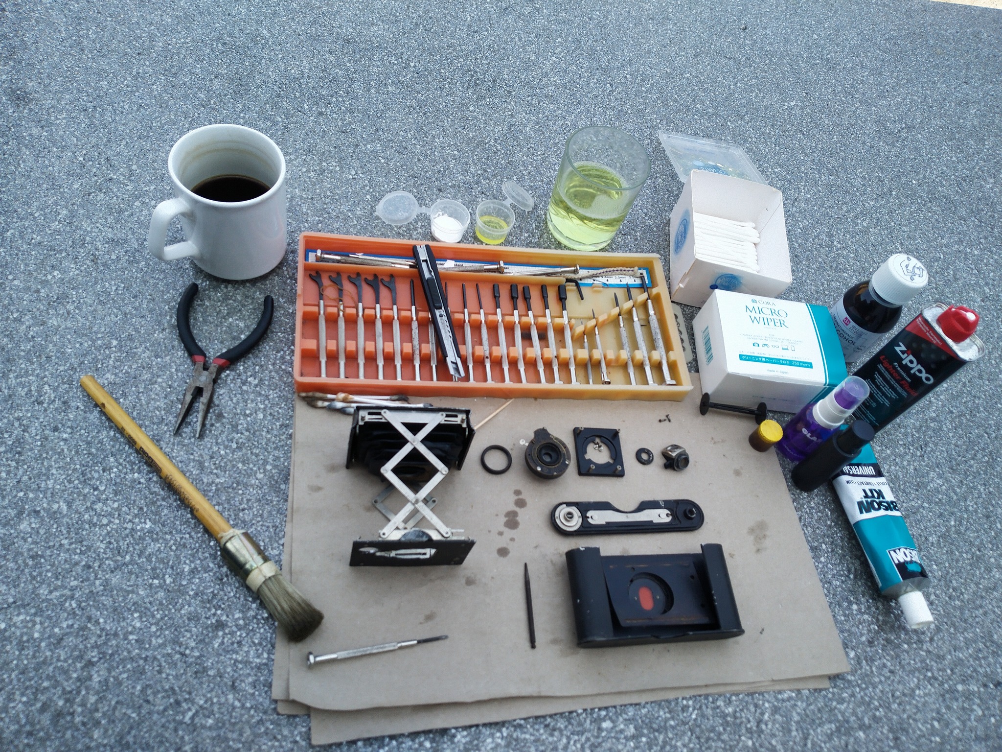

General cleaning job of a Autographic Vest Pocket Kodak.
Still some pinholes in the bellows to take care off
