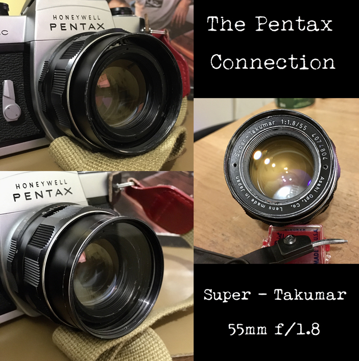

I had this Super-Takumar sitting in my closet for the past 7 years because of the damaged filter ring. It was warped in a way that prevented focusing and made it impossible to re-screw the beauty ring which I had previously removed to service the lens. Yesterday, I got lucky while trying to fix the filter ring yet another time, and then made a decision regarding the beauty ring which was still impossible to screw in the traditional way. It might not be "the belle of the ball" but now it can be used and serviced if need be.

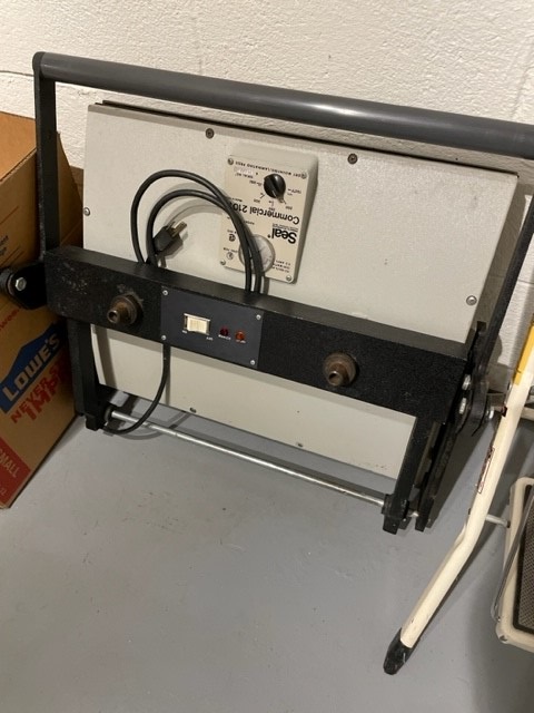

Scraped-down and cleaned-up a Junk store find of a Seal 210 Commercial hot press. Works a treat.

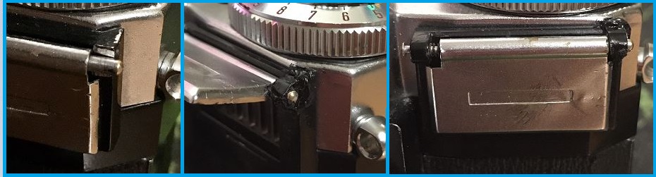

I've made a hinge of fortune for the light meter cover of my Contaflex IV. A piece of metal, some J.B Weld, and a touch of paint to make it blend a wee bit.
It won't win a beauty contest but at least now the cover won't fly open sideways.

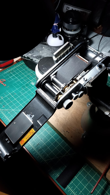

Adjusted the shutter speeds on my Pentax SP II using the shutter speed tester I built. The cam is worn so getting the speeds right was a bit of a compromise. Better than when I started and things got cleaned up a bit in the process.

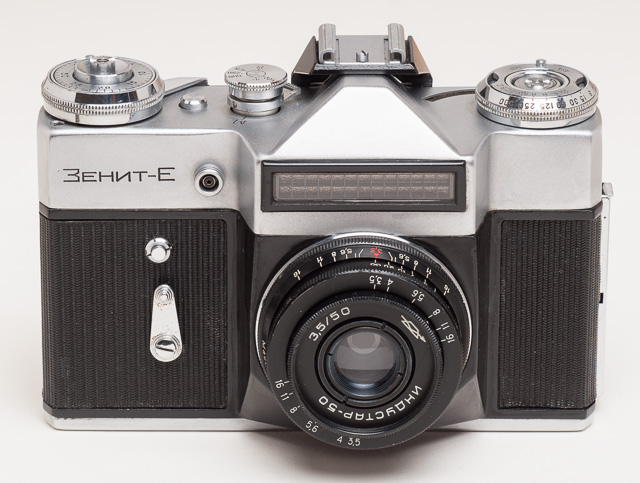

I CLA'd a Zenit-E and replaced the selenium cell with a silicon solar cell, so the light meter works.
