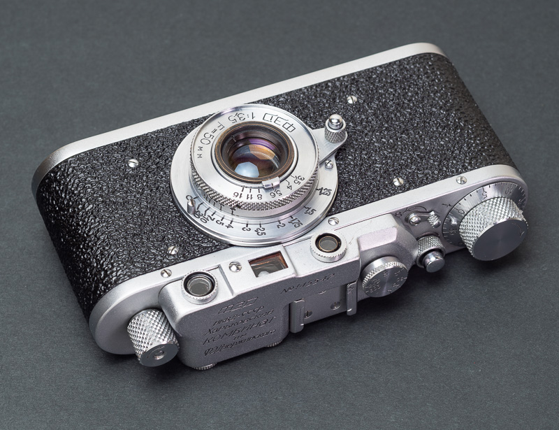

Just finished restoring a 1940 NKVD FED-1.
I've tinkered with leaf-shutter repairs but nearly always stopped at the stage of removing/cleaning/replacing the shutter blades. (I did try this on a Seikosha-S with less than fully satisfactory result.) But lately I have been playing with Ilex No.3 shutters and been pretty happy with the outcomes. So I bought a junker and decided to do my best Chris Sherlock imitation on it while doing a full teardown and rebuild. No stress--purely a learning exercise. I had searched for photos and diagrams without much luck, but found some, along with good info, in the National Camera ("Learn Camera Repair") manual. It's in lesson 10 "Variations on the Escapement Retard" starting on page 99. So I opened up the shutter and tried to get my head into the functionality. (The manual really helped here.) I learned the logic of the design and the dual-escapement sequence. Fired it over and over until it got stuck (oil on the blades) to see how the mechanism works. And I found out what a phone camera is good for: taking closeup shots of shutter mechanisms for later reference. I carefully took it apart, documenting every step, cleaned out all the oil (there was a lot) and put it back together. There was water damage to the flash sync mechanism and I never shoot flash, so I didn't replace that part. It's a much simpler mechanism when you remove the flash sync bits. Last night I finished reassembly and it all worked. And I only lost one spring! (I had a spare...)
https://www.flickr.com/photos/terry276/51925833527/in/dateposted-public/
https://www.flickr.com/photos/terry276/51927439520/in/dateposted-public/

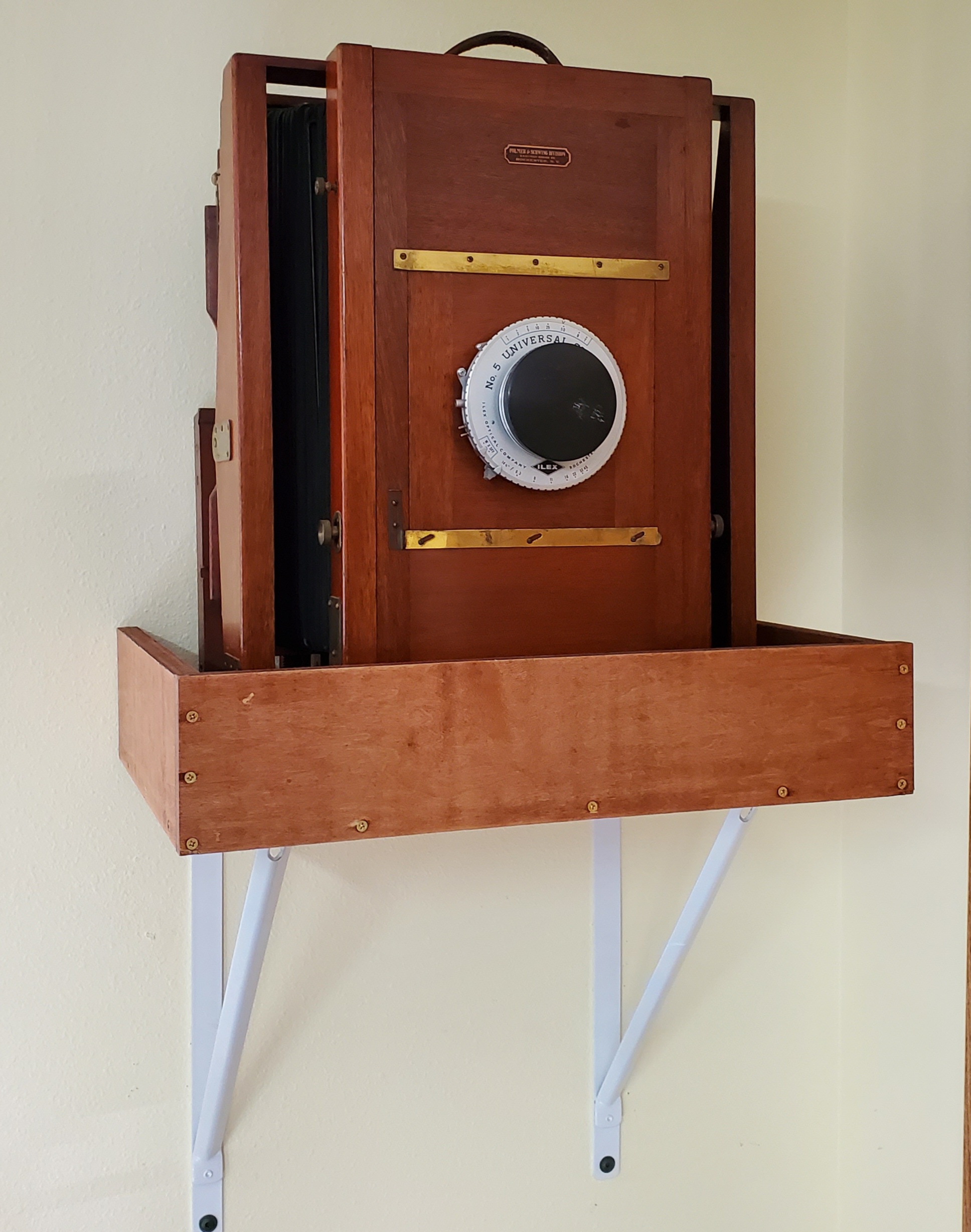

Built a nice perch for my 1917 Folmer and Schwing 11x14 commercial camera
I trying it envision your perch, any chance you could post a photo of it. It be cool to see the camera too.
Roger

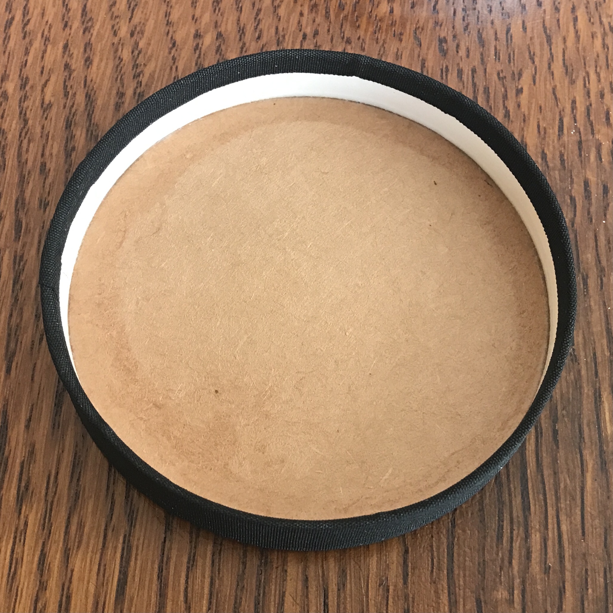

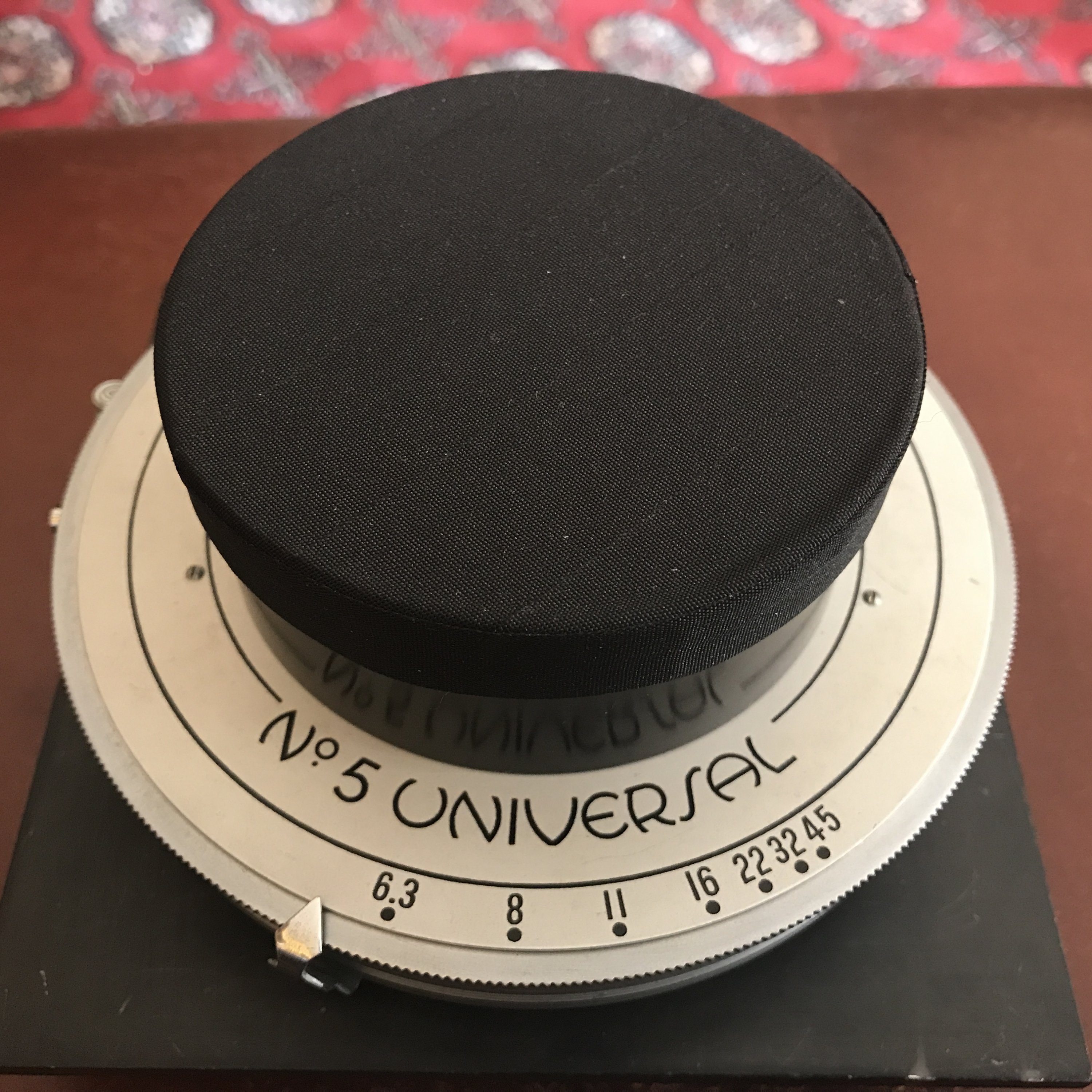

My efforts today, a set of quickie lens caps for my Gundlach Radar 8x10 f6.3 lens.

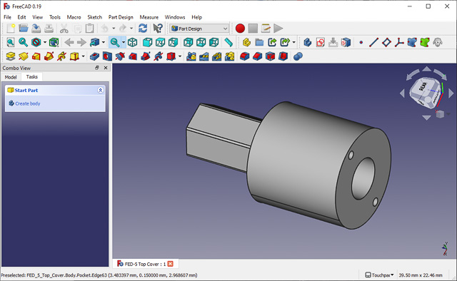

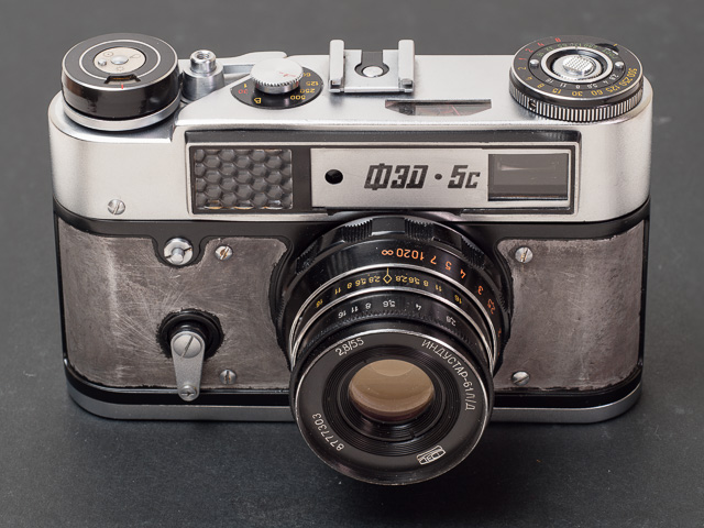

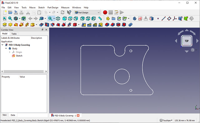

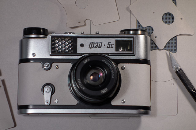

Designed (in FreeCAD) and 3D-printed a spanner wrench allowing me to remove the top cover of my FED-5s, performed general CLA and repaint, started creating pattern for new body coverings. Oh so tempting to buy a laser cutter, but where would I put it? Probably will opt for a much lower-tech solution, like simply using a printout of my drawing as a cutting pattern, else sending the data file to someone else for cutting.
Making sure that the patterns that I've drawn out will actually fit..!

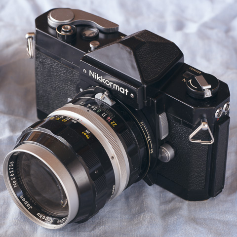

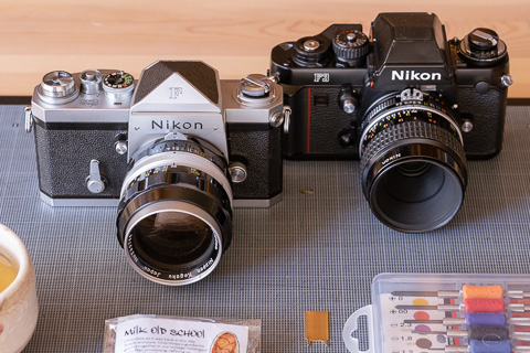

It certainly hasn't taken me very long to accumulate Nikon SLRs! The F body was broken in ways which seemed deliberate: Was it used as a training tool for service techs? Because I don't think that the mirror lockup or Bulb shutter settings would normally fail as they did here, and it took me quite awhile to diagnose, but once I did, the solution was easy enough. Nikkormat FTN needed more typical CLA type work. F3 still has problems with shutter capping at higher speeds. I'll check to see that shutter tension wasn't messed with, and will want to use manufacturer's lowest recommended settings. Perhaps shutter drum + rollers need additional attention.
55/2.8 AIS Micro-Nikkor is known for lubricant problems, am guessing that Nikon switched to a lighter grease which had problems with flowing where it wasn't wanted, and drying out. CLA-ing focusing helicoids tends to be a messy job, and some of these AIS lenses have floating lens elements, which means multiple helicoids. But ultimately, tidying up the older 105/2.5 and 55/2.8 AIS Micro lenses proved to be one-afternoon mini-projects.

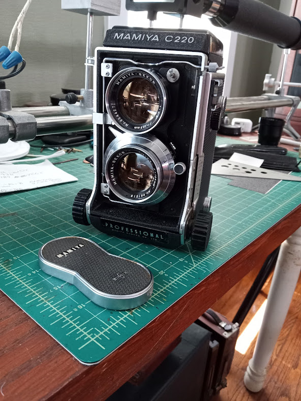

Rehabilitated a "parts or repair" C220 and a Sekor 105mm lens. The camera just needed some TLC and maintenance to the film advance mechanisms. The lenses just needed disassembly and cleaning but the shutter was kind of a mess--the aperture blades had oil on them that had turned to glue and as a result, some of them were bent beyond repair. (Somebody tried to force it...) So I swapped the shutter for another Seikosha S I had fixed (I have a couple of backups) and re-collimated. Then I took the damaged shutter apart and pulled a fresh set of blades from my parts bin and installed them, only to discover that the shutter wouldn't fire. Turned out that one of the escapement gears was slantwise, with one end of its shaft out of its bearing hole. I wiggled it back into place and it was a happy escapement once more. So now I have a full complement of backup shutters again! And a nice "new" C220.
