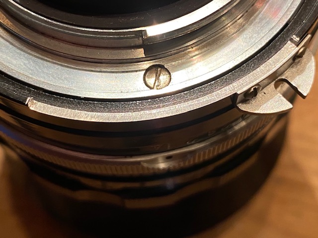

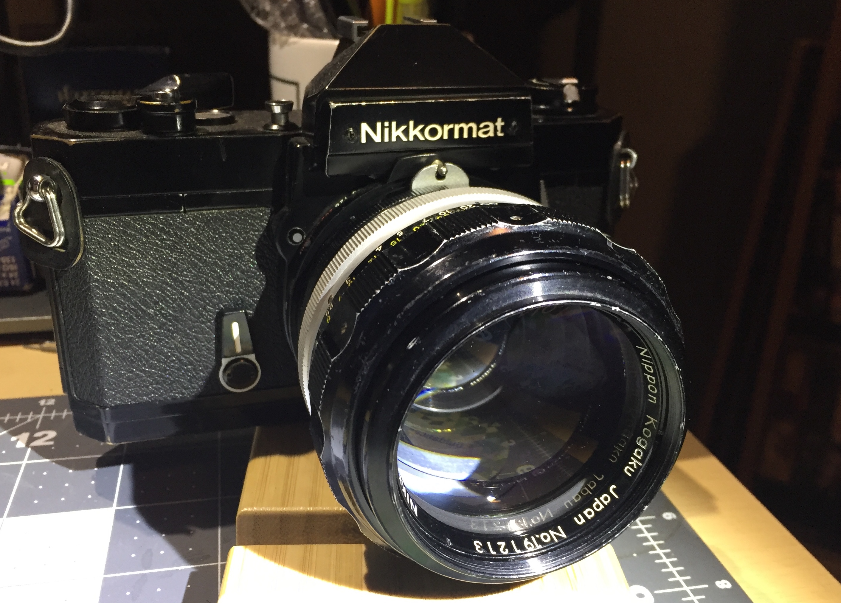

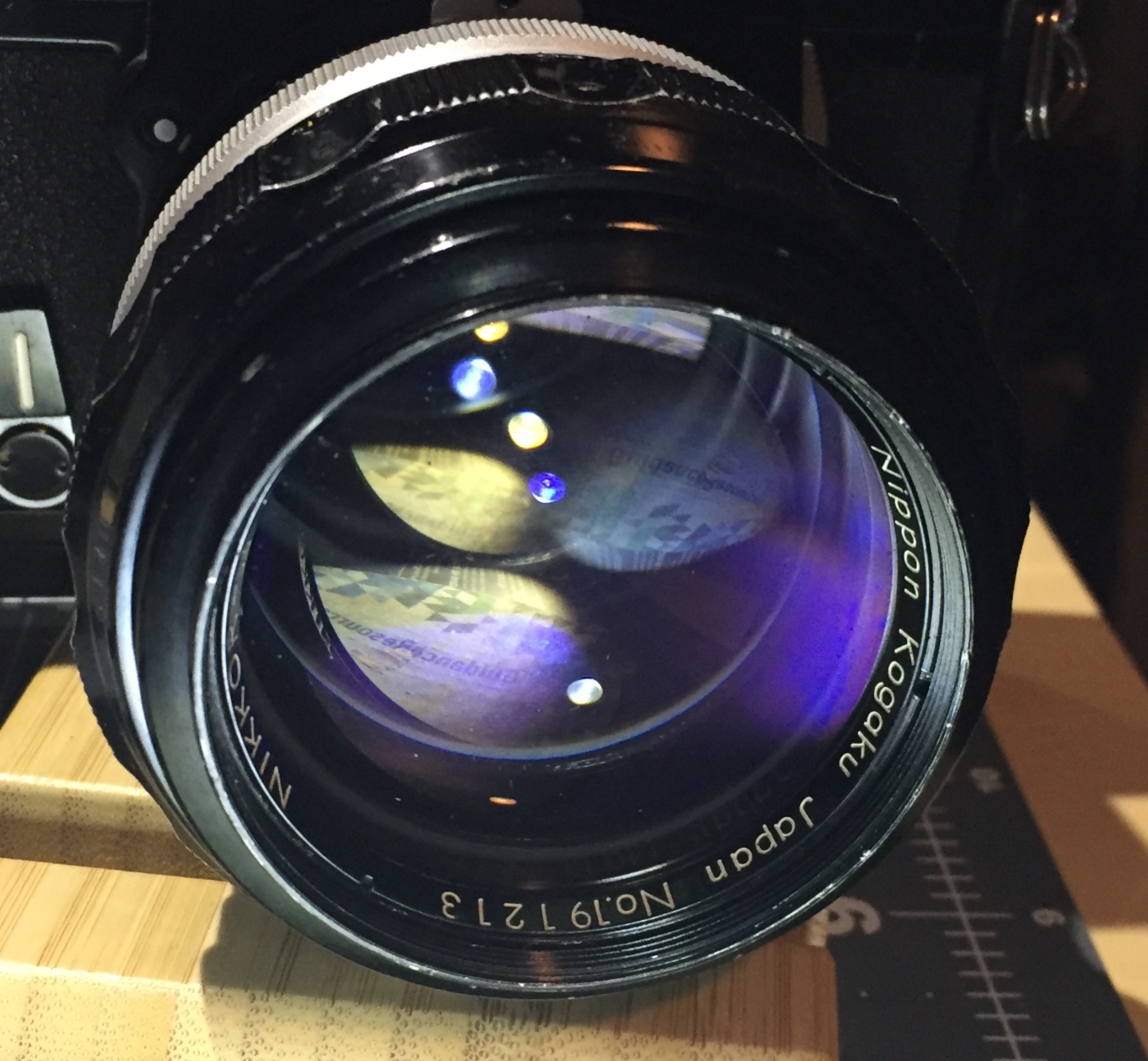

Well, maybe not a fix as much as a mod. I filed an AI notch into an otherwise minty Nikkor-S 50mm f/1.4, which fixed the problem that I couldn’t use it on my FE2. Been on the fence about it for a while but worked up the courage. Measure 500 times, cut once. BTW, a proper high quality mill file can look almost as clean as a machine if you’re careful. A little black paint and it’ll be virtually invisible.
Filing, done well, is more accurate and looks better than milling, done badly. And both the tool and the skill are cheaper to acquire.

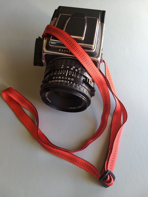

I made a strap for my Hasselblad using red webbing. The clips are the reproduction ones via eBay. I wanted a very flexible strap that I could wrap around the body when I tuck it into a camera bag. The genuine Hasselblad narrow leather straps are nice but still a bit too stiff. My OpTech strap is more comfortable but is rather bulky.
Yes, the Hassy straps are clumsy. Nice solution!

There are better Hasselblad straps available, seek and you shall find.
For my taste, wider straps are more comfortable. For my Nikons, I love those wide yellow ones. For my Hassy, I got this wide synthetic strap (from a seller here, long time ago), that has a softer padding on the part that rests on the shoulder/neck.
I have a wider Hasselblad one with padding for the 503 CX and narrow one for the 903 SWC.

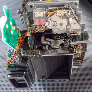

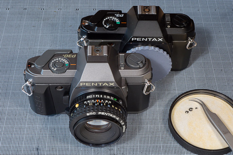

Replaced the notorious sticky rubber damper found inside Pentax P3 and P30 cameras which can cause skipped frames of film:
