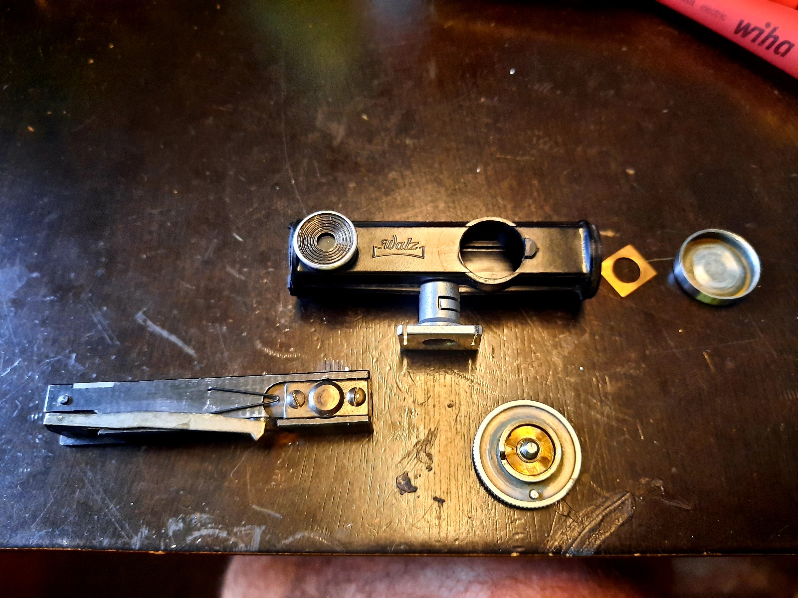

Finally worked out how to adjust my Walz range finder. Has a little threaded hole to insert something to turn a ball thingy .

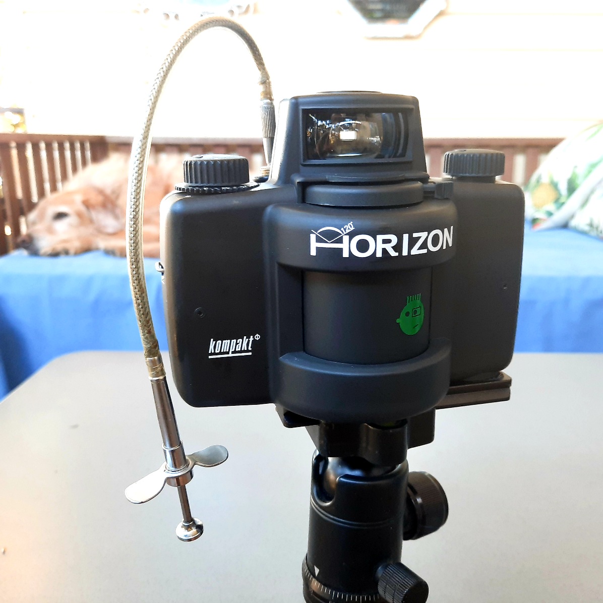

A Horizon arived today, had to make a new button to fit a cable release and tripod attachment as they dont have a tripod mount or anywhere to fit a cable release.
...hope it works, can't send it back now.

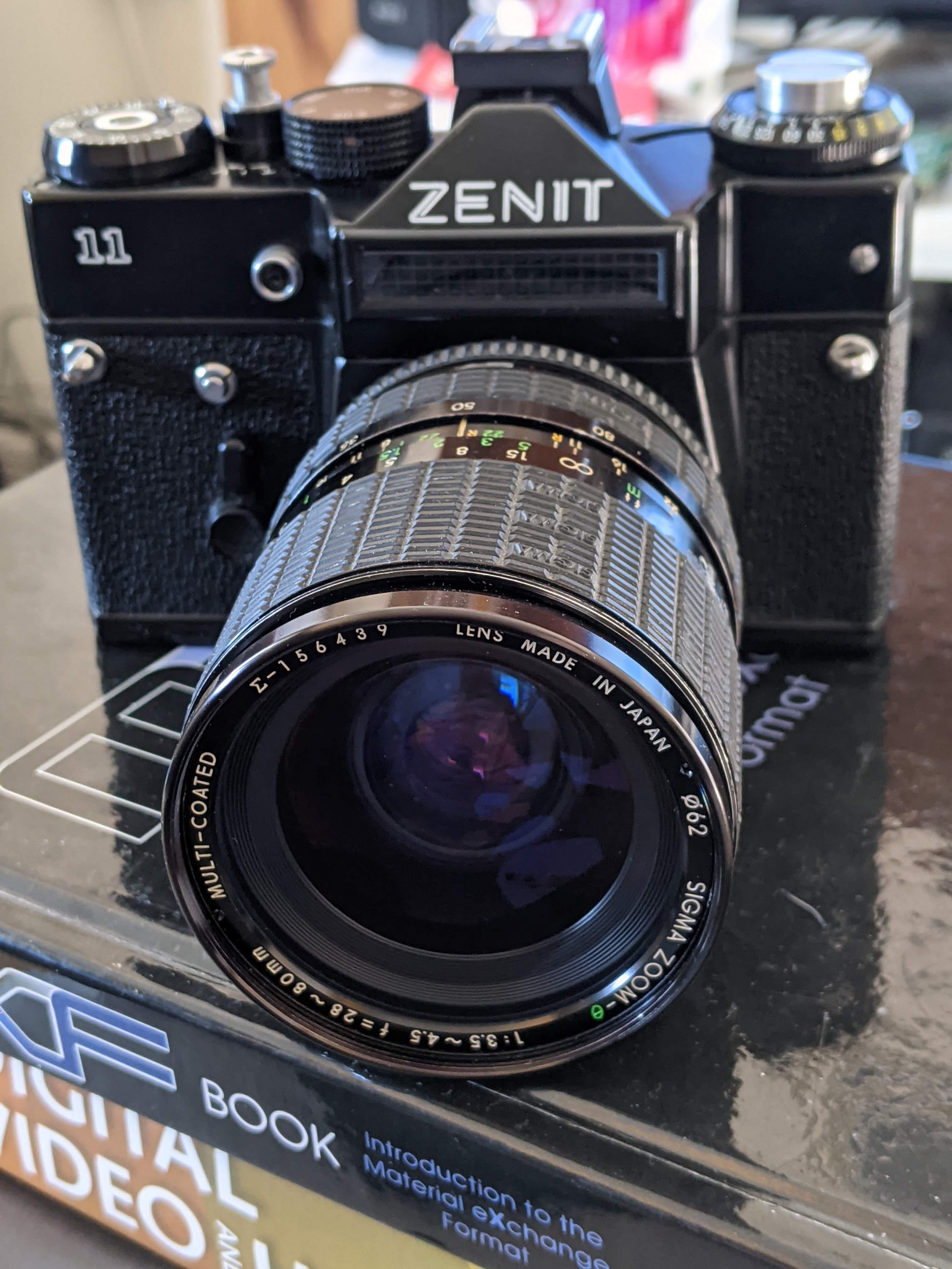

Recently bought a cheap M42 lens - a Sigma 28-80mm F3.5-4.5. Cosmetically it's mint. No dust/scratches on elements but it had weird, splotchy hazing on the inside of 1 element.
3 tiny grub screws on the periphery held the front ring in place and the 1st lens group came out easily as 1 big lump.
The 2nd group was 1 element and was retained by a ring that came out easily. The haze cleaned up easily with some iso lens wipes.
All back together and looking through it on a camera is no longer a soft mist.
I don't expect much from this lens as its an old, cheap zoom with zero info about it via google, but should be ok for now.

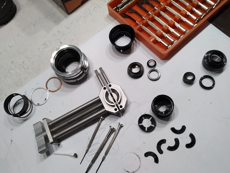

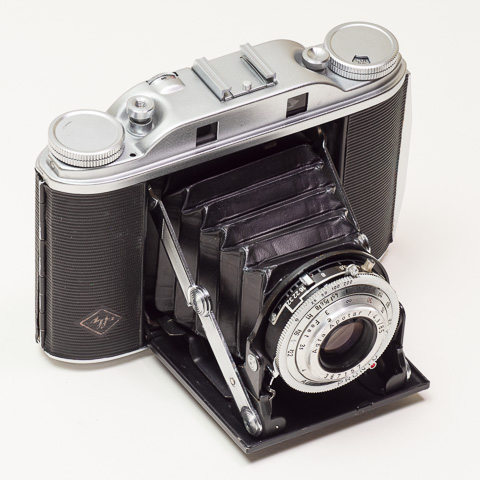

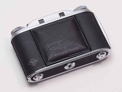

This was my first encounter with Agfa's green grease, and it certainly lived up to it's reputation! Lens focus helicoid, rangefinder wheel and it's adjustment screw were frozen solid. Had previously tried loosening them using naptha, heat (not much, as I was wary of cracking glass parts) penetrating oil, acetone and other solvents had no obvious effect. Taking a hint from Chris Sherlock's Youtube videos, I then tried a multi-day soak in CRC Lectra Clean, and that loosened things up just enough to be barely moveable. Some of that foul green grease even seized up the front lens element retaining ring, and oozed out along the edges of the front lens element itself. But once the assemblies were apart, the remaining green grease wiped away readily enough with my regular solvents.

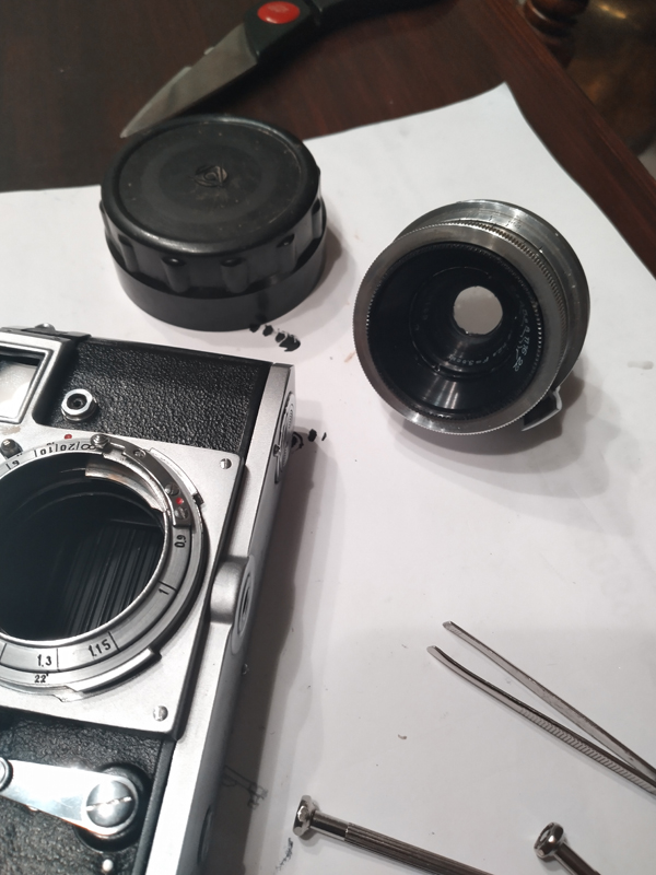

Jupiter-12 bought for parts, turns out it was relatively complete except for a broken pin screw in the aperture control ring.
Also the spring-loaded ring that engages with the rangefinder on the camera was to tight.
All back together now. Will check the focus later this week.
