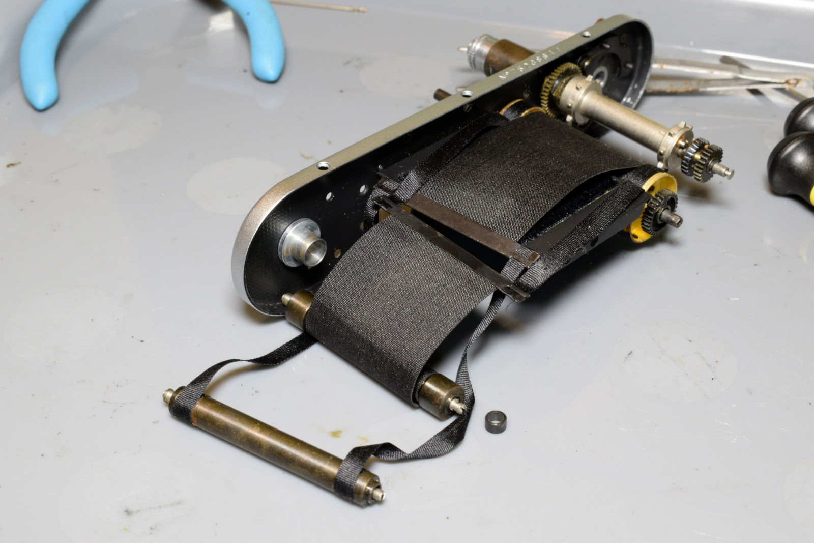

Over the weekend I've serviced a:
Balda Super-Baldax with a slow shutter,
A Franka Rolfix with stuck shutter
Deformed shutter blades and aperture blades out of position.
Rebuilt a Leica SVOOP take-up spool with a missing flange with part of a FED spool (that was also missing a flange)
And reskinned a Leica I
Cleaned the aperture blades on this Volna-3 lens. The auto stop-down works smoothly now.

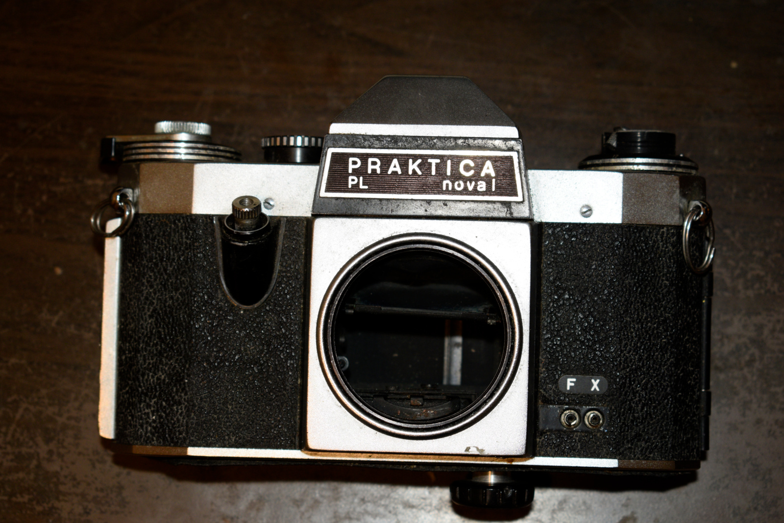

A Praktica PL Nova was in a very sorry state. Lots of corrosion and mould. Stank too.
The main issue was it wouldn't wind or fire. Somebody clearly had tried to clean the mirror with their hamfists and dislodged the mirror.
Put that back in place and it wound and fired. Junk camera as the mirror's surface was torn to hell. Surprisingly an image is still possible through the prism with this mirror!

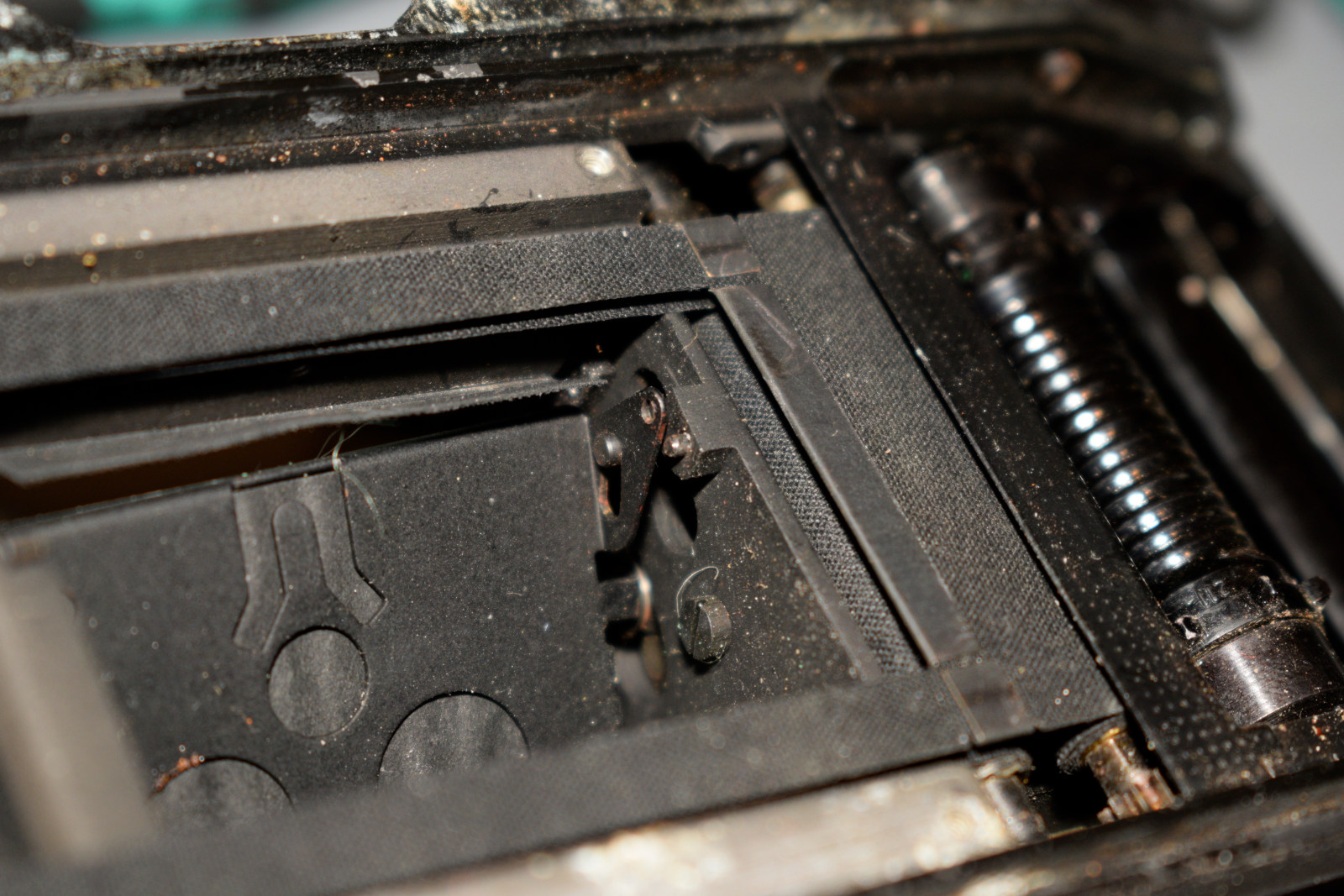

Current camera i'm working on is a Praktica LTL 3. Ok condition but won't fire or wind. Found a loose screw in the bottom of the camera when removing the base plate.
On removing the front plate I noticed the shutter-release assembly was wobbly.
The missing screw appears to go into the hole that's just visible
Just need to reassemble now.
EDIT: yep. That was it. Without the screw the mirror couldn't be cocked and therefore couldn't release the shutter.

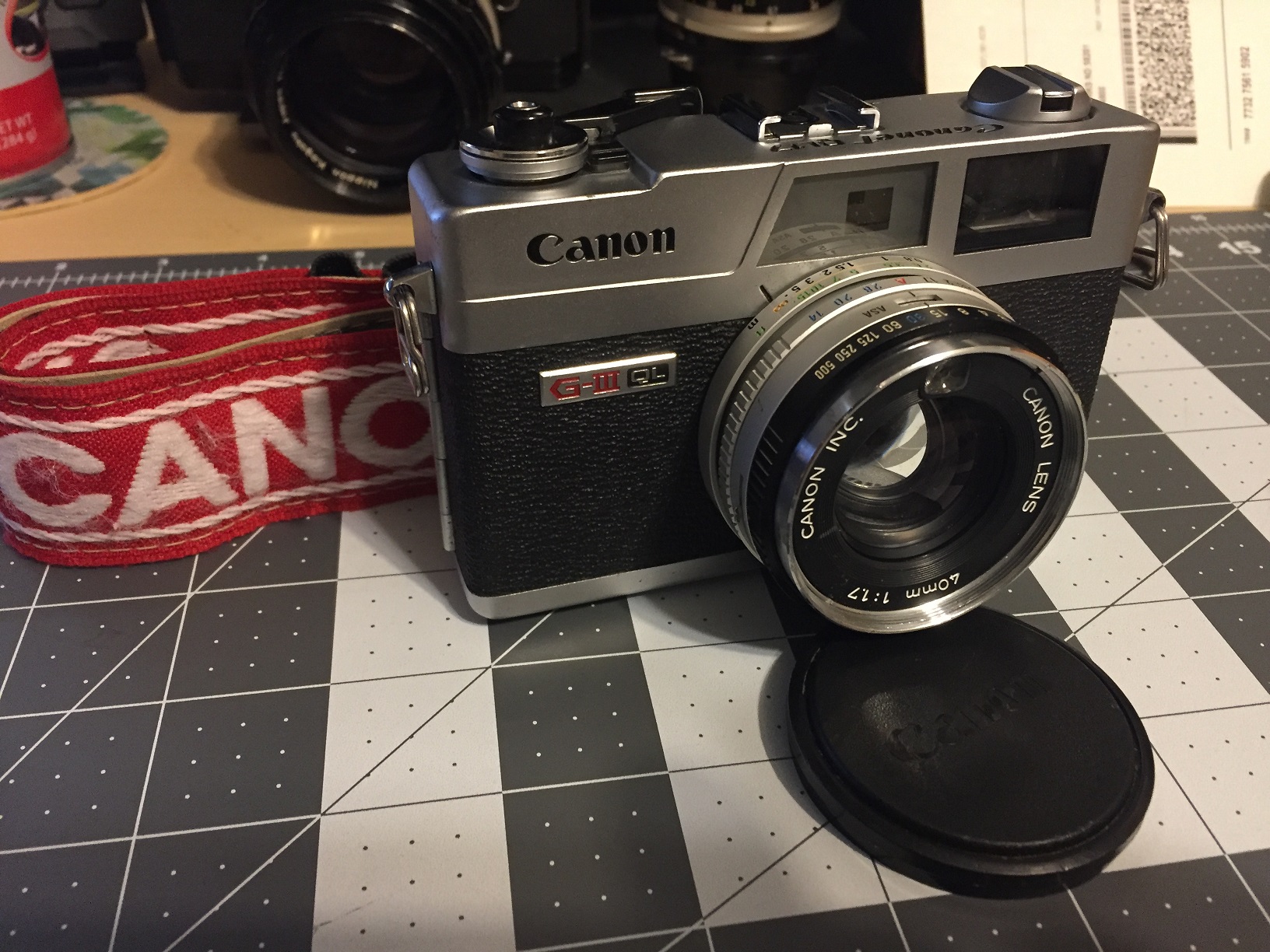

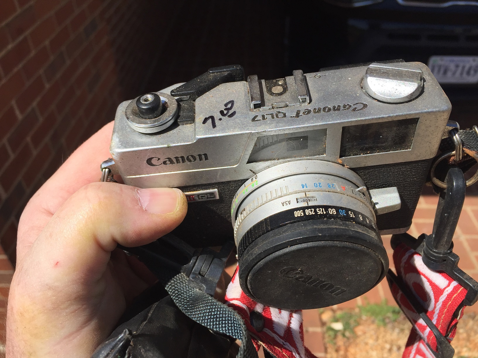

Bought a forlorn, filthy Canon G-III QL at a junk store this morning.
Now it's cleaned, fully functional and awaiting light seals I just ordered from Jon Goodman.
7 bucks for the camera, a few hours labor and chemicals and $15 for light seals. Not a bad price!
Serious bargain! I have one of those, they've got an excellent combination of fast, sharp lens, accurate and easy-to-use RF, good meter, and compactness. Easy to load, too.

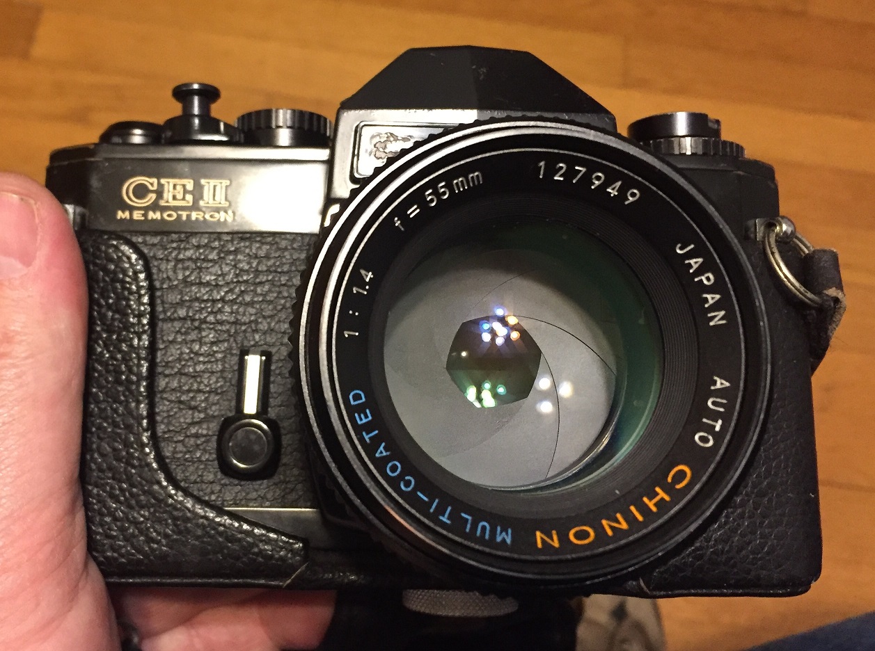

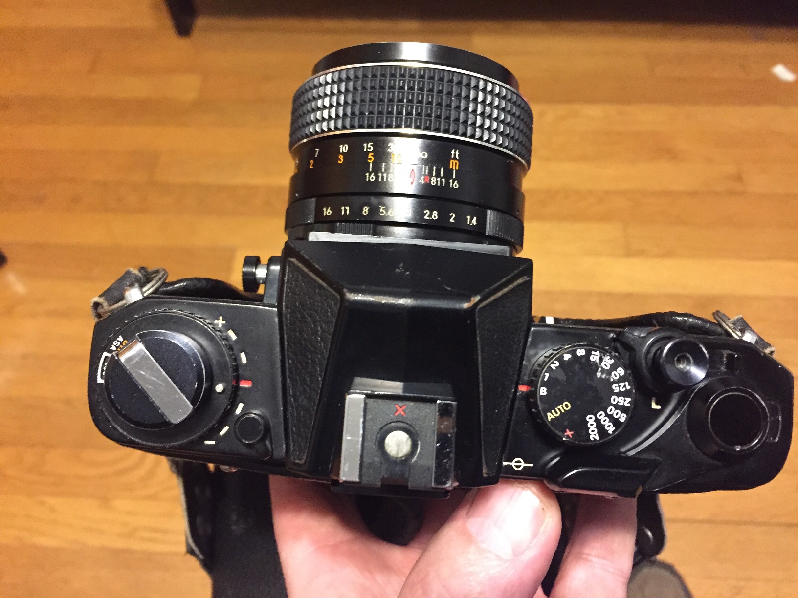

Chinon Memotron CE II; I was totally unaware of this very interesting camera until I found it today in a thrift store for $4.99 USD. At first, I debated if it was worth purchasing, as it was filthy and the aperture was fused open in the lens,but now I am very glad I did, as it is quite an interesting camera.
Turns out this is a camera that can use any M42 lens with with open aperture auto exposure, as I discovered in this very thorough article by Mike Ekman: https://www.mikeeckman.com/2016/11/chinon-ce-ii-memotron-1976/
After a thorough cleaning of the body and removing the front and rear element of the 55mm f1.4 multi-coated lens, I was able to free the aperture with naptha and alcohol. There was a touch of fungus on the inner surface of the rear element that wiped right off with alcohol. Now it's amazingly clean and looks like quite a good lens.
I might have a problem finding new light seals, but I haven't contacted Jon Goodman yet; I'll bet he can help. The leather is pretty shrunken and weirdly lifting around the edges, but in no danger of falling off. Maybe someone offers some leather that fits this camera; any ideas?

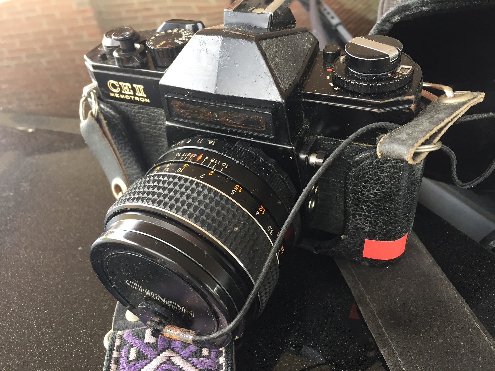

I am constantly surprised at how many models of cameras I had no idea existed. Foolishly, my first impulse was to dismiss this camera as a mediocre camera and now I am quite enthusiastic about it's potential.
EDIT: OH and if you want to find one, try searching for a rebadged GAF L-ES or Reviewflex 4000 EE; same camera, probably a give-away price...
View attachment 271914 View attachment 271915

Kino,
You're going to have fun with this camera! I have both a L-ES and a Chinon CE-3. The L-ES has become my go to street photography camera of late. Why? Because of all the great M42 lenses! I generally use it with my SMC Takumar 35mm mounted. Preset focus and f-stop and fire. Something that's not widely known is that the shutter in the L-ES can reach a top speed of 1/4000th in auto mode. I found that out in a tiny note in Modern Photography.
It was also sold by Sears at one point and also by Alpa
On the covering peeling off: This seems to be a well-known Chinon problem. If you go to CameraLeather.com, he sells coverings for the Chinon L-CS/GAF-17-those cameras use the same body as the L-ES. I recomend the Griptac highly.

Thanks for that information and advice!
In just fiddling around with the camera, it has earned my respect even prior to shooting a roll of film. A real bonus is being able to use all my Super Takumars in auto mode.
I thought there must be another camera model that used the same leather. Now, to find a Chinon name badge or get creative and make my own.
