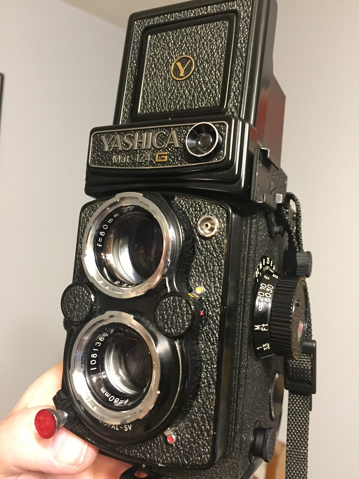

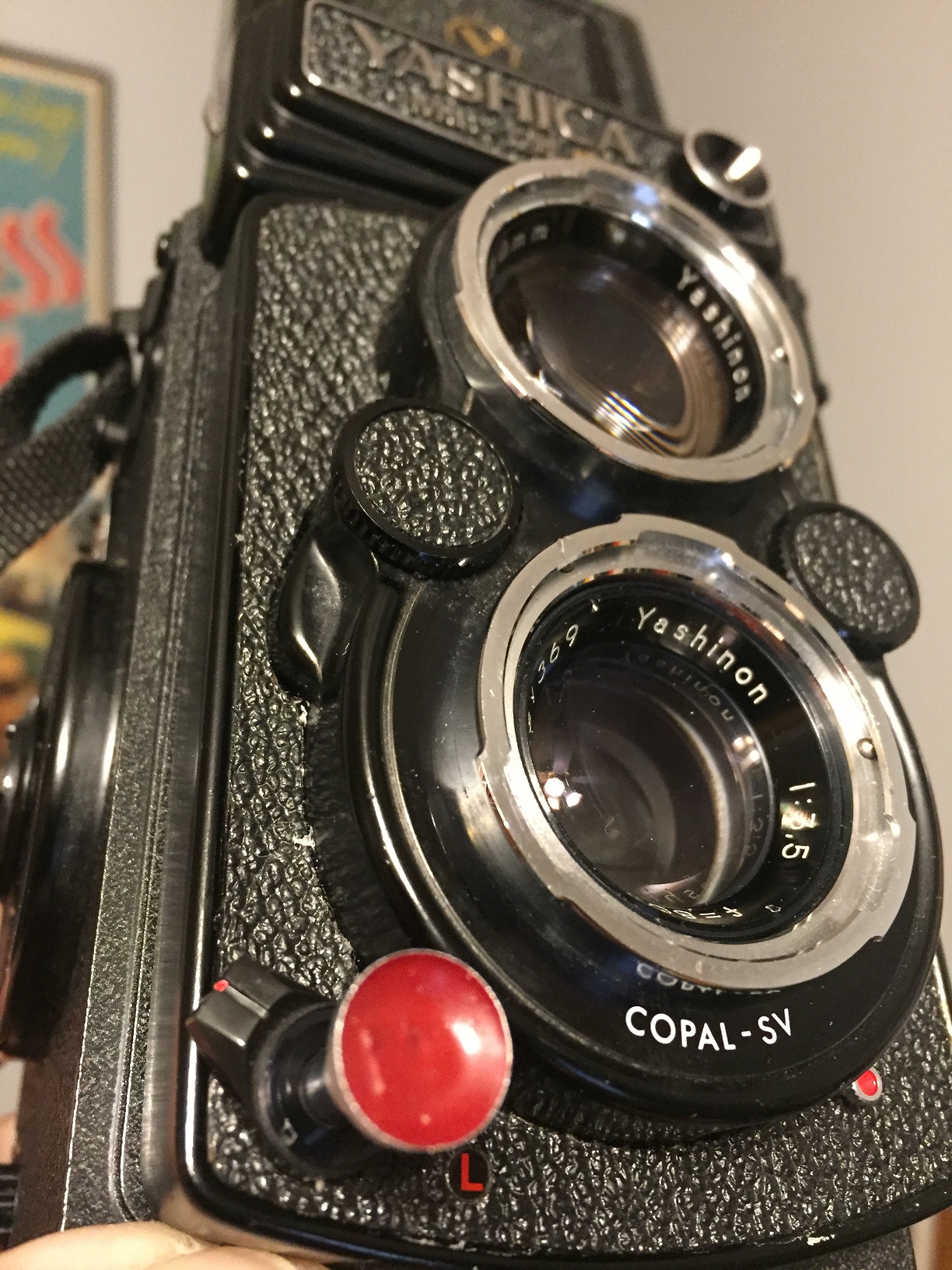

Fixed the floppy shutter release on my Yashicamat 124G. The slot in the release piston had opened up so far it allowed the cable release pin to drop down into the body of the camera. Careful bending of the face plate and the release piston to reform the slot with pliers and a bit of lube and it's happy and solid again. Someone must have dropped it or bumped the camera with a cable release inserted to have bent the piston and face plate so drastically. I've been living with it like that for a decade, so it's nice to finally get it fixed!

Removed and cleaned the haze from the rear element of the taking lens of my Yashicamat 124G. I have to do this about once every two to three years. It cleans up easily with Kodak Lens Cleaner fluid and a Kimwipe. Apparently the hazing is caused by outgassing from shutter lubricant and is well known as a problem with the Yashicamat.
I toyed with the idea of leaving the lens element out for a month or two to (hopefully) 'dry' out the lube a bit but didn't like the prospect of losing or damaging the lens element. The hazing does appear to be diminishing over time so perhaps in 10 years this ritual cleaning won't be necessary.
