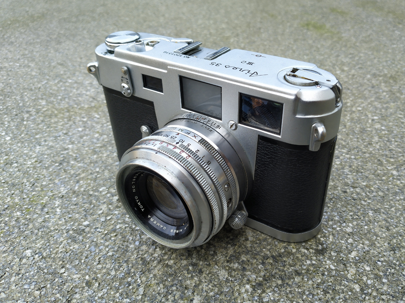

Aires IIIc, had 3 loose elements in the VF/RF, and the aperture ring was loose. Probably because the previous owner bounced it off the pavement at some point.
All fixed and calibrated now.
Still need to replace one broken pin on the back of the shutter and give it a good clean.
Great camera! I have one that is fully operational and one that is in a box awaiting my attention...

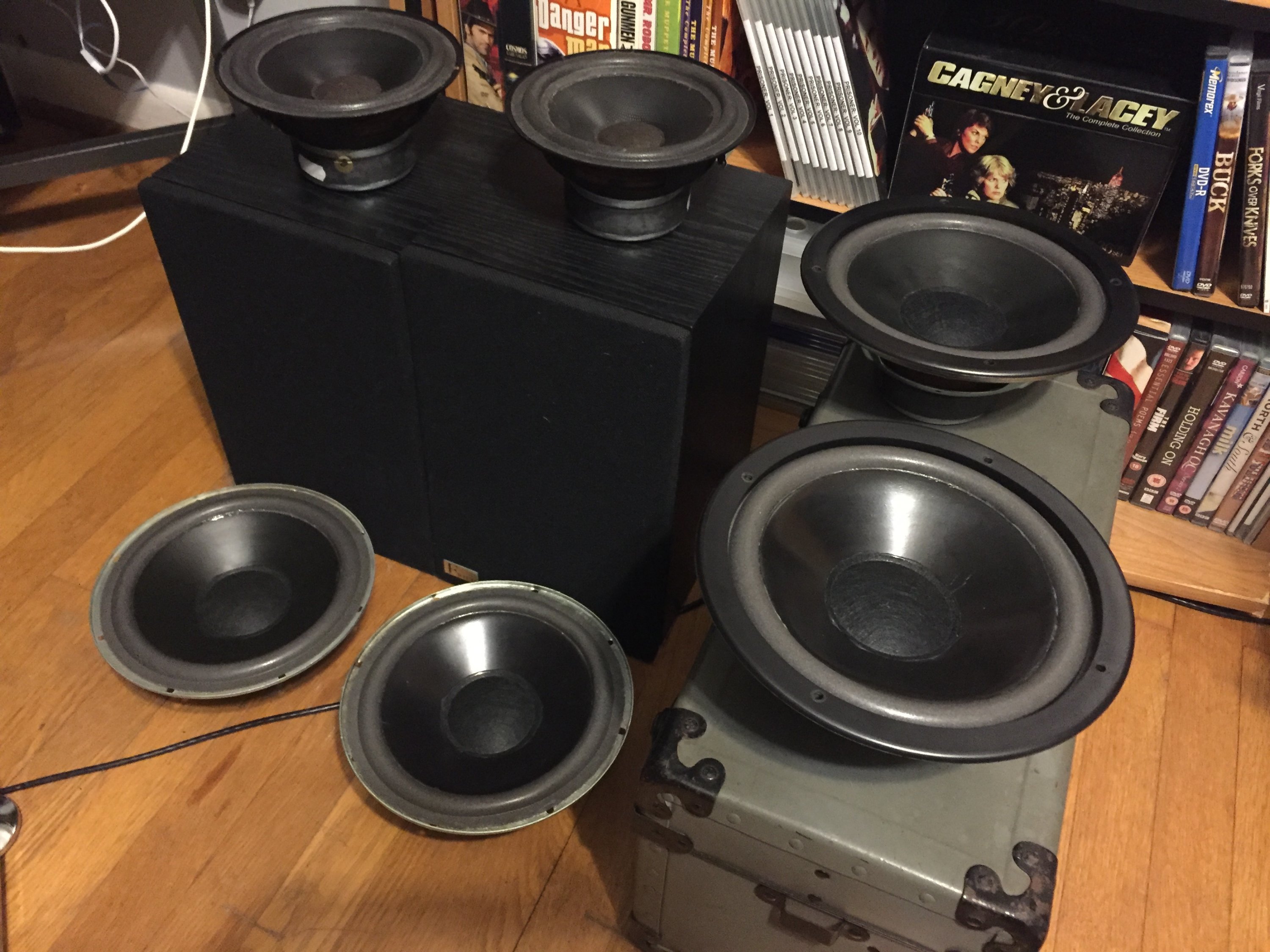

Well, this is analog, so I will post that I just refoamed 3 sets of rather rare speakers.
Fried Signature Series A/2, Q/2 and the Beta IV bookshelf monitors. Got to let them dry and install the drivers back in their cabinets tomorrow.
That was interesting. Hope I did it right!

It's back together now, I drilled out the broken pin on the back of the shutter and tapped in a custom replacement
The shutter mechanism itself took a good bath in the ultrasonic cleaner.
Only the aperture dial doesn't feel as smooth as I like it to be. I'll look into that sometime in the near future.
I might also touch up some of the engravings with a wax crayon.

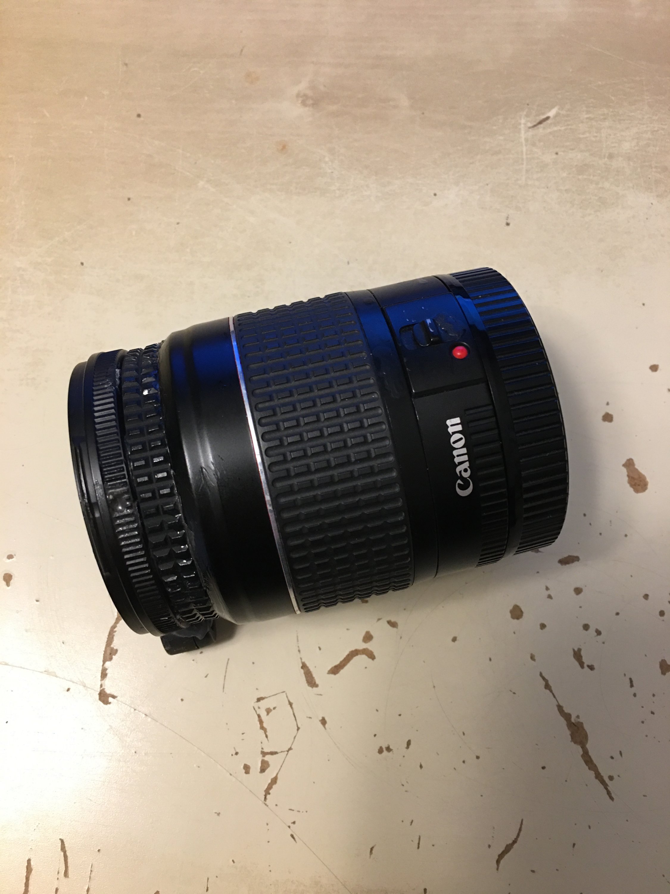

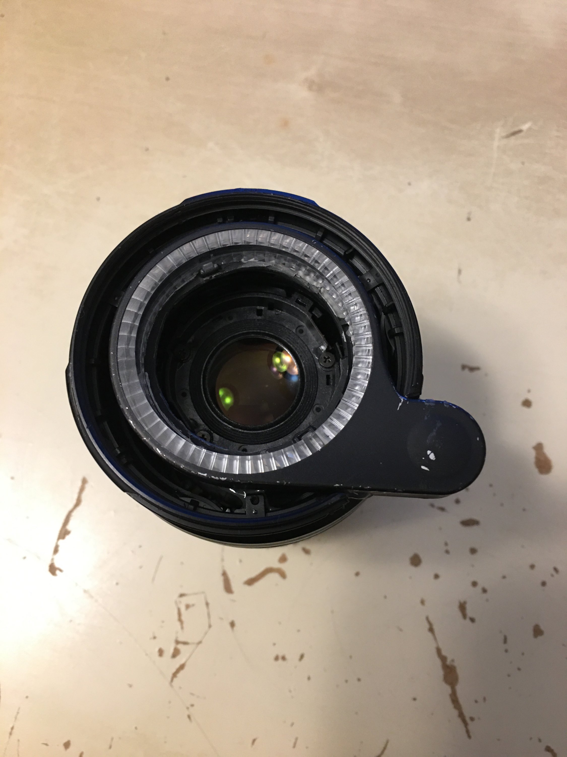

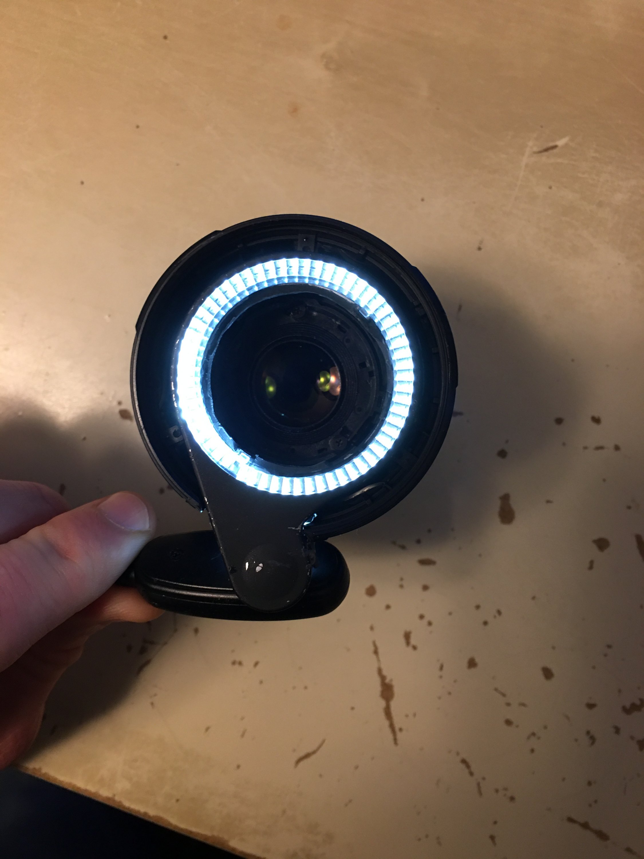

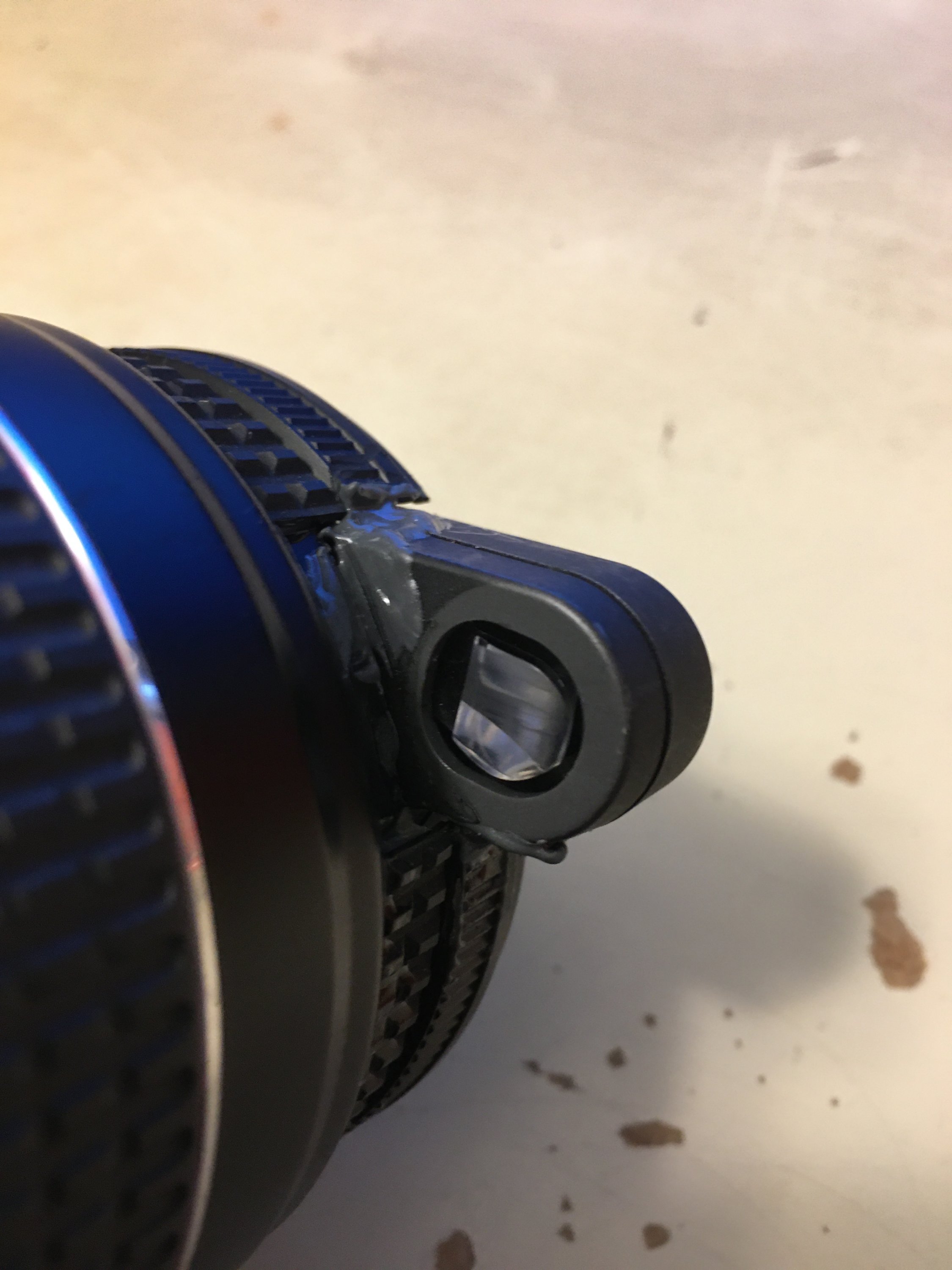

Here are pictures of a Canon 28-80mm zoom with a bad focus motor. It came attached to an EOS Rebel body I found for $15 in a junk shop, I mean, an antique mall. I’ve converted it to a close-up lens, which gives magnification of roughly 1-2x on my EOS 1Ds Mk II. I’ve removed the front element group and cut the body of the lens down a bit to get a little more working distance. The aperture mechanism still works! Also, because the working distance is so short, I fitted it with a ringlight accessory from some random video camera. Waiting for a box of LED key-fob flashlights to arrive so I can attach a more permanent light source.
I love epoxy and my Dremel tool. It’s not the prettiest thing I’ve made, but it works!

Didn't know this camera; what a beauty!

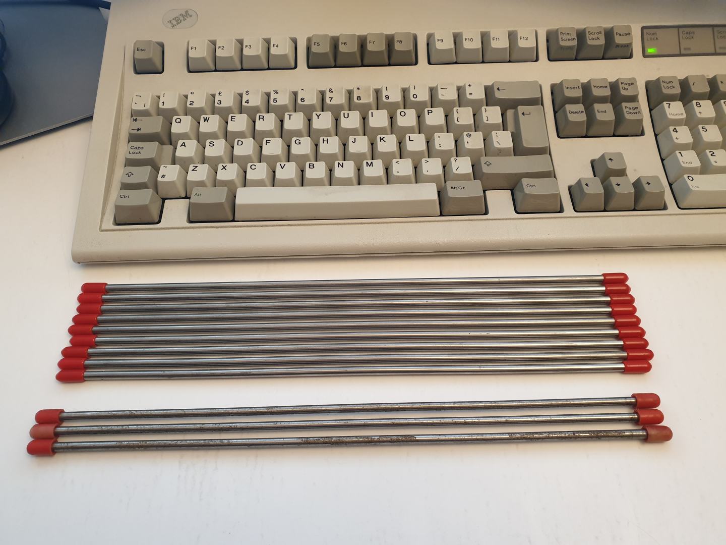

I have an old Marrutt drying cabinet. It only had 3 hanger rods which were beginning to corrode.
I purchased some 5mm 316 stainless steel rod, an upgrade on the original 3/16 304 rod. I was able to create a full set of 9 rods from a piece of 3 metre stock.
Bolt cutters made quick work of cutting the pieces, and the replacement vinyl caps saved me from having to file the ends of each rod.
I'd like to remove some of the rust from the cabinet and repaint it eventually. The final bit of work will be to replace the thermostat with a PID controller.
Ashamedly, the cabinet has seen more use as a room heater, but when when I am drying film/prints it's a great piece of equipment to have.
