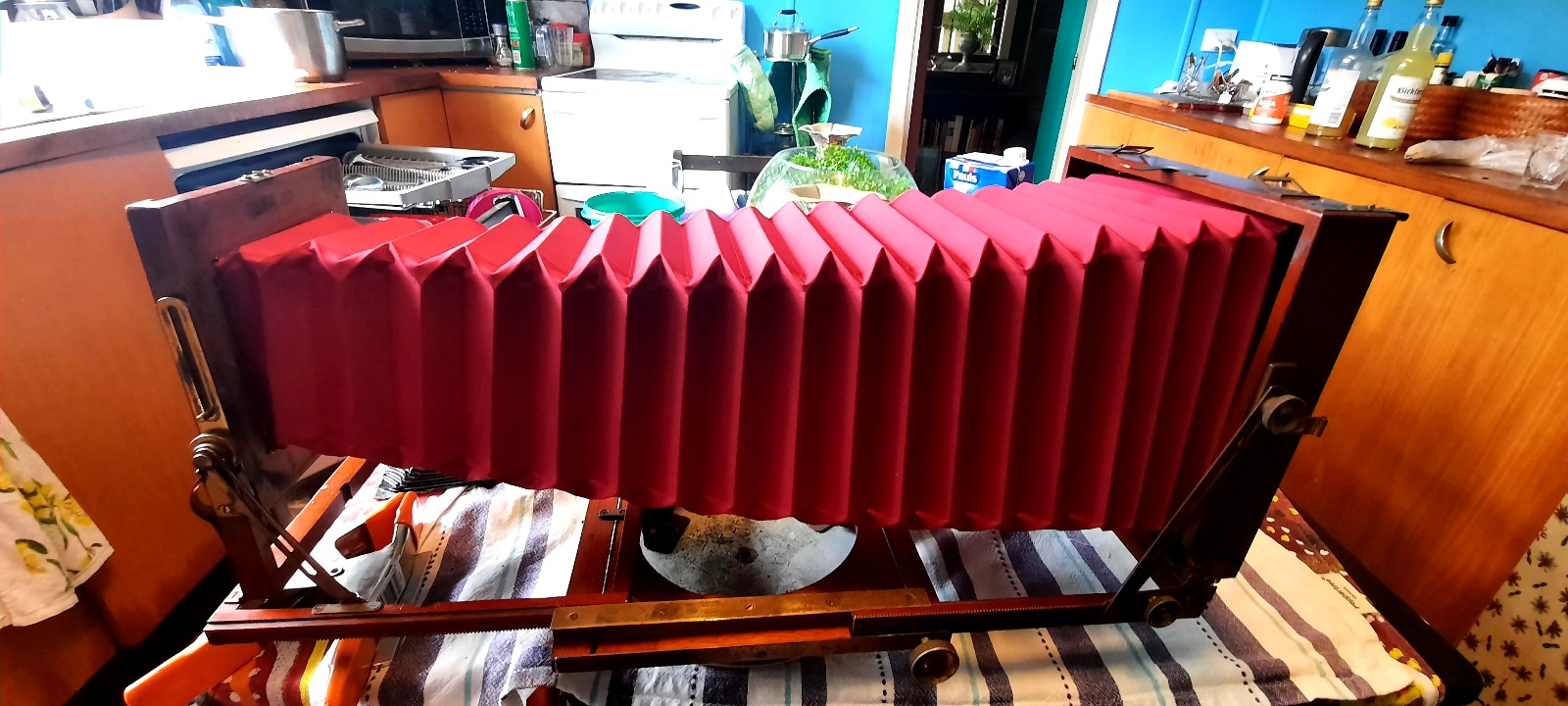

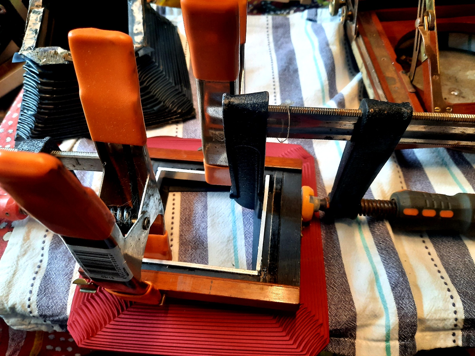

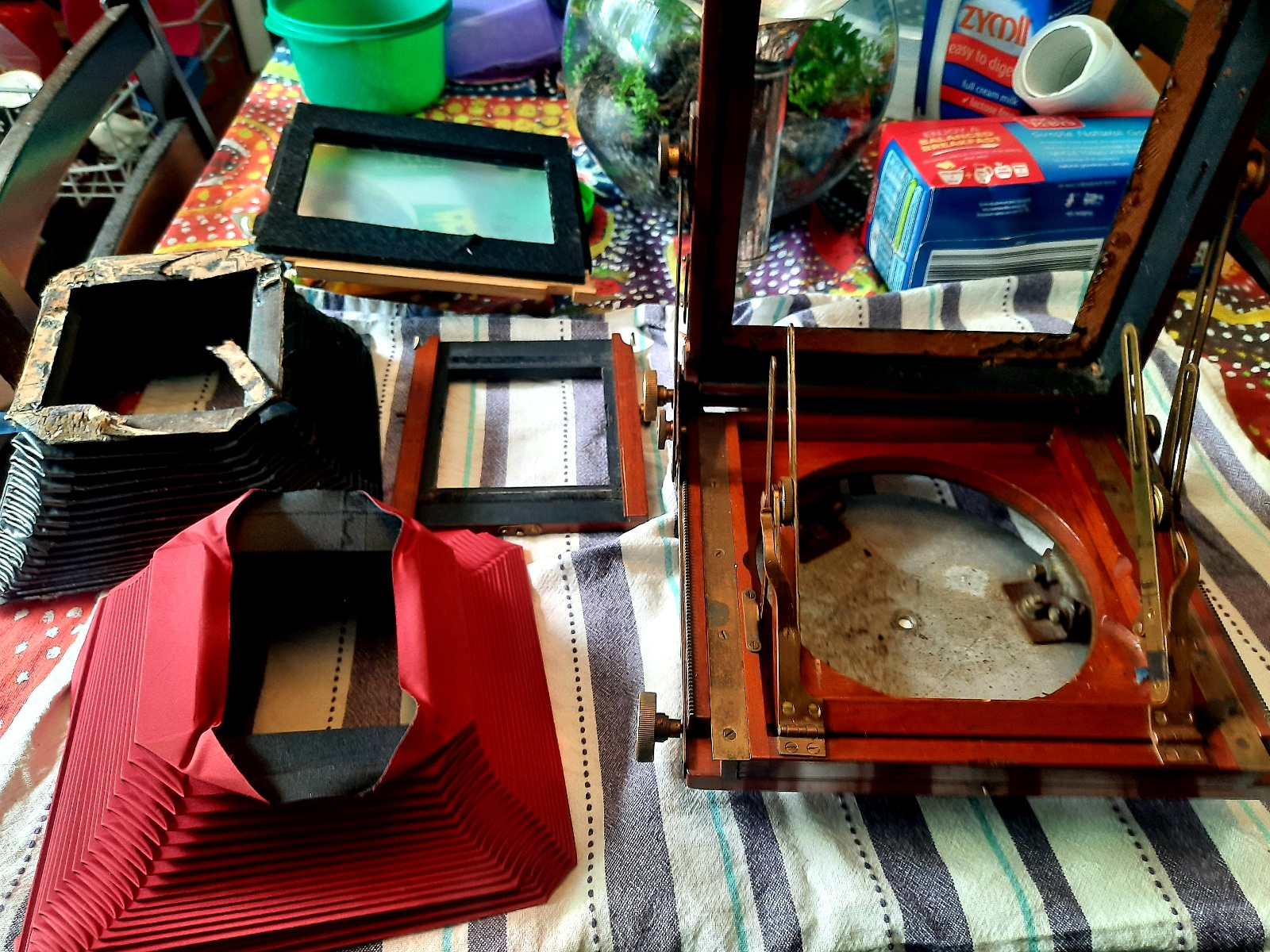

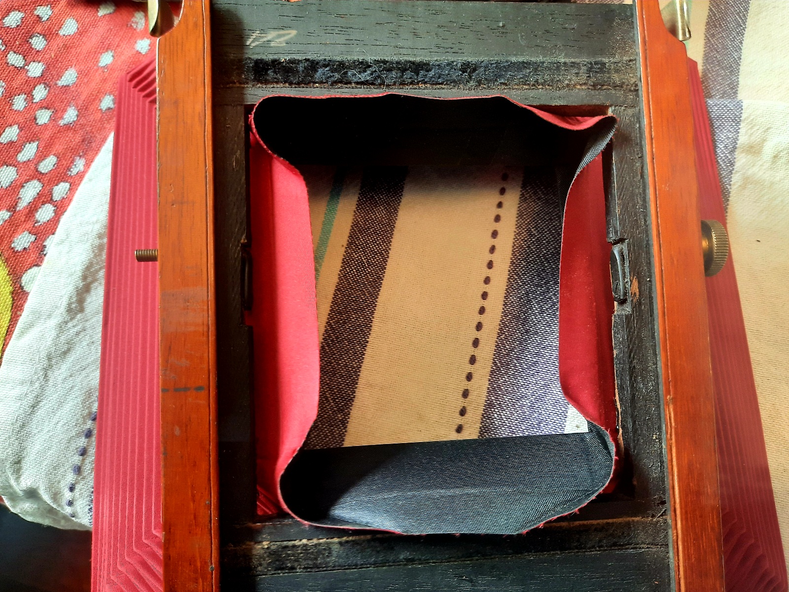

Replaced the ballows on my Superbe Victo triple, in sexy red. Ballsed it up bit, is a bit skewed, should of worked from the centre and not what I thought was the corners. ......gues my pictures will be out of kilter.

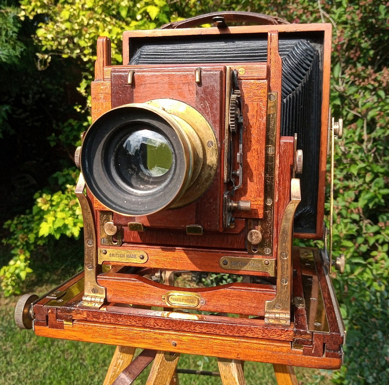

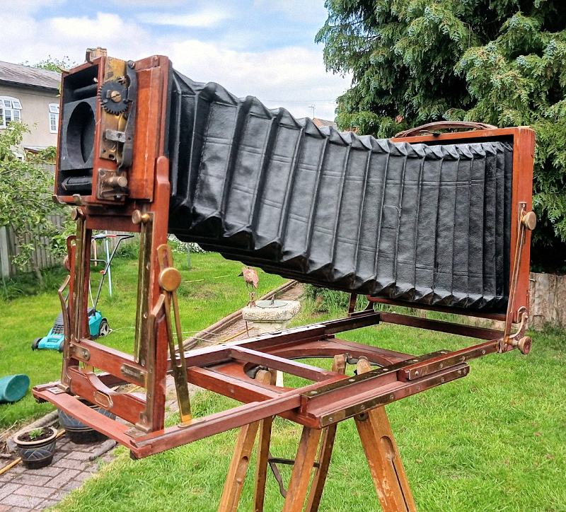

Had to restore the bellows and also the front cross member that the front standard is attached/hinged to. The shutter needs a new crtain and cord as awell as a speed dial. The lens is on a panel from my two shuttered TP Triple Imperial. I have plenty of lens options for this one.
Seems to be a plastic iused for a previous repair. It's a Houghton Triple Victo Half Plate camera, joins my Whole plate Victo and Houghton 1/4 plate King, and Half Plate Houghton Duchess :D
