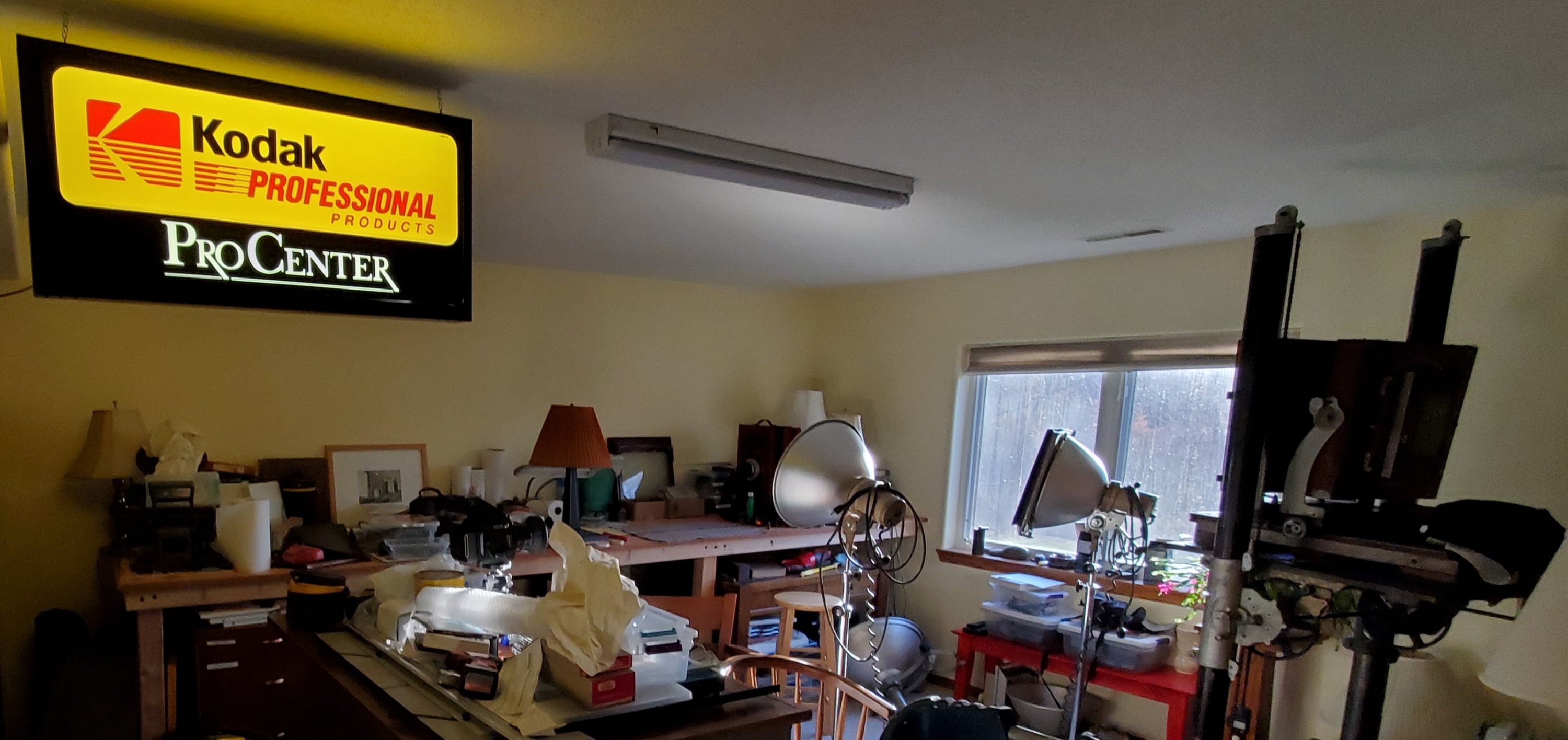

Found this at Camera Corner in Davenport Iowa. Needed one of the two ancient ballasts replaced, nearly impossible to find, along with rare 33 inch tubes, new starters. Thank goodness I took electronics in 9th grade!
We had so much Kodak branded stuff in our house when I was growing up, I couldn't figure out what "this" you were referring to when I looked at your photo.:D
Everything looked normal to me.
No, just cover them with blackout curtains.
Good idea! I built this room as a print finishing area, I since then have acquired the ginormous Deardorff. I'm going to remove 8 feet of the countertop to make room for a backdrop. I have some nice Zeiss Hasselblad lenses I want to use for portraits. :smile:

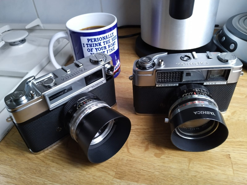

Serviced these two Yashicas over the weekend;
The Minister-D had a stuck shutter, too much oil and dirt built up on the shutter blades.
The Lynx-1000 needed a deep clean as foam from the deteriorated seals under the top had started to infest everything.

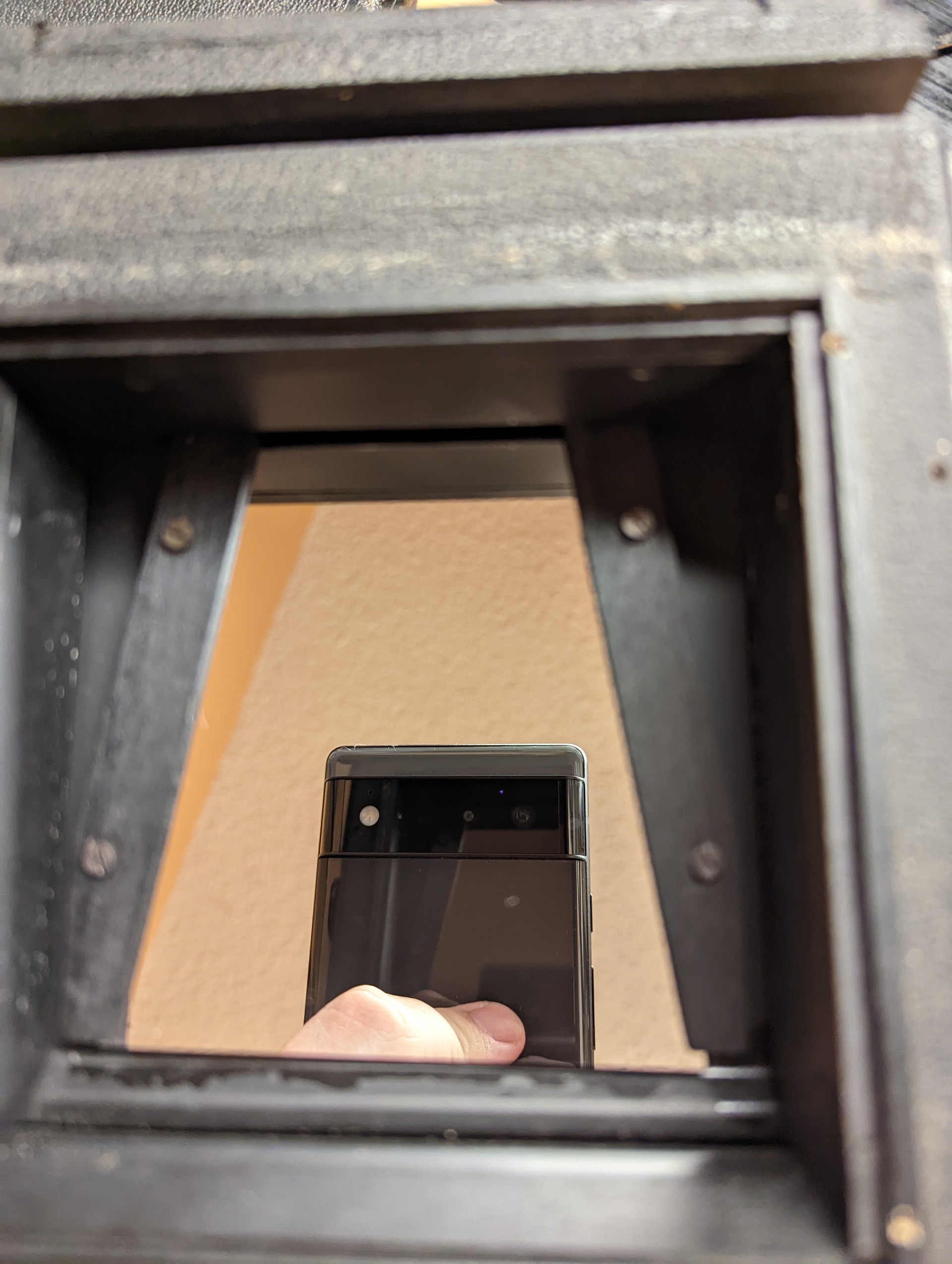

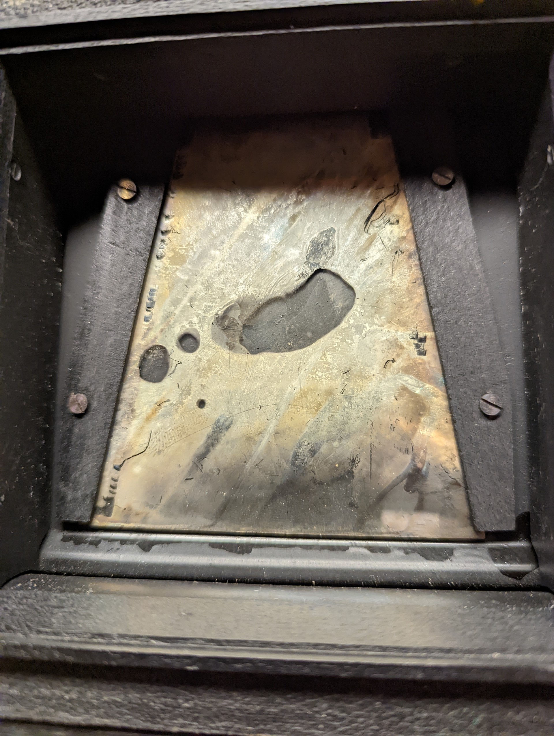

Replaced the mirror in an ICA Reflex quarter-plate camera.
Went from this:
To this:
What's astonishing is that the old mirror actually produced a workable (but very dim) image on the ground glass. So far, I've cleaned the ground glass, the lens (was filthy, but cleaned up nicely), and replaced the mirror. All that's left is to replace the shutter curtain, and I can start taking photos ("all", he says.... *sigh*).
Speaking of mirrors, there's a user on eBay named "marty1107" who cuts mirrors to order, has a very quick turnaround, and his prices are reasonable. Search for "replacement TLR mirror".

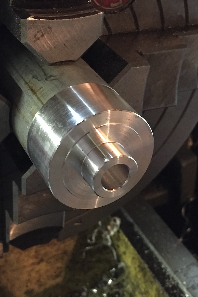

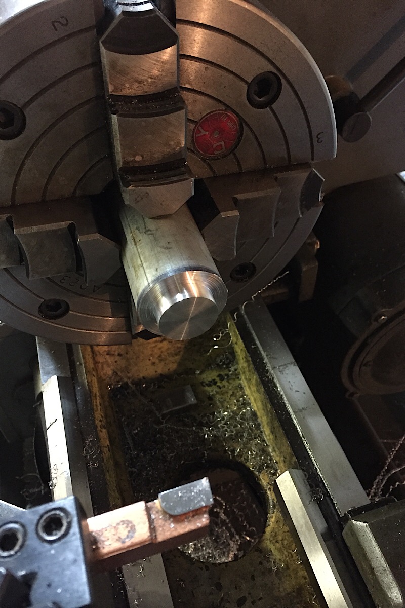

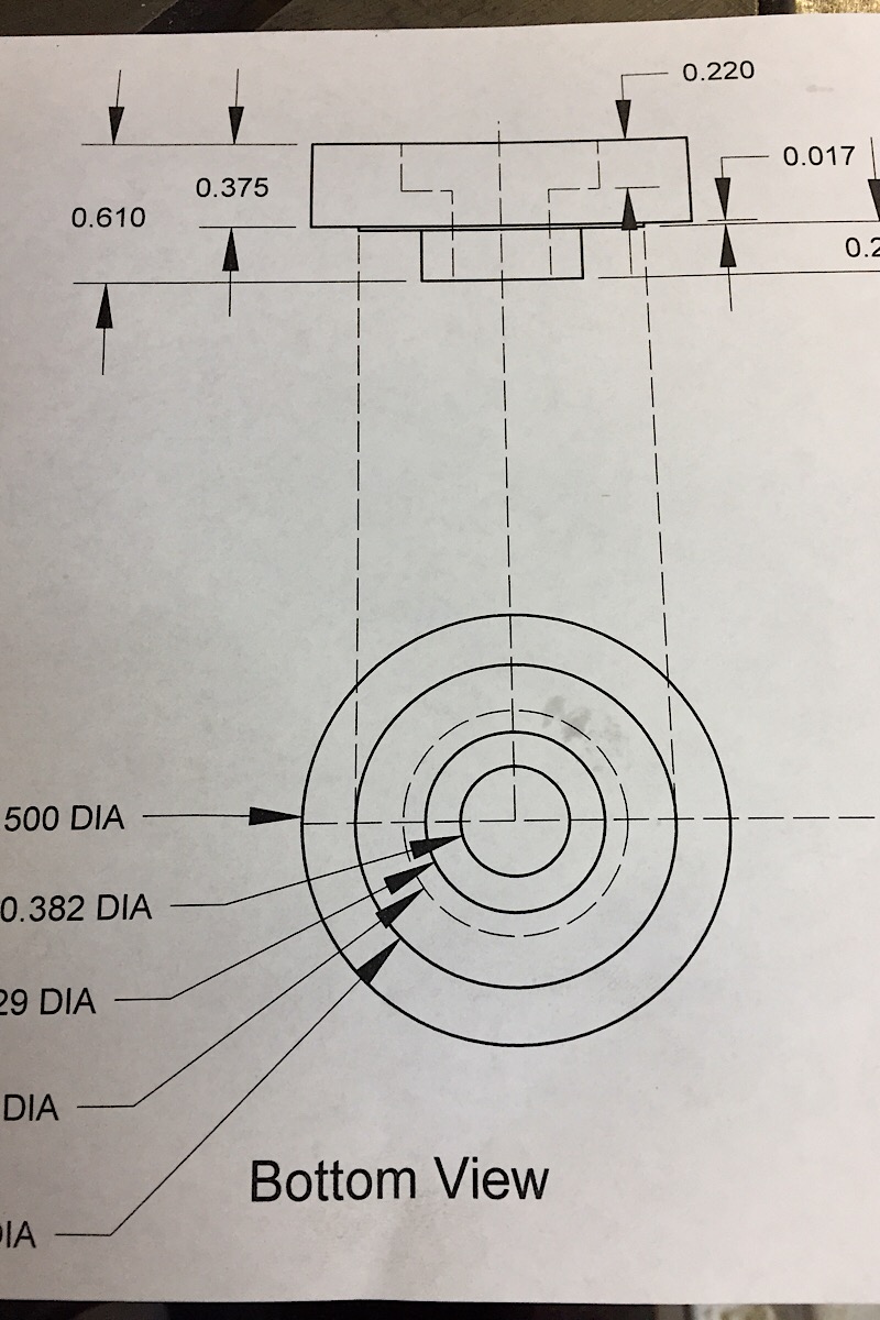

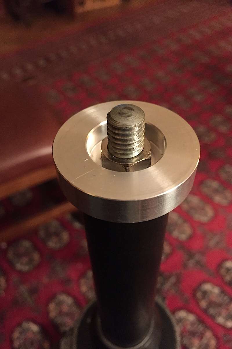

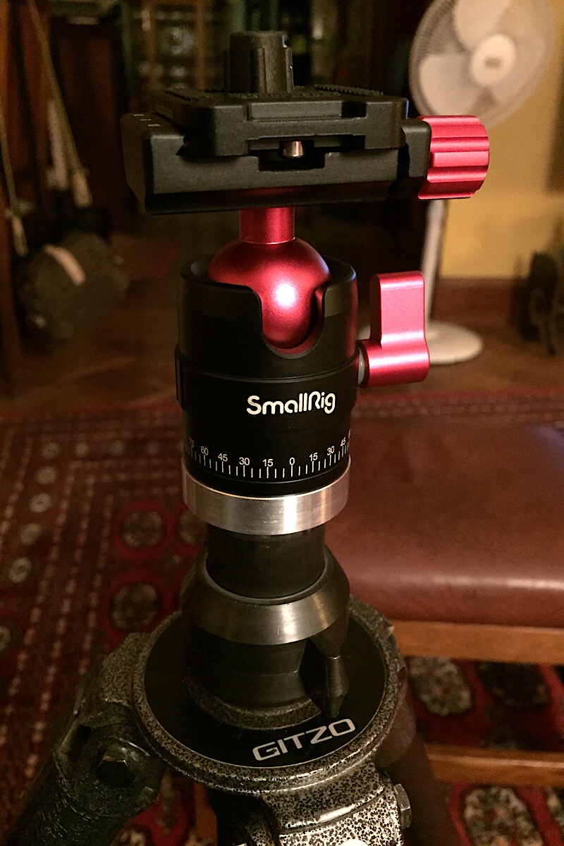

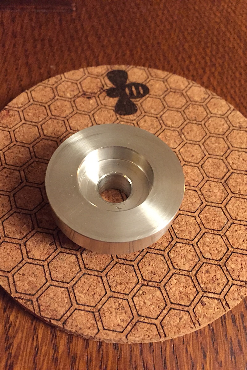

Not so much a fix more of a modification. Wanted to mount a small ball head on my old Gitzo tripod. The problem though is that the old mounting plate on the center column was way to big making it hard to turn the little pan lock knob. So I made a smaller mounting plate.
I slowly getting up to speed with my lathe, lol, I should be an expert considering how many YouTube videos I’ve watched.

Nice job!
