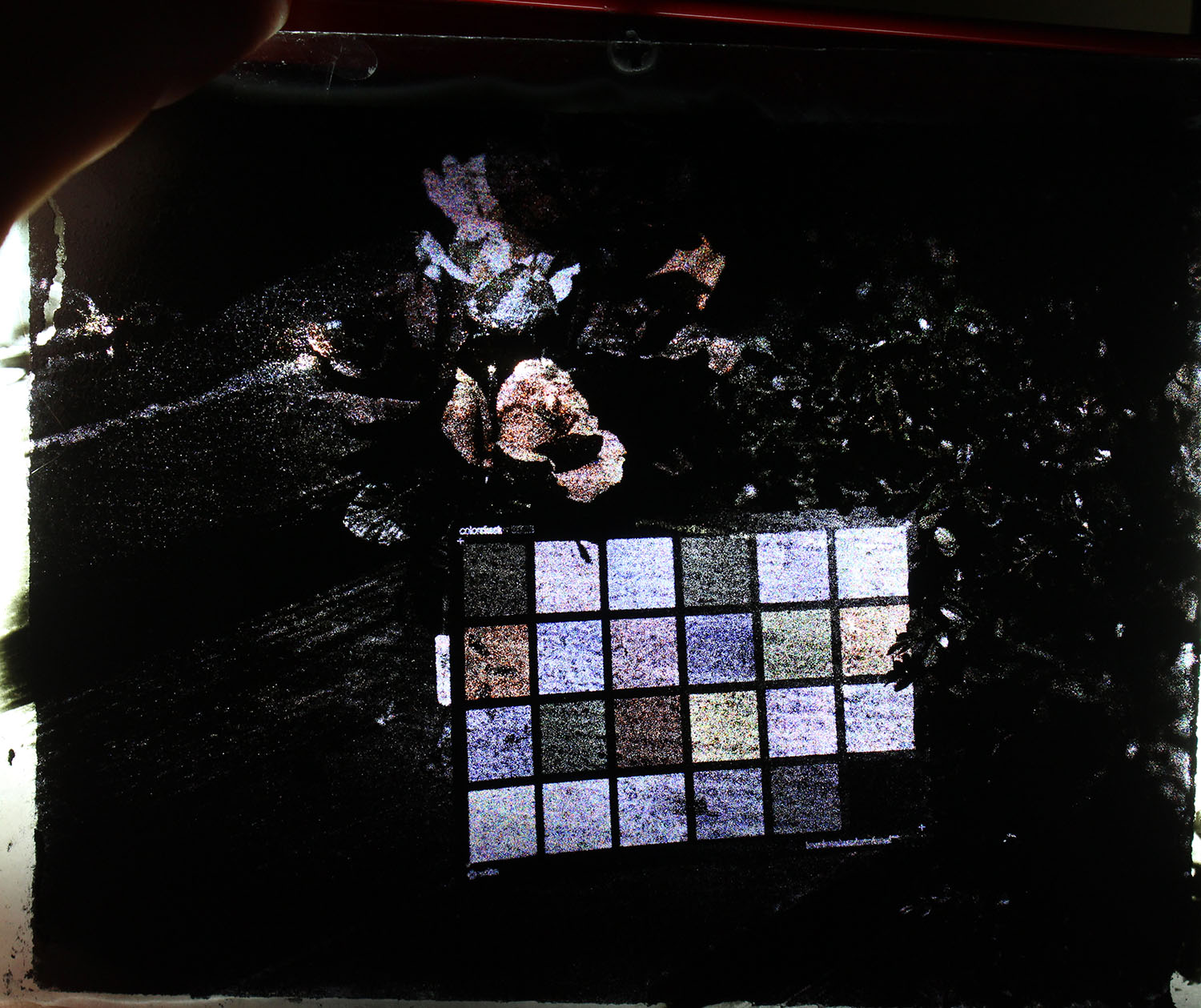

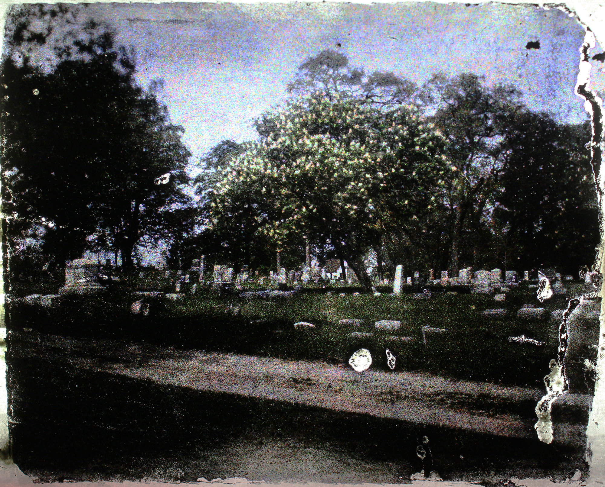

Alright, here's the best success of the day. It's not the best ever, but I'm still getting colors consistently so I call it a win.
This emulsion was made the same way as the previous ones, only this time I added:
2mL 1:1000 erythrosine before precipitation
4mL 1:1000 pinacyanol before coating
I added the typical 200mL of water before coating, to dilute and allow for thin, even coatings. 6mL of the solution applied to each 4x5 plate.
As you can see, the colors here are very weak compared to some of my previous shots. It was an overcast day, ~EV11, exposed for 20 seconds. IIRC another stop would have increased the saturation a bit (and another plate shot at 10s seems to back this up, as the colors were even less distinct). I think the emulsion was a bit too dilute this time, as the shadows were fairly weak. I'll coat four more plates tonight with 8mL of emulsion each and see how that performs. As you can see from the exposed screen, this is an older one and hardly neutral in tone -- so I won't be basing any dye concentration adjustment decisions off of this.
The corners of the plate got contaminated with something while drying I think (causing fog, which was ultimately bleached away). The other 3 did not have any huge spots or anything of the sort. I know my fan fell over on these guys sometime last night, so it could have been from that.

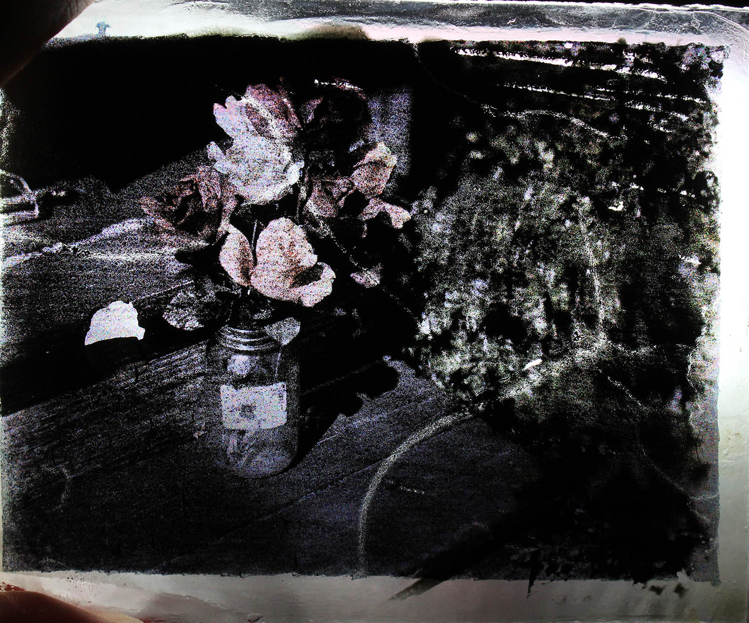

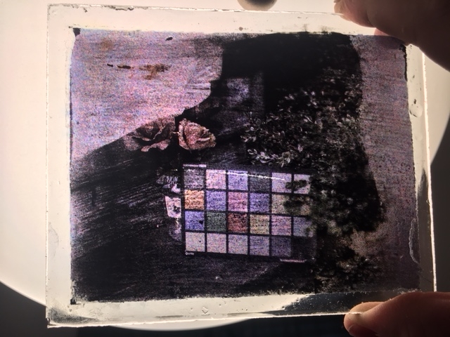

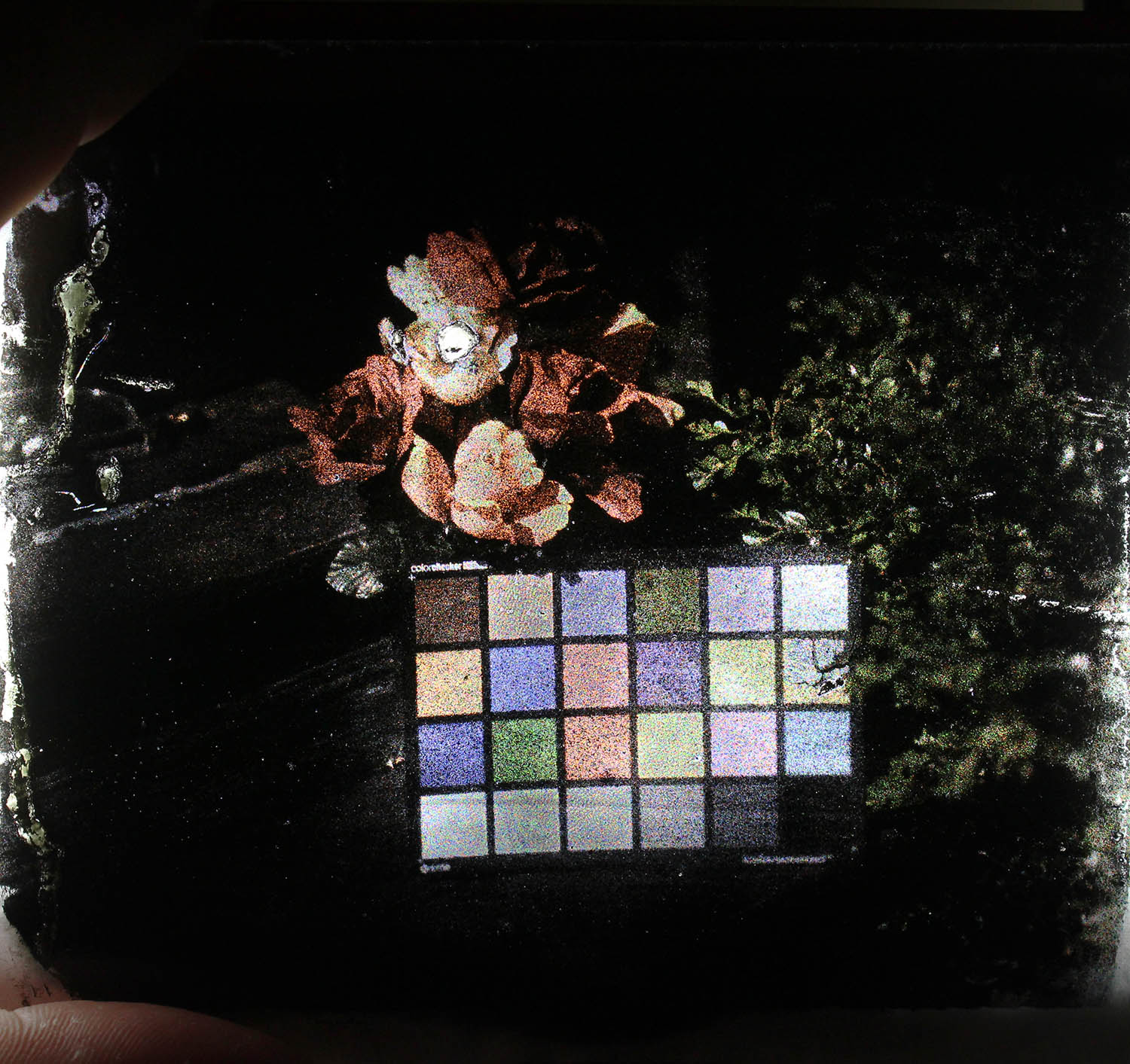

Today I was able to try out an orange filter, which seemed to fix things. The colors were getting washed out due to the blue sensitivity being too high. The orange filter seems to have balanced things out nicely for an exposure in the sun. I think both the dyes here are probably nearing their upper limit, so the filter may be a necessity from here on out.
The last plate I coated I exposed 6 seconds without the macbeth chart. I think it would've made a nice picture, but unfortunately it was a few stops underexposed. I'm a little puzzled why it came out the way it did, since I had coated them all at the same time, developed them all within 1 hour, etc....

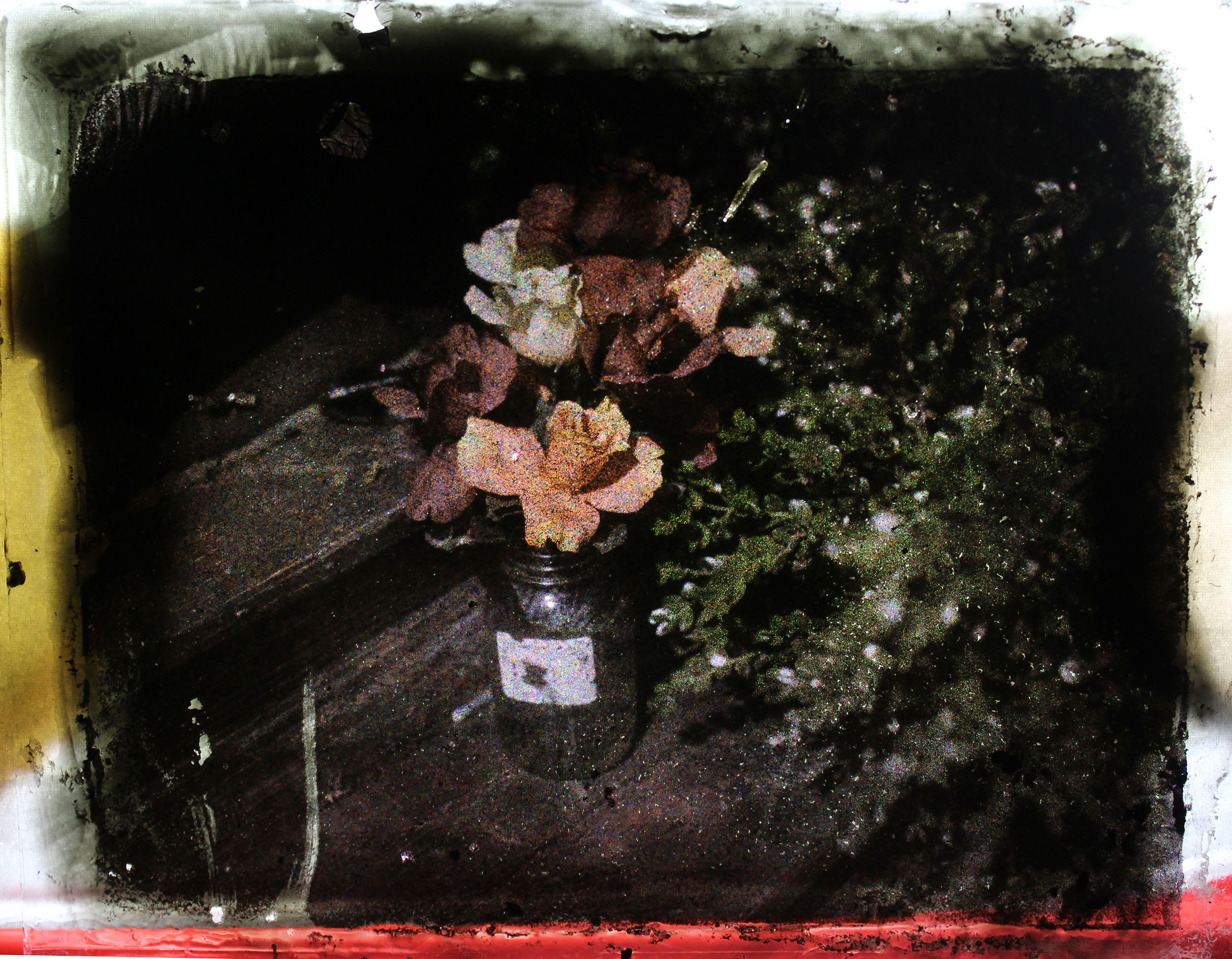

Today's plate, made on the same screen plate as the "5s_orangefilter" picture from my previous post. 9mL of emulsion. The image is a bit dark and contrasty, but longer exposures just result in washed out colors. I think I'm going to coat some plates with 6mL emulsion again, and see how they look with the new filter.

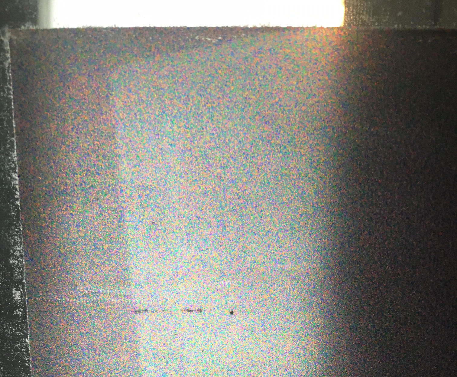

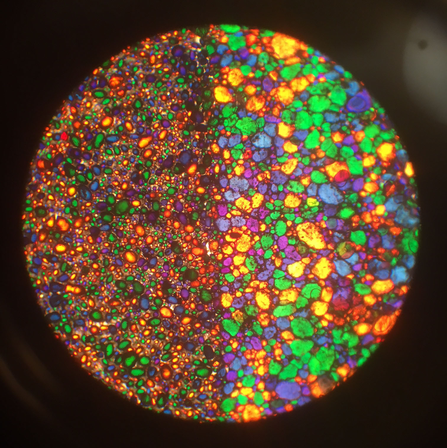

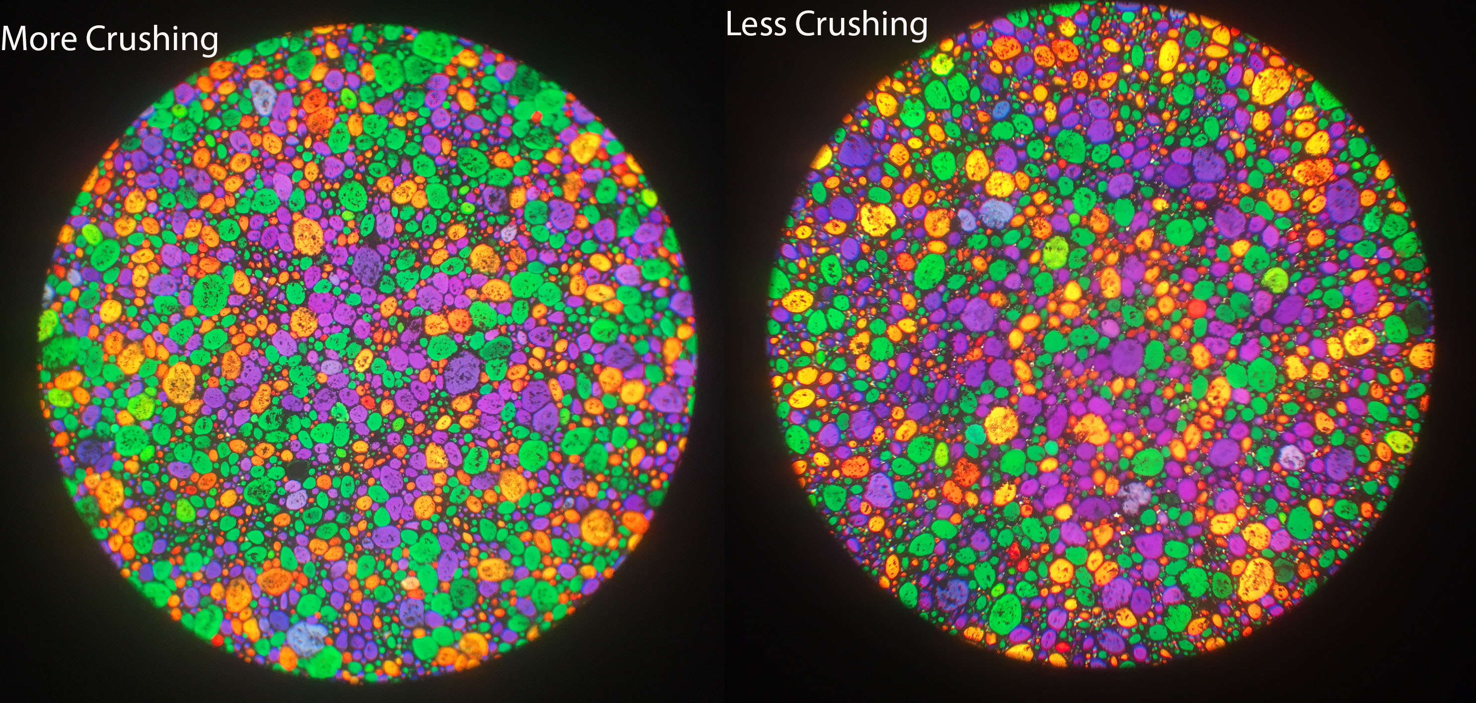

Currently I've managed to modify my CNC router with an attachment that has a small 1/4" threaded bolt as an axle, with a small roller this kit. It provides two points of contact against the starch, both are just about 0.5mm wide. Right now my rolling program rolls back and fourth across the starch 14 times before picking up and moving over 0.5mm to the right, and repeating the process until it reaches the end of the plate. This takes about 45 minutes to complete. IMG_2751 shows a neat little comparison between the pressed and unpressed starch grains. Here's a video of the router in action.
In IMG_2753, you can see the difference in transmitted light between one 45 minute pressing, and a second 45 minute pressing (the plate shifted near the end of the second pressing, giving us a neat little comparison). You can see the differences through the microscope in IMG_2754. It's hard to see, but the grains are a bit more rounded with only one pressing, and there seems to be a bit more interstitial spaces between them. I think, to get things to a satisfactory level, this second pressing may be necessary.
One observation that pops into my head while I'm writing this, is that there doesn't seem to be a whole lot of graphite in between the unpressed starch grains. I'm wondering if I might be a bit too aggressive when I'm brushing it off with the talc. It may be, with such large grains, that the graphite / talc steps are wholly unnecessary.
I tried filing down one of the edges of the little roller wheel, so that there was only one point of contact against the plate. In theory, this would double the pressure applied, since we're halving the surface area. Right now I can't apply any more force, since it causes the z axis belt to skip on the router. This didn't end well, since the roller now "leaned" so that a corner of the edge was in contact with the plate, dropping the contact width to something closer to 0.2mm (IMG_2750). I modified the program to perform smaller "hops", but I think the sharper edge of the contact area tended to destroy parts of the plate. The compressing was good in the areas that survived, though.
If someone can recommend a better roller, with the point of contact being closer to the middle of the bearing, I'd love to hear it. I'm sure something like that exists for a few niche applications somewhere, but I haven't been able to find anything quite yet.
Nice to see you posting again! I've been following your research with delight and absolute admiration for your tenacity. My research ground to a halt when I decided I needed to do the work in a separate space from my house/studio. I still haven't gotten it built :cry:.
I had the same thought/hope about eliminating the carbon black. Alas, I found that it seems indeed necessary. You are way beyond where I got, but if it's at all of help or interest, my last results are on this page, second and fourth entries: http://thelightfarm.com/cgi-bin/htmlgennew.py?content=Journal2
Best, d
