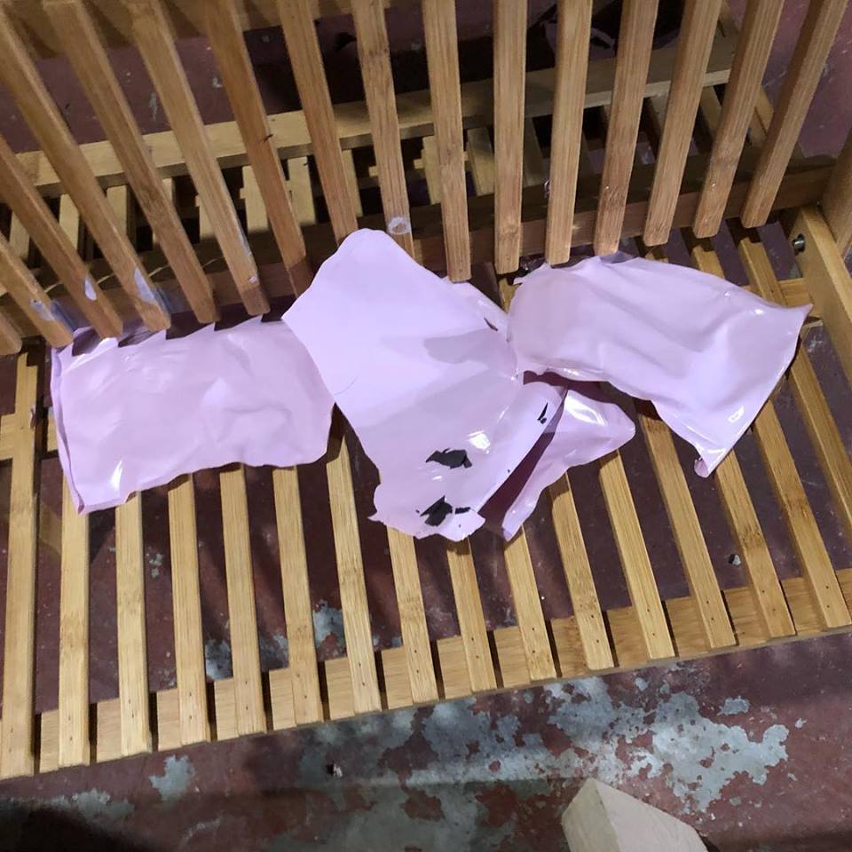

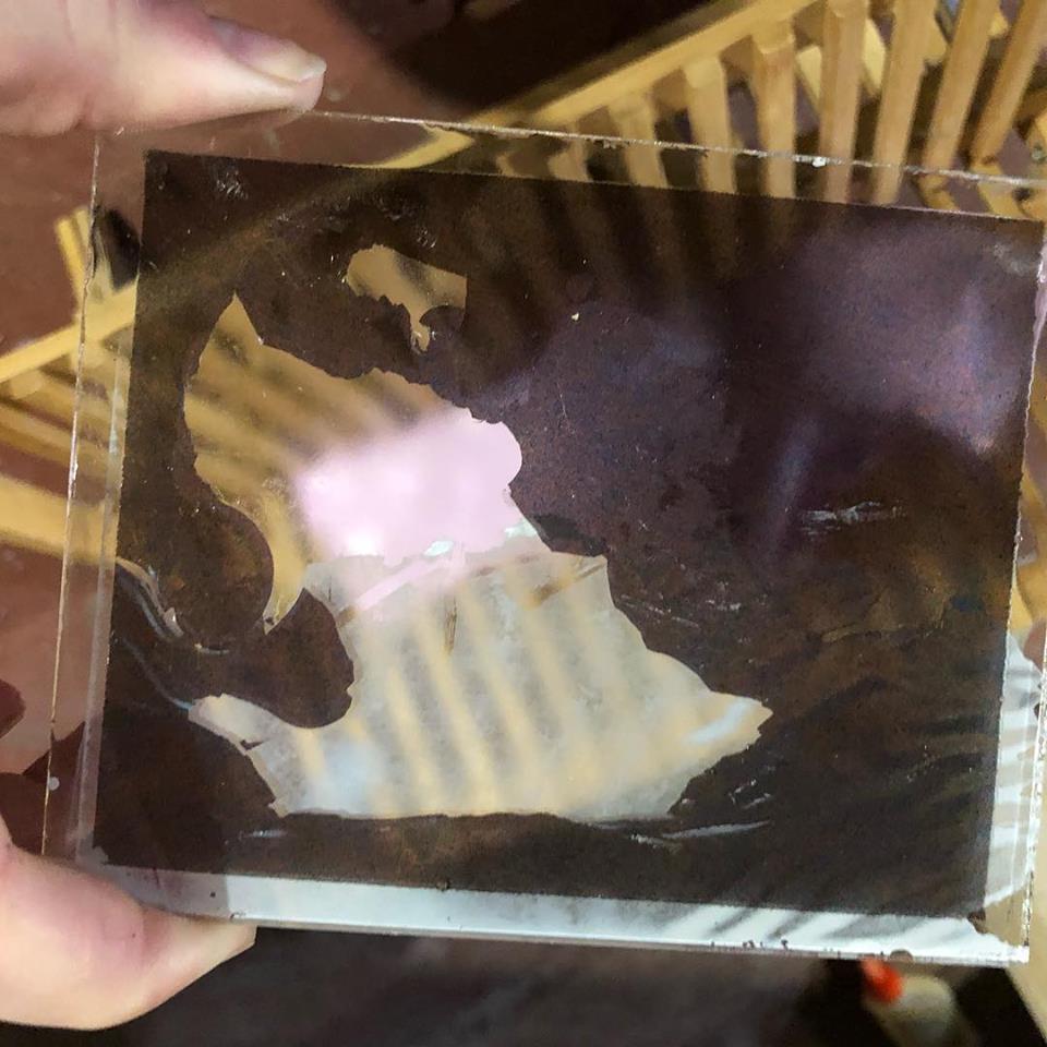

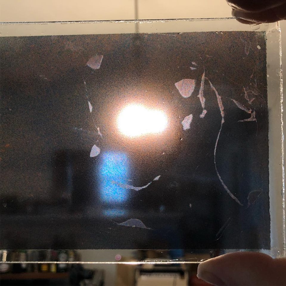

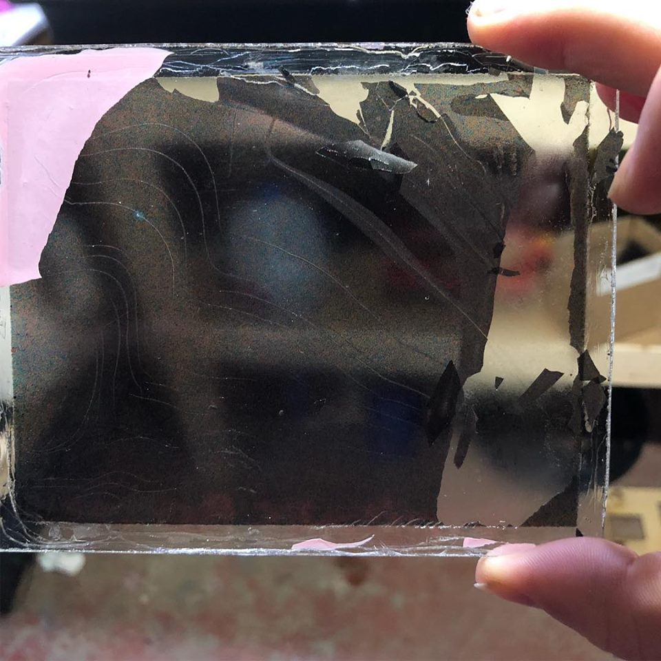

I coated some screens with fresh emulsion last night, and woke up to... this! I'm not totally sure what to make of what happened exactly... 4 out of 6 plates, the emulsion flaked off as it dried. All of them seemingly had leaks into the starch, causing the dyes to bleed. I had noticed that several screens had developed some sort of "star" or "asterisk" like patterns, which I think may be the rubber layer lifting off the glass. However, I examined all my screens very closely before coating last night, and they looked nothing at all as poorly as they looked after the emulsion dried. I'm a little puzzled as to exactly what went wrong, but short of me accidentally dumping sulfuric acid in the emulsion or something, my working theory is that my second varnishes become brittle over some months and cracked.
Unfortunately, this means I've more or less trashed all the screens I made last year, so it's quite the setback. I still have a few plates that were starched and pressed, but never had a second varnish applied, so luckily I can test out different varnishes on them. I'd definitely be interested in hearing any recommendations on other second varnishes to try. So long as they dry clear and are not aqueous, they might be a good candidate.
I had success with an acrylic based driveway sealer - it dries hard and is water tight. However, it seems the gelatin doesn't like to stick to it, and flakes off as it dries. Does anyone have experience with using photographic emulsion on acrylic at all? Perhaps it could be subbed, or possibly dissolving damar gum may allow it to stick better? I guess tomorrow I'll make a control group and see if my emulsion is having trouble sticking to glass, too...
EDIT:
I also have to wonder, if I try out subbing (which I've never had to do before), would it hold up during the reversal bleach? Hmm...
EDIT 2:
This thread regarding liquid light seems to indicate that a particular solvent based acrylic varnish from Golden seems to allow for good adhesion.

Ouch, that was a bad loss with some seriously good looking screen coatings. Sorry to see that problem. It looks like it is multifold though. One is adhesion to the glass of all of the layers, and another is that the layers seem to repel. A third appears to be that the layers dry to different (or at different) rates. This latter assumes that some of the solvent of the wet layer wets the layer beneath.
PE
Emulsion doesn’t stick to acrylic at all, but you will have better luck coating onto polyurethane. Dip the plates in a thinned polyurethane solution (thin 50/50 with mineral spirits). Allow to set up a minimum of two days before coating.
Polyurethane will yellow with time, though I don’t know how apparent the yellowing in such a thin layer will be. Alternatively, blonde shellac may work but I haven’t tested that.
PE
Thanks for the kind sentiments. I found an old post of yours that may explain the problem with the emulsion adhesion. I have in my notes to add 0.4g of KBr to the emulsion as one of the finals. It occurred to me last night that typically I would skip this, since I never really got to test it out. In my recent attempt, I did not. I'm thinking I might re-run that recipe without the KBr in the finals and see if things look a little better.

I'm not sure about the polyurethane. I did make 4 screens with it last August (IIRC with your recommended 1:1 dilution). It coated very well, much less picky than the nitrocellulose stuff (it wasn't super weird about temperature, condensation, etc), and the gelatin adhered with no problems. I think one or two of them did yellow a bit, but I can't be certain. I didn't keep them labeled, so after this disastrous coating I can't really tell if they performed better or not. There were two that only had leaks into the edges, and not all the cracking/lifting -- maybe it was those? I think it's worth a second shot, with better notes this time!
Cool. Btw there will already be some amount of KBr in your emulsion after the washing phase (you always want some small amount to avoid having a surplus of silver ions). ..the added KBr just ensures a minimum amount and acts as an anti-foggant... it also reduces the emulsion speed some, so leaving it out you may get some additional speed but at the expense of increased base fog.
Ah, gotcha. I always figured that was the mechanism, but never actually looked into it. I've always had a habit of reacting with KBr in excess during precipitation since my Lippmann days.
I'd never actually looked into the mechanics of varnishes/lacquers/whatnot before, since the Lumiere formula was temporarily getting me by. So, for those like me who don't really have much knowledge of such, here's what I found out this week.
The difference between varnish and lacquer
: After the solvent evaporates, a varnish needs additional time to polymerize. A lacquer just has a bunch of junk dissolved in a solvent that sets up when the solvent dries, and can be redissolved and whatnot. Despite the term "Second Varnish", in this context the Lumiere varnish is actually a cellulose lacquer. Once the ethyl acetate (and in my case, amyl acetate) evaporates, the coating is good to go.
Polyurethane: I'm really warming up to this as a coating. I had always assumed that it had been around forever, and that if the Lumieres didn't choose it they probably had good reason. It turns out that it wasn't even created until 1937, and not in common use until much later. I've coated about 12 new screens with a few different variables. Most of them are still tacky even after sitting at room temperature for a few days, which is what prompted me to do this research. Due to the thicker coatings on some (1 tbsp / 20sqin, undiluted), it will likely be weeks until the coating is cured and ready to go on most of these. Just today I picked up some "Japan Drier", which has metal salts that will accelerate the rate of curing. I just coated plates with the polyurethane + Japan drier, so we'll have to see how that goes.
Pros: I know the emulsion will stick to it. I've tried it, and it's been proven to be water tight. Easy to coat, and does not cause the first varnish to wrinkle or lift from the glass
Cons: Will yellow when exposed to UV (though to be fair, UV will destroy the autochrome dyes too). Long cure time.
Acrylic Varnish:
As mentioned earlier, my first attempt ended with the gelatin just flaking right off. I picked up a solvent based varnish from Golden, based on this super old forum post indicating that Liquid Light will stick to it. I've coated it on one screen that I messed up, so we'll see if my emulsion works or not. I think I still will try to mix in some damar resin I have in with the first acrylic driveway sealer just to see what happens, because it did make a really nice coating.
Mystery Varnish: I have no idea what type of varnish this is, but it was cheap. Slightly yellow after coating. Still tacky after a few days. We'll see what happens from here...
Alkyd Lacquer: Since this is not a varnish, this should dry quicker. I was worried that, because of the presence of alcohols, the dyes would bleed -- however, no dyes bled when I put a drop on a bare screen. I'll coat a plain glass plate to see if the gelatin sticks.
Epoxy:
I think if epoxy is thinned properly, it could provide a good coating. I mixed up some with some terribly old epoxy I had laying around, and was successfully able to thin it with 1mL acetone / 10mL epoxy. It's still sticky to touch one day later, but that may just be because it's super old.
Polyester Resin: I figured I'd try this out, since the Photographic Emulsion wiki page mentioned that some polyesters were traditionally used as a substrate. I picked up some that is typically used for casting. I'm a little worried about how much it shrinks while it cures, but we'll see... And I can make Lippmann prisms with the leftover if it doesn't pan out.

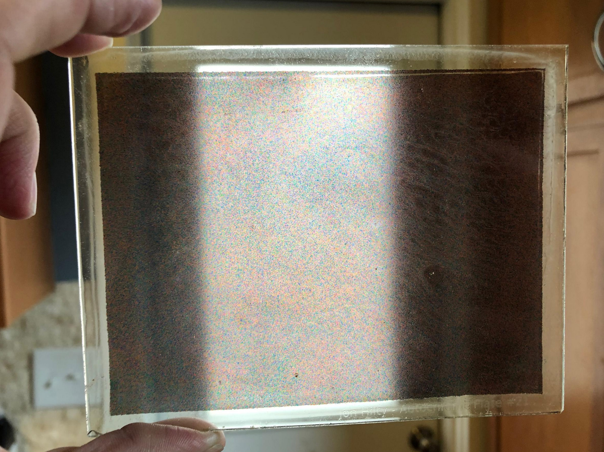

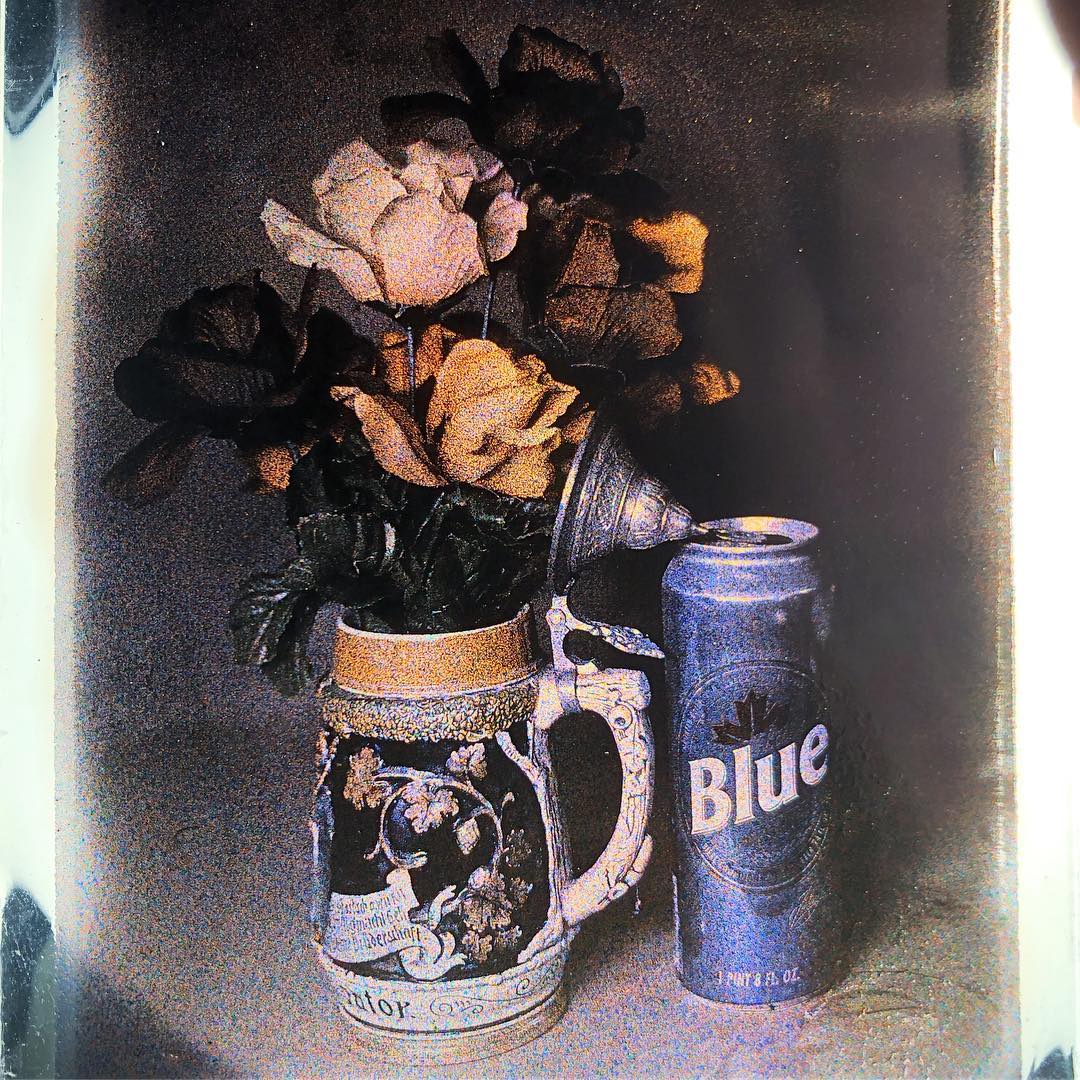

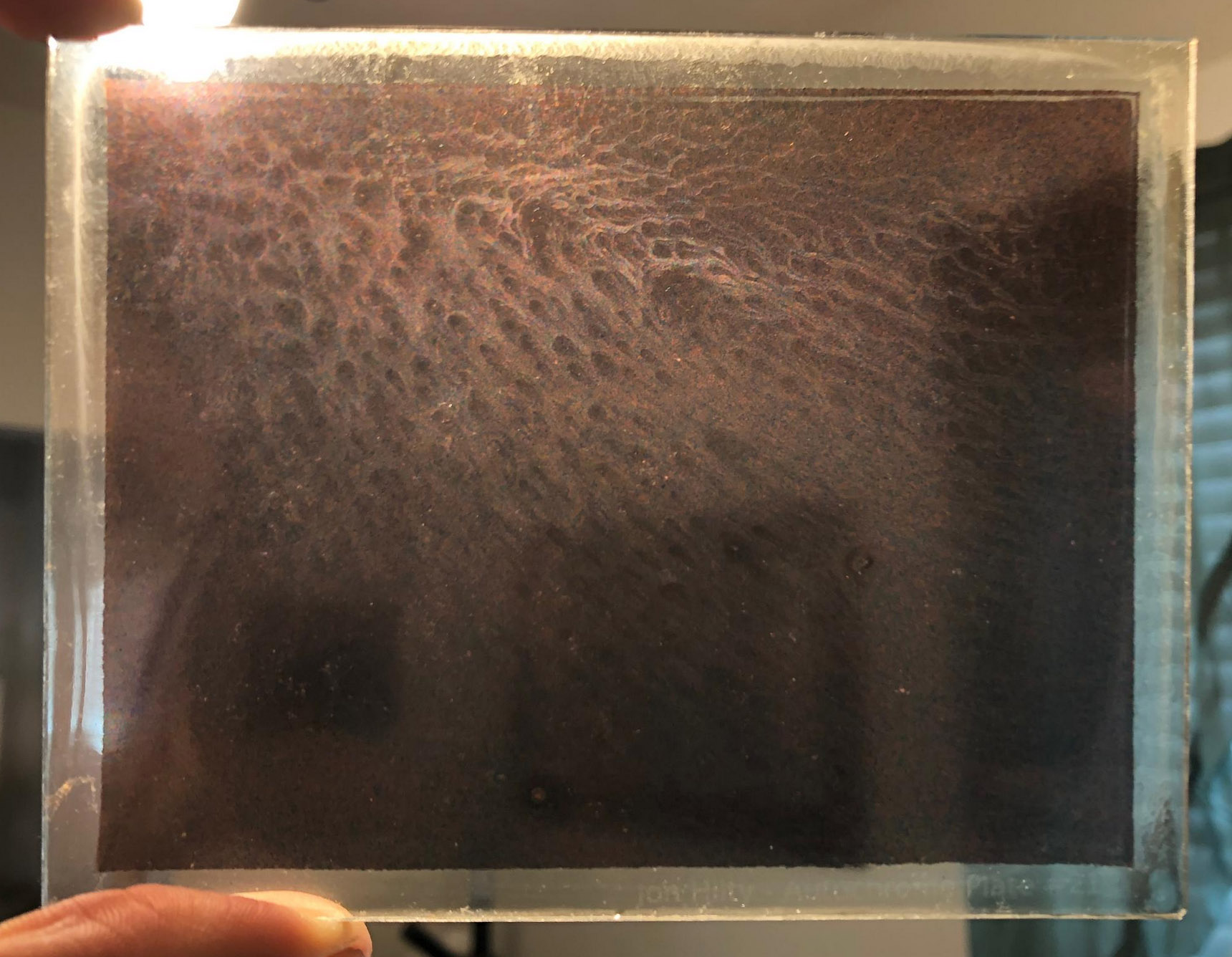

Here's a success I had last night. It's fairly dark and a little contrasty, so it pretty much has to be viewed with the plate directly against a light to make it out clearly. I was having some issues with yellow staining completely ruining the image during second dev. I think I was rushing the clearing/washing steps though, so I timed how long it takes to completely bleach the plate, and gave equal time to clearing and washing before second dev.
Here's an issue that I'm running into now. It takes a REALLY long time to bleach/clear/wash - about 50 minutes each! With my plates from Dec. 2017, I remember being able to visibly see the silver dissolving away over a few minutes. I've noticed that the same recipe, when used for normal glass negatives, has the same problem with fixing too -- it could take about an hour to completely fix the plate! Talking to Nodda Duma, one suggestion was to up the gelatin content, since mine was quite low (~2.8% gelatin). My gelatin is quite old too, so I've ordered some newer stuff too see if that's the issue.
As a small followup to my last post -- diluting polyurethane 1:1 with naptha seems to perform fairly well as a second varnish, but takes about 3 weeks to cure still. Undiluted polyurethane will take months to cure, so I have about 15 screens I won't be able to use until late summer, realistically. I tried about 8 other coatings with varying degrees of success, but I'm still working out some kinks, so I'll save my thoughts on them for a later time.

Too true! It's "VM&P Naptha" made by Klean-Strip. I tried diluting with odorless mineral spirits, however that created thousands of tiny bubbles that were trapped in the polyurethane, which causes some light scattering. It doesn't affect it much while I'm testing, but I'll be sticking with the naptha from now on.
Here's one of the plates with polyurethane diluted with odorless mineral spirits.
