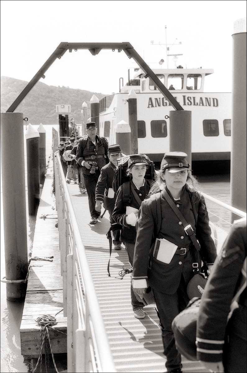

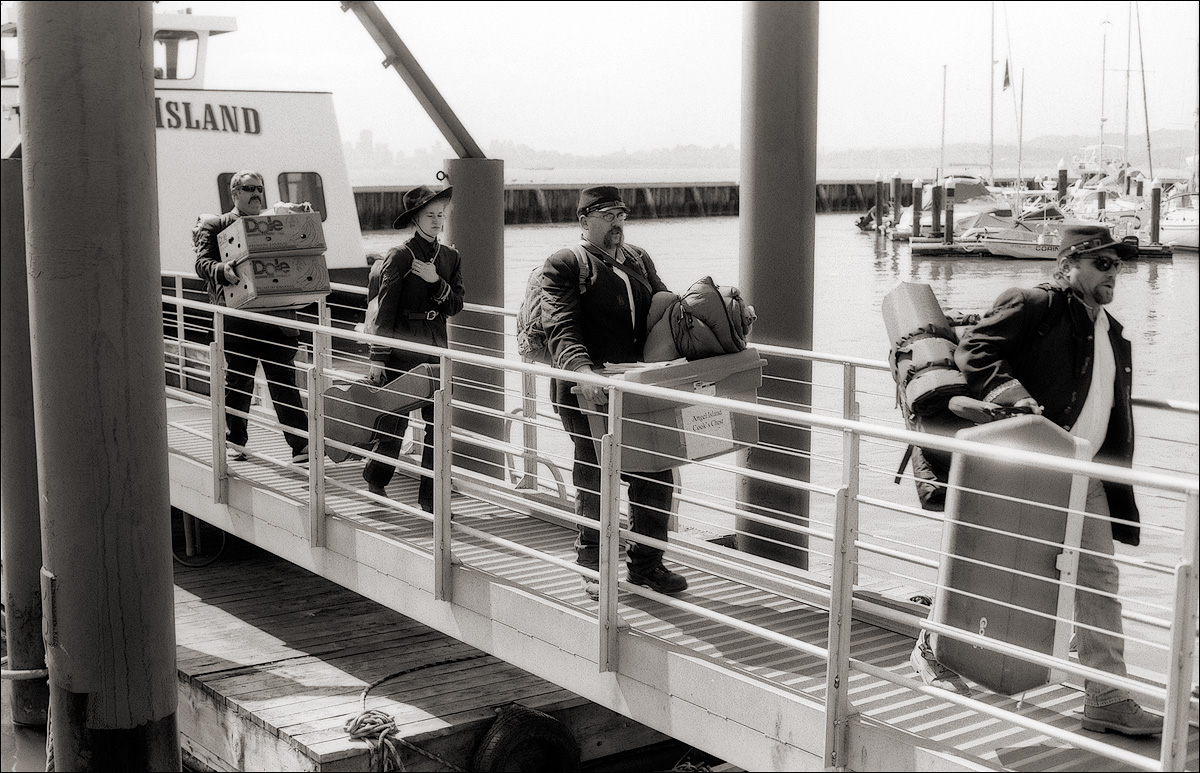

Ok I shot two short rolls of the Cinerex yesterday on a field trip with my son's 4th grade class to Angel Island in San Francisco bay.
As mentioned I shot it in my Contax G2 and used primarily the 45 Planar but also the 28 Biogon and 90 Sonnar. It was a bright, clear sunny day and I set the camera for 40 ASA but adjusted +2/3 to +1 to "over-expose" for anything close to being backlit.
Developed it just now in HC-110 dilution B at 20C for 5 min with 2x agitation every 30 seconds. It's hanging to dry right now but let me say this: contrast!!!! Crisp and sharp, sharp, sharp (with those lenses of course) but my god the negs look like they were etched in granite. Will scan some tonight. Fingers crossed on highlights being preserved.
Right now am thinking 50 ASA next time and perhaps HC-110 but dilution H and 6.5 min just to see how the contrast is tamed with more dilute developer and some pull back in time. Will see if this opinion stays after the scans later...

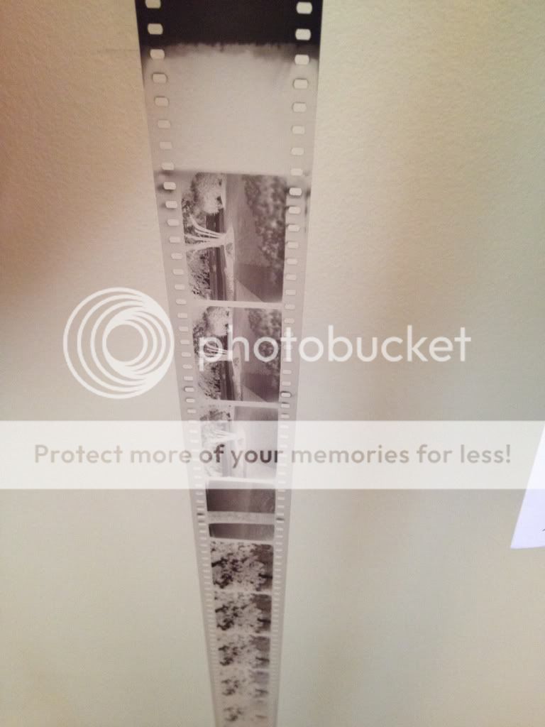

Still rainy and cloudy out here, was able to do a quick test roll of about 15 frames. Here they are drying, not thin negs anymore!!! I developed by inspection with a red light in the darkroom. Checked at 5, 10, 11, 12, 13. Then at 13 they looked nice and baked well....
Note, if you are going to open your tank and look at this film, please make sure you have good goggles on since the film can splatterer and what not while unrolling and glancing at it as my goggles saved me already.
Shot it at 25 with a yellow (K2) filter (which takes one stop) on my Yashica Linx 14E f1.4. Xtol 1:1, 14 mins. They look spectacular (at a glance as they dry)....time will tell...hope to get a scan of em today and if I am lucky get a printing session too today....
Ok, here are some of my examples as developed and exposed in the above post:
SF Commute Angelk Island ContaxG2 45Planar 28Biogon 90Sonnar AgfaCinerexIC1N ortho HC-110dilB 5m.jpg

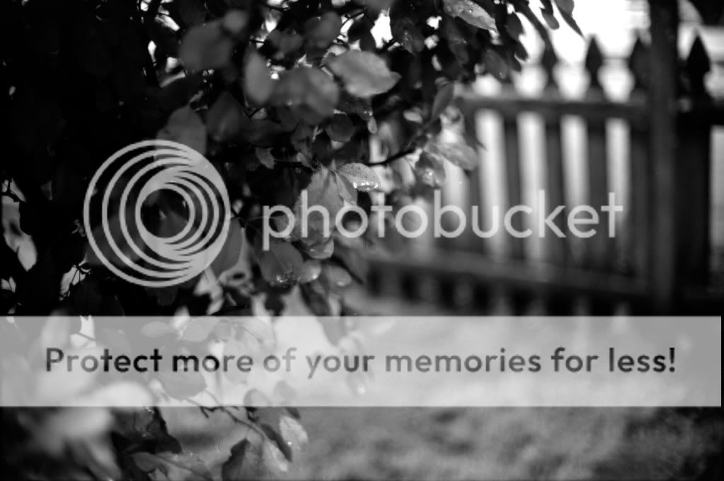

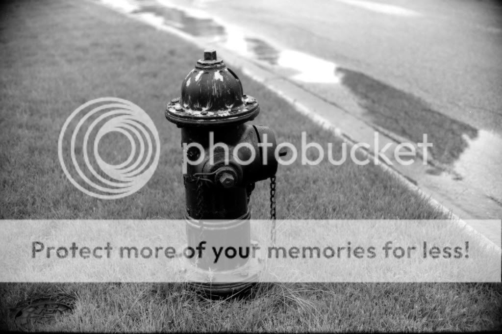

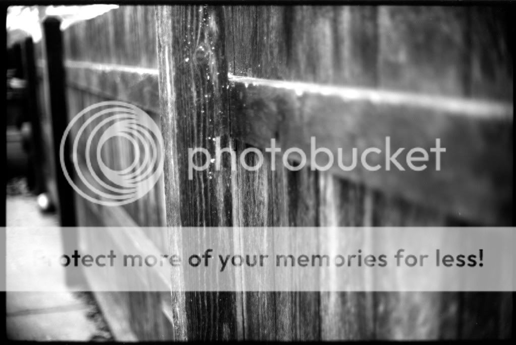

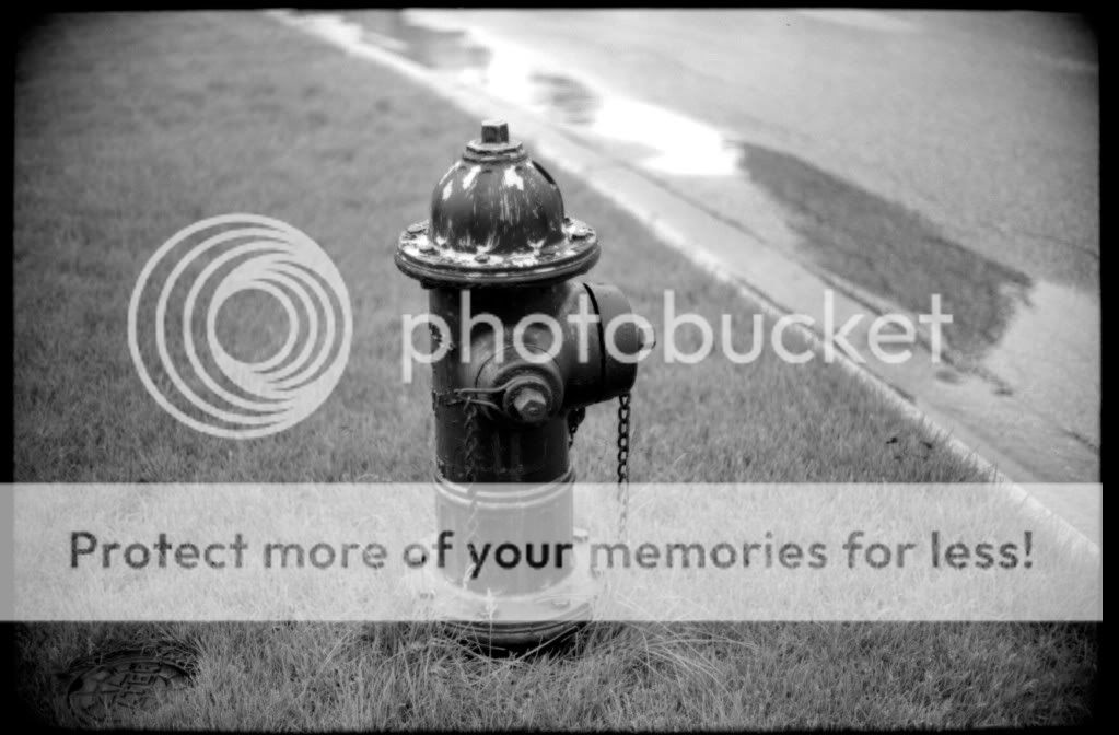

After my fourth roll I think I hit my stride!! Thankfully the weather has been the same for all four rolls thus far (gray, cloudy and rainy). This last roll I shot at 25 with a yellow filter (K2). I developed in Xtol (not replenished) 1:1 for 14 minutes. This film when hit right is beautiful. I was sure jazzed to hit a few.
Camera – Yashica Linx f1.4:
Scans (auto no adjustments on my end):
A: 1/125 f1.4
B: 1/250 f1.4
Check out how sensitive this film is only one stop difference between C and D?! Wow, night and day.
C: 1/250 f2
D: 1/25 f1.4
I think this film works exceptionally on overcast days! Like all ortho not the best on skin tones (it’s a bit harsh, I saw a neg of a shot of my wife and it does not do justice to her skin color – more pink/red looks dark and harsh, it would work great for the Marlboro Man through)…
I think like others have shown, a filter is probably needed (I am enjoying my yellow K2).
I am now dreading shooting in sun, a whole other set of rules.
