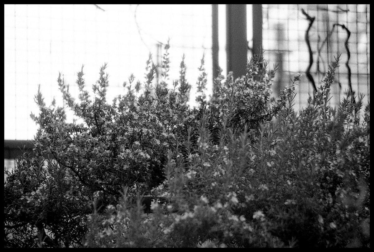

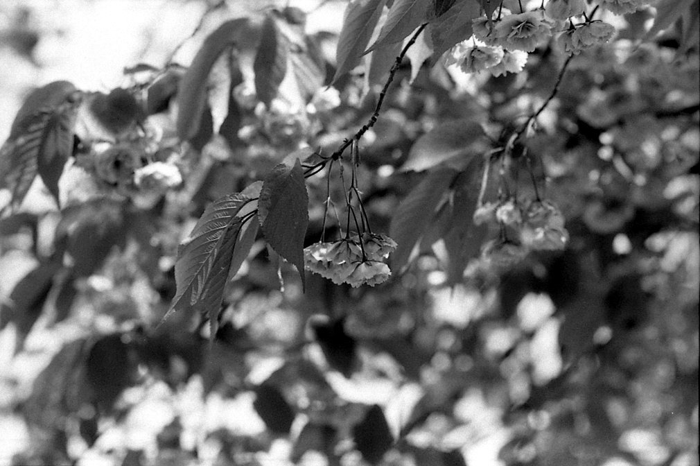

Exposed and developed my first roll @ 35 EI Developed 1-50 Rodinal 9 min @ 20 C. I used my usual way: Pre rinse then 30 secs agitation to begin and then 5 secs agitation every 30 secs. Slightly over developed. Next 1 will be 7.5 min with 1 min agitations. Not far off for the start. Will be adding a Yellow filter also. Very nice grain.
1-Agfa Cinerex 50 1-50 Rodinal027.tif.jpg 1-Agfa Cinerex 50 1-50 Rodinal002.jpg

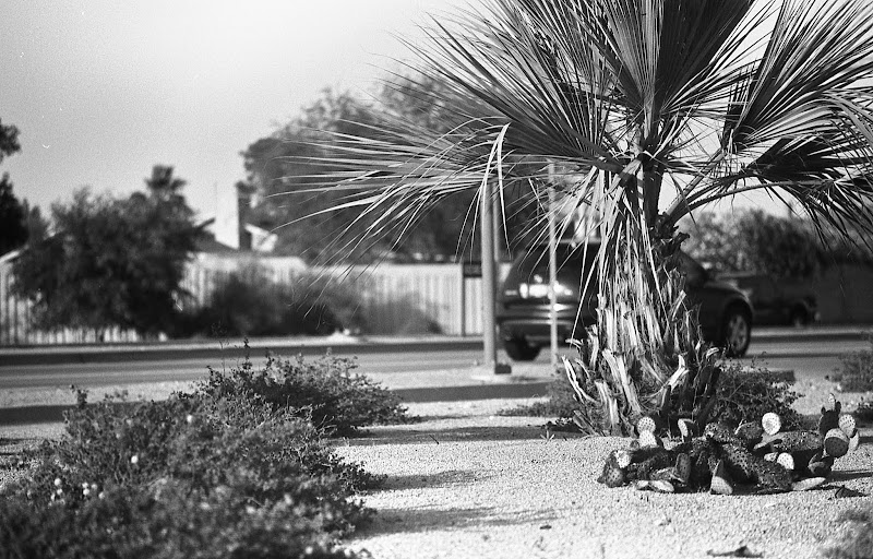

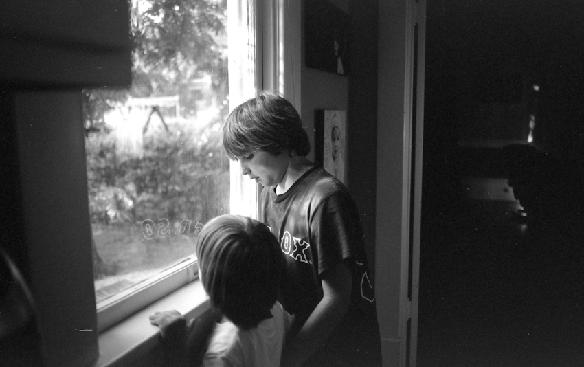

Shot at ISO 200, developed in ID11 (1+3ish) for 14 minutes - agitation first minute and then 6 inversions every minute after that.

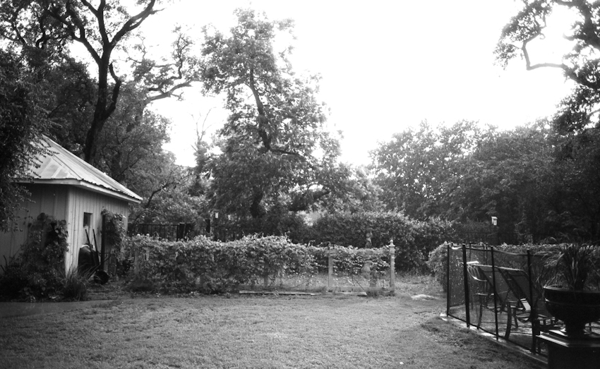

This film dries VERY fast. I had no problem with using this film under a red safelight either ... Grain is VERY fine. I like it. Dark greens and bright highlights. It's lovely. Just a random sampling. (I killed my toaster today, by the way).
Looking great Katie! There is that glow that John (grumpy old man) is looking for!!

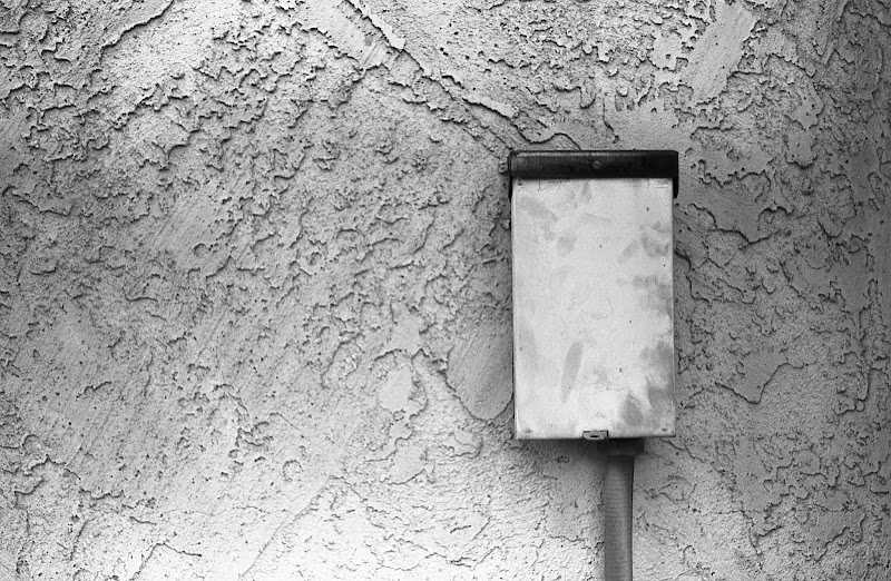

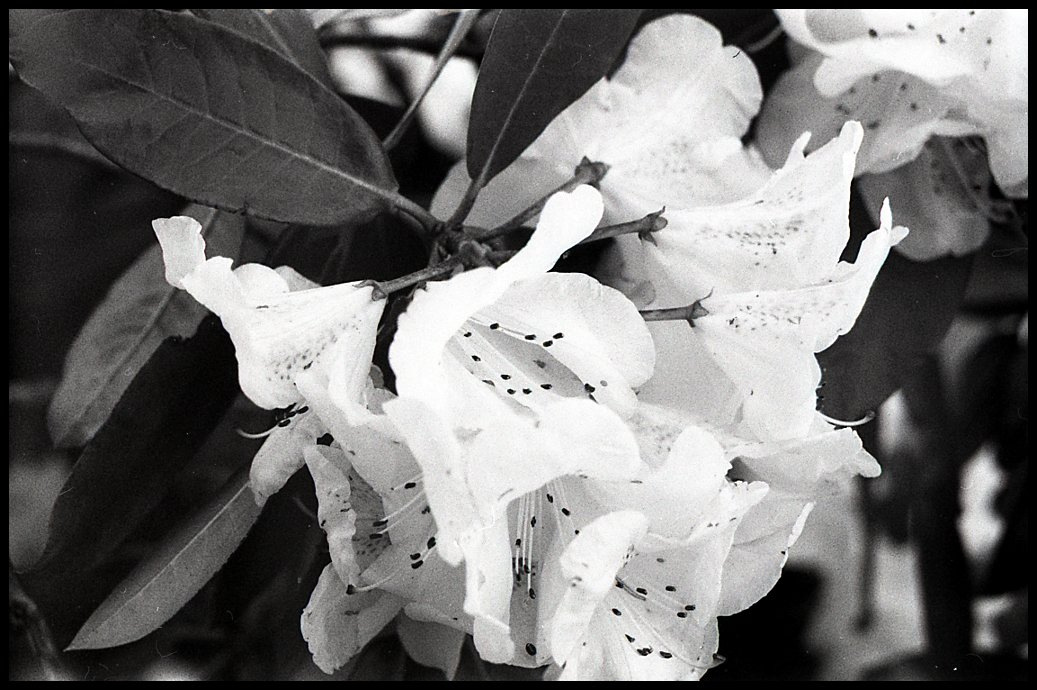

Revised developing. 8 min @ 20C Rodinal 1-50 5 sec agitation per minute . 35 EI I could really get to like this film. Excellent grain
A few more experiments and I think I will happy with the results. I added a bit of warm tone on my Flickr site that really stand out well.
1-Agfa Cinerex 50 1-50 Rodinal014.jpg 1-Agfa Cinerex 50 1-051.jpg 1-Agfa Cinerex 50 1-056.jpg

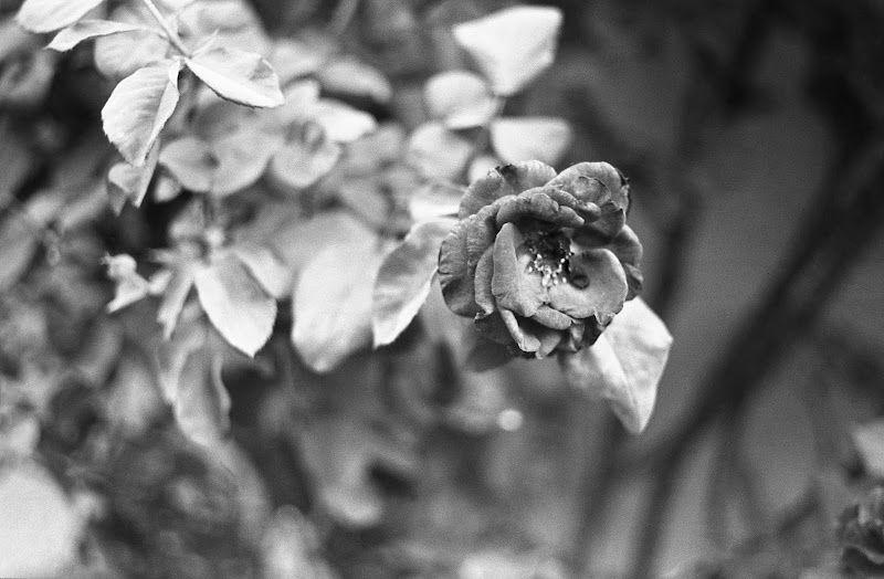

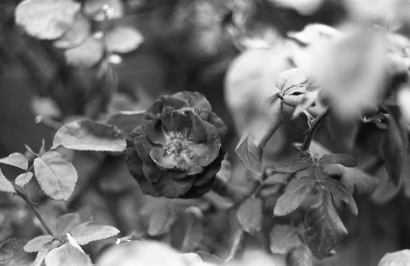

Finaly developed one more film. Exposure index = 50. This time did Fomadon R09 1:50, 20C (68F), 8 minutes, agitation for first 30 secodns and then 2-3 "turnarounds" avery minute (basically followed Field's experiments / recommendations). I love result. I do not see that much difference from a "normal" bw film (except black roses).
Now I'm torturing myself why I did not buy more rolls from Field when they were cheaper.. :smile:

Nice. Good starting times for my next few rolls as I'll use Rodinal.
Vfalendysh - Those are looking great, the portrait has great tonality!

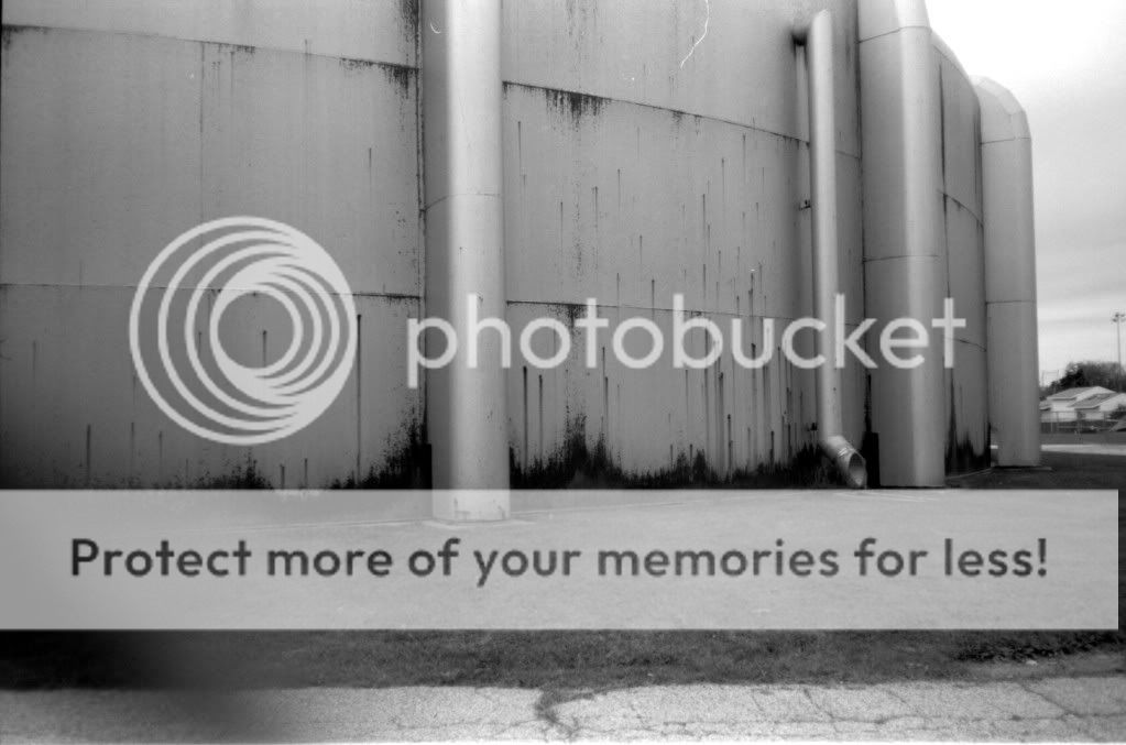

Today, like almost every day since this film has arrived, it was gray and rainy, so I bulked about 10 frames, and while running errands with the kids I saw this water tower, it was surrounded by a chain link fence so I tried to stick my camera’s lens through one of the links, which I didn’t do so well (see left part), but since this was a test, I am not really concerned sharing something with such obvious technical issues, with that said, the photo is gorgeous in my estimation, the water tower looks almost exactly like you see in reality because it was a sliver structure with that neat black grime on the bottom. I thought I would share this since it shows how great this film can be (if only I could have framed the photo better). Camera Olympus XA, ASA 50, processed Xtol 1:1 (not replenished) 17:45, agitated 4 times for 10 seconds initially and every minute thereafter:
ps dont mind that fuzz that somehow got on my $canner....
Thank you for comments :smile: next step - find correct delution / timing for stand development. Looking at my first "experient" I think I will try something like r09 1:200 / 60 minutes.
Have to add one thing.. Picture were Taken with my now-favorite Mamiya ZE. Those little cameras the same as entire E series mamiya lenses are very underestimated. They are pretty rare to find but go for close to nothing.. 50mm f2 is really sharp and makes amazing foggy bokeh on full open.
