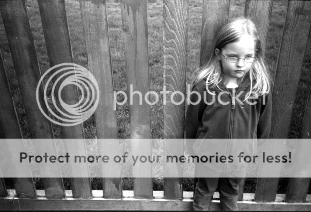

What interesting film. Washed clear. Just black and white. Odd, neat, cool. Like a chrome.
Took a pic of my daughter, the fence wood is quite interesting.
At 50, Xtol 1:1, 10:30 seconds. Neg scan for now.
Really interesting stuff. Nice to have in my bag! Thanks Field, this is everything I hoped for, a film that is odd, different and fun to play around with!

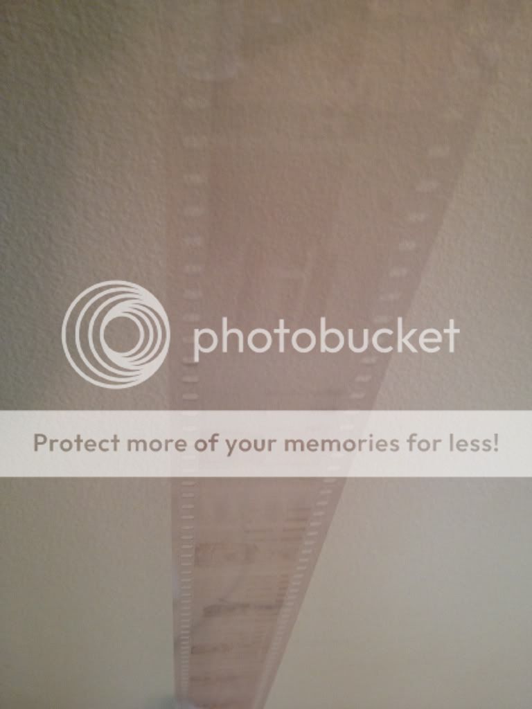

Bulked another roll of 10 frames, it's drying now (see below), might be able to scan a few tonight. Won't be printing till probably the weekend though.

My 2nd roll's negs as you saw two threads up are way too thin....hummm
Shot at 25 dev Xtol 1:1 for 8 mins. Think I went the wrong way
Should have gone 25 ISO and maybe 13.5 or so ???
The initial roll at 50 for 1:1 Xtol for 13.5 mins were pretty thin too but the blown highlights made me think shoot slower but cut the dev. Anyone getting thicker negs?
