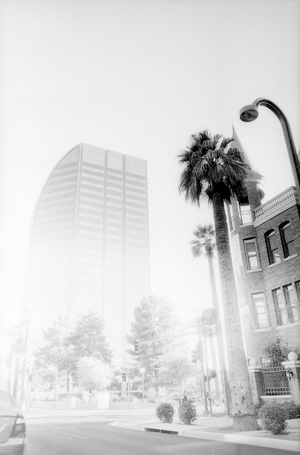

Developed in Fomadon R09 / 1:100 / 60 minutes / 20c (68f), agitation for first 30 seconds, then stand for 59 1/2 min, then stop bath, kodak fixer for 8 minutes, zonal archival wash and kodak photo flo with 2-3 washes in between chemicals..
First part of the film was shoot as ISO 50 and those frame come up extremely overexposed. I tried to do my best manipulating brightens / contrast in photo editing app:

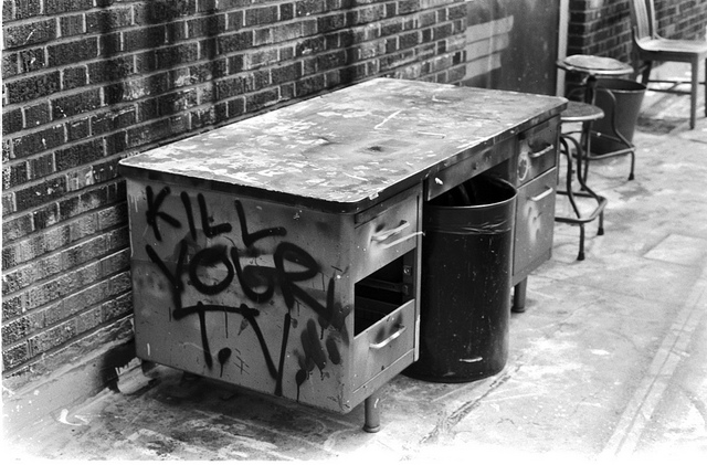

Great job Field!!!! That desk photo is perfect!!!
The problem is I didn't use any post editing, which should be required for any properly done negative. If you look at the other photos they are too hot in certain areas.
