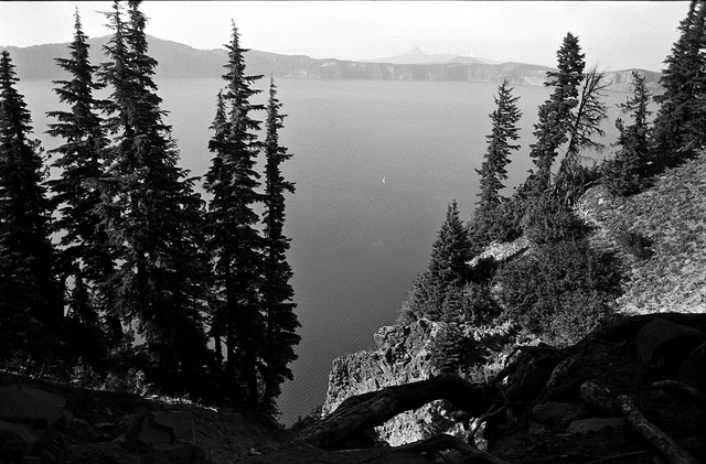

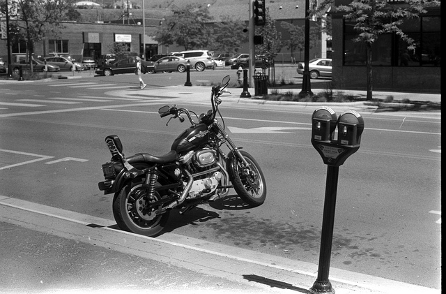

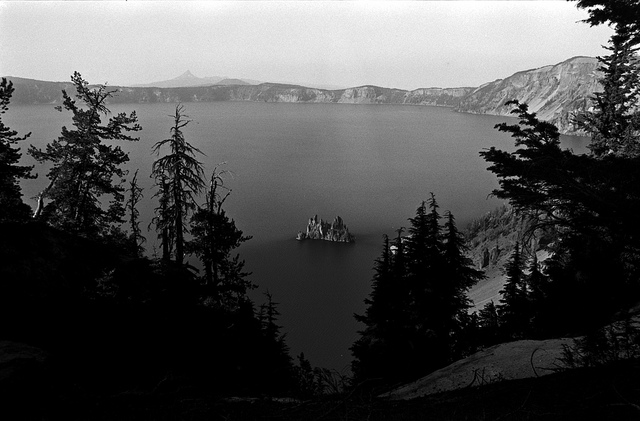

A few more using Rodinal 1-50 (16 EI) for 7 minutes with a prewash and agitation 1 per minute. Taken with Canon EOS 3 w/ 28-105mm f/3.5-4.5 lens
Loving the contrast I get from this film. Next batch will be 6.5 minutes in Rodinal
View attachment 51123 View attachment 51125
Wow. Loving this. I think I see here a combo of EI and times I'm going go with in using Rodinal.
EI16, wow!
Anyone looking to do the same please realize the agitation of Rodinal greatly changes how it works. I prefer less agitation becaues it extends the development time and lets me fine tune development.
That is one of the differences I have found between Rodinal and the Canadian version Blazinal. With this developer you NEED to agitate every minute to prevent uneven developing. I have tried it with many different films and found I have far better development WITH agitation of 1 per minute. I am going to keep reducing my development times even more. 6 minutes next and leaving the 16 EI . Sooner or later I will find the minimum time. I have given up on the small test rolls (-20 ish frames) up to the over 30+ frms so I may need another large roll before the year has ended. THNKZ

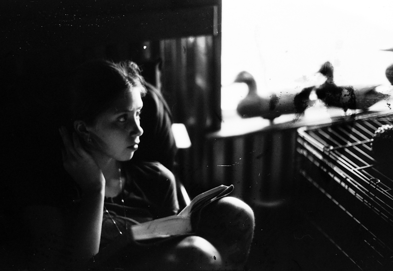

A few more, shot at ISO 100, developed in ID11 (1+2) for 9:30 ... still overdeveloped. These were in a daaaark room. Used with a tripod.

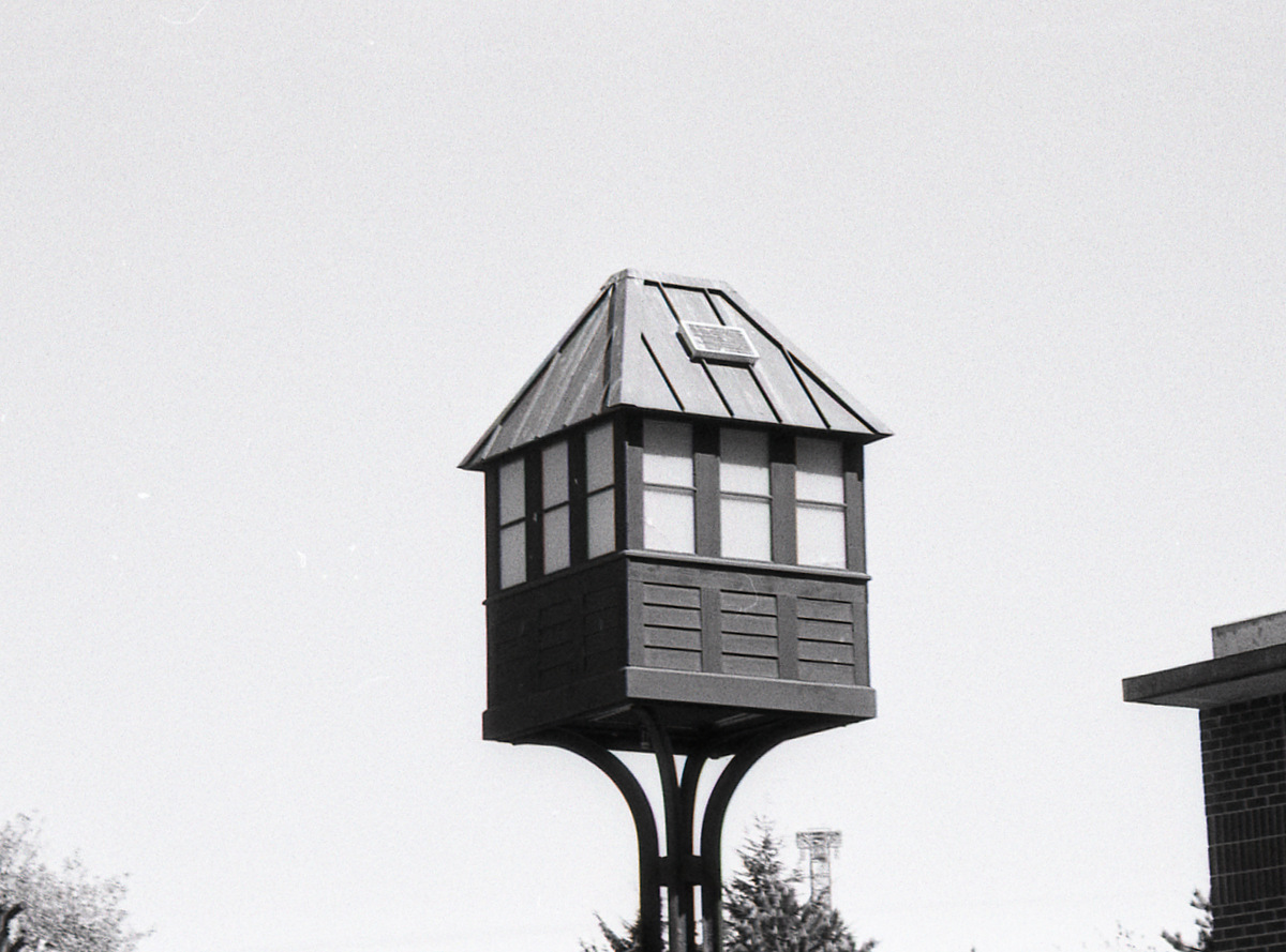

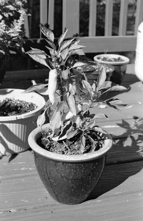

I tried Rodinal 1:50, 68F, 7.5 minutes, agitate first 30 seconds, then 5 seconds every two minutes EI50. This turned out much better than my first batch which was overdeveloped (8 minutes with more agitation). I am feeling more confident that this film can be used in not only even lighting but also with harsh lighting (dark shadows). The negatives are so sharp. Test shots - the first one is of a banana pepper plant in a navy blue container in very harsh side lighting. The second one is of a grave marker. The usual disclaimers about image quality. A sharp, contrasty film, no doubt, but it can be tamed.
Tonight I will test if they are printable with traditional methods. I bet they are.
Thanks again Field!
Dave
This stuff can be very sharp, or very dreamy. I find at lower shutter speeds the sharpness is diminished for me often. Maybe it is my hands, but I don't know! I usually pull of sharp pictures at lower shutter speeds (nothing too low, like 60th). Maybe it has more to do with DOF and focus. The film is designed for receiving a rather flat image, maybe that has something to do with it.

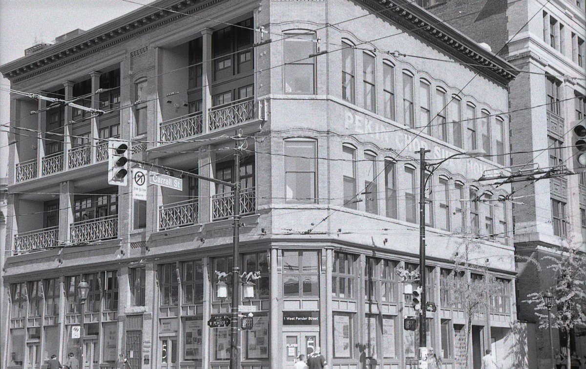

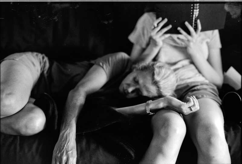

EI100 5min rodinal 68* , agitate beginning and middle.
EI200 6min rodinal 68*, agitated beginning and middle.
v700 flatbed. only 150dpi, 16 bit greyscale nothing else. it is always dirty. Man silverfast software blows but hey... I can use it.
Are you getting any separation in the shadows? My monitor shows a pretty solid black.
