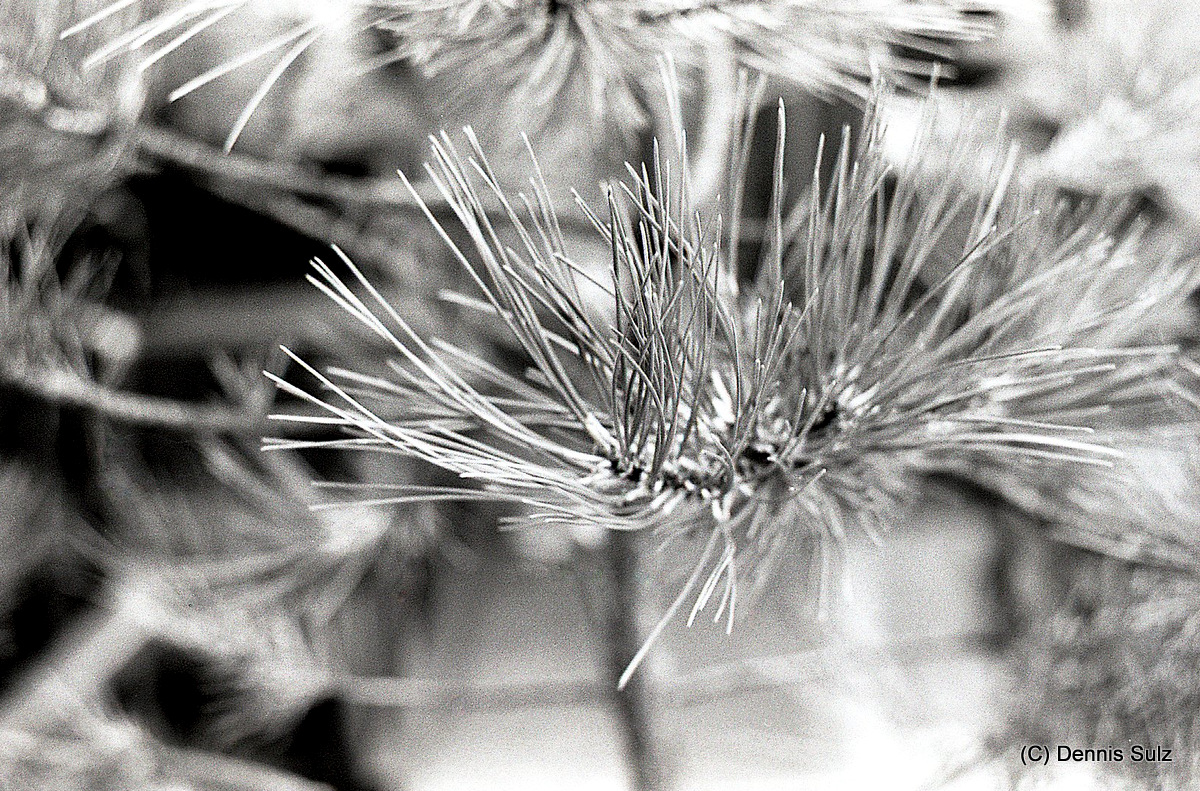

I have been shooting it at 25 and developing in Rodinal 1-50. Nice results & just scans so far.
In my test roll I ended up with 40 asa and 6 min in D76d (started in 1985 and replenished ever since, like me it continues to improve with age), Back to subject, the few prints I made were good for first work prints

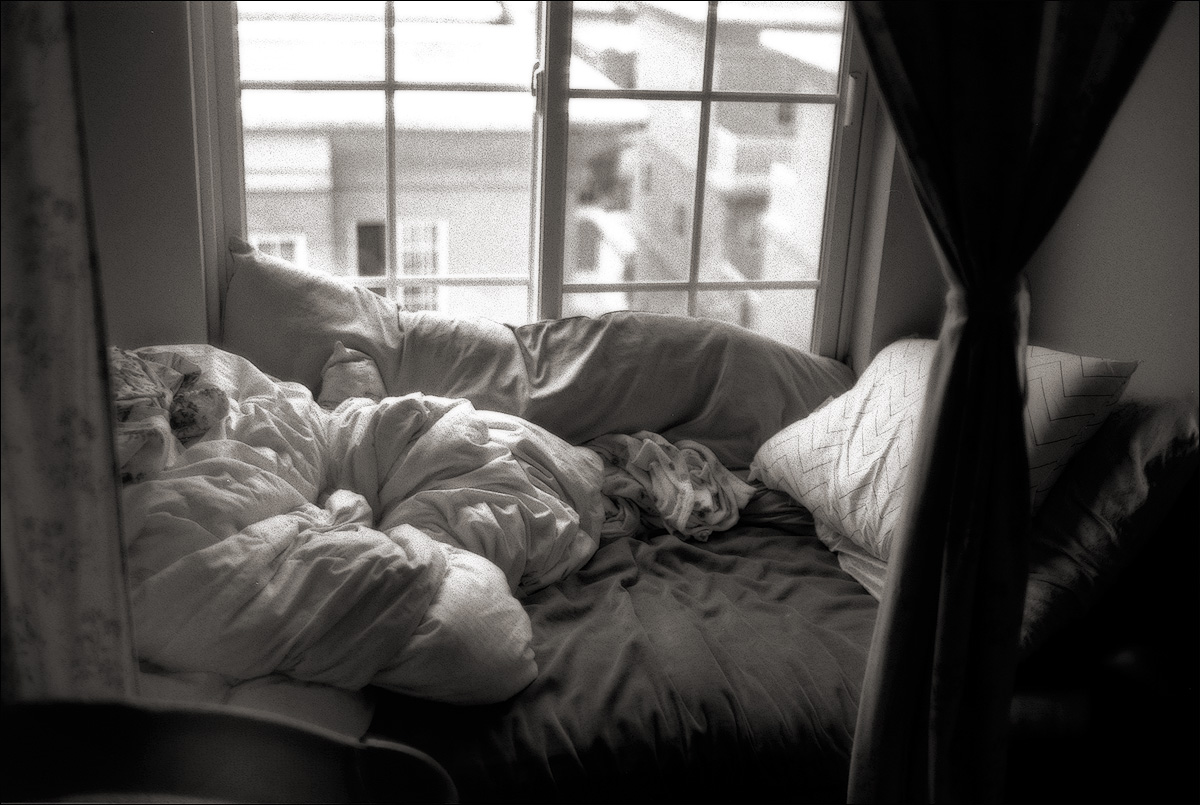

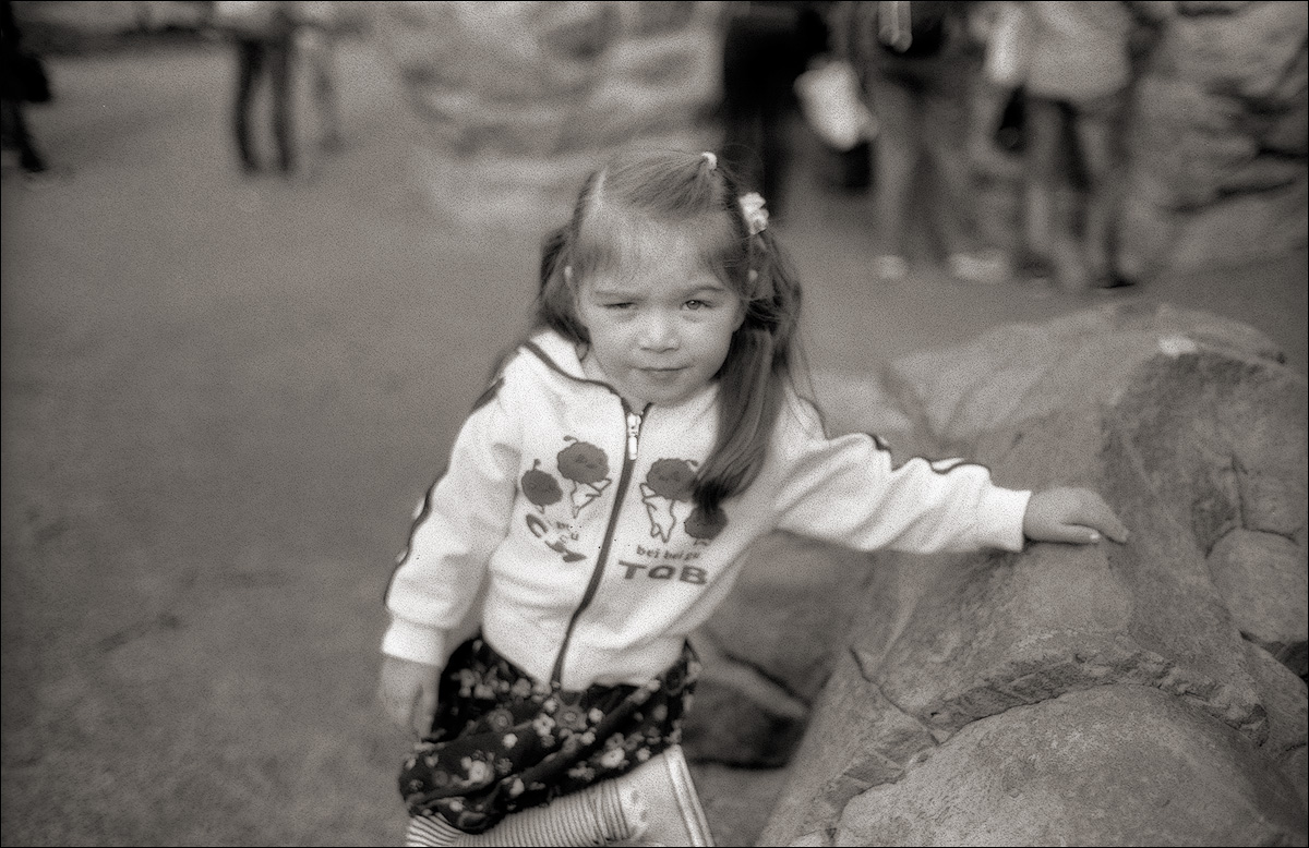

I'm reviving this old thread as I've been shooting this film again and thought I'd share results. In particular I'm trying to find better shadow detail and shot this latest roll on an overcast day without much contrast in the lighting. I'll say I'm still having some trouble gaining significant shadow detail and the negs are still quite contrasty. I may still try to pull back on development times more and perhaps lower the asa even more but have to say even with less shadow detail than say a traditional B&W emulsion I really love the look I'm getting from this film nonetheless. VERY grain evident but overall a very unique and interesting tonality that while may not work all the time but I find quite interesting and pleasing.
All the below shot at 50 asa with my Nikon F2 with a 35/1.4 Nikkor-N AI lens. Most shot at f/2 or so. Developed in HC-110 dilution H (half of dil B) at 7 minutes development time at 22C, agitation 3 times every 30 seconds. Scanned on a Nikon 9000 with Vuescan software.
Window seat "nap area":
attachment.php
My daughter Naomi (who we call "Mimi") who will be 4 years old this coming December 30:
attachment.php
attachment.php
attachment.php
  • Mimi Ben Amy Tilden little farm, jewel lake NikonF2(blk) 45f1-4Nikkor-N AgfaCinerex(at50) HC-110.jpg

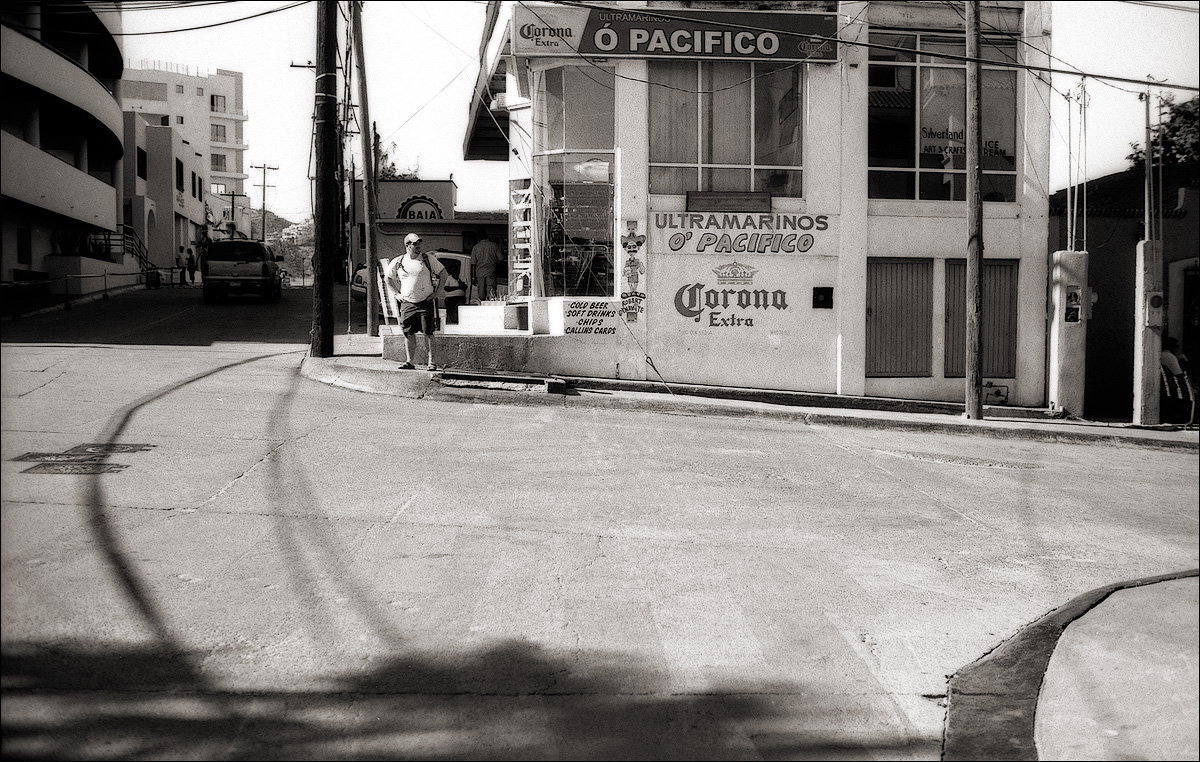

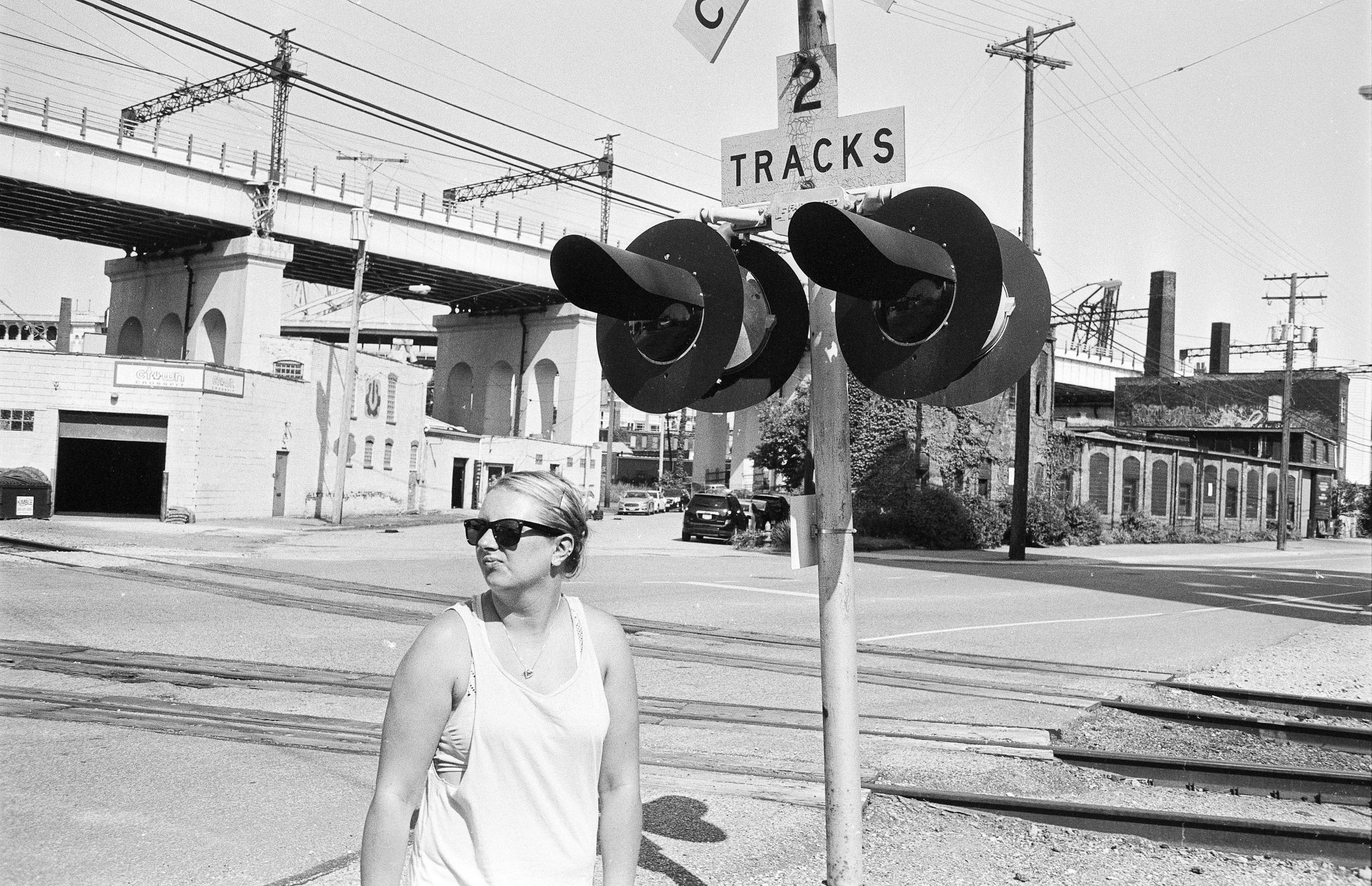

Ok, shot some more of this on vacation in Cabo San Lucas last week. Decided to try in very bright contrasty conditions, over-exposing and then pulling back on development. Did ok overall but this is NOT a film for contrasty conditions unless you REALLY want a contrasty result! Maybe not Kodalith but not all that far off either!
All the below shot at 12 asa with my Konica Hexar AF. Developed in HC-110 dilution H (half of dil B) at 12 minutes development time at 18C, agitation 3 times every minute. Scanned on a Nikon 9000 with Vuescan software.
attachment.php
attachment.php
attachment.php
  • Cabo San Lucas 2014 KonicaHexarAF AgfaCinerex at12 HC-110dilH 12min 18C 1minAg3x 2014-12 VSmac 4.jpg
Oh, one thing I'll add that I forgot: definitely less apparent grain this time for the Cabo San Lucas shots....

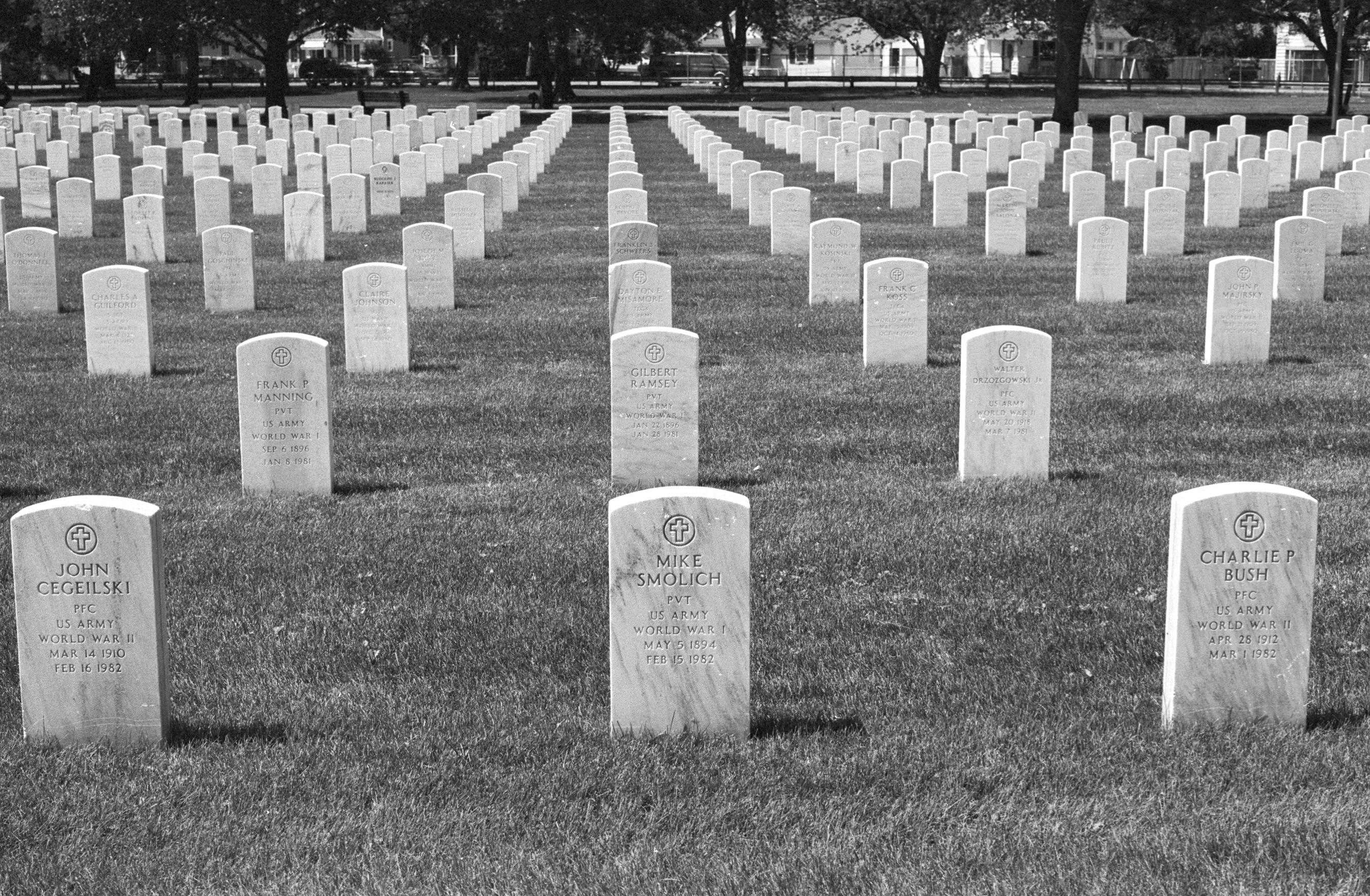

Grave Markers in Ohio
Went to visit my dad at the Ohio Veterans Home in Sandusky, Ohio. There was a celebration of the anniversary of the 70th anniversary of VJ day and 162 WWII veterans were honored. This is located on the property.
Cinerex in Rodinal 1:50, 30 seconds initial agitation and 2 inversions every two minutes. Could reduce the time of 7 minutes a little bit but overall I am pleased with the look.
I really like this photo.

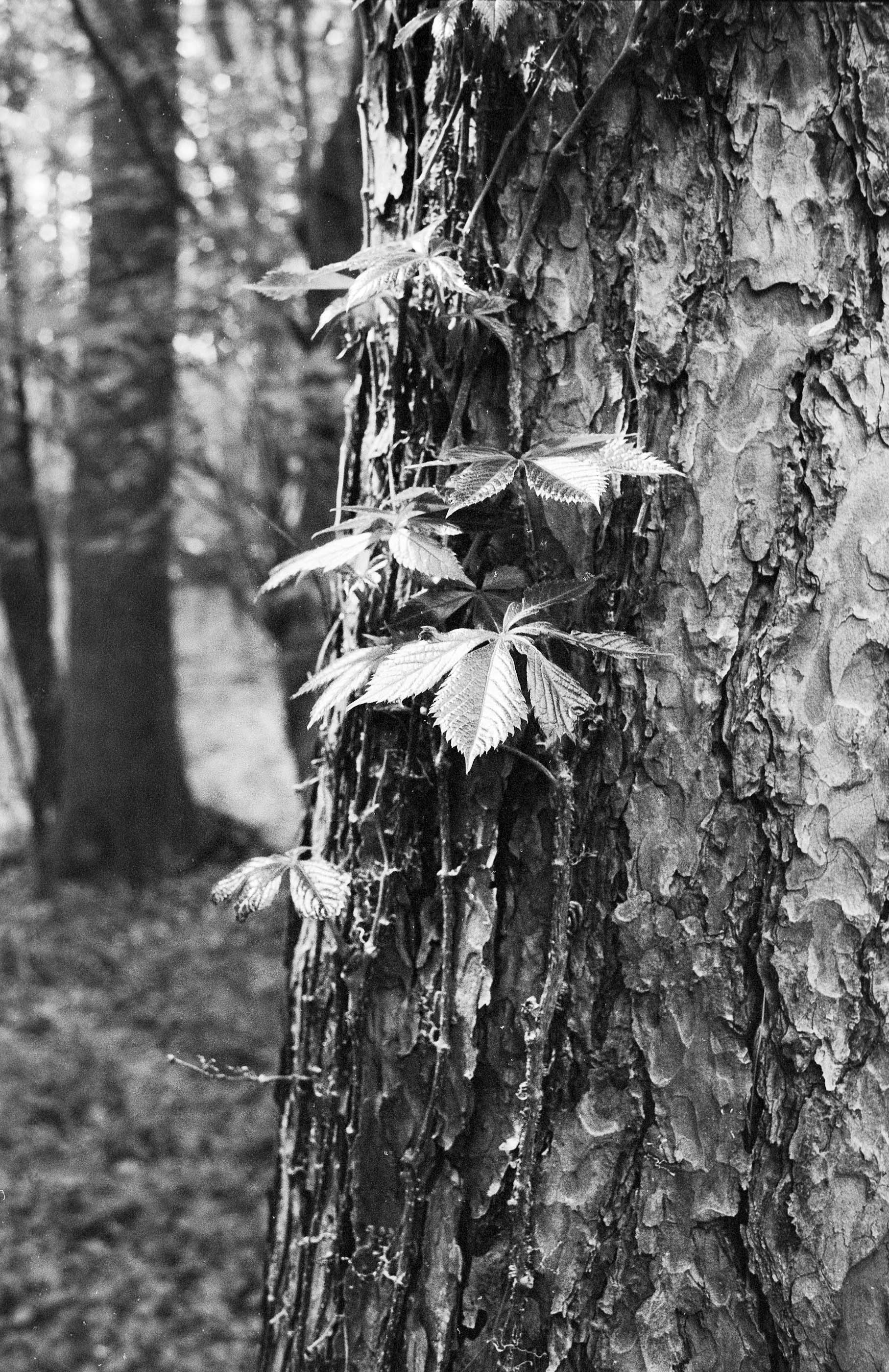

A few more on Cinerex
Here are a few more from the same batch as before. Some of these were taken in the Flats in Cleveland and a couple were taken at Wallace Lake in Berea, Ohio.
Any comments appreciated.
