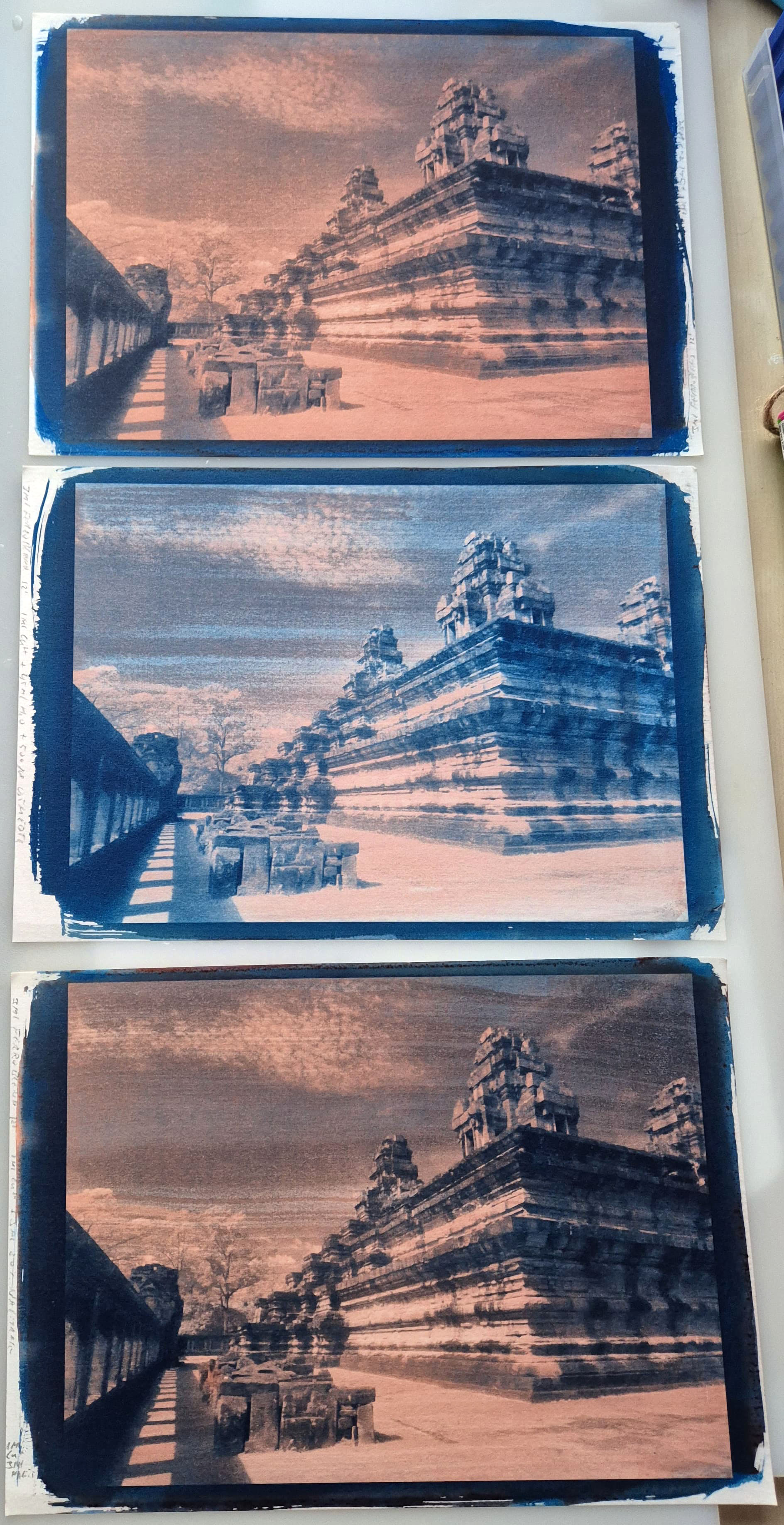

I did some testing on the Schut paper, adding different chemicals to the developer.
Conditions:
  • Digital negative (may or may not be optimal, but I am happy with the results
  • Schut paper (size A4)
  • 3 ml sensitizer solution (foam brush): all in one solution which after 4 days became increasingly hard to get an even coat (you see coating artifacts in below scan) with Ammonium Chloride, will go back to the 2 solution option (AFC+Amm. Cl and KFeCN)
  • 12 minutes exposure on my UV bank
  • Developer:
  • Top: 1 ml Copper stock + 3 ml 20% KBr
  • Middle: 1 ml Copper stock + 0.5 ml 0.5 M EDTA (=0.084 gram) +2.5 ml water
  • Bottom: 1 ml Copper + 3ml Sodium Citrate
After exposure the different developers are brushed on and kept there for 1-2 minutes, the EDTA one takes longer (chelating the metals).
Below image is from the still wet prints and give a approximate impression of the different colours possible. I would say it is quite flexible! Still no pure paper white in these images, but the Sodium Citrate seems to be the brightest, and on a stepwedge is give almost pure paper white in the higher steps.
Best,
Cor
The middle one looks the cleanest to me, and I understand that's the one with EDTA added to the developer, correct? I wonder how that would look if you leave it to develop longer, and/or reduce the EDTA concentration to a threshold amount that just suppresses fog without hampering development too much. It'd require some experimentation to determine that amount (if there actually is such a threshold concentration).
Dialing the EDTA is a bit finicky, to little there is fog on all steps in the stepwedge, too much there is no copper ferrocyanide at all, as expected since EDTA will chelate (bind) all the copper ions.
At this point I like the sodium citrate the best, is has a nice Dmax and a nice image tone. The EDTA one is clear blue in the shadows and that switches to the salmon/orange of the copper ferrocyanide, I like this less for these images.
Best,
Cor

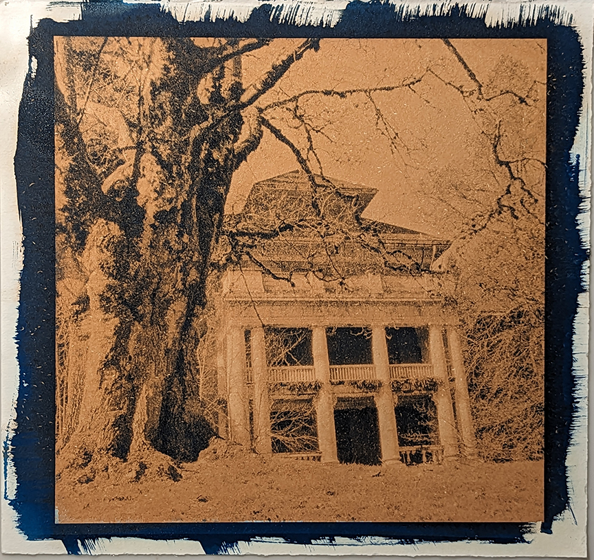

I was able to make a decent print, using the traditional cyanotype recipe, on Revere paper. I'll just do it this way so that I don't have umpteen different concoctions laying around... And I can still make straight cyanotypes when needed!
Interesting... no excess pot ferri. I'm going to try soon... will start w/ OP recipe.
I don't see a lot of gradation to the copper image in that one, @Andrew O'Neill . It looks nice as it is, but it's not a FerroBlend print, technically speaking. It's a cyanotype with a constant copper-toning layer on top of it.
@koraks: you're right. It seems more like a layer of CF has been added on top of regular Cyanotype image.
@Andrew O'Neill: can you please share pics of the print at intermeidate stages? Will help us understand what's happening. And does your developer contain Citrate as specified in OP?
Yes, there is Sodium Citrate in the developer. The only thing I did different here is that I used the straight Cyanotype recipe. I'll revisit all of this after I get back from Japan in June. I'm too busy now. Thanks!
