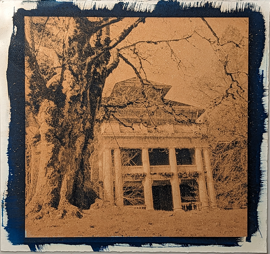

I tried some old Stonehenge paper that I had laying around. Cheap and thin. I forgot how crappy this paper is for Alt. Anyways, I went ahead and acidified it in 10% Sulfamic Acid, washed and hung up to dry. Now the crappy part that I had forgotten about... it doesn't like brush application. To be more accurate, it doesn't like foam brush application. Small paper burrs on the surface. Once the paper dried, I was able to brush them off with my hand. I made the exposure, and developed in the Copper Sulphate...by brushing it on with a foam brush. More burrs. But... I got a wonderful print! Much better than what I could get on expensive, Revere. So... I acidified a sheet of the Revere, even though one would think that it's not buffered like these cheap papers, but what the heck. I'm waiting for the Cyanotype coating to dry, then I'll give it a go. For now, here is the print on cheap garbage Stonehenge... You can see the paper burrs on the full print. I included a closeup, too...
View attachment 395853View attachment 395854
I wonder why this picture has a charm that made me look for a time. I can't be sure yet because i've only been enrolled here for a few months. But i believe it's you that had an infrared shot of some building columns that was remarkable. ll that said, why do we keep applying these exotic emulsions with a brush? Why not an airbrush with a broad tip, requiring only about 3 swipes to coat the whole sheet? 3 up and 3 down and near perfect uniformity is assured. One thing I learned early on (as in the first time) is that foam brushes for this purpose are purely awful.
Thanks @NedL for sharing your experience and result.

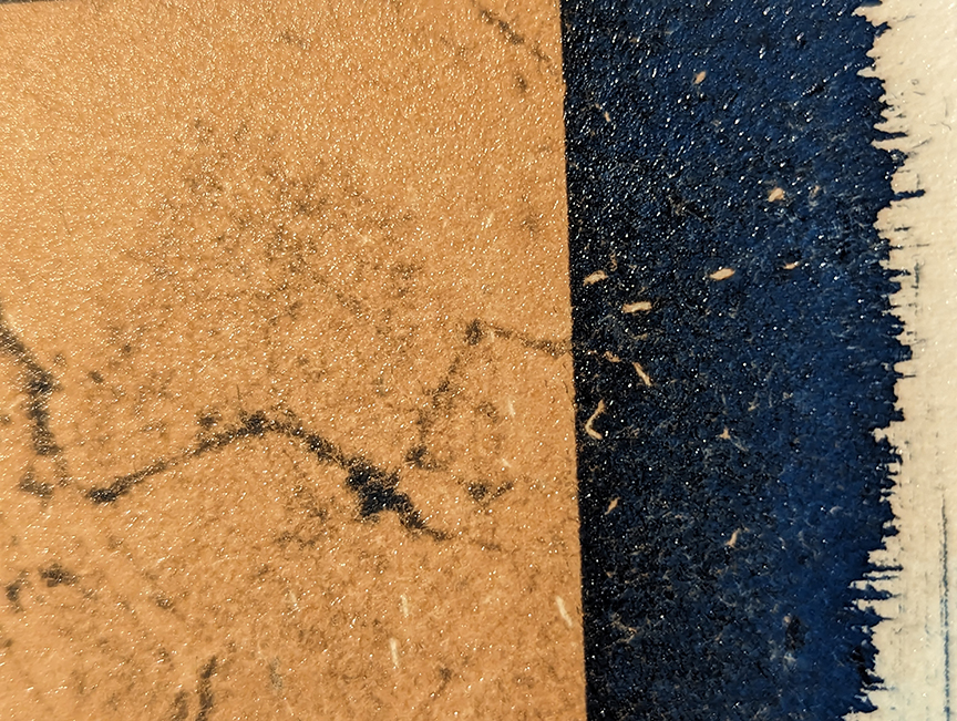

The blue patches in the print, I'm curious if they appeared immediately after brushing the developer or during the wash.
Hi Raghu.
I could see the blue patches before I put it in the wash... I'm almost certain they were caused by high areas where the developer flowed away and got thin. Today I tried again. I misted the back of the paper with water and then let it relax before I flipped it over onto a piece of blotter paper and applied the developer. Very even development this time...no blue patches.. so that problem is solved! No loose pigment forming, and the image seems to be nicely locked into the paper with no smudging. Today I added 12% KBr to the developer, and the highlights are noticeably lighter but not a dramatic difference.
Ha, I'm still thinking about the ammonium chloride. When I mixed it, I'd forgotten it is endothermic and even that surprised me :smile: Anyway, it changes the paper characteristics quite a bit. Today the same thing happened in the print frame... there is a strip in the middle that is blurry. Before I opened it, I checked that it was still flat and it was, but when I opened up the print frame a bow formed in the middle of the paper in the same place as the blurry area. There are other areas in the print that are a little blurry too. The only thing I can think of is that as the paper heated up in the sun, it shrunk or expanded enough to move during the exposure. I've made hundreds of prints in that contact printing frame, many of them with this paper, and it's never happened before... now it happened two days in a row! Today I let it dry for 3 hours prior to exposure... maybe I'll also hit it with a blow drier next time. That's assuming paper shinking/expanding is related to humidity and not just temperature. I'll try some different papers eventually, maybe some thicker ones too, but I generally like printing on thinner papers.
It's a fun process and I'm looking forward to making more prints. Thank you very much for all your work on this and for sharing it here.
I should note: my scanner exaggerated the peach/pink highlights and in person they aren't so glaring and it looks nice. I'll see if I can do a better job of scanning the one from today. Unlike some other examples in this thread, I notice that my "blend" of copper and PB starts near the middle of the scale. It would be a good thing to know what factors affect the "switchover" point from copper to PB ( length/depth of exposure, pH, buffers, temperature, differences in AFC, etc etc.... ) Kind of a "split toning" control if you will....

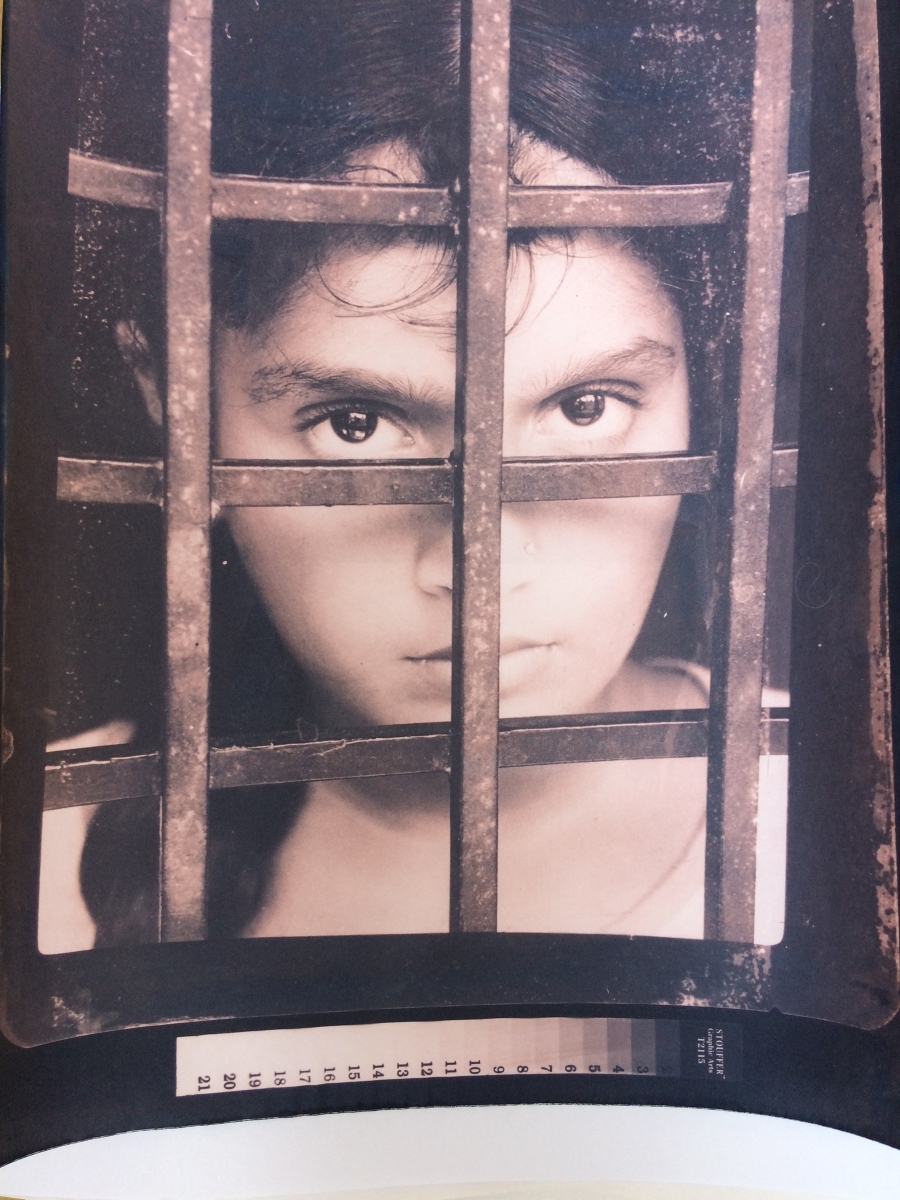

This is some very excellent work. For all intents and purposes it seems to equal Enjoyable reading though ordinary silver-based process. My question, at least for me and my needs and my age, is if there's any reason to use this process instead of the ordinary silver-based process and whatever toner you prefer? Enjoyable reading though. Although the girl behind bars would not have been my personal choice of subject matter.
This process is fundamentally different in every way to silver gelatin and I don't see how a silver gelatin print could realistically be made to look like a ferroblend print, or vice versa. The process of making these prints is different, and the requirements on negatives are different, too. Subject matter that may work well for one process may not work well for the other. Whether any of this is a reason for you to try one thing or another, nobody else but you can answer.
You're free to print whatever you like, as is anyone else and as long as it fits in the forum rules it can be posted here. Kindly focus the discussion in this thread on the process and the technical characteristics of the prints, not on personal preferences in subject matter.
I am sure the girl is not incarcerated in a jail or something, but just looking out a window of her home with bars which is fairly common in India, specially in the old buildings.

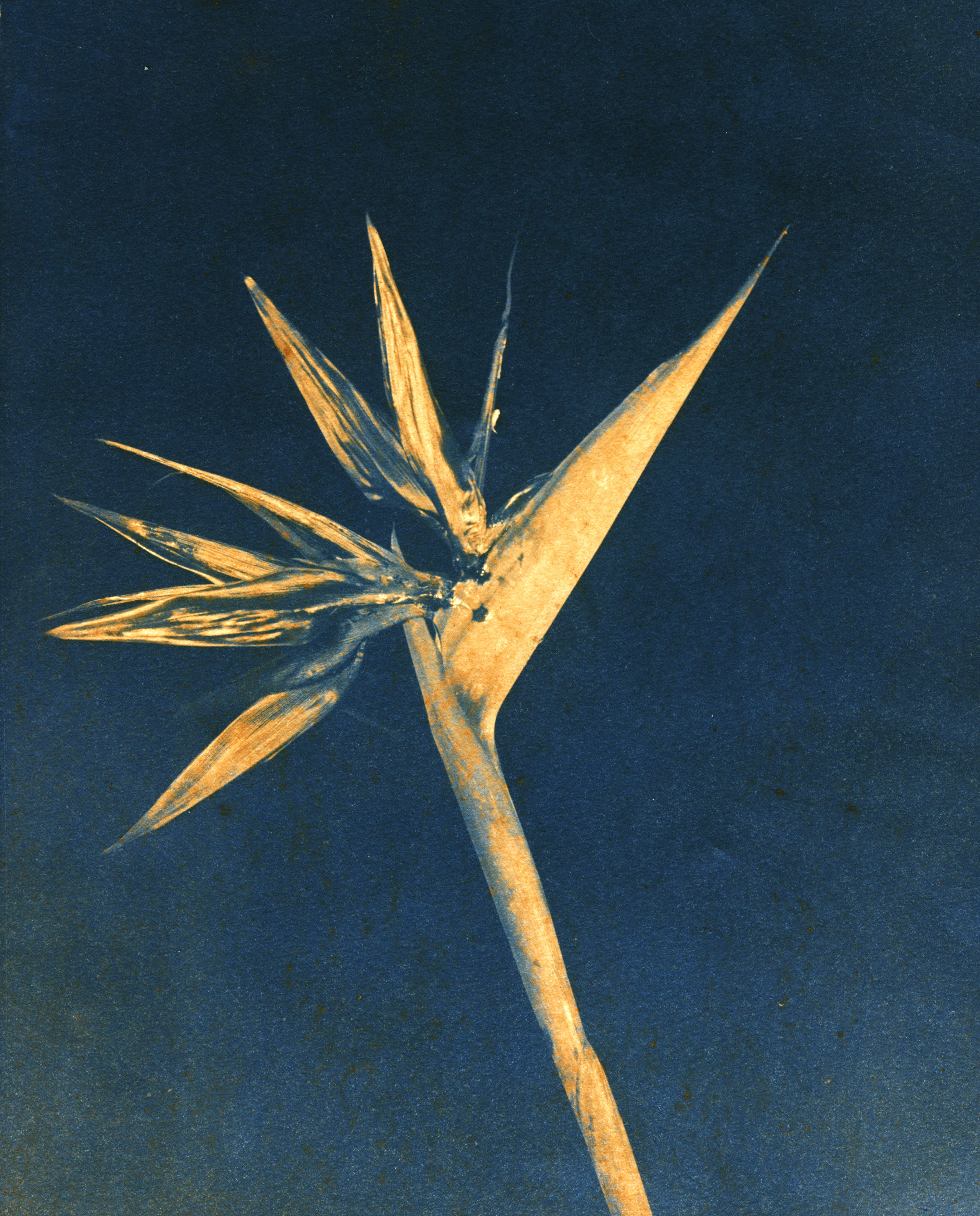

This is a test contact print from a 10x8 Foma 200 negative - bird of paradise flower photographed under UV light in the studio.
Workflow:
. I used the OP's directions for sensitiser and developer,
. glass rod coated A/B, 1+1ml
. air dried in the dark,
. about 30 seconds blow dry both sides,
. then exposed for 8 minutes under 365nm LEDs,
. rod coated with developer, 2ml
. left in the dark for 15 minutes,
. initial 2 minute wash in weak citric acid solution, then washed for about 20 minutes.
Still some more work to do, but it looks promising so far. Paper was Bergger COT160.
