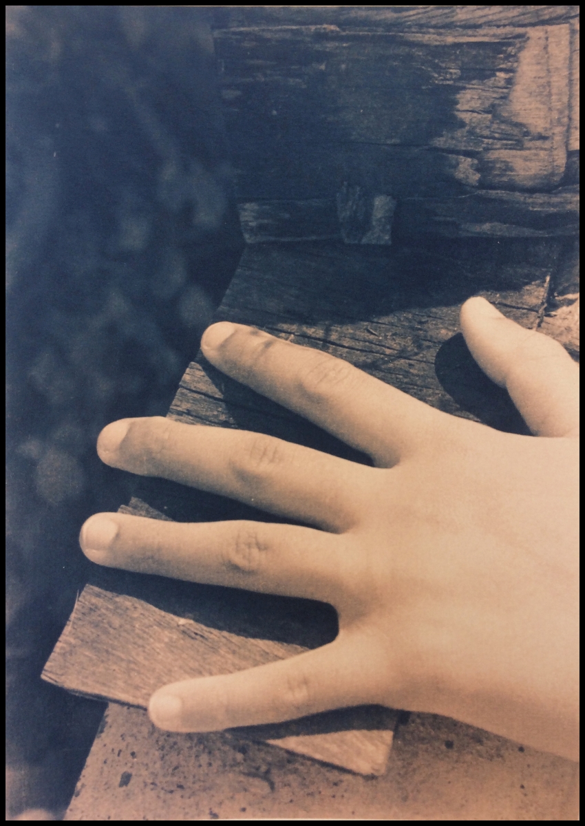

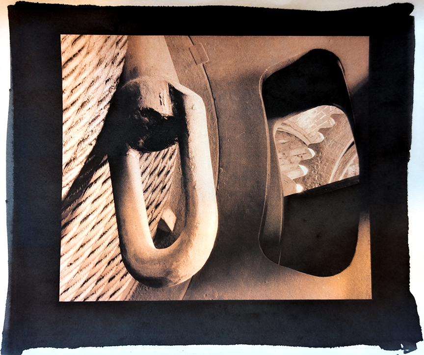

Three papers that I've been playing around with, from very cheap Daiso (Japanese dollar store) paper, to a pad of Canson XL Watercolour, to expensive Revere Platinum. All yield different results. I'm quite happy with the cheap dollar store stuff.
Dollar Store Paper:
Canson XL Watercolour:
Revere Platinum:
Andrew O'Neill
Jan 16, 2004
13,014
Coquitlam,BC Canada
Canson's shadows were very blue. Coppering was subtle for Revere. Dollar store paper, had no blue. Very much like a Cuprotype, but with much more intensity, which I like.

And it's interesting how each paper gives its own interpretation as far as the blue/copper is concerned. Revere's copper is subtle, and blue is low intensity. Canson XL's copper rendering is strong, as well as the blue in the shadows. The Japanese dollar store paper's copper rendering is the strongest, but there is no blue at all.

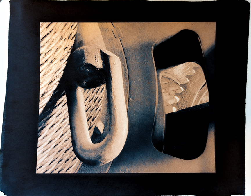

All three are beautiful prints demonstrating different possibilities, @Andrew O'Neill. I like all of them though the first one is immediately striking relative to others. As @PGum noted, complementaty split tone effect in the other two prints has come out well and has its own charm.
BTW if one doesn't like the blue or wants a bit more warmth, cuproammoniacal toner can be effectively employed. Here is a variant that I've been working with lately:
Water: 200 ml
Copper Sulphate: 2.5 g
Ammonium Chloride: 5 g
Sodium Carbonate: ~ 5 g
Dissolve in the same order as above. Add sodium carbonate till the solution turns deep blue.
Use straight or 1+1 dilution to tone a well-washed FerroBlend print for about a minute or two. Wash to remove residual toner. I use as little as 50 ml of the above concentrate to tone A4 size print.
A slightly overprinted print is ideal for toning as there is a bit of highlight bleaching is observed.
Blue moves towards bluish black and mid tones become browner.

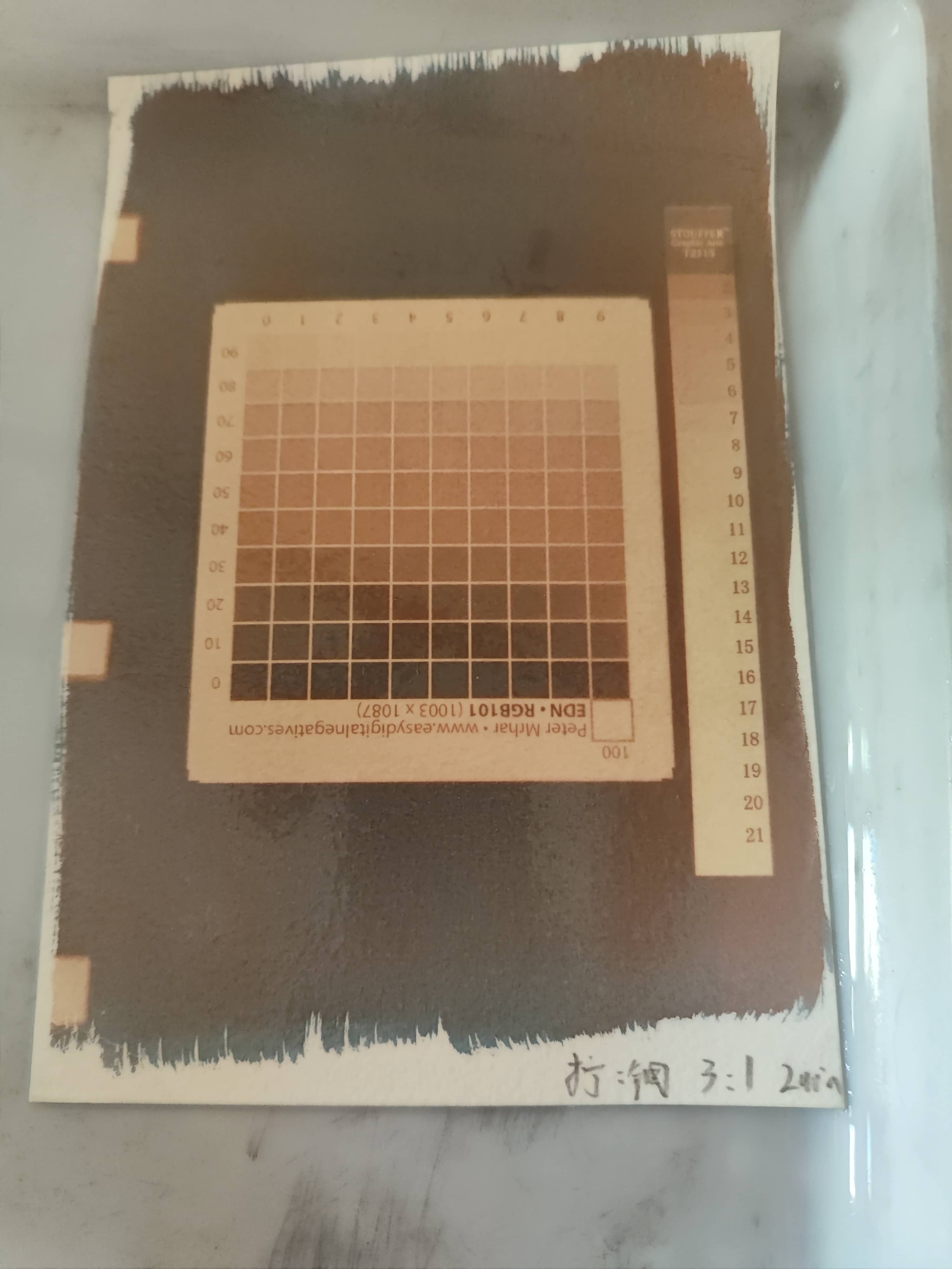

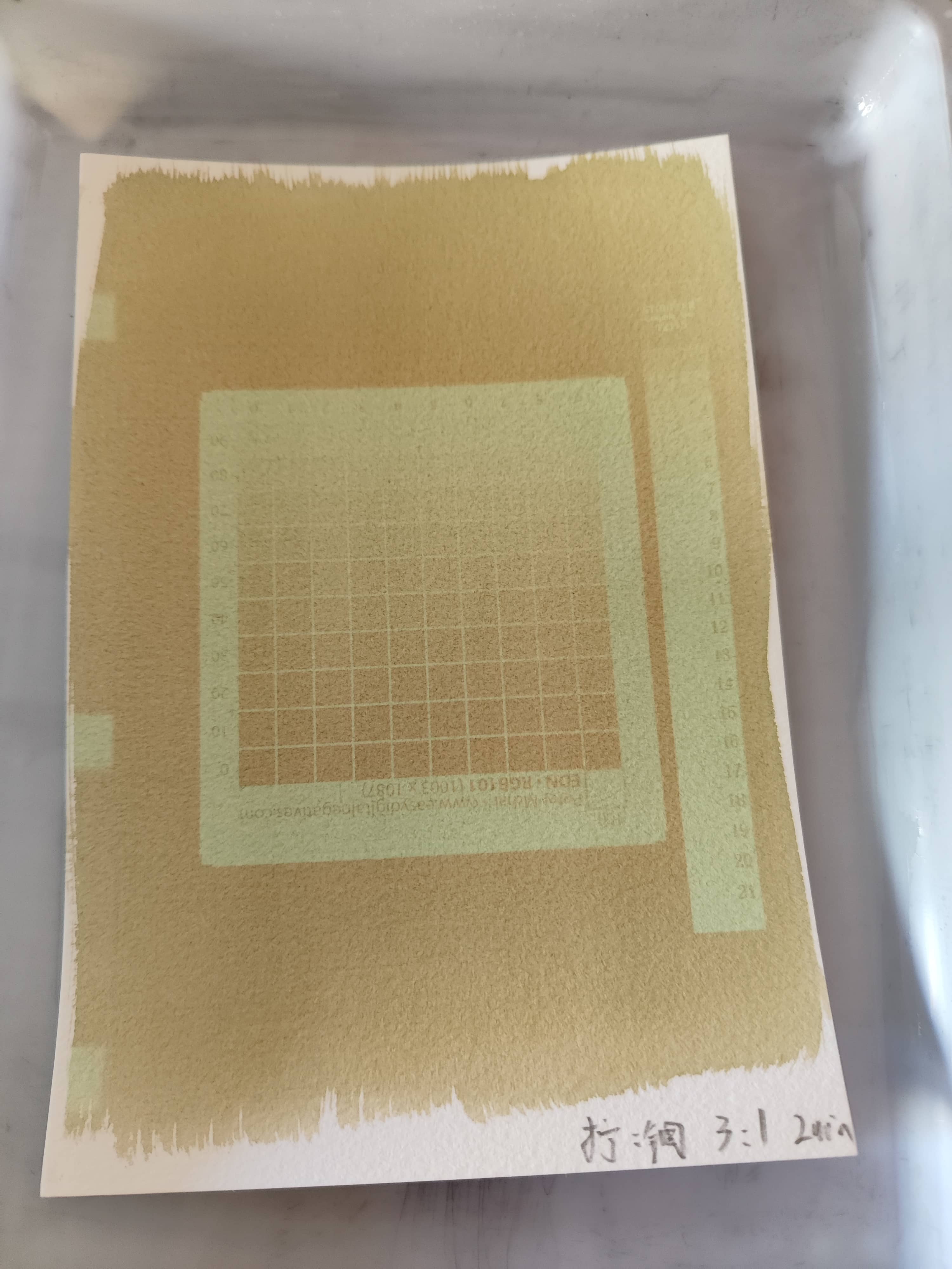

I’ve recently been working on a two-step iron salt sensitization process and have developed a two-step FerroBlend process.
Solution A: 20% Ammonium Ferric Citrate (same as Solution A in classic cyanotype)
Solution B: 10% Copper Sulfate
Sensitizer: Mix Solution A and Solution B in a 3:1 ratio (the ratio can be adjusted depending on the desired balance between Copper Ferrocyanide and Prussian Blue—increase Solution A for more blue tones).
Apply the sensitizer evenly onto paper. Exposure time is roughly half of that required for traditional cyanotype.
Developer: 1% Potassium Ferricyanide. Apply an excessive amount evenly across the paper during development.
After development, rinse thoroughly with water to remove any residual potassium ferricyanide.
After Exposure
After Development

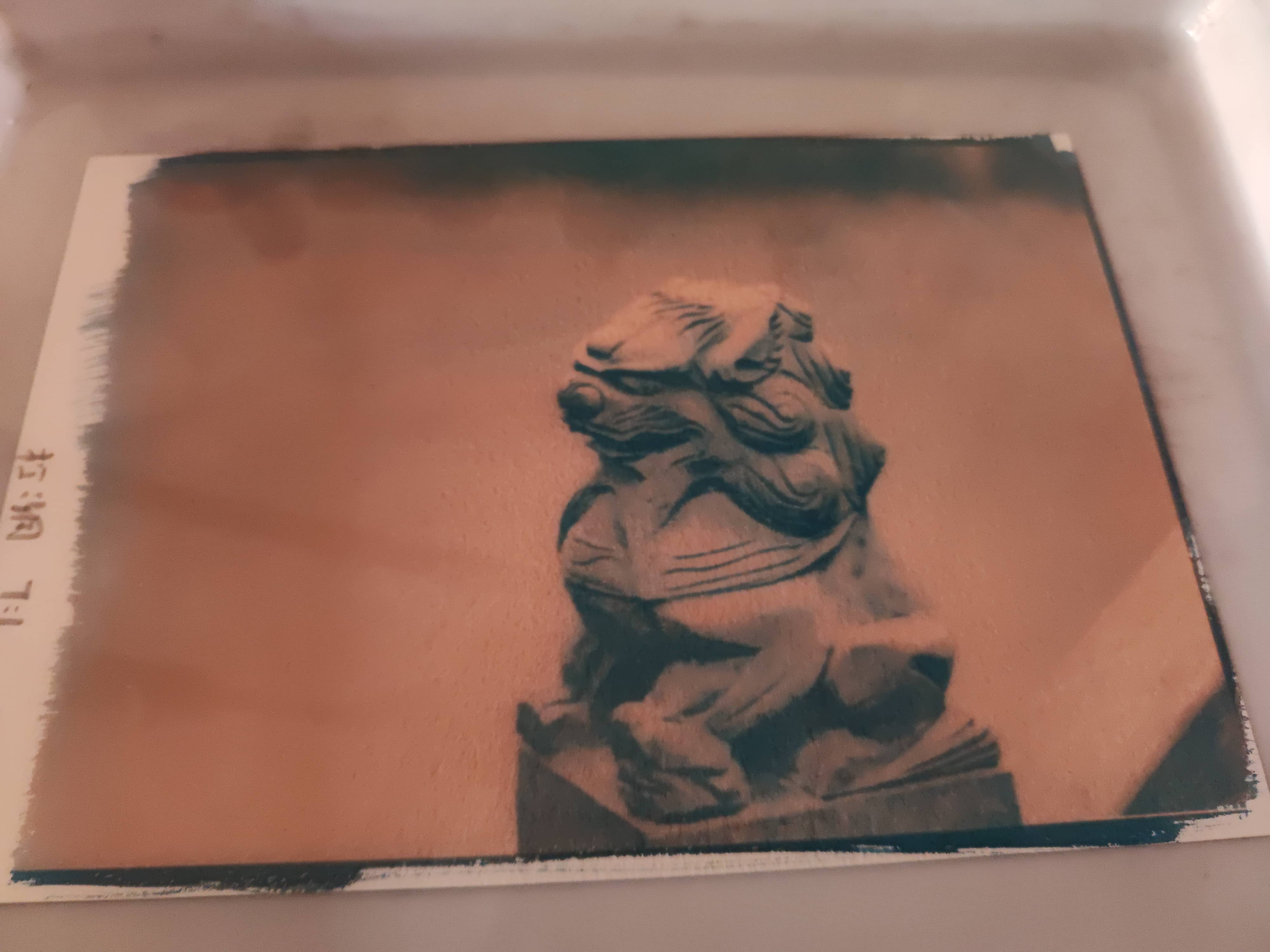

The result of mixing Ammonium Ferric Citrate (Solution A) and Copper Sulfate (Solution B) in a 7:1 ratio is shown below.
